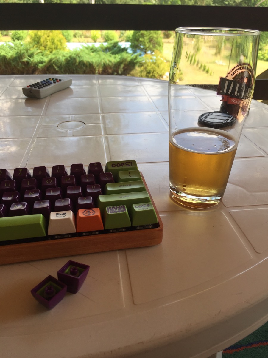

Our wood cases are machined from one piece of wood, the only thing that is glued is the small bar over the USB port because there is no way to machine that otherwise (unless you have a 5 axis CNC).

Ahhh that's what you mean. Well you can't make it out of just one solid piece of wood because when machined to pretty thin (2-4 mm in thinnest parts) case it would flex and bend and even PCB and steel plate would not help. It took us long months of testing and working with experienced woodworkers to find a solution to that problem.
So our solution is to use pre-glued wooden blocks (like used for tabletops or shelves for example - single block would warp the top and they wouldn't be flat) which we source from local woodworkers. We then cut them into smaller blocks, about 20mm wider and longer than actual case, and such block is getting through the machining.
After process is complete it's time for manual work. We glue the small portion above the USB cutout, then do the sanding, cleaning, oiling.
Oiling is the most time taking. We use 3-4 layers of oil (depending on colour) and we wait around 4 days between each layer + 2 weeks after final layer so everything is nice and dry before it goes on the store.
