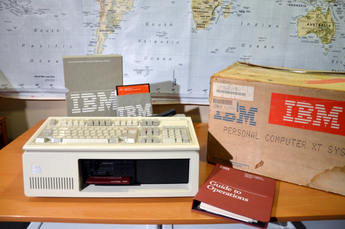

I have an original IBM XT with the original boxes and manuals and it came with a 1390120 keyboard and it worked natively with the XT computer.
I was also able to connect the 1390120 with a 5-pin DIN to ps/2 adapter and a ps/2 to USB converter and use it my modern 2016 computers without needing to flip any physical external or internal DIP switches. My guess is that the internal keyboard controller in 1390120 is capable of auto-switching between XT/AT keyboard codes.
http://www.clickeykeyboards.com/model-m ... m-model-m/
IBM Personal Computer XT and 1390120 keyboard
ibm xt 1390120.jpg (454.59 KiB) Viewed 3780 times
