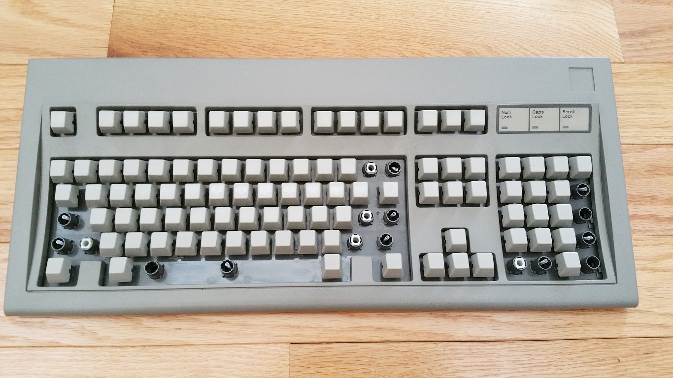

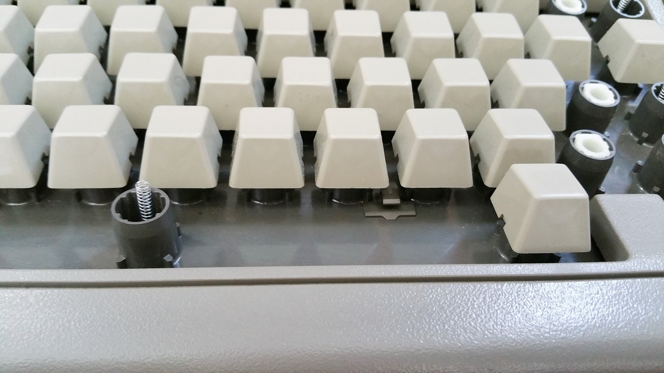

I am cleaning a bunch of IBM Model M's and noticed one peculiarity. My early industrial Model M with the square black logo on the right (which is missing at the moment but I'm working on that) with part number 1390653 has a grey barrel plate. I can't recall if I ever seen this before or if it's unique to a certain set of Industrial M's. My other Industrial M's have either black or white barrel plates as the normal Model M's but I'm just wondering how common this is? Additionally, is there any other factory colours of barrel plates that were manufactured by IBM? Just curious.
I must say, this keyboard looks pretty cool without any key caps on. The second pic hopefully shows the dark grey colour better.

I don't have pics right now, but I also had an '88? Model M with a gray barrel plate like the one on your industrial. Just going from experience (work on at least a dozen Model Ms from various years), but I believe all of the early Model Ms up to '87 had black barrel plates, then from '89 until Lexmark introduced drainage channels, Model Ms had white barrel plates.
As far as I know barrel plates with drainage channels were all black. I don't know much about late Lexmark-era Model Ms though.
So I think IBM only briefly made barrel plates in dark gray, around 1988. Do you have a manufacturing date on that Model M?

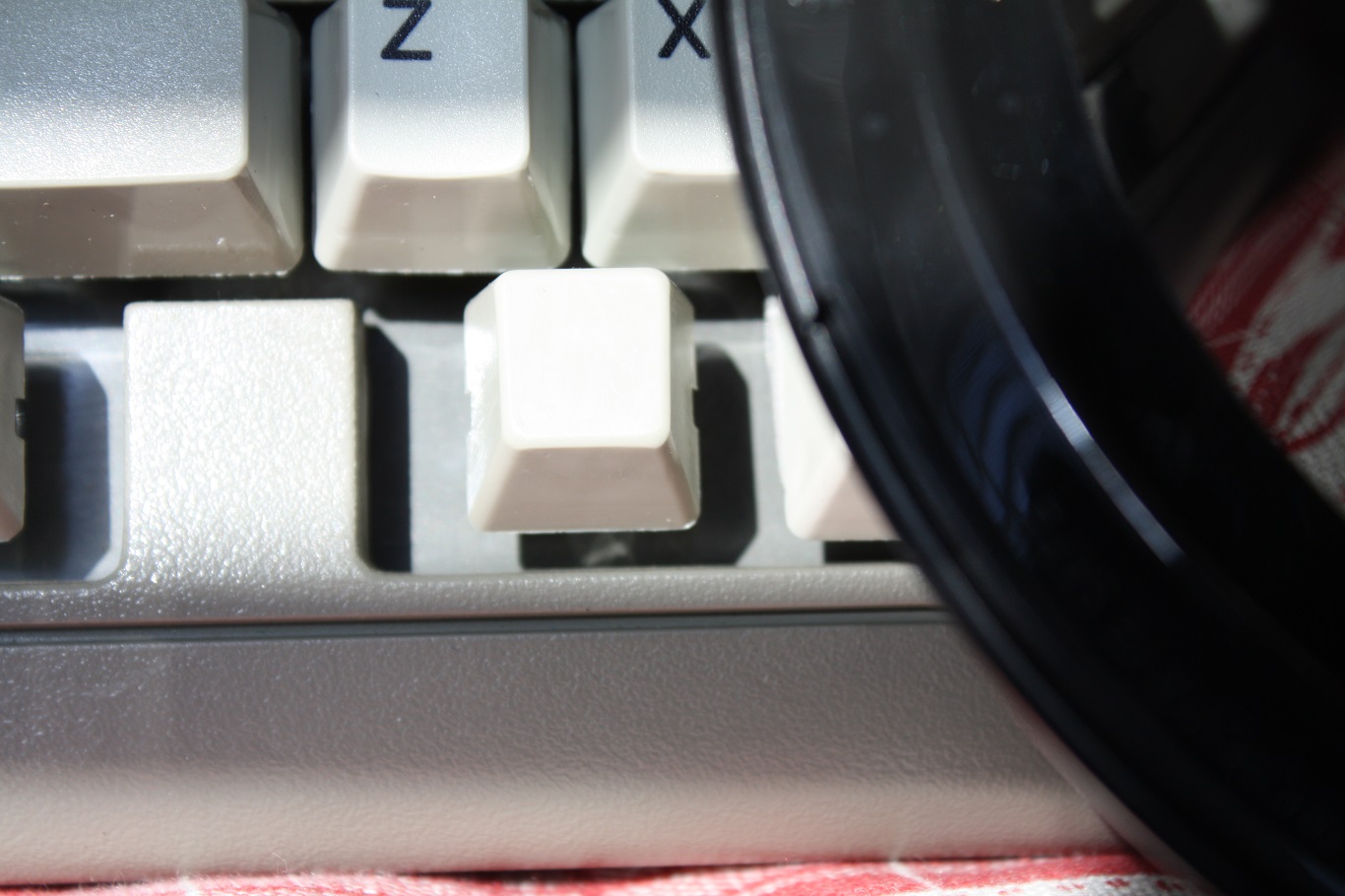

Here's a better pic in direct sunlight. I put a black plastic plate next to it for contrast. I think I have seen one like you describe where it looks like there is swirl marks in it like they mixed it and didn't finish but threw it in the molds anyway. Does that sound possible? This one is definitely grey and noticeable or I would have just breezed past it. This one is a solid colour.

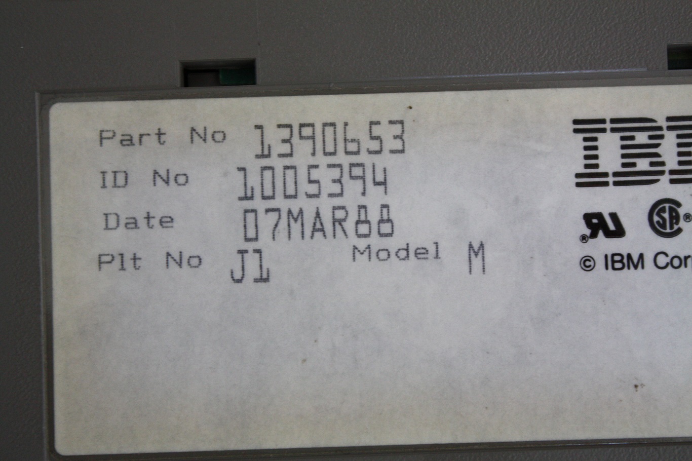

This one is March 7, 1988. Seems kind of late but also notice the ID number. The 5394th one made?

snuci wrote: Here's a better pic in direct sunlight. I put a black plastic plate next to it for contrast. I think I have seen one like you describe where it looks like there is swirl marks in it like they mixed it and didn't finish but threw it in the molds anyway. Does that sound possible? This one is definitely grey and noticeable or I would have just breezed past it. This one is a solid colour.
Yes, that's definitely much greyer than I thought. And indeed, the swirly thing, almost like frost crystals on a pane of glass, is what I was describing. Quite a lot of Ms I've found have that effect.

01 Jul 2016, 20:22
That's definitely grey. Been a while since I've seen one of those. They're pretty uncommon to put it mildly, but they do exist and they're the real deal. I don't know what plastic they are either. They seem to be specifically associated with industrial applications, so my guess is that it's a higher melting point plastic or it's more resistant to harsh chemicals.
