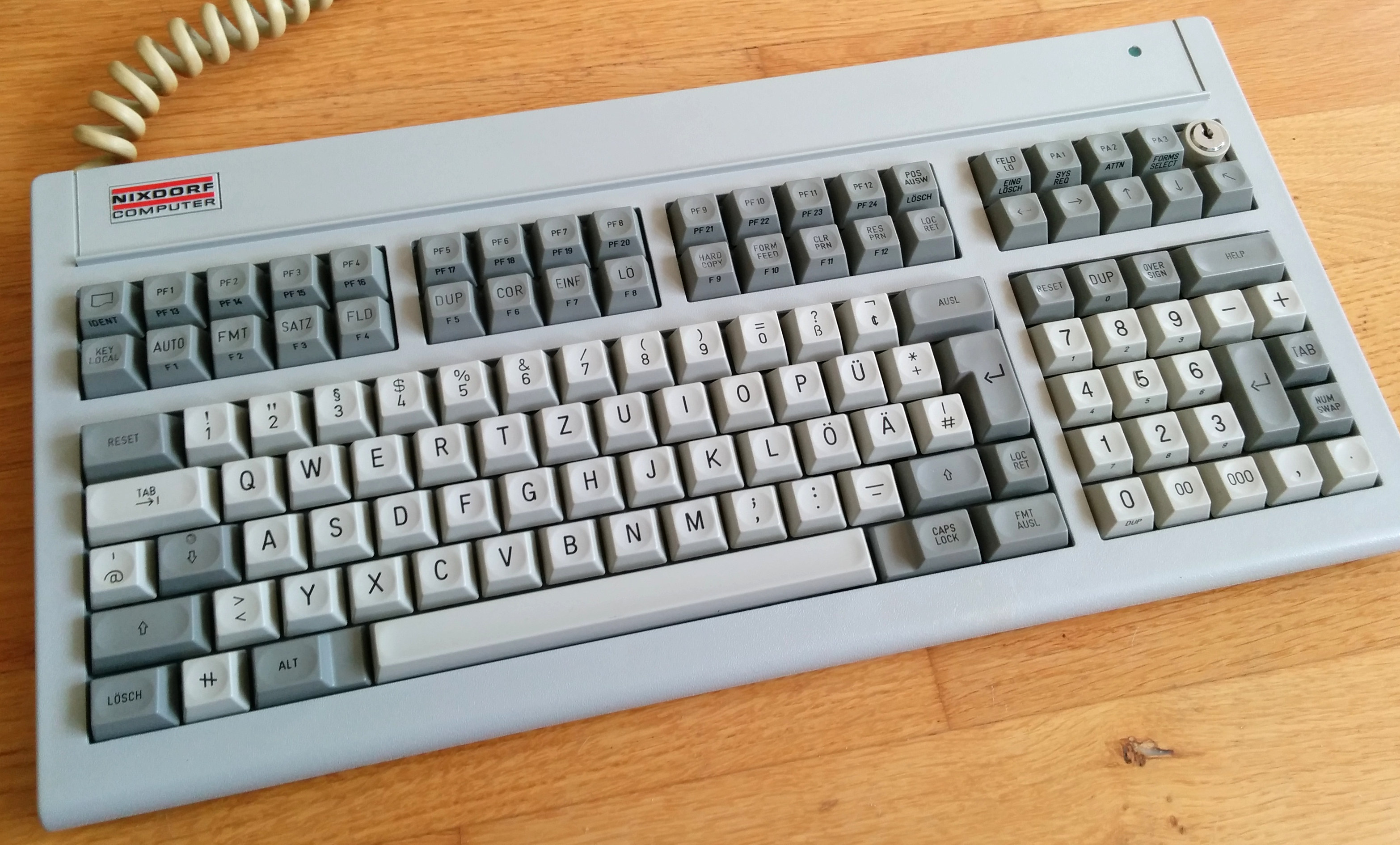

I've been very slack with my keyboard posts in the last months so let's take a closer look at this Nixdorf CT11 now. This keyboard is obviously a variation of the Nixdorf CT06-CT07/2 M Softkeys having the function keys at the top rather than on the left and right sides like the CT06-CT07/2 M . hammelgammler gave us a good look at the keyboard here:

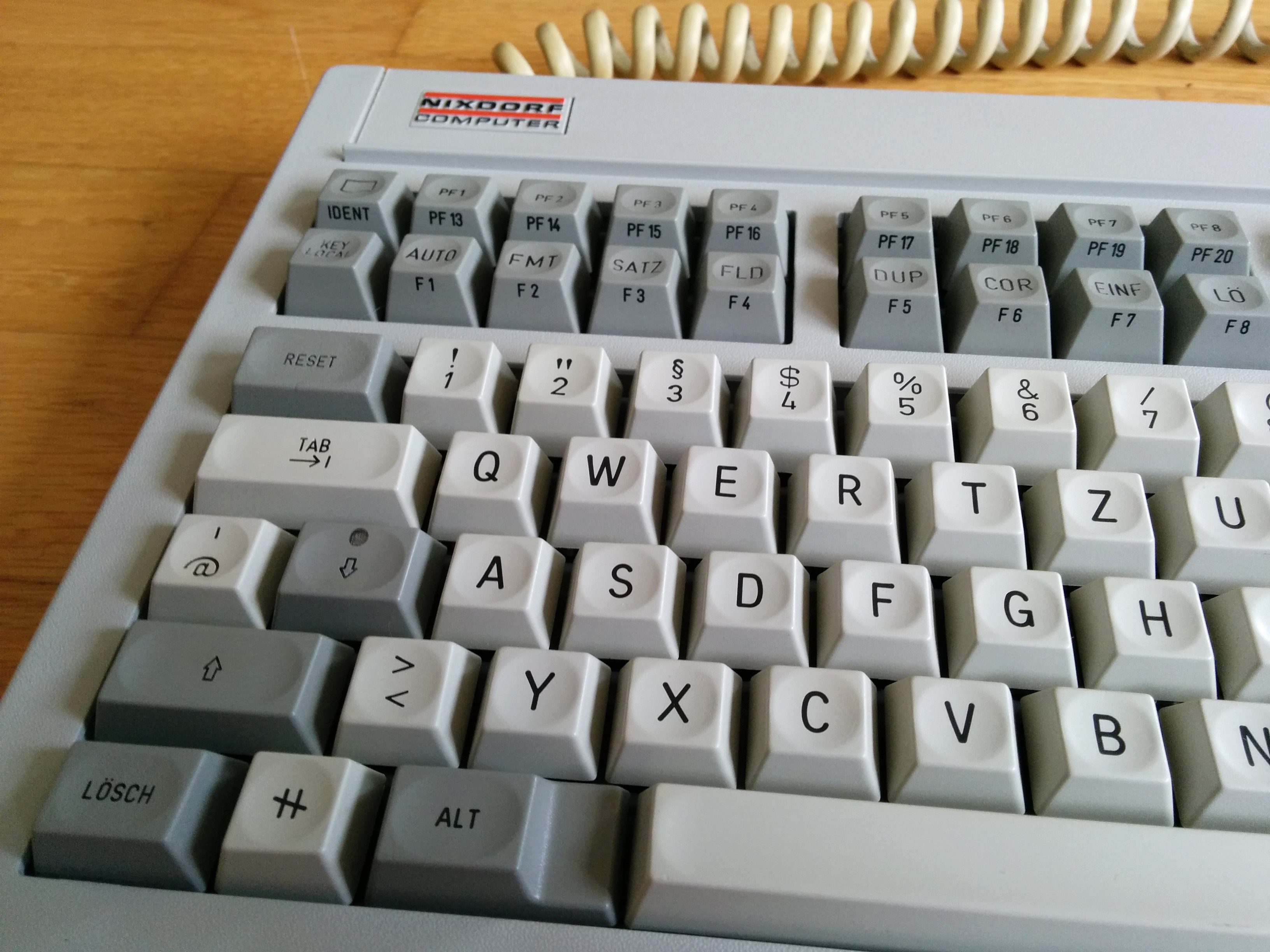

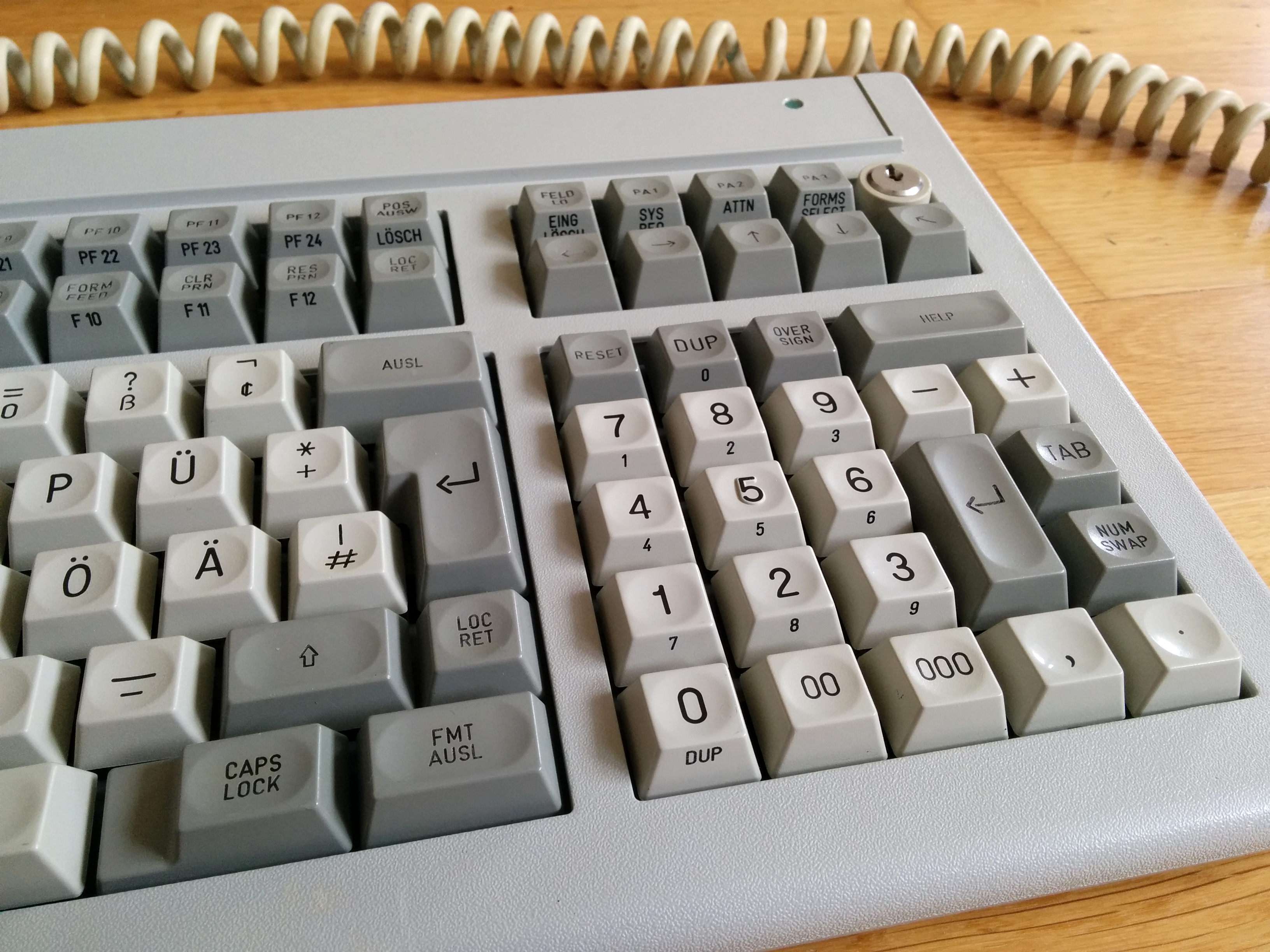

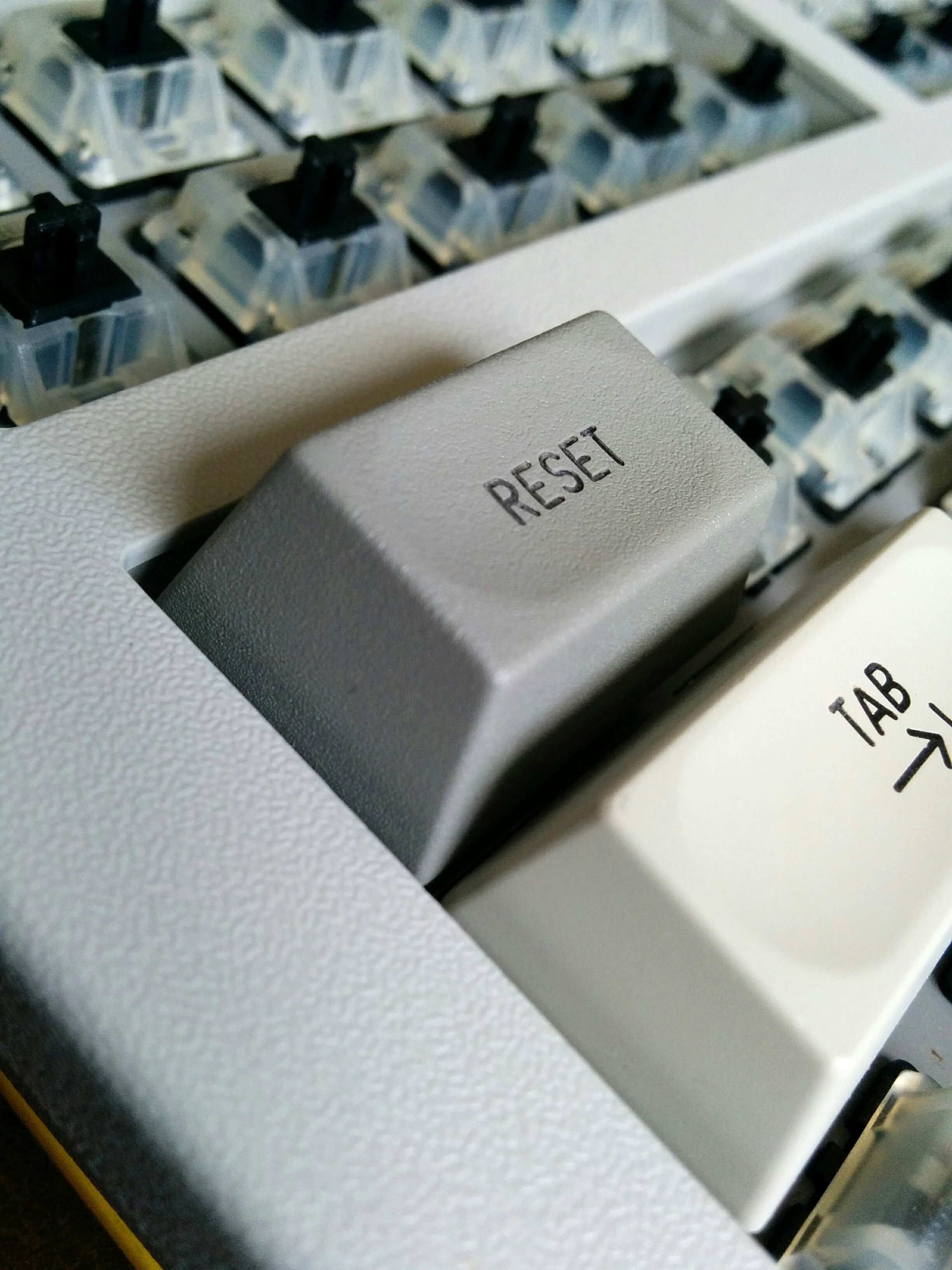

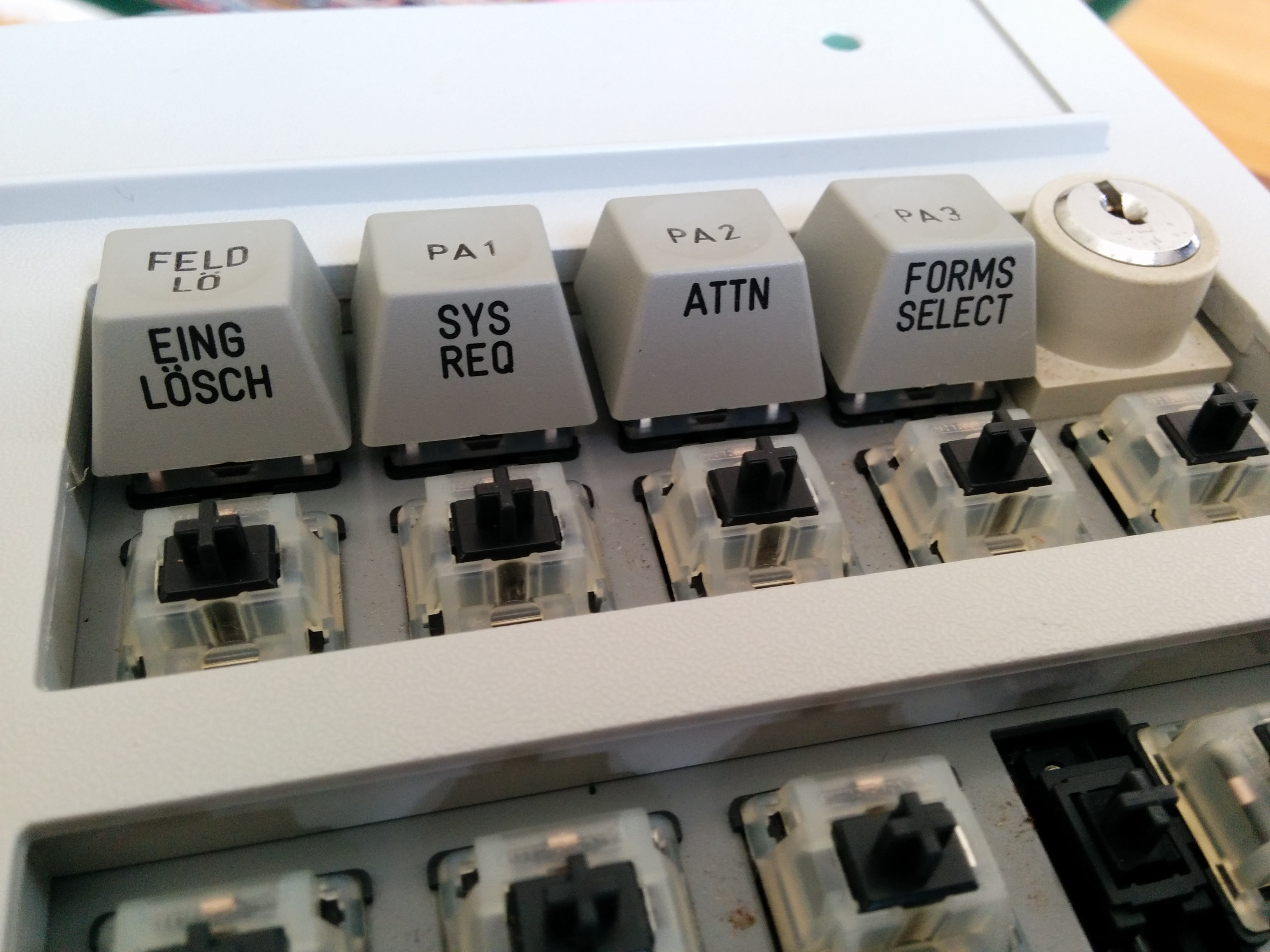

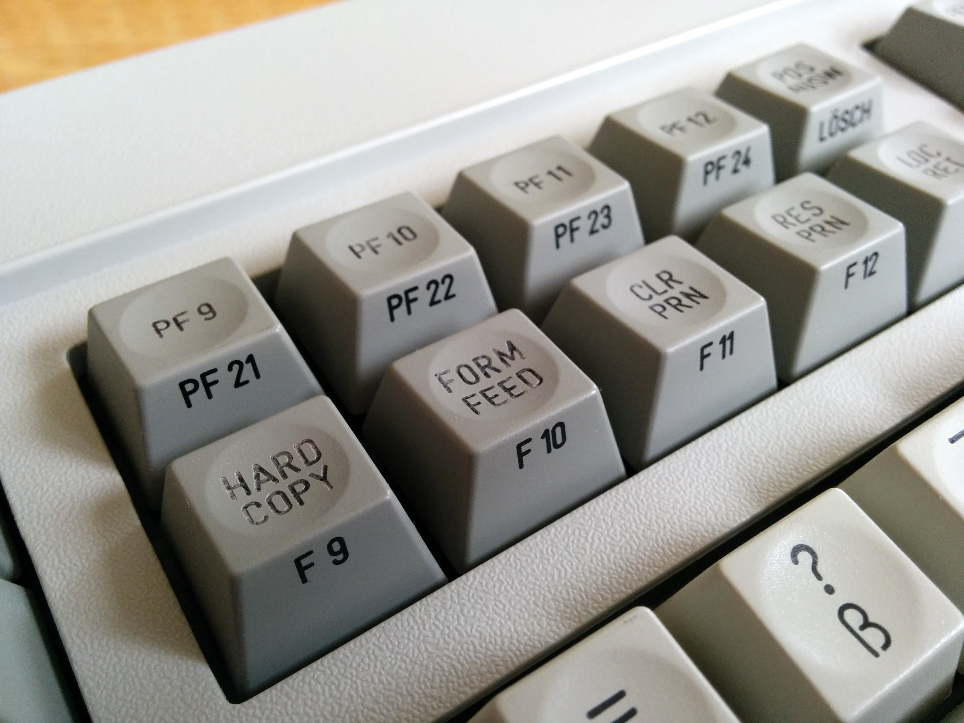

All caps are doubleshots with dampening rings. The "5" is the only keycap that is raised just like on the CT06-CT07/2 M. I do not know what the printing on these keycaps is. The font and overall style is the same as on the the CT06-CT07/2 M. No homing bumps. These keycaps are slightly concave, I guess one could call them semi-spherical.
The dark grey function keycaps have engraved legends, the beige alphas do not. Quite a few secondary legends are present.

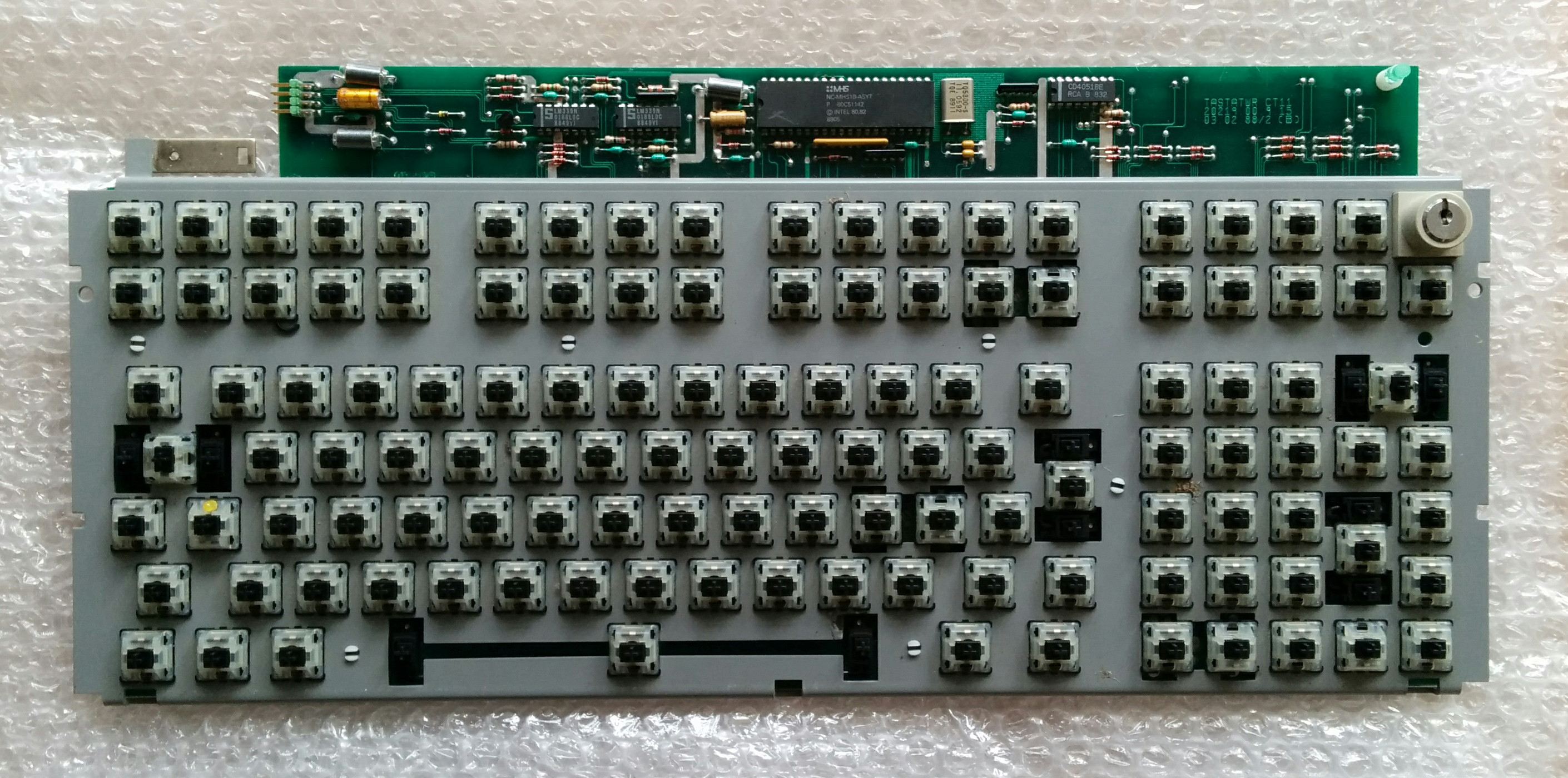

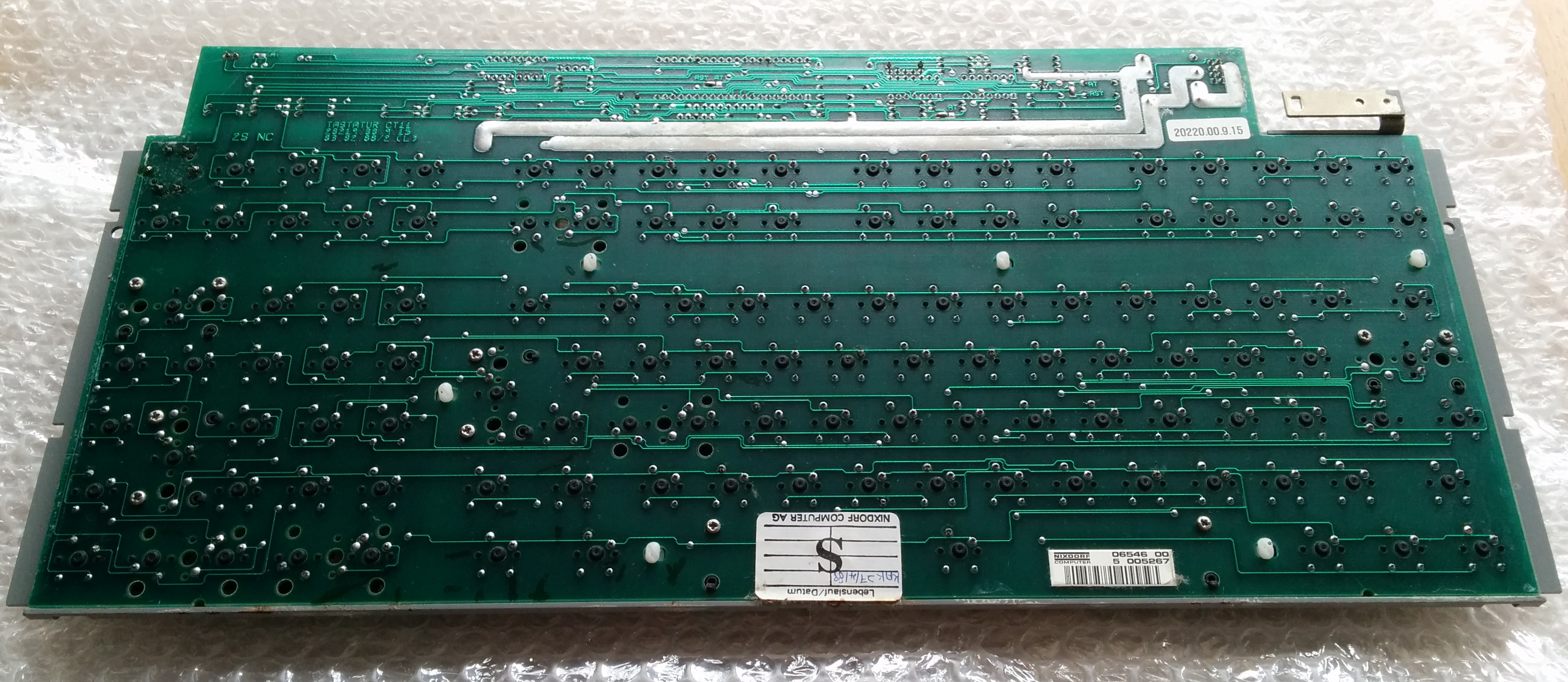

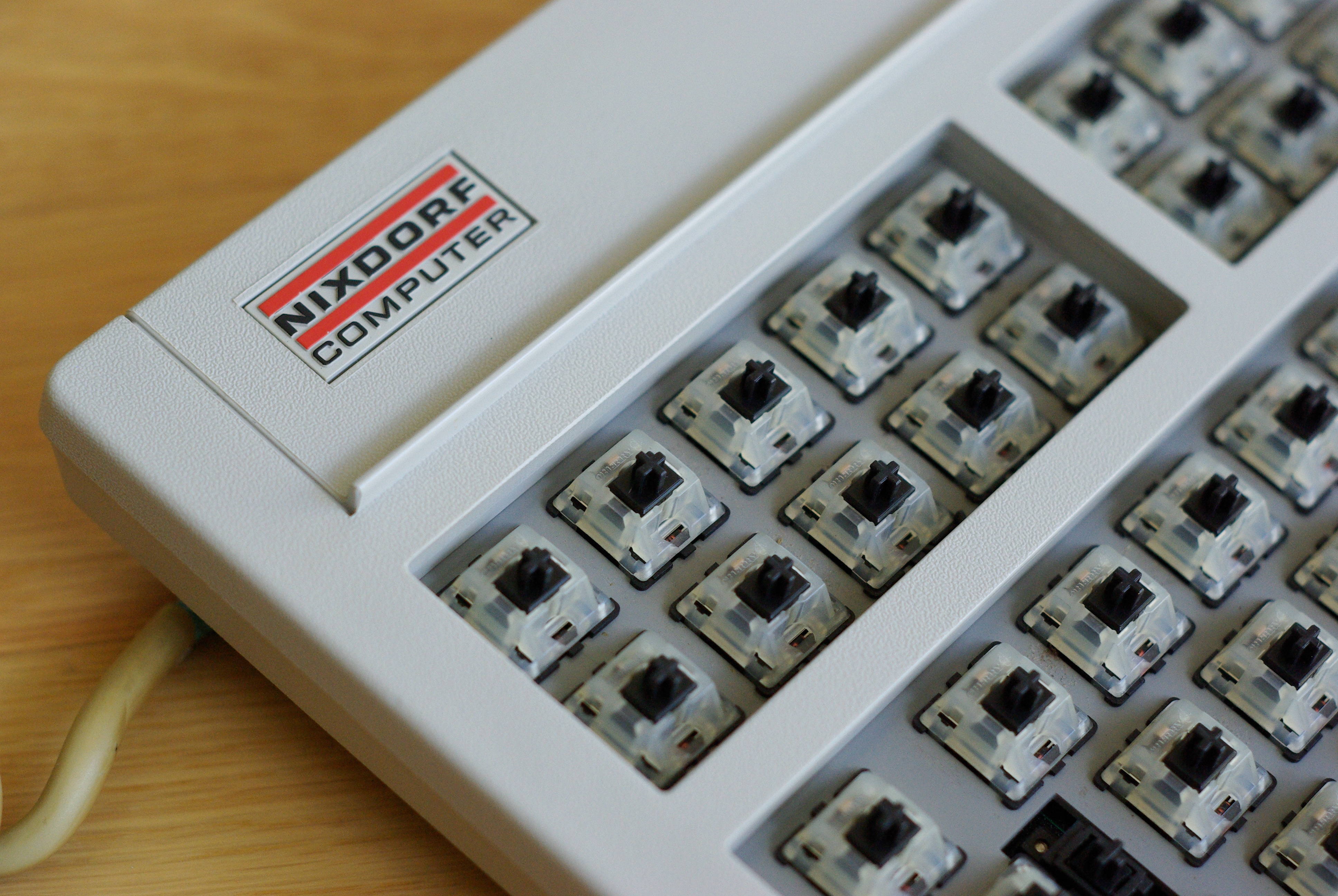

Plate mounted Cherry MX Black cleartop "nixies". Nice grey plate.

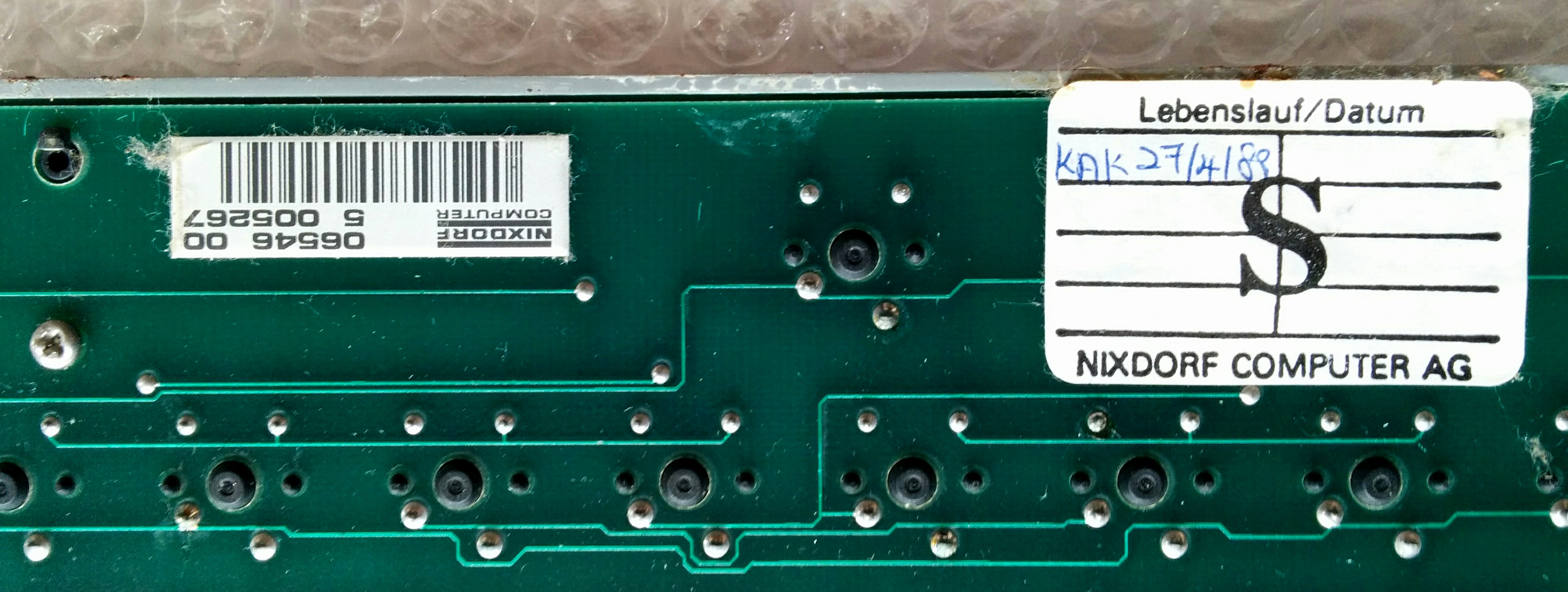

"Lebenslauf" is curriculum vitae or résumé "KAK 27/4/89" making it 27 years old. Youngster. :lol:

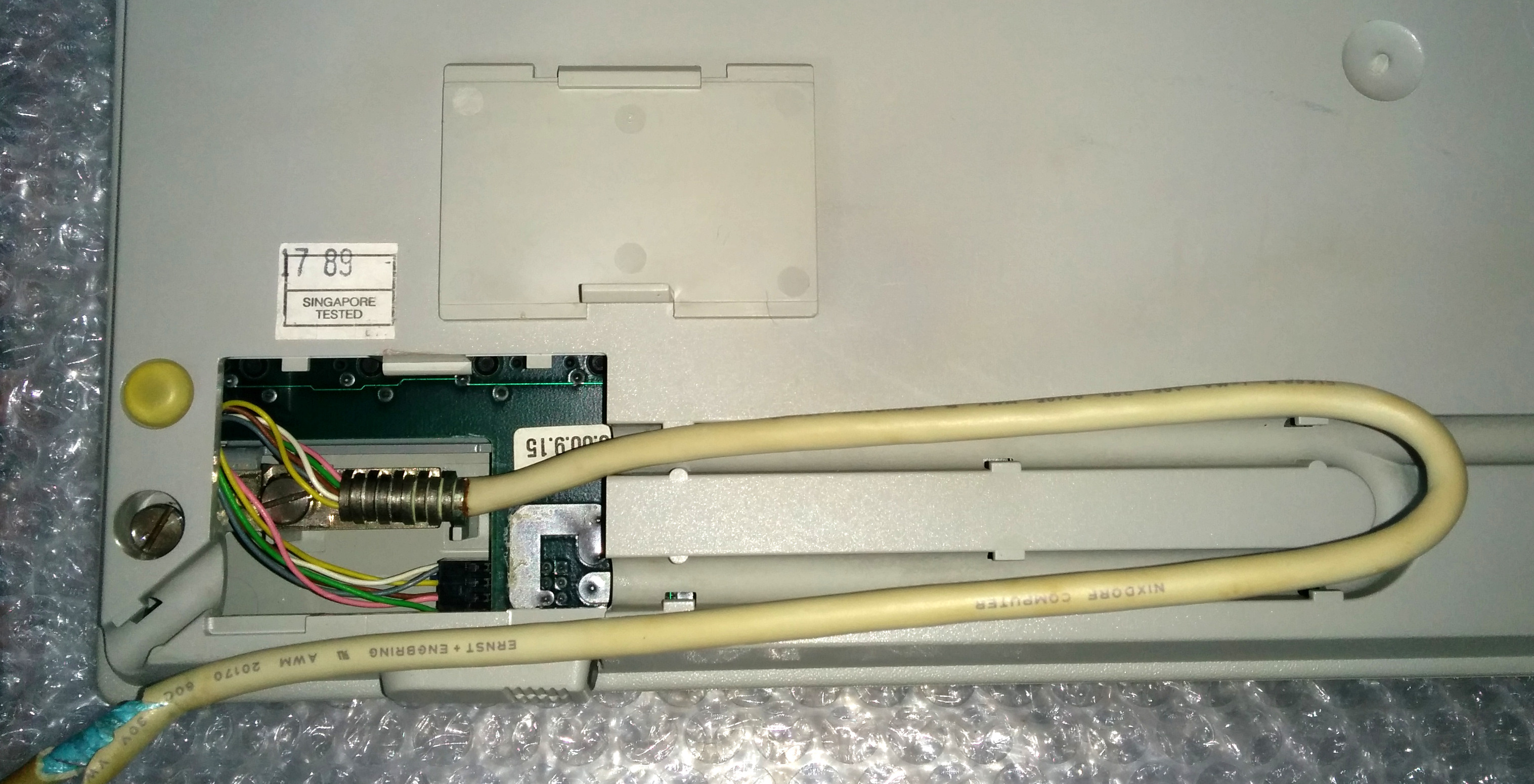

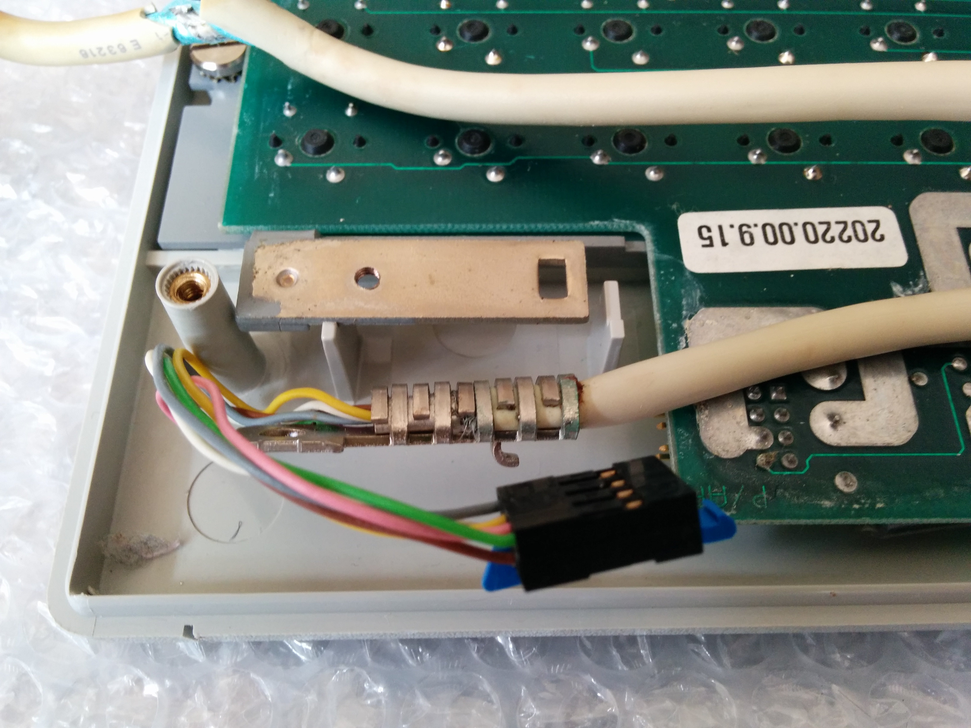

"Singapore tested 7/89" The connector cable is fixed on that little metal bar and then routed out the case, notice the extra little access compartment for the connector.

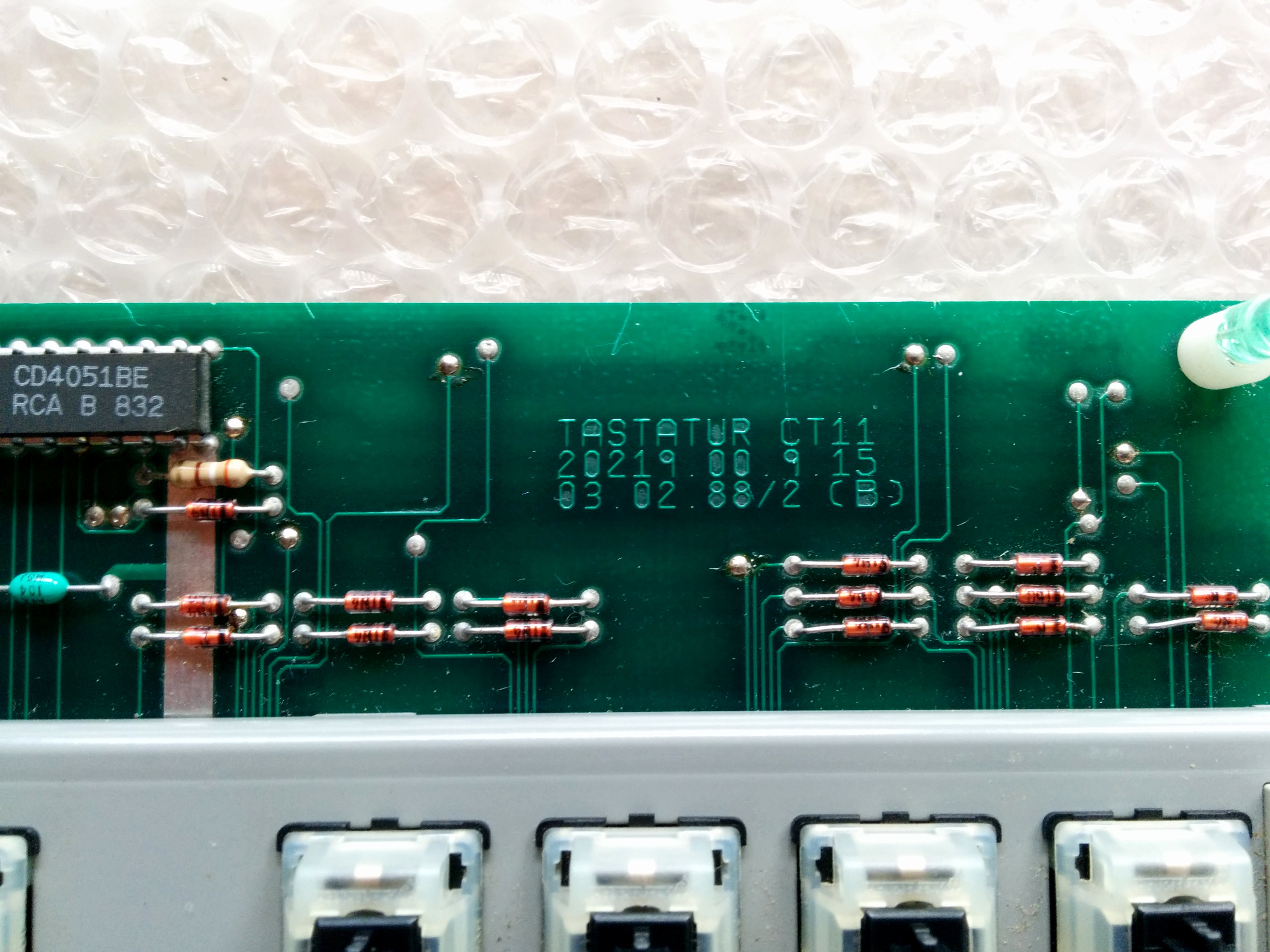

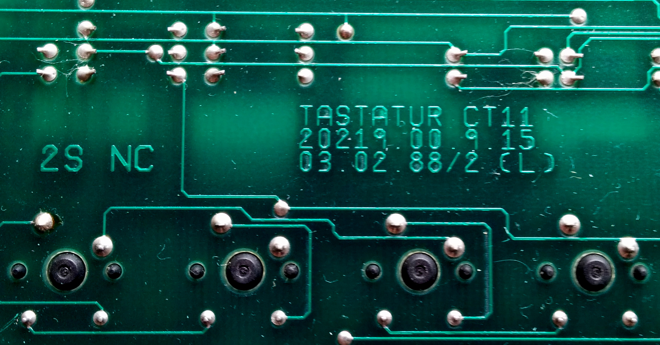

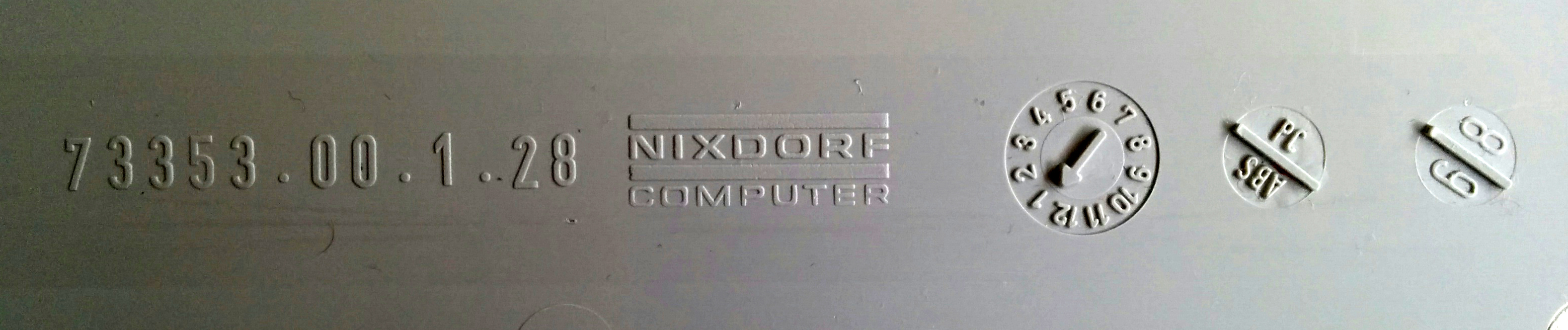

Matching numbers. :mrgreen: "PC ABS".

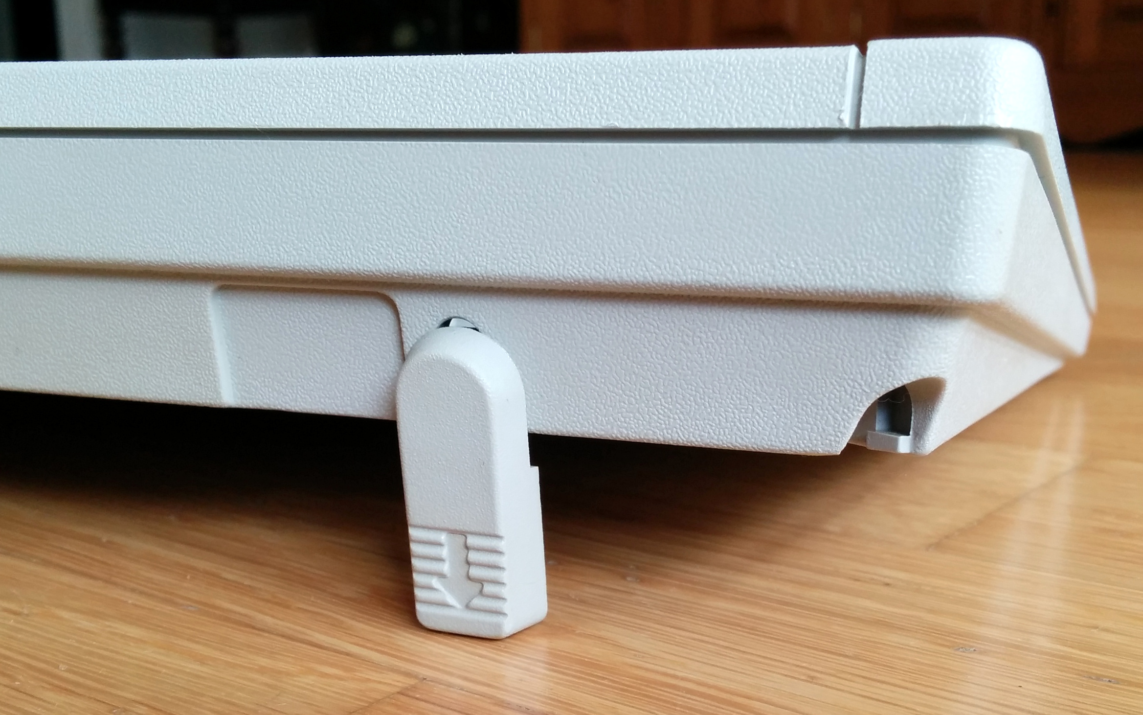

While those little flip feet look flimsy they're sturdy as hell. Overall the build quality of these exceeds a G80-1000 or even a G80-2100.
orihalcon, there is no visible information on the lock. The lock has five soldering points in a circular arangement. Give me some more time on that, I'll get back to you.

I love the layout is has and the way it looks... like it means serious business somehow :P
I wonder why the used a plate on this model and not the bigger "plus sized models".

I'd say it's a very practical keyboard obviously made for a commercial setting with those terminals. That little cable compartment is a good example, a practical time saving feature. The whole keyboard only has four screws, two for the case and two for the plate. Sure I'd love to use it as a daily driver, plenty of function layer options on this one. ;)

I ended up trading my refurbished Unsaver for Hammelgammler's CT11 board. I actually desoldered everything, and the existing matrix is too complicated to really use with another controller as is. I Initially thought it wouldn't be too hard to convert using the existing matrix, but that turns out not to be the case.
Going to have to hand wire it and probably hook it up to an Xwhatsit controller so that programming is the most practical. I do find myself missing the Unsaver, and might consider selling it once it is fully functioning, but by then will have probably put a good 10 hours into the restoration - complete with new key lock. Who knows if selling will still be the plan by the end of the restore though.

Thanks guys, I think I'll be keeping this one although the prices being offered are tempting. Like I said I do not know much about the terminals these came with, I do know that this was an expensive commercial system not likely bought for personal use so there may not have been that many sold. I find that little "Singapore tested 7/89" sticker interesting, I was under the impression the hardware was manufactured in Germany. Apparently not so, or the parts were assembled in Germany. I'm looking foreward to your progress orihalcon, keep us updated!

The fact that the switch are plate-mounted and PCB-mounted is really cool. :)
orihalcon wrote: the existing matrix is too complicated to really use with another controller as is. I Initially thought it wouldn't be too hard to convert using the existing matrix, but that turns out not to be the case.
Can you elaborate a bit more on what is that complicated with that matrix?
I don't know much about electronics, but it seems to me that a matrix is a matrix; probing the pins doesn't work here?

This well-made Nixdorf PCB feels like the TG3 board. Are they had some communication on that day?
And the condition seems very good.

terrycherry wrote: This well-made Nixdorf PCB feels like the TG3 board. Are they had some communication on that day? And the condition seems very good.
It's in pretty good shape for it's age. No real damage.
