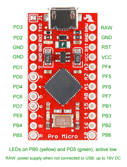

The Arduino Pro Micro has 18 bidirectional digital pins. Some pins on the AVR can also be used for special purposes such as serial, timer input, PWM output, etc. and they are therefore sometimes labelled by those functions which can be confusing.
Arduino makes it even more confusing in that it does not necessarily map its pin numbers to AVR ports and bits in any sensible way and I think it can be different for each Arduino board.
Here is the mapping:
In the figure above, Pxy stands for digital port x, bity.
Unlike the Teensy 2.0, The Arduino Pro Micro is made to run on batteries so it has a built-in voltage regulator.
There are two variants of the Pro Micro: One which feeds the AVR 3.3V, and one which is made to feed it 5V - the 5V version being the most common. If it does not say, it should be the 5V version.
If you do feed it with +5.0V from USB, however, there is a penalty - the voltage regulator will deliver only +4.9V.
The AVR should run well on 4.9V, but you could also bypass the voltage regulator by bridging J1 with solder.
RAW = +5V from the USB port (or power IN if you use battery). VCC = +4.9V (or 3.3V) from the voltage regulator, or +5V if bypassed.
On 3.3V, the AVR is limited to 8 MHz and the firmware needs to be made for it but since most firmwares are made for the Teensy 2.0 which runs always on 5V, if you have the 3.3V of the Pro Micro you should bridge J1 to run that firmware.
