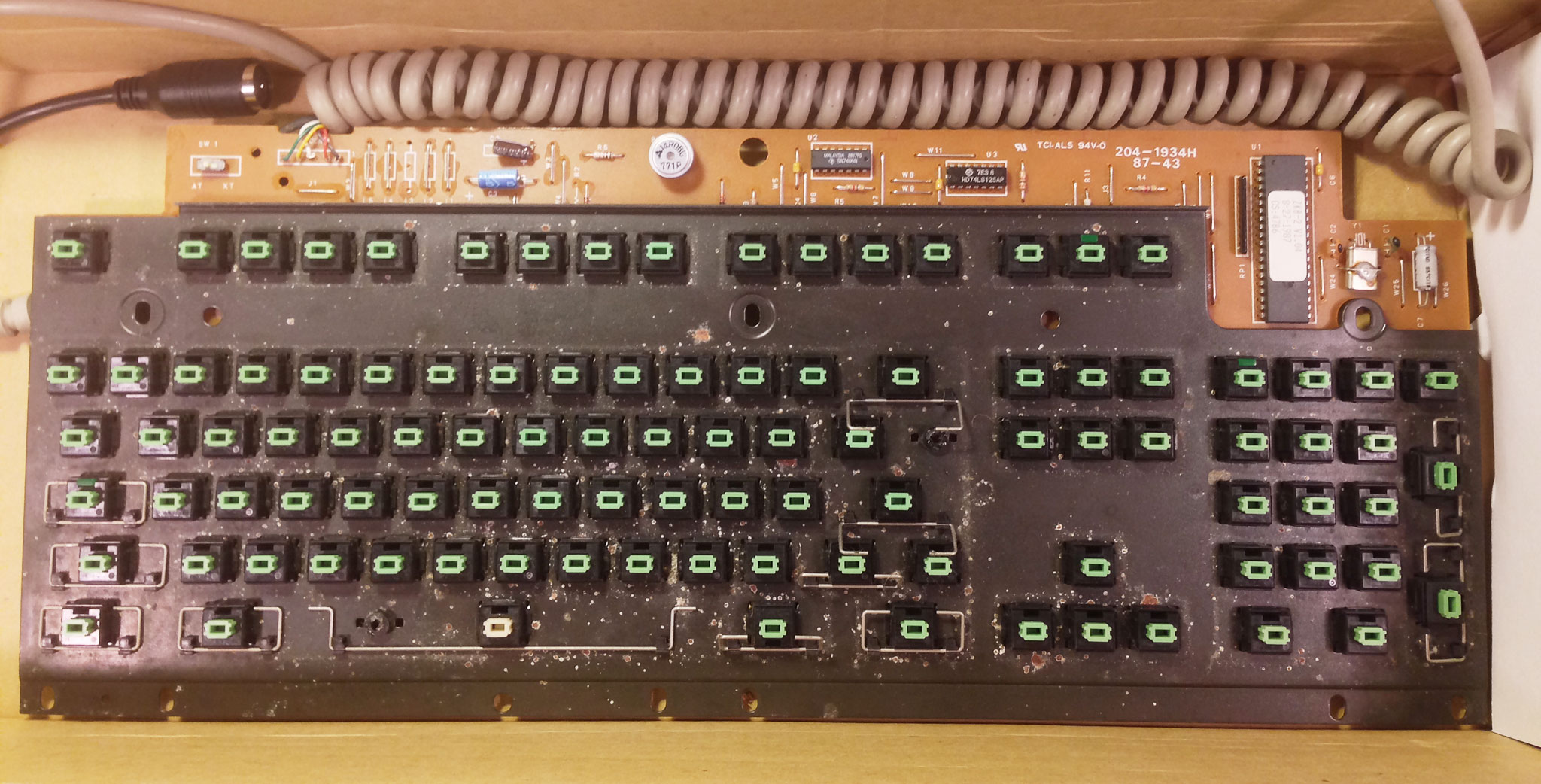

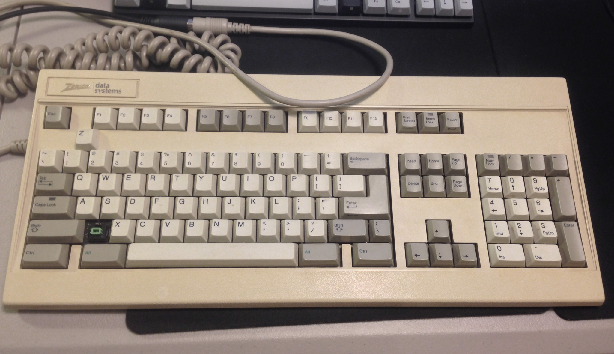

I finally found a decent ZKB-2 the other day and it was somewhat dirty. There is a bit of rust on the switchplate. I was wondering what kind a tips people may have on how to recondition the plate. I thought I could touch up the spots individually after cleaning them.
06 Aug 2016, 03:58
A "switchplate" is what people generally call the contact assembly inside the actual switches. What you're referring to is the mounting plate :) .
Unfortunately this isn't easy to fix due to the nature of rust. If you really want to clean the plate properly you'll have to desolder all the switches, sand the plate down to get rid of all traces of rust. You'll have to pit out any pockets of rust, too. Alternatively you can use a dilute acid solution such as vinegar to chemically wipe it. After that you can paint it with a primer and a rust-protecting coat of paint.

Chyros wrote: A "switchplate" is what people generally call the contact assembly inside the actual switches. What you're referring to is the mounting plate :) .
Yep, I'm still a bit new to keyboard internals. I had a little rust on the mounting plate inside my IBM XT, but the Zenith has somewhat more. I will need to learn how to solder before I can do a proper restoration. I suppose I'll try cleaning it as best as possible without doing any soldering and eventually I may be able to refinish the mounting plate.
I want to take my time with it and do a good job.

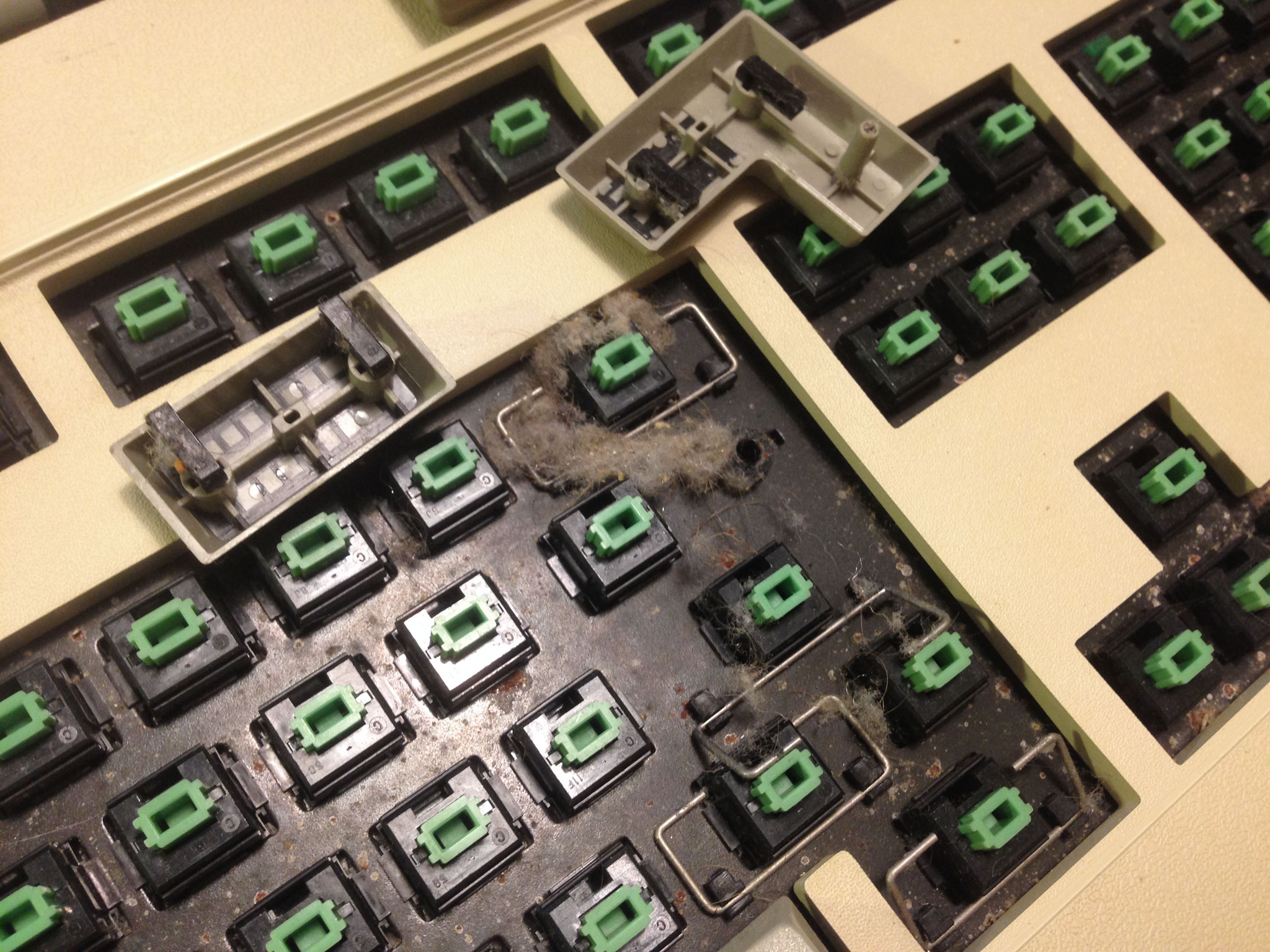

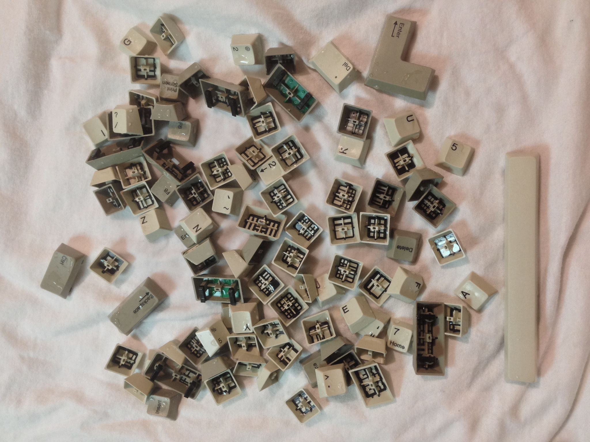

I just finished washing the key-caps and I don't think they have much yellowing at all. At least the color on the interior of the caps looks like the exterior. My medicore Iphone 5 camera wants to over-saturate all my pics though.

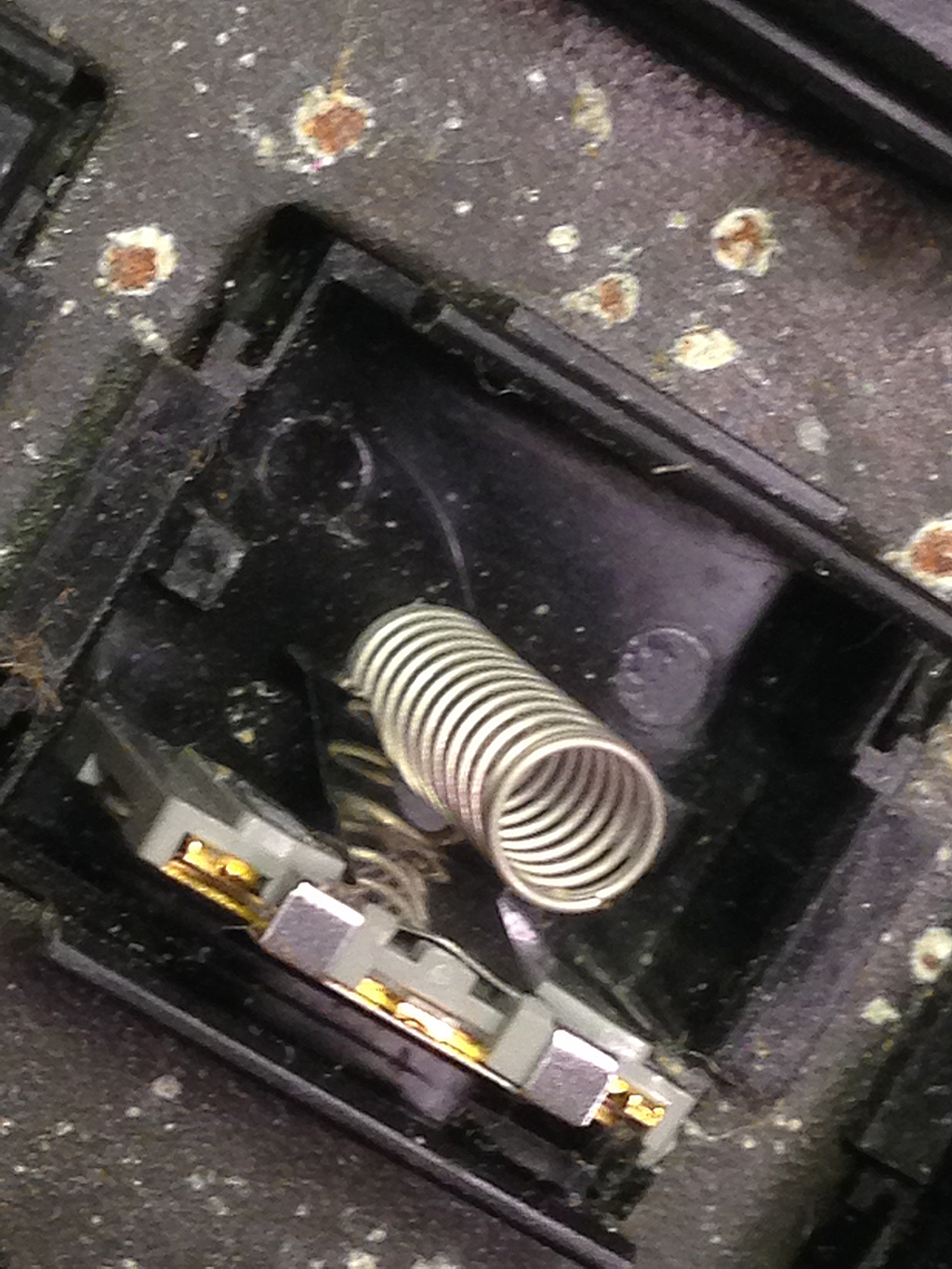

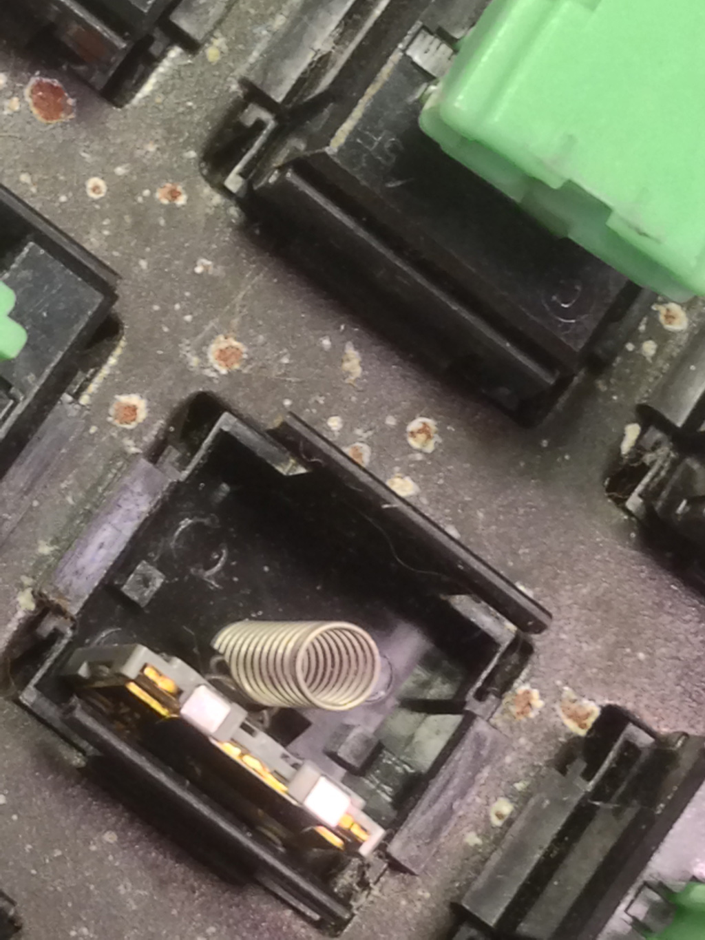

emdude wrote: Ooh, that may not be good. As is oft-repeated, Alps switches are very susceptible to dust and while cleaning (and lubing, if you wish) them will help a bit, you may not be able to restore them to their original smoothness.
Here are a couple of poor close-ups of the inside of a switch. I had vacuumed with board after removing the caps, so that might have cleaned the switches a slight amount. It's hard to tell without the caps on, but they could be smoother now.
I also noticed that there is a slight haze on the sliders that can be rubbed away. I wonder if this is some type of dry lubricant or just environmental residue. ???

I'm not sure if SKCL Greens were ever lubricated (though I think they were), perhaps Chyros can elaborate more on that, but if they were it should only be on the contact points between the slider and the switchplate leaf.. Those gray streaks on the bottom of the slider in the first photo might be lubricant..
Otherwise damage to the slider will be at that contact point, and also the contact points between the slider and the top housing. People usually lubricate the former or both to increase smoothness.
On another note, I find it fascinating that some of the wide keys use traditional rectangular mounts for Alps stabilizers while others use the cruciform Cherry/Costar mounts..

Generally speaking, the wear and degradation in feel comes from two things, one that's more temporary and fixable and one that's more permanent.
1) Dust and dirt getting in the switch and caught between the slider
2) Dust and dirt starting to wear at the plastic from continued while dirty
Generally, just cleaning the switches out with a blast of compressed air is enough to restore the feel if they aren't too beat up. Much of the feel comes from the top housing, even more than the slider, so if you can really clean them or replace them, that will help.

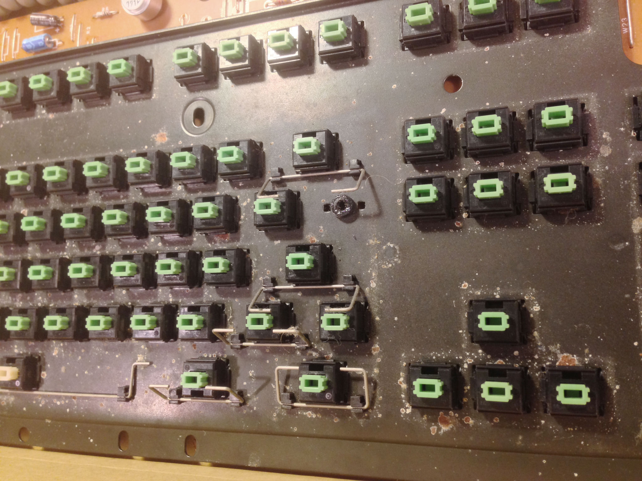

That plate is a goner though.

Yes, the hazy stuff appears to be a dry lubricant we haven't been able to identify. Unfortunately despite a fair amount of effort, people have not yet succeeded in fully restoring Alps switches. Cleaning them out can help, definitely, but making them as-new, no. When you do clean give special care to the inside of the top housing.

Best way to fix that plate is sinking it in vinegar for a few hours until the vinegar has eaten all the rust, then brush it off really well under clean water and dry it with a towel. Spray some paint on after you made sure it's properly clean & dry.
