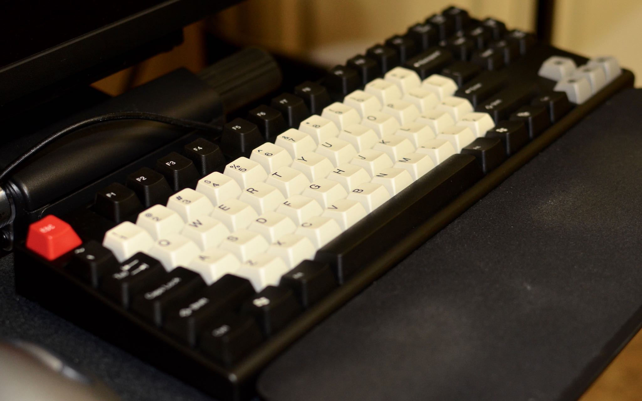

It's hard to get much of a usable layout from something like an LK201, and, I had to modify the left and right arrow keys to fit by cutting them down to size. For now I'm using them on a V80MTS with some ABS double shots to fill in the balance. They caps are nothing short of magnificent, everything I've ever wanted from a key caps (almost - WoB PBT doubleshots of these would be ideal...)
KBParadise V80MTS (Matias Quiet Click) with spherical alphas, Signature Plastics ESC, and ABS doubleshots elsewhere.

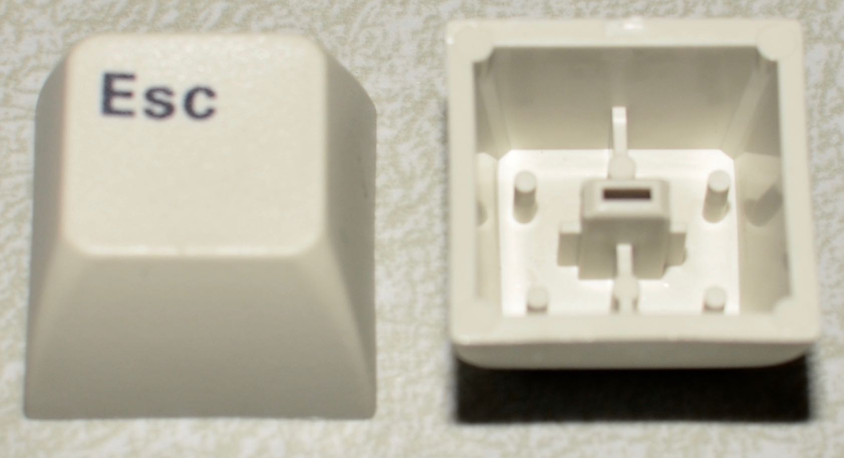

Let's have a closer look at the caps and their profile.
PBT spherical key cap molding detail.

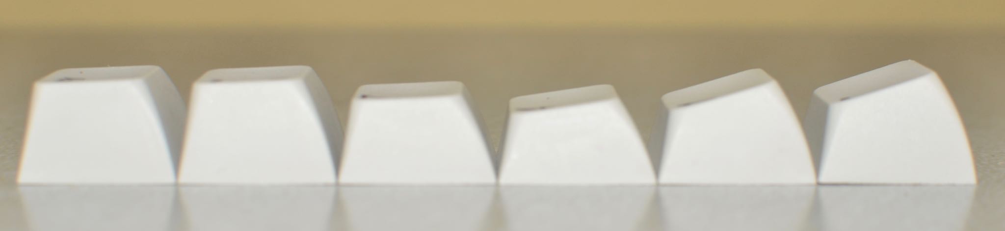

PBT spherical key cap profile detail.
Has anyone seen these before? Who could have made them? If only there were some way of bringing them back into production...

Amazing keycaps. No I have never seen ones like these. Tai-Hao? They look really nice on that KBParadise V80MTS, quite a find.
[ XMIT ]
16 Aug 2016, 17:32
Thanks! Oh, I forgot to mention: not just PBT, but thick PBT, not thin. These are pretty substantial key caps. These are the first profiled sphericals I've liked enough for daily driver use. DSA is great but not profiled, SA isn't as deep as I'd like, Topre HiPro has weird square-edged key tops that are not completely spherical, and the various vintage sphericals I have (Beam spring, Alps) are not on a keyboard with a usable layout.
These caps got a long bath in the ultrasonic cleaner before use. They are as clean as can be.
The V80MTS wasn't one of my favorite boards but with these key caps (and the odd fact that sphericals somehow make all switches feel lighter) I don't see this one leaving my desk for a while!

The caps have a really neat profile. Up until now, I thought they looked like uniform, albeit tall, sphericals.
