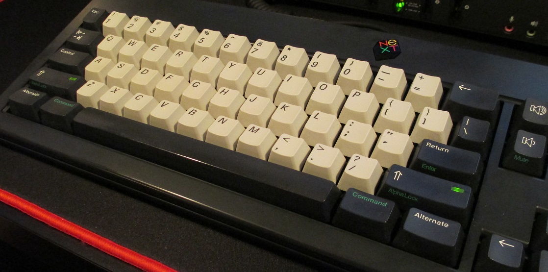

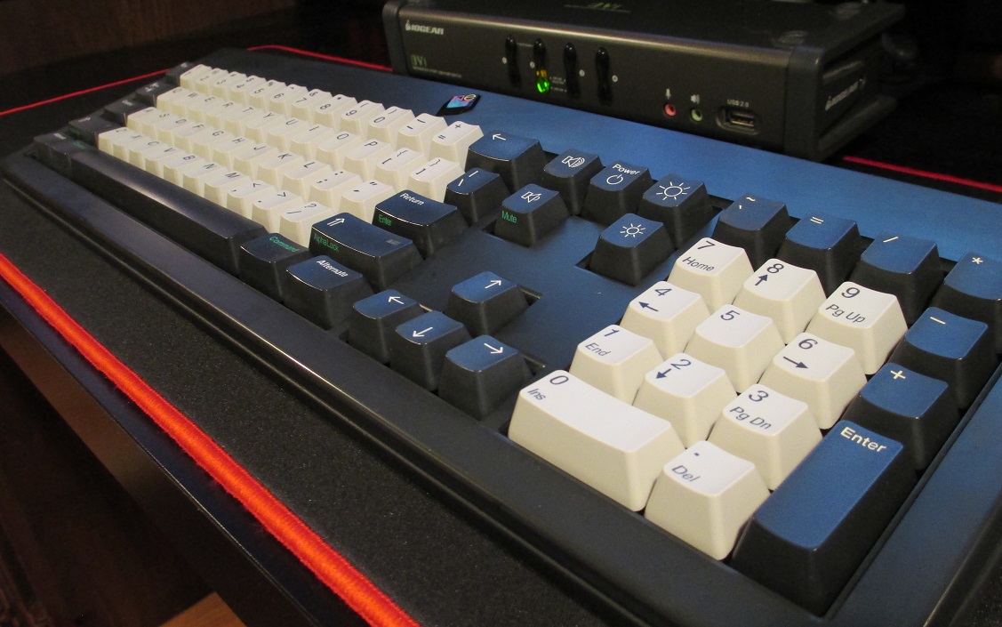

The NeXT keyboard has a pleasing form factor with a fairly standard full-size layout except for the absence of the F-key row and 5 media keys instead of the top 6 in the navigation island. The top row of the NumPad has a Backquote/Tilde key instead of NumLock, and the right column of the NumPad has 1.00x Minus and Plus keys along with a 2.00x Enter key. The bottom row of the main typing area is Winkeyless (of course!) with a 9.00x spacebar and no space between the 1.50x modifiers or between the modifiers and spacebar. The single Control key is to the right of the "A" key. There is no CapsLock key -- this function was otherwise activated on the NeXT keyboard and called "AlphaLock". The Shift keys are windowed and illuminated with LEDs when AlphaLock is on.

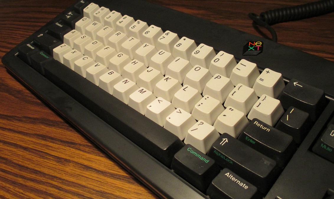

Although the NeXT keyboard is essentially full-size, it gives the impression of being compact. It measures 17.75 x 5.50 inches (45.1 x 14.0 cm) and weighs 2.67 lb (1.21 kg). This fairly hefty weight in a relatively compact package helps make the board feel dense and sturdily built. In comparison, my black Dell AT101W measures 18.5 x 8.25 inches (47.0 x 20.9 cm) and weighs 3.11 lb (1.41 kg).
The case is black and agreeably simple in design; the only branding is a small colorful NeXT cube logo centered on the top bezel. Unfortunately, the smooth finish of the keyboard readily picks up and shows fingerprints. Moreover, the black keycaps conspicuously display wear according to frequency of use, resulting in prominent uneven shine on a given cap that is inconsistent across the board. Because of the marked shine on the caps, especially on my US ANSI version, I swapped most of the modifiers for the less-worn caps on the L-shaped Return version. In addition, given that I usually prefer typing on PBT, I also swapped out the stock alphanumeric caps with those from a Granite SBI board.

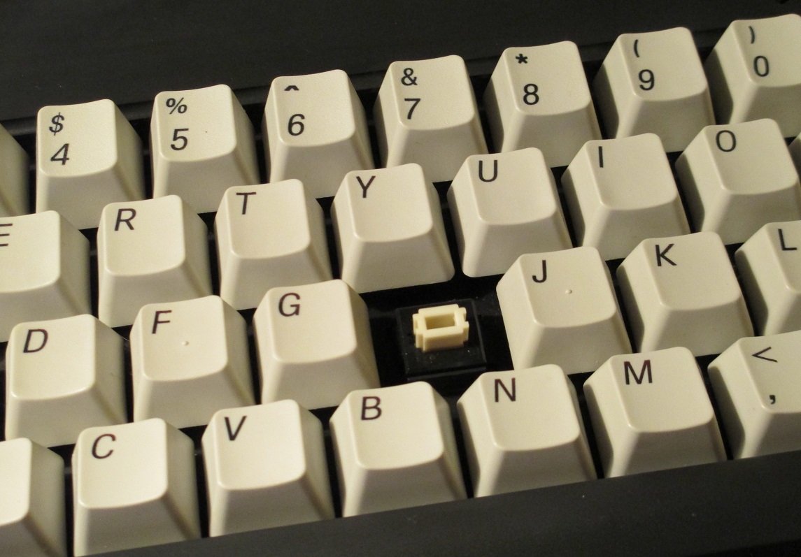

Typing sound and feel are good to excellent. The undamped cream Alps are not as crisp as blue or white Alps, but they are smooth and provide more than adequate tactile feedback without the somewhat mushy feel of damped switches. I bottom out all my keystrokes, and the NeXT chassis furnishes a fairly solid sounding board that is not as solid as my Northgate Omnikey 101 but not as hollow as my Leading Edge DC-2014. The feel is definitely lighter and more resilient than that of my custom 60% with tactile brown Alps in a stainless steel plate. Some of the keys exhibit pinging, but I do not find this sufficiently objectionable to be a deal-breaker.
The long spacebar was initially a bit loud and rattly, but after lubing the stabilizer and putting foam pads on the top plate directly under the stabilizer inserts, it became acceptably quiet. At first, I had considered swapping the slider with one from a Matias Quiet switch, but this no longer seems necessary.

BTW, although I am using the NeXT caps on the nav island, I have remapped these media keys to standard nav island keys: Insert/Delete, Home, and PageUp/PageDn. The old "Power" key is now a "Home" key. "End" is Fn + Home. Right Alt is Fn.
Note also that the Backquote/Tilde key on the NumPad becomes NumLock in the Fn layer and that CapsLock is Fn + Tab. I like the way the NeXT board lights up both Shift keys to show that CapsLock is activated.
