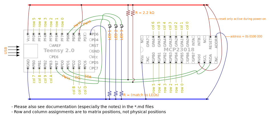

Sure it could work.
The I/O expander that the ErgoDox uses has 16 I/O lines on two 8-bit ports. The ErgoDox configures it to use one port for strobing and one port for sensing, thus a maximum of a 8×8 matrix but you don't have to do it that way. Each line is individually configurable either as an input or output so you could configure it a bit differently but then you would have to alter the firmware a bit more.
Here's a circuit diagram that I had found, but I forget who had made it. I don't think it is official... I don't see the capacitor on the I/O expander-side.

And what do I do with that capacitor? I have seen it described as optional, but other sites say that it's a good idea to include it. I am not entirely sure I have understood where it should be placed. And is there something else required other than connecting it in the right place? In the assembly instructions for the Massdrop ergodox, there is a connection between to pins on the expander that the instructions say should be shorted if the capacitor is used. Is that always the case?

A decoupling capacitor between the power and ground suppresses noise.
Some keyboards use a capacitor to debounce switches.
Other keyboards use firmware to debounce switches.
If the keyboard half has 24 keys or less, use shift registers.
If the keyboard half has more then 24 keys or has LEDs, use an I/O expander.
Here are some tutorials on connecting split keyboards:
https://github.com/wolfv6/keybrd/blob/m ... yboards.md
https://github.com/wolfv6/keybrd/blob/m ... gisters.md
https://github.com/wolfv6/keybrd/blob/m ... ith_IOE.md

MCP23017 and MCP23S17 are push-pull.
MCP23018 and MCP23S18 are open drain.
MCP23017 and MCP23018 are I2C.
MCP23S17 and MCP23S18 are SPI.
I2C is fast enough for scanning up to 5 rows.
The keybrd_DH (DodoHand) sketch polls 5 rows over I2C at 7.5ms per keyboard scan.
I2C speed is limited by the I/O expander and length of wire (not the controller's speed).
SPI is much faster, but requires 2 additional wires.
I would use SPI if the I/O expander scans more then 5 rows.
