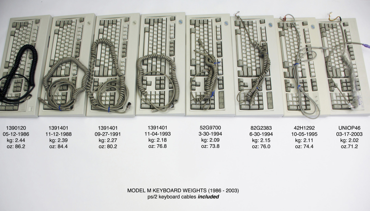

Some additional observations
Model M keyboard weights (1986 - 2003) http://www.clickeykeyboards.com/model-m ... 1986-2003/

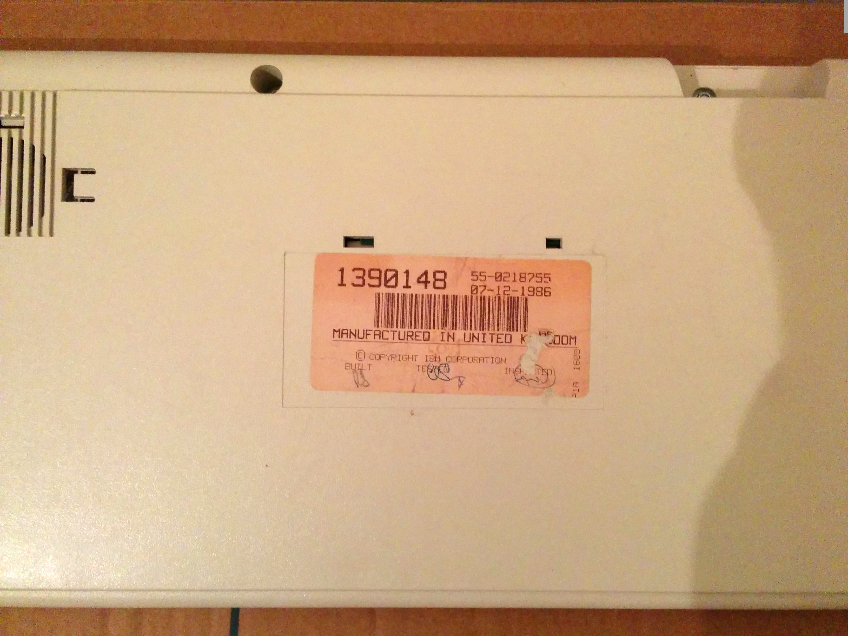

Good question that's been answered now. I recently got a 1390148 from 1986 but I doubt there is any difference in build quality to my 1390133, I'll have to check.

Great! thanks!clickykeyboards wrote: Some additional observations

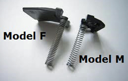

A visual inspection of M and F springs shows them to be pretty similar (XT vs '1401 from '92). Same length, same radius of coil, same number of turns. There may be material differences though.
- fohat
- Elder Messenger
- DT Pro Member: 0158
Here is the photo that I took:
- IBM-M-F-spring-hammer.jpg (64.32 KiB) Viewed 8344 times

Model M springs have less coils and as a result are more stiff; that's a scientific fact. The more coils you have in a spring the easier it is to compress. The whole reason why Model Fs feel so different is the fact that the rubber mat is gone and the springs have more coils...emdude wrote: Is this true? This GH thread says that if you switched springs on an Model F flipper, the difference in feel between Model M and F springs is not significant enough to be noticeable.

Fohat's picture may just be due to the way they're positioned or something else, but the springs would have to be the same height as F and M share the same dimensions and all of my F and M springs are the same in height. I've compared all generations of Model M springs and they remain consistent with the amount of coils and length:
(left to right: early IBM, '90 Lexmark, '14 Unicomp)
From what I'm told, all variations of the Model F flippies are the same in height:
Proof my F flippies are the same height as the unicomp M flippies:
The Model M springs have less coils presumably due to the fact they need to be more stiff when pressing on the rubber mat and membrane.
