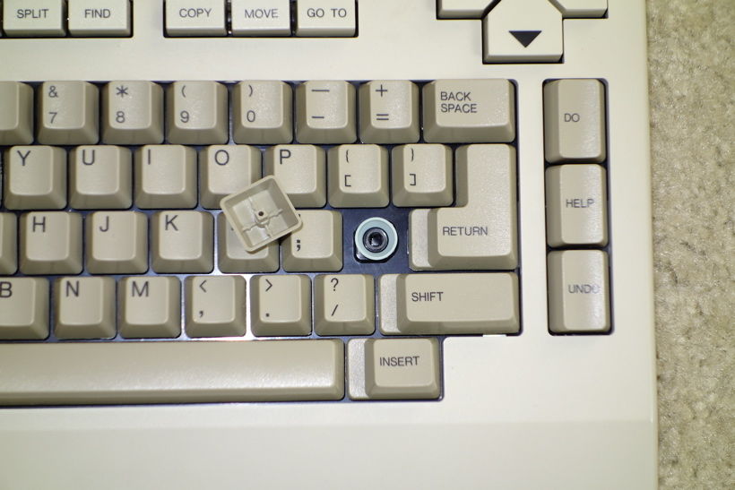

BTW, here's an example of a Videowriter keyboard that externally looks like a brown Alps 250 model, but it actually has inverted rubber domes and the caps are not doubleshots:

Hypersphere: That's devilish! I was sure the layout was a dead giveaway of brown Alps. Any other markings we could use? Any differences in stepped keys? Logo?
Hypersphere
19 Oct 2016, 15:40
I'm not aware of any external clues giving away the domes that lurk beneath. As I said before, I found out the hard way by purchasing a Videowriter 250 keyboard that looked like a brown Alps board only to discover that it had rubber domes. There might be some tell-tale information on the back label, but I do not recall.

Sorry about necroposting, but I just fell into the same trap, having bought a VideoWriter 250 board which turned out to have rubber domes. From looking at pictures of several with ALPS switches, the logo on them says 'Magnavox' under 'Videowriter', whereas my rubber dome one hasthe model number 250 there instead of 'Magnavox'.
Also, the caps on mine are clearly pad-printed whereas the ALPS appear to be doubleshot, which might help if you have really good photos to look at...
