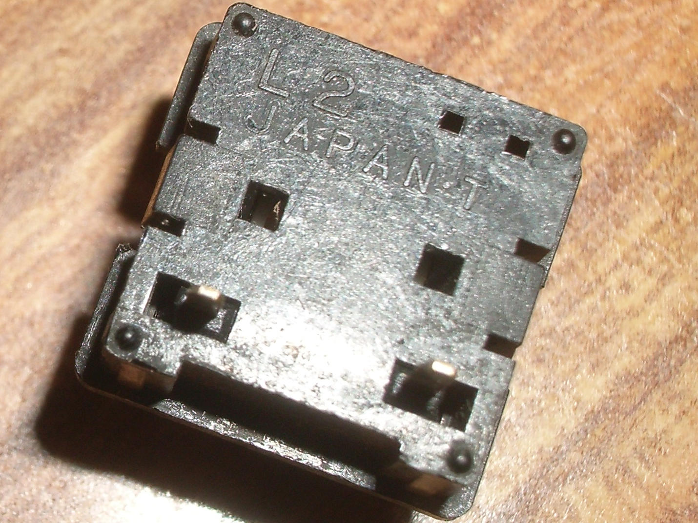

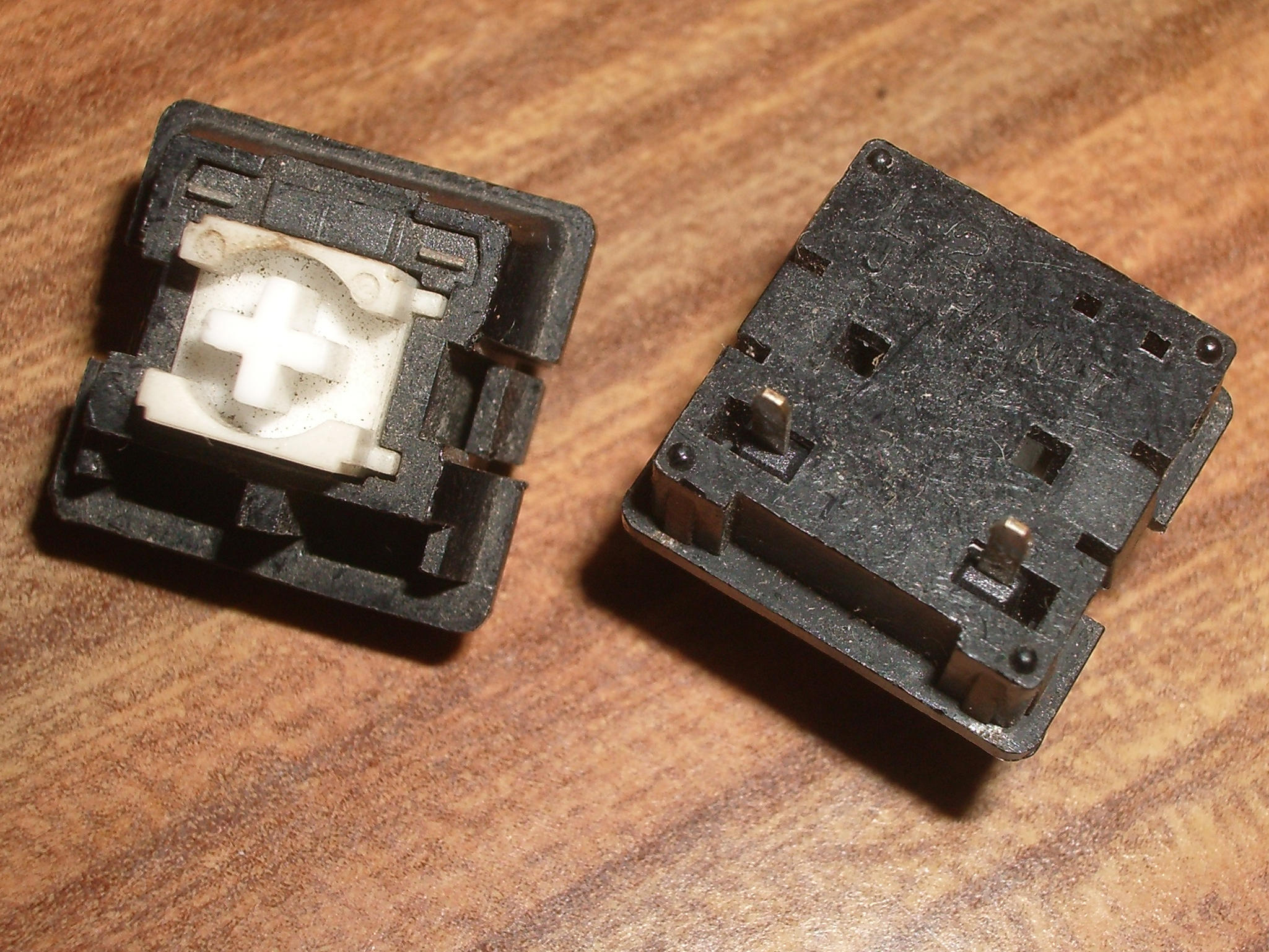

12 Dec 2017, 23:10
Supposedly, these are from a Japanese company. I wasn't confident that this was true.
However, today, as part of a package of filthy and sometimes broken switches from China, I got some of these switches, but a different variant. These are still not branded, but they are indeed marked "JAPAN":
Katano Japan.jpg (538.38 KiB) Viewed 20284 times

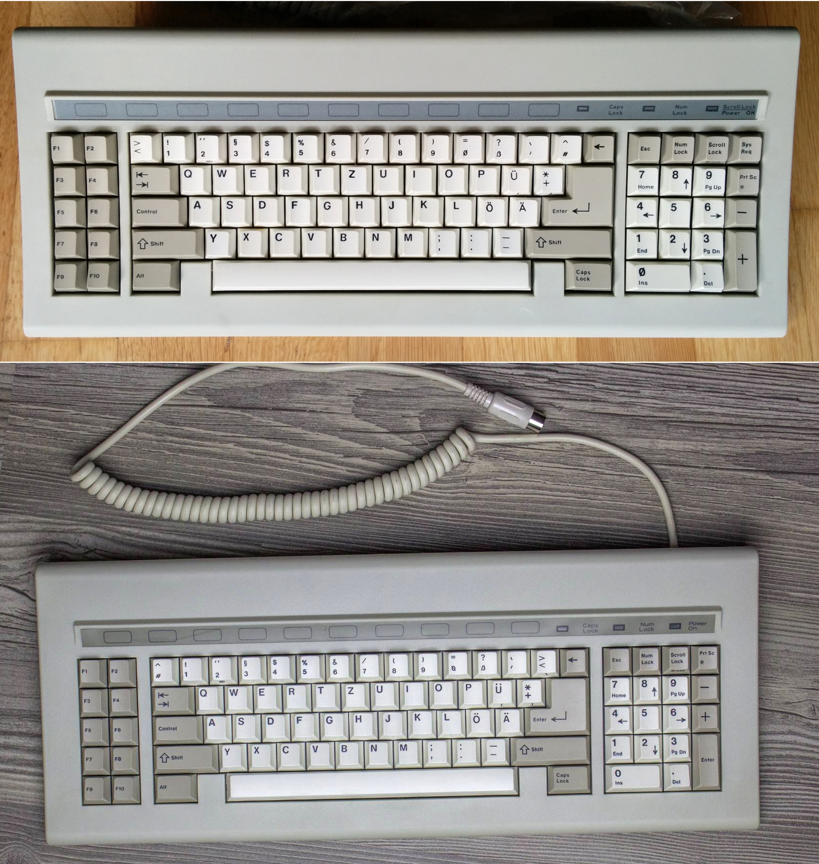

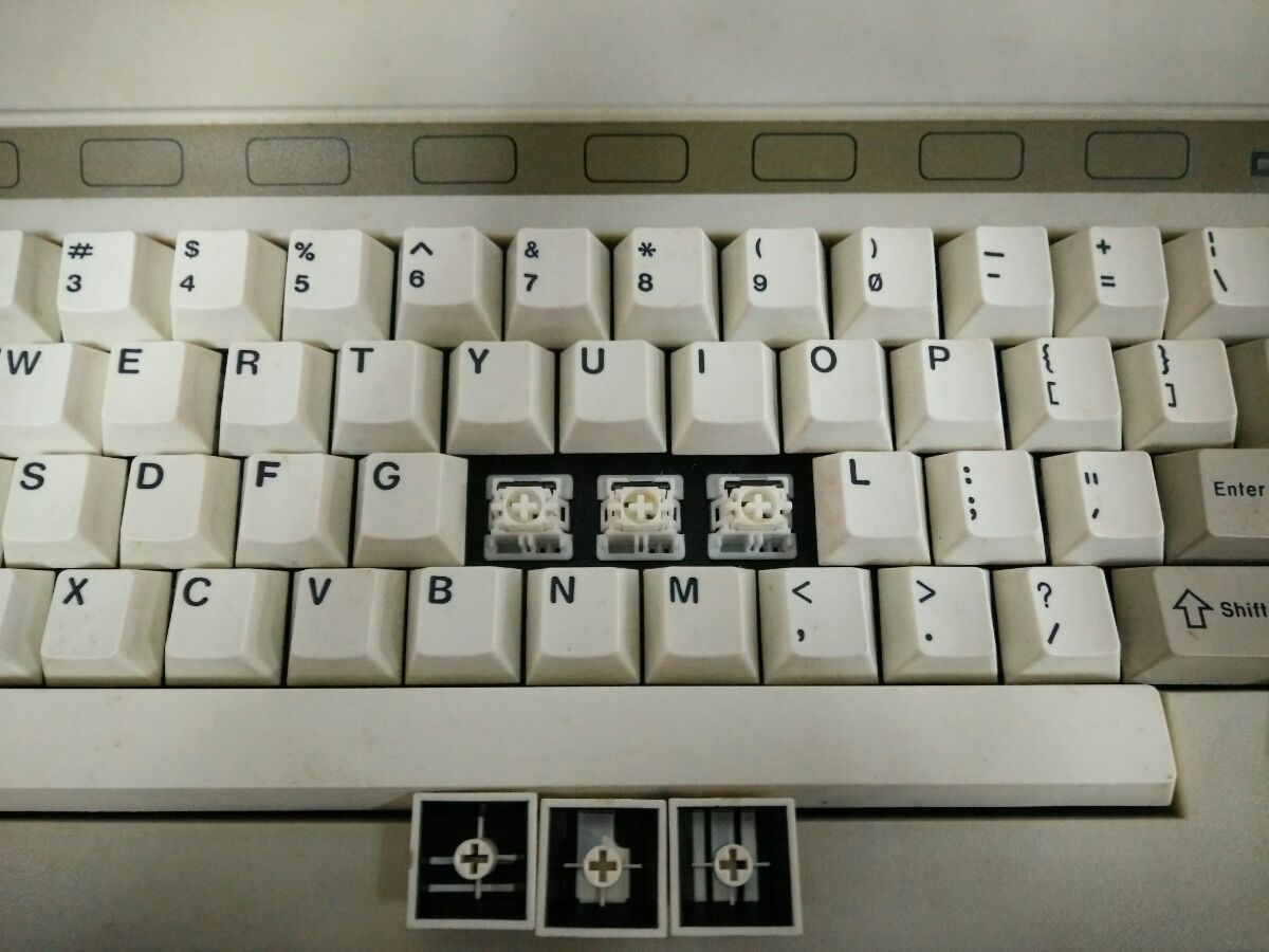

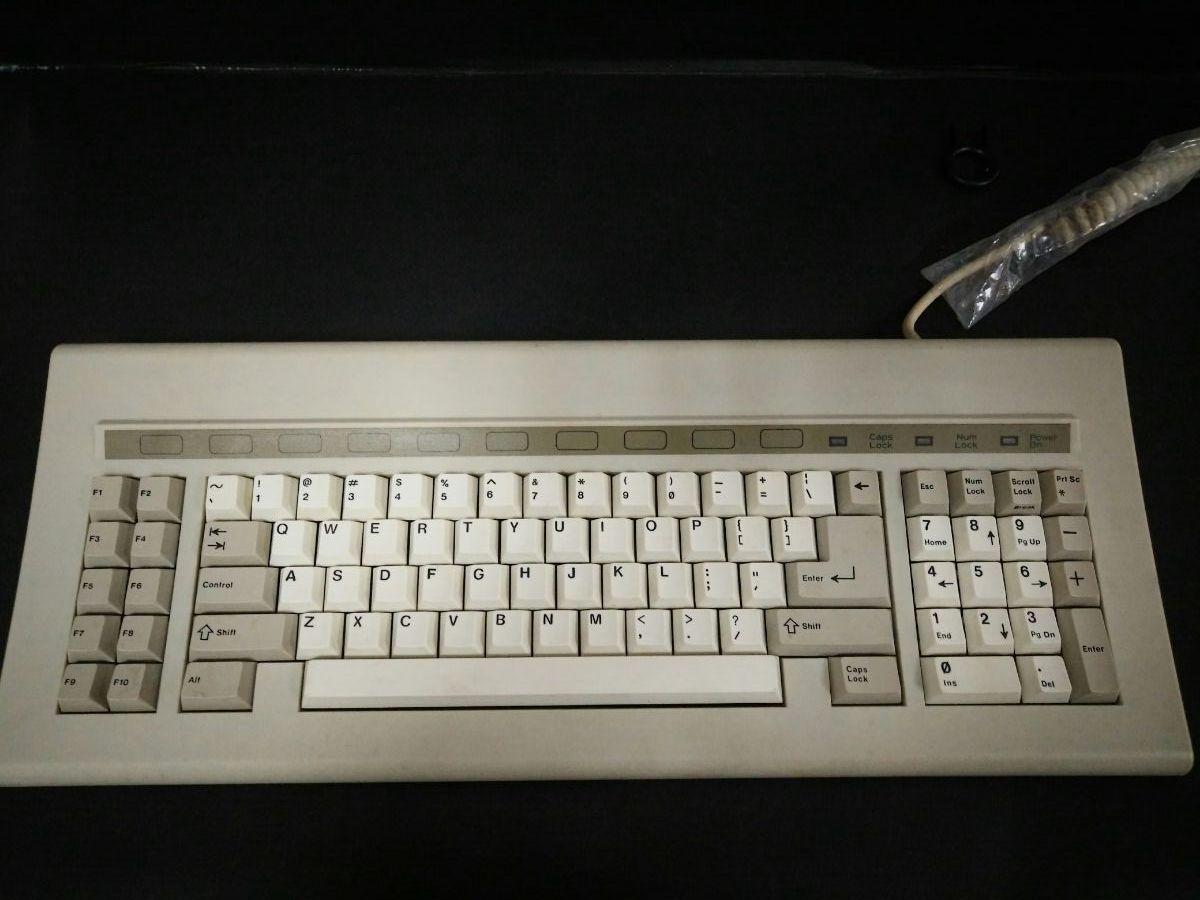

Jan Pospisil
07 Nov 2020, 21:08
Sorry to necro, but I ran across this Katano switch in another keyboard - what looks like a LogoStar rebranded Chicony kb-5161.
Unfortunately I did not win the bloody auction, but I will try to contact the winner through the seller, to see if I could perhaps buy one of them, or get some more photos:
Dr.Medic
07 Nov 2020, 23:19
Jan Pospisil wrote: 07 Nov 2020, 21:08 Sorry to necro, but I ran across this Katano switch in another keyboard - what looks like a LogoStar rebranded Chicony kb-5161.
Oh, hey! I was bidding not that auction as well... and I have won... one... but not these.
https://aukro.cz/klavesnica-xt-at-2-6976945809
It's the
K-450 I have realized it, just now.
Good luck.
Jan Pospisil
07 Nov 2020, 23:53
Dr.Medic wrote: 07 Nov 2020, 23:19 Oh, hey! I was bidding not that auction as well... and I have won... one... but not these.
It's the
Good luck.
Ha, I identified that one early and did not bid on it. That's a decent final price, if only for the caps. Or maybe you'll like the switches too, who knows.
