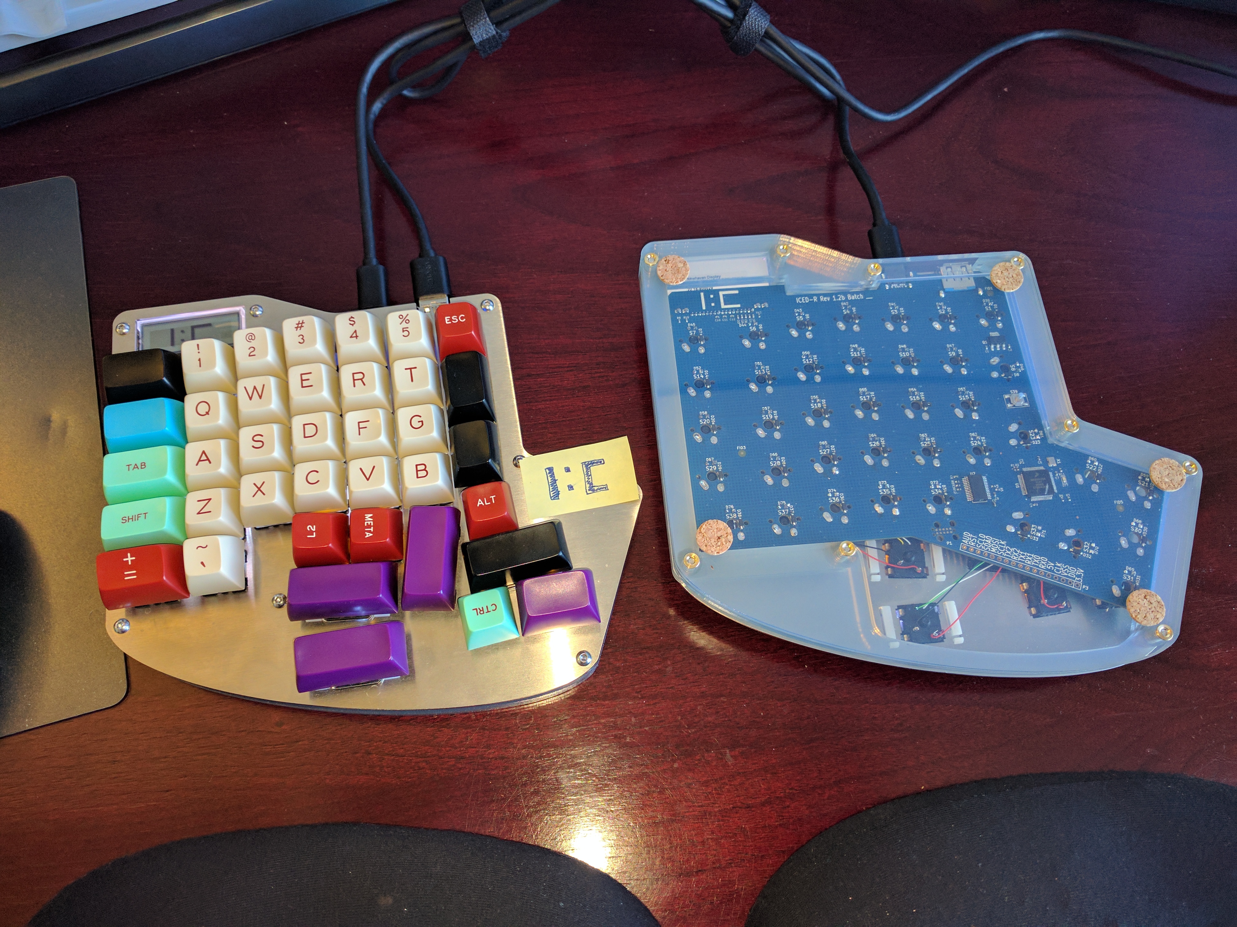

This is my second iteration at modifying an Infinity-Ergodox kit to provide me a thumb cluster, better to my comfort and liking. There are 8 buttons for each thumb cluster.
  • The vertical 2U button (SA Row 3) under the 'B' and 'N' keys is my thumb neutral position.
  • The three to the inside are hit with the thumb slightly tucked under the palm. Notice the use of the Row 1 and Row 2 SA profile keys, which, to me, has a better feel than the all Row 3 keys that I first tried.
  • The three black keys (SA Row 2) and the far green 1.5U key (SA Row 1) outside the neutral key are hit with the thumb extended comfortably (for me) outwards.
  • The bottom black key can be easily chorded (pressed together with) either the middle black key or the outside green key. This gives me a Ctrl-Layer combination with just a single thumb press.
  • The bottom, central button is a palm button that I map to the GUI key.
  • Additionally, I hit the bottom, outside column key with the upper, pinky side palm. Notice that this is an SA Row 4 key, turned around to match the palm angle.
You can see the blank expanse of stainless steal where the original thumb cluster of the kit was positioned. I found this an uncomfortable stretch. The inner thumb cluster keys were taken from the bottom row of the kit, which I also found inconvenient to use.

Here is the first iteration:

ErgoHack
02 Nov 2016, 16:30
Custom switchplate, Infinity-Ergodox PCB, with the moved switches 'hand-wired?' and threaded back to the PCB.

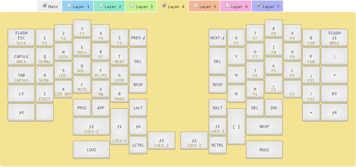

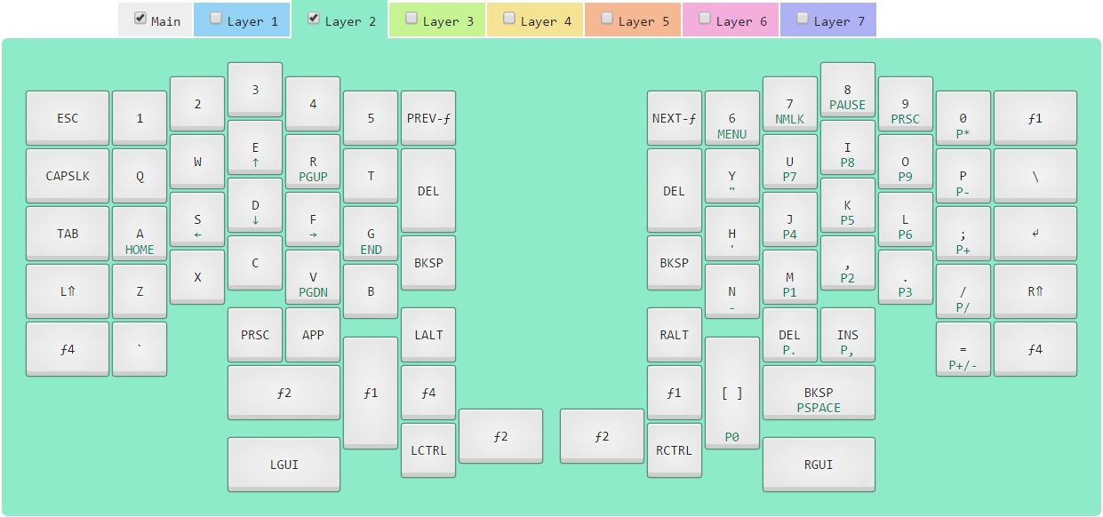

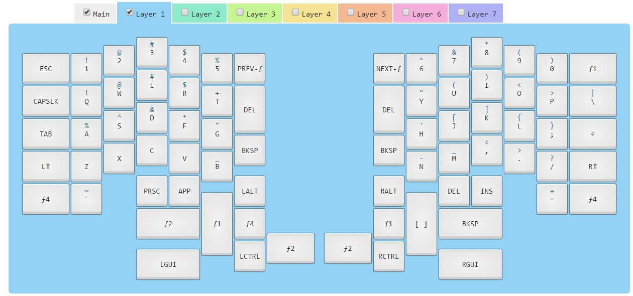

Here are the key mappings, and underlying JSON file, for this build:
Layers 0 and 1
Layers 0 and 1
Layers 0 and 2
Layers 0 and 2
Layers 0, 4, and 7
Layers 0, 4, and 7
Here is a link to the JSON file that can be used to bootstrap the keymappings and layout with the on-line configuration tool at input.club
https://github.com/john-r0/ErgoHack/blo ... hack3.json
https://input.club/configurator-ergodox/

ErgoHack
16 Mar 2017, 01:08
(sorry for the outage)
The custom plate was easy. I use lasergist.com and found them cheaper, quicker, and easier to work with than the metal fabrication shops in my metropolitan area.
I get my prototype 3 and 4 case custom cut through ponoko.com. The quality is good, quickness is good, but I wish the price were better. I might do more shopping for the plate and the case if I start building these for others. For now, I have been finding appreciative homes for my previous prototypes amongst extended family members who are either gamers or programmers.
With my third, and upcoming fourth prototypes, I have used fasteners and cork feet from McMaster-Carr (https://www.mcmaster.com/). They have a huge selection of kit. I'll post a picture shortly.
I have started posting the plate and case cut files at https://github.com/john-r0/ErgoHack , as these are open source derivatives.
And lastly, once my key positional tweaks have stabilized (I'm almost done, maybe prototype 4 will be 'it'), I do plan to edit the Infinity-Ergodox PCB. In addition to aligning the keys with the plate, I want to move the LCD display above the thumb cluster, where it will be visible. Currently, my SA row 1 keys hide the display from much of my view.
