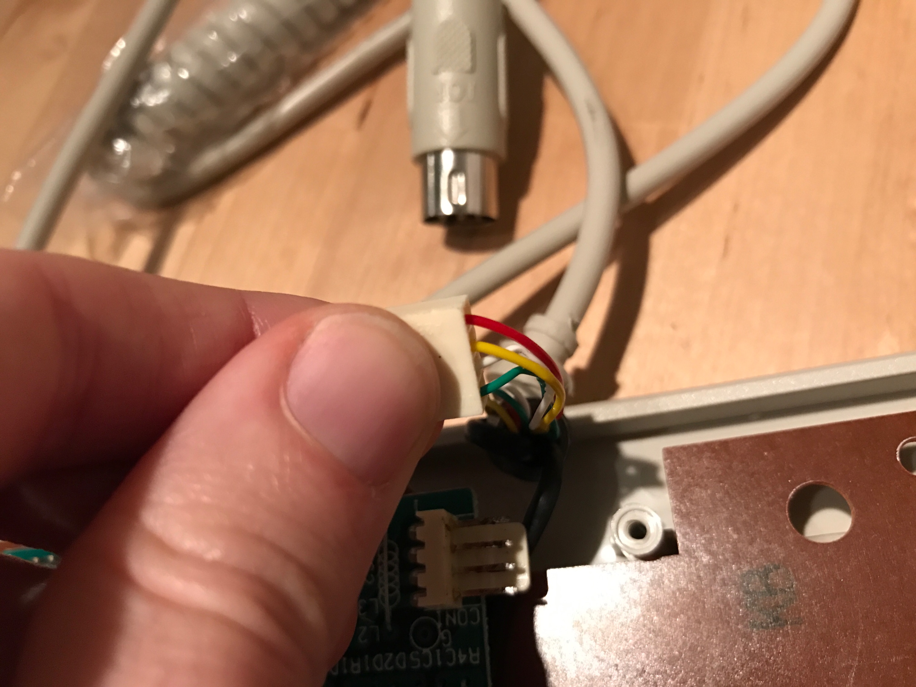

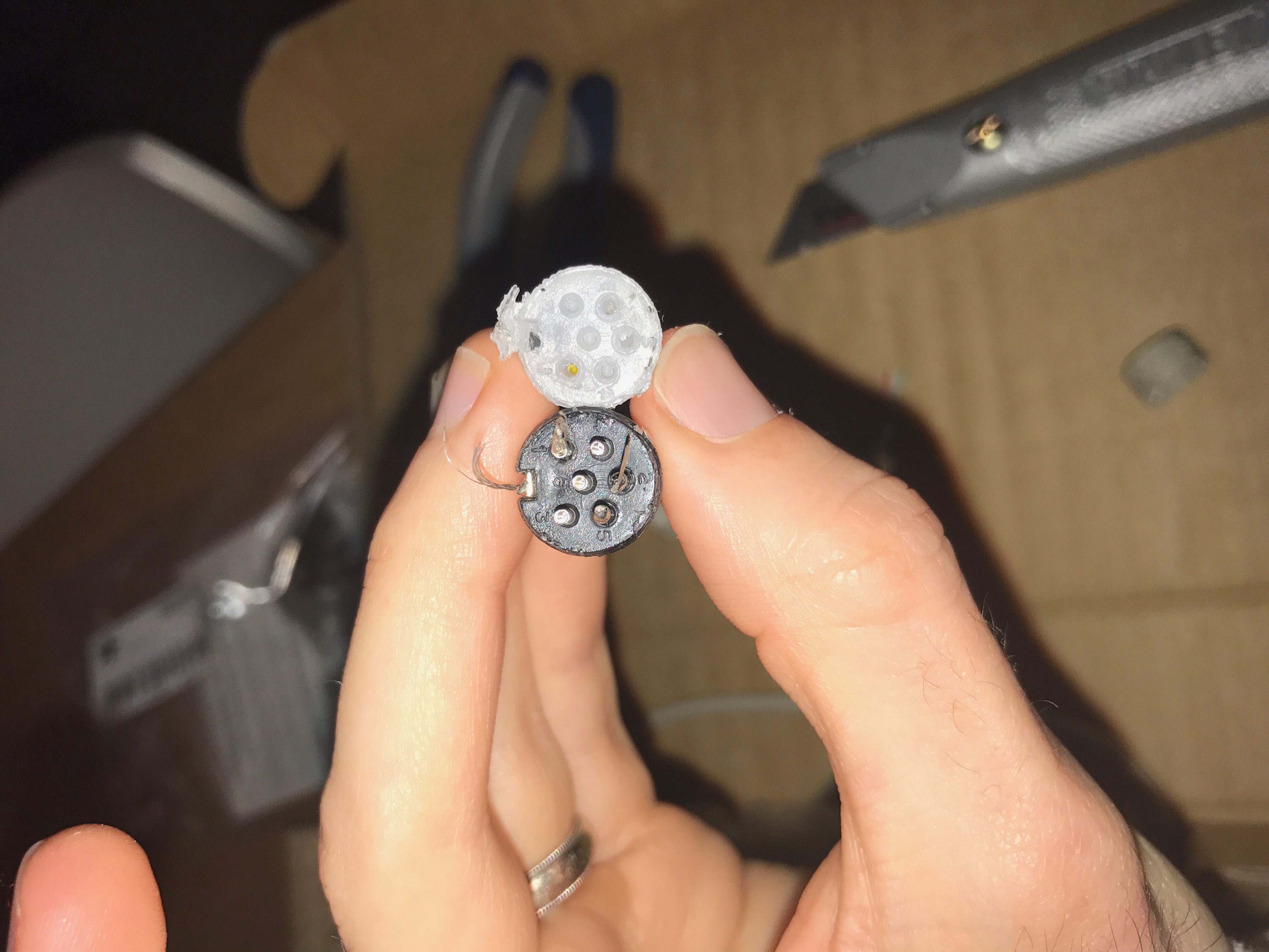

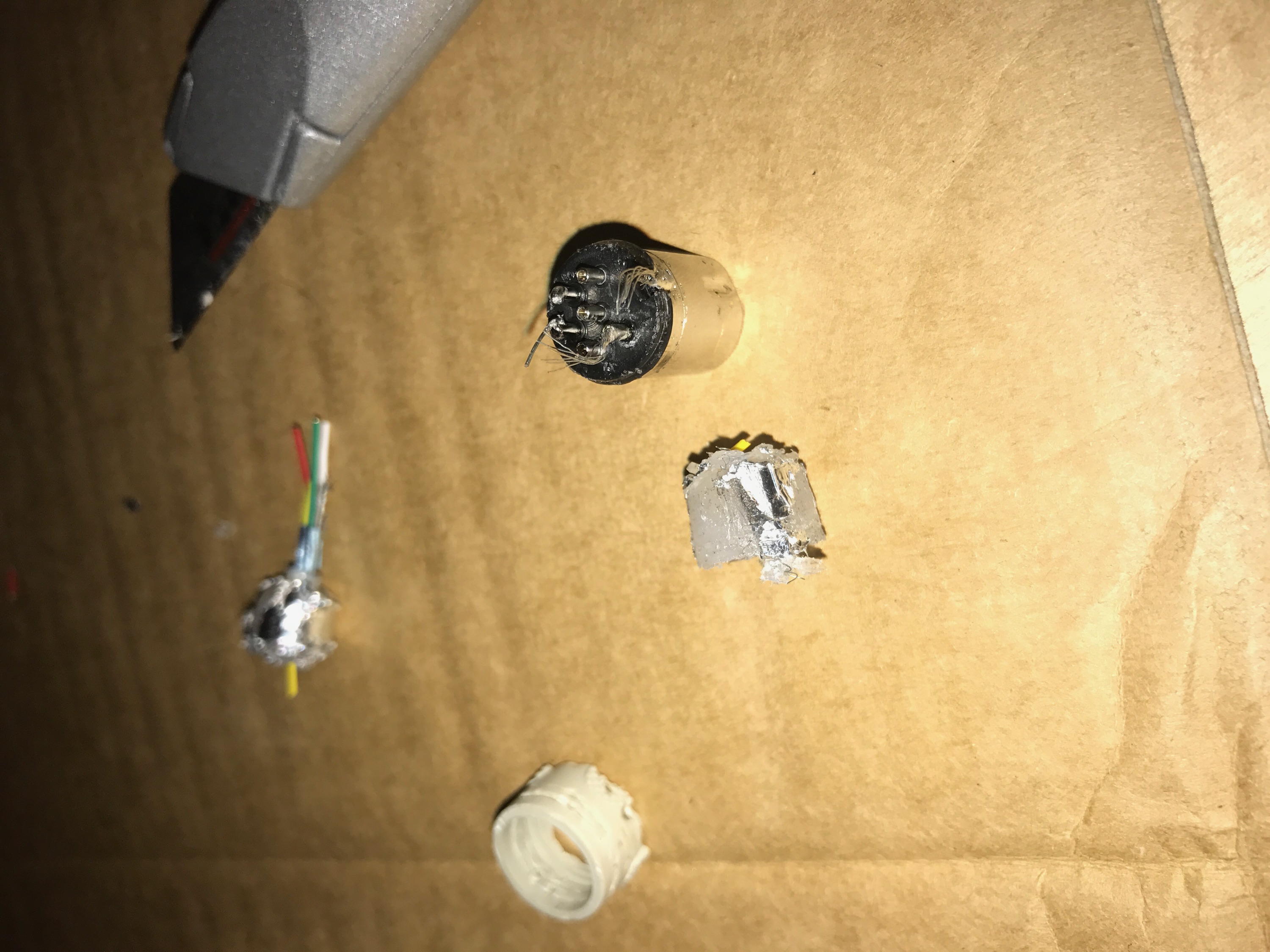

Went ahead and opened the 6-pin connector myself. The connector was filled with glue, so seeing which wires connected to which pins was impossible. Pulling off the rubber glue tore all the wires off the leads. It appears the connector does not follow the pin layout shown in the Amstrad PC1512 diagram previously mentioned.
Is there a way to identify the pins from the keyboard PCB using a multimeter? I'm not that handy or experienced, but it seems like it would be possible. I can borrow a multimeter from a friend tonight if someone wants to fill me in on how to properly identify the pins using it.
Wire order on cable connector, left to right: Green, White, Yellow, Red.

Opened 6-pin connector with nasty glue.
Close up. Does not follow Amstrad PC1512 pin layout.
