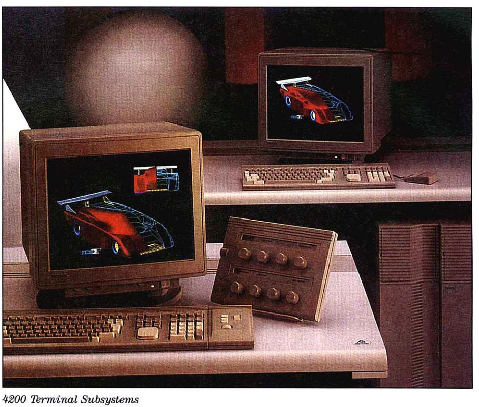

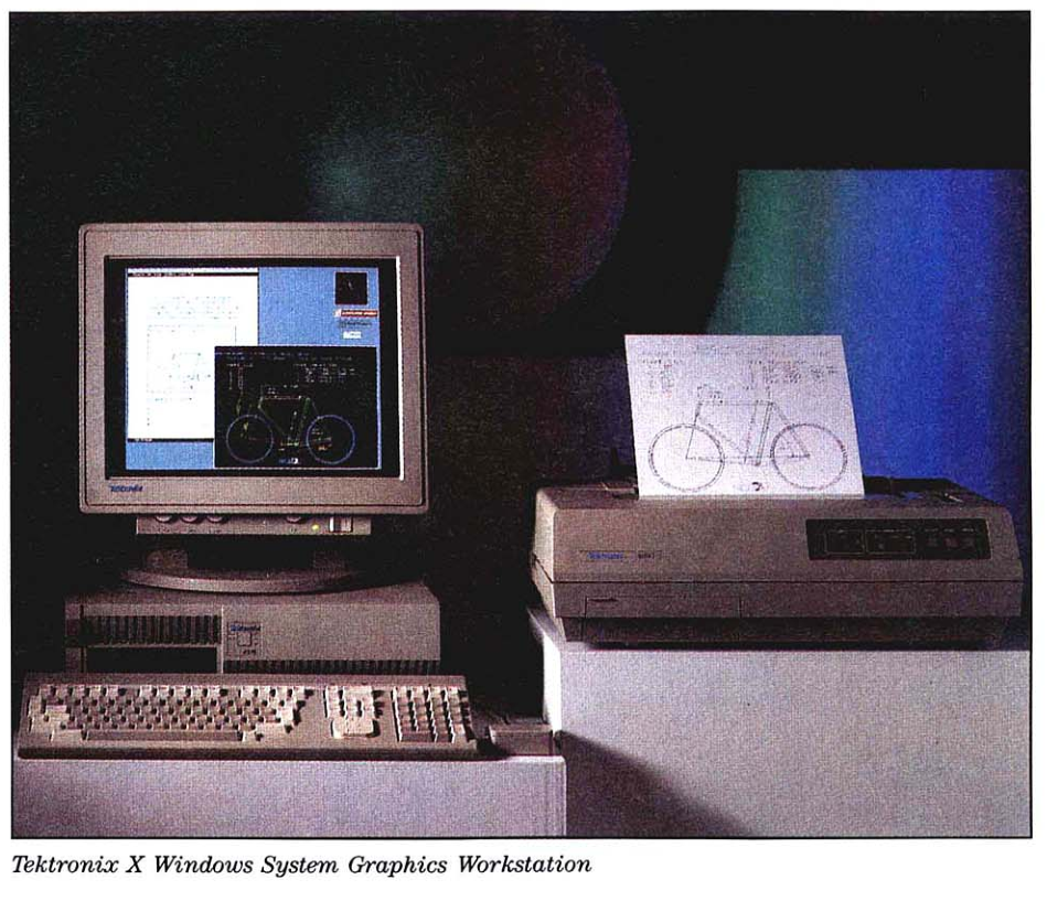

Small update on your Tektronix keyboard here Menuhin, looks like it may belong to a 4211 Tektronix terminal and was also used with other products:
http://terminals-wiki.org/wiki/index.php/Tektronix_4211
There is also link to a 318MB 576 page PDF Tektronix catalog form 1989 there that include these pictures:

Right. I actually downloaded the PDF somewhere and made snapshots for all the photos that I posted here about Tektronix's CAD workstations and terminals and some of its keyboards. Because almost no one has written about Tektronix's discontinued computing systems and its keyboards, and Tektronix is now known for mostly just its oscilloscopes and engineering measurement products.
