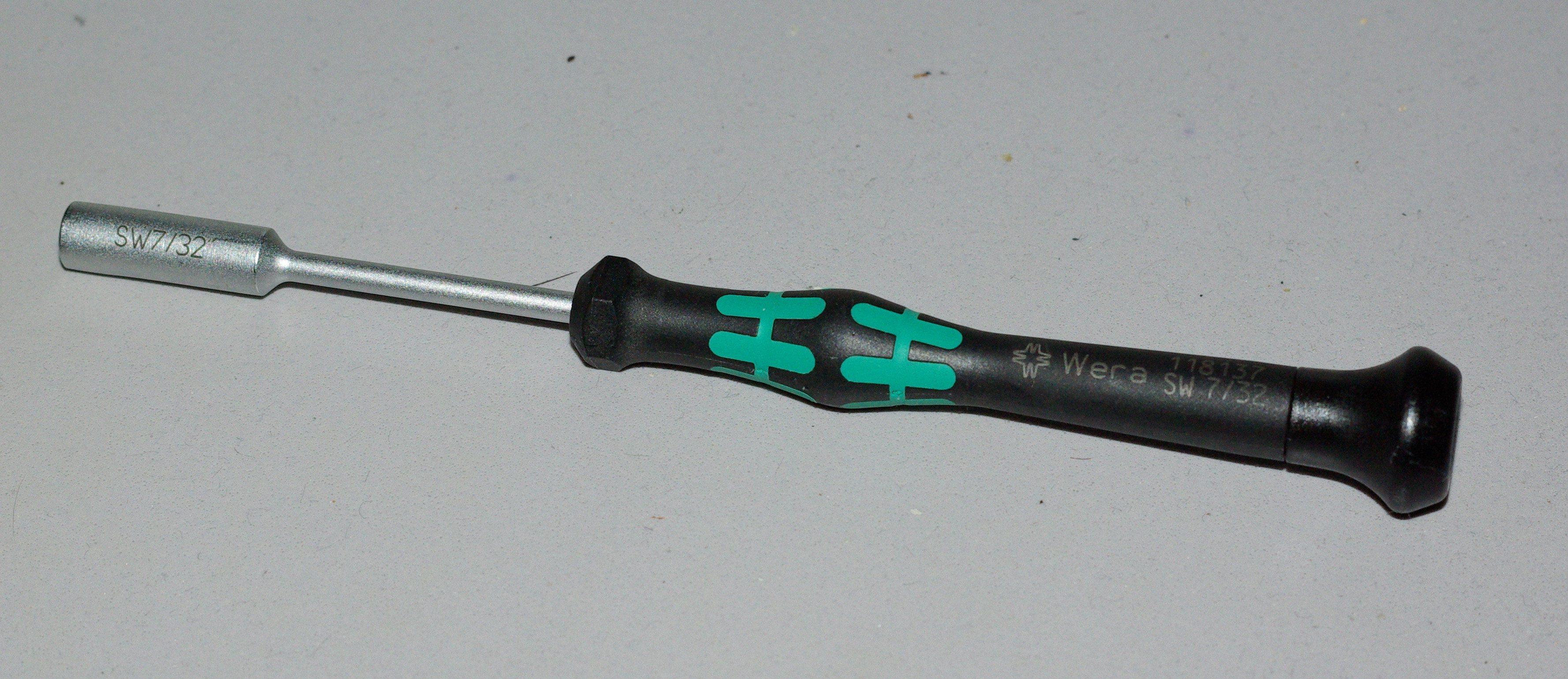

If you don't have that kind of socket, and until you acquire it, you can try and shake the keyboard, or rotate it. If you hear some rattling sound moving in the case, those are probably broken-off rivets.

This is Reagan-era US gear, 7/32" is official and 5.5mm is extremely close. Just make sure that it is "long" and "thin-walled".

Yes, it should look something like this. I remember someone here improvising one by melting a piece of plastic, I would not recomend that.

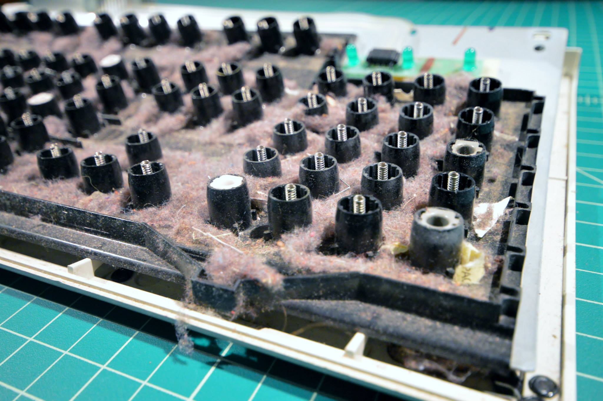

Note, while shaking the model M keyboard might be an indication of broken plastic rivets, remember that many model M keyboards were used for years in real-world production environments in office and industrial settings and any number of "things" may have fallen inside the keyboard.
We regularly find paper clips, staples, binder clips, sewing needles, wire ties, screws, springs, bits of cut wire.. in addition to the dust, hair, paper confetti, nail clippings and Doritos snack chips that fall into "well-loved" keyboards.
We have a found a good industrial ShopVac with a HEPA filter to be indispensable in the first steps to restoring model M keyboards.
- raw, unrestored model M keyboard internals with dust

All of that lint and chow is actually a 'feature' to act as dampening instead of O-rings

The M I bolt-modded was basically up to the edge of its barrels in board chow and had half a dozen dead spiders and flies in it. That was a fun project, though.
