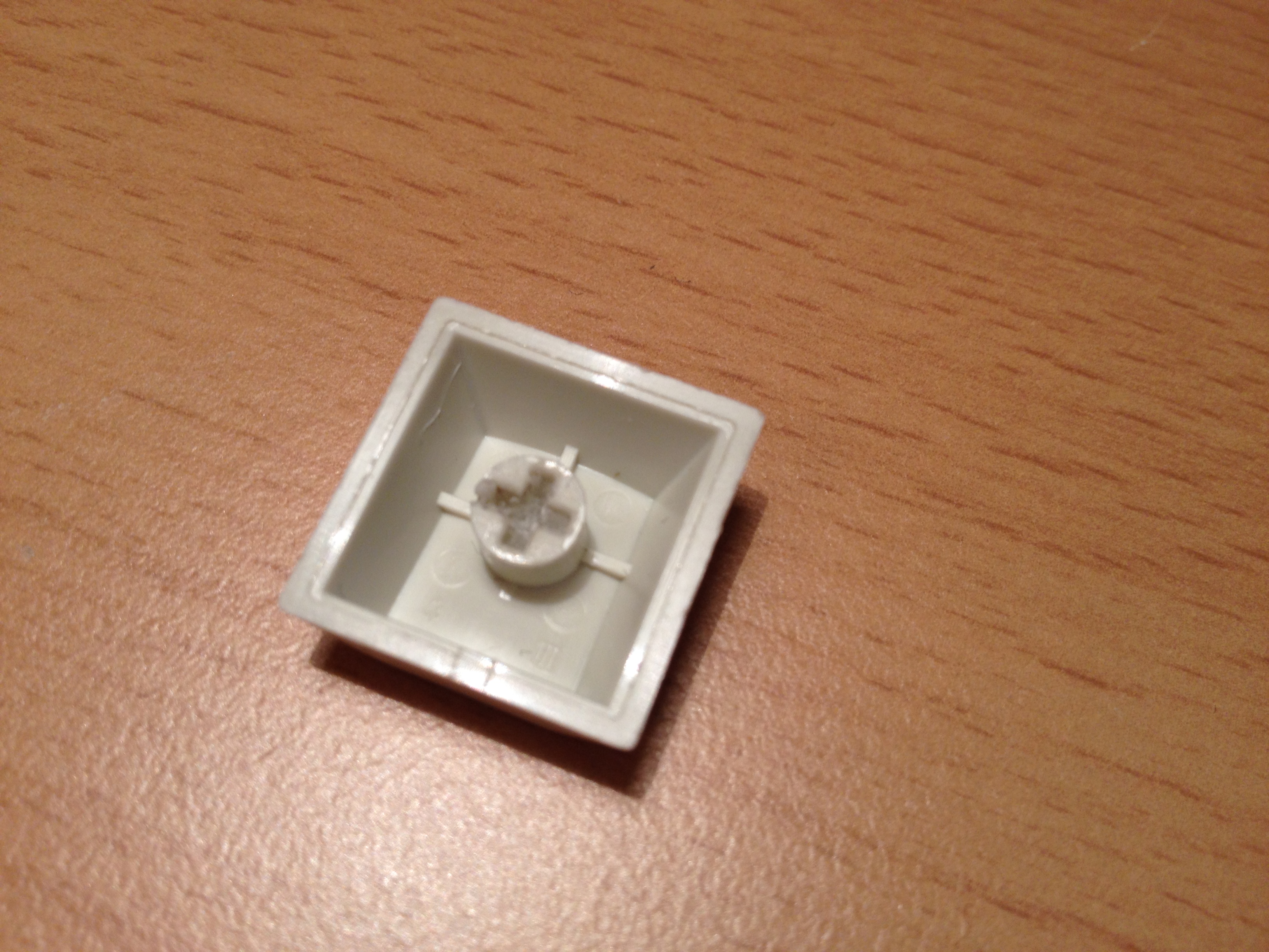

Hello everyone,
I broke off the stem on a Cherry MY switch when removing the keycap, now parts of the stem are still stuck in the keycap.
I can't get them out. I already tried it with a needle, but I just can't make it work.
Maybe a small drill, like a Dremel could fix it, but I don't own one.
Is someone able to fix this keycap?
- IMG_0252.JPG (1.98 MiB) Viewed 6238 times

You can heat up a needle which has a very small hook in the tip. Heat up the needle with a soldering iron and stick it in the plastic. I have never done it with a keycap but with a plastic screw before which was too small to be drilled out. Note you shouldn't hold the hot needle with your bare fingers.

I've done that several times with a dremel and a tiny drill and obtained rather good results,
although on one occasion I was too self-assured and seeing the procedure as a kind of routine,
I completely ruined a rare cap by pushing the drill completely through it
The other solutions I tried (needle, screw extractor) always completely failed,
obviously too much force is needed to overcome the friction which secures the cap on the switch stem.
Another solution, of course, could be simply replacing the cap with an intact one
Yours looks like thick PBT, so my guess would be Cherry dye-sub, probably "Shift" row.
I have a donor SAD which has already been put to good use,
but perhaps your missing cap is still there

I've had something like this happend to me before, also drilled it out with a very thin drill on a dremel.
Just drill out the center, then try pulling the four side-pieces out with a little hook.

I just tried it with a dental pick and failed.
Drilling it out with a dremel is the only solution left I guess.
The keycap is an OG Cherry PBT dyesub "Ä" in excellent condition.
I'd rather save the cap, since it's in such good condition and a replacement cap probably wouldn't have the exact matching color.
Is one of you confident enough to do it for me? (I'd pay for it)

Did you let the needle cool before you pulled on it?
I'm not 100% sure, but I think I have seen someone do this before with a tool that looked like a corkscrew but more slender.
Or maybe it was used to get the keycap part out of an Alps slider ... which is a bit fatter. I don't quite remember.
Anyway. I don't think you would be able to dremel it without having to replace the stem completely. There aren't that many dremel bits that are small enough to get into there ...
BTW, I have a spare lasered thick PBT 'Ä' key if you'd want it. But if you are just going to use the stem off then I'd rather send you a numpad key instead.

A replacement OG Cherry PBT dyesub "Ä" is certainly worth a try,Geroximo wrote: I just tried it with a dental pick and failed.
If not, I'll finally buy myself a dremel.
and dremelling yours will still be a solution if it doesn't match.
I still have your address and can send you the replacement cap.
