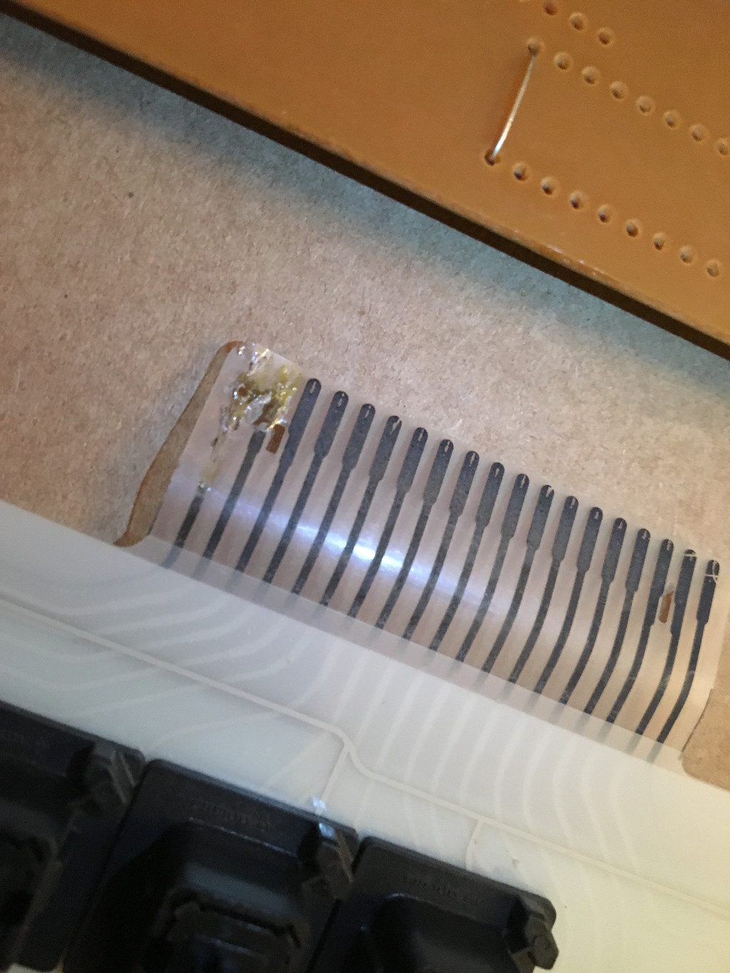

Perhaps that could be repaired, using a "Circuit repair pen", conductive ink or some kind of metal tape. I once managed to bridge a circuit on a membrane using "Bare Metal" foil for model kits - I was surprised to find that it was conductive even on the glue-side. If you have any conductive glue (for heat sinks etc.) then maybe that might also work.

Findecanor wrote: Perhaps that could be repaired, using a "Circuit repair pen", conductive ink or some kind of metal tape. I once managed to bridge a circuit on a membrane using "Bare Metal" foil for model kits - I was surprised to find that it was conductive even on the glue-side. If you have any conductive glue (for heat sinks etc.) then maybe that might also work.
It's hard to see on the picture, but It there are holes where the traces have been ... and the plastic looks molten. No idea how that happened really. At first I thought that I fucked up by not loosening contacts from the controller board, but now I think that this might have been a short of some sort ... but now I'm unsure if there's even enough current there for that to happen.
So I would be hesitant to fix this, just in case it "catches fire" later on.
