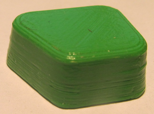

I printed few keycaps with FDM. They are not very pretty but they are well usable. You can improve their look quite bit if you sand them a paint with acetone (for ABS) or tetrahydrofuran (for PLA). Here is an example non-standard keycap which was not sanded. It was only painted with acetone:
Nothing special but one can get a strangely shaped keycaps for experiments in about 15-30 minutes (not including design time only the printing and post-processing). The FDM keycaps can look much better if you use 0.1 mm (or smaller) layer height and Ø 0.35 mm nozzle and slow print speed. The example picture was Ø 0.5 nozzle and 0.2 mm layer height. The print speed was slowed down so that one layer takes 15 seconds. Sanding before painting helps quite a bit too.
