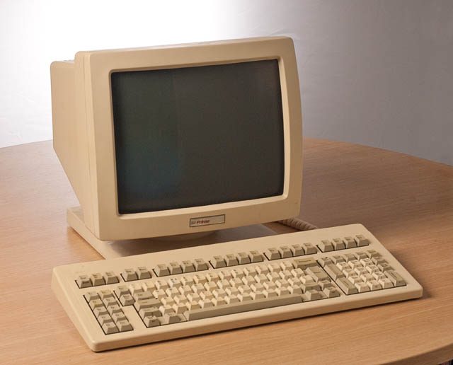

That keyboard of yours looks like it may have been part of a Prime PT250 terminal:

seebart wrote: That keyboard of yours looks like it may have been part of a Prime PT250 terminal:
First time seeing that photo, Looks like they used the same keyboard with a couple of their computers.
