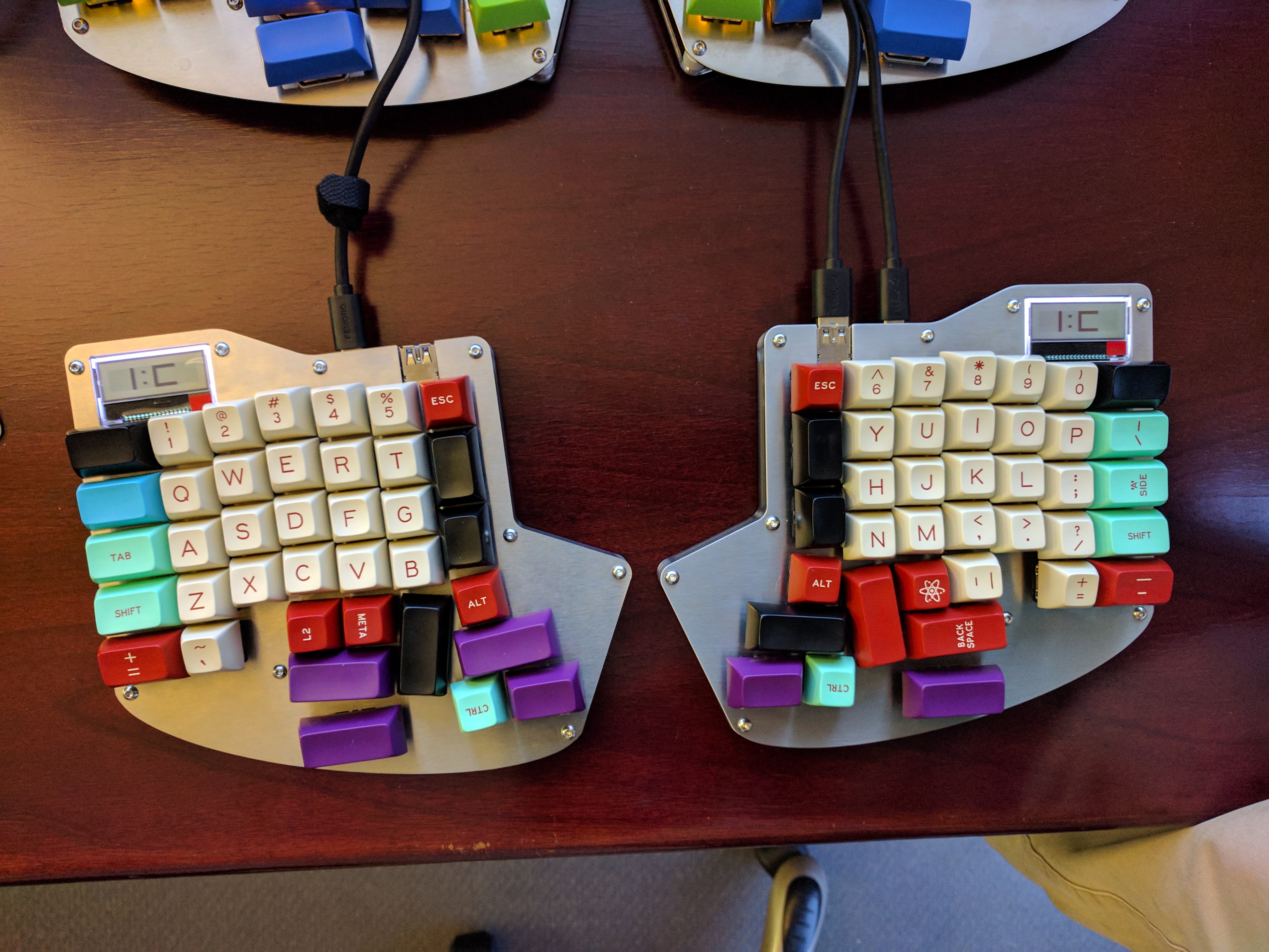

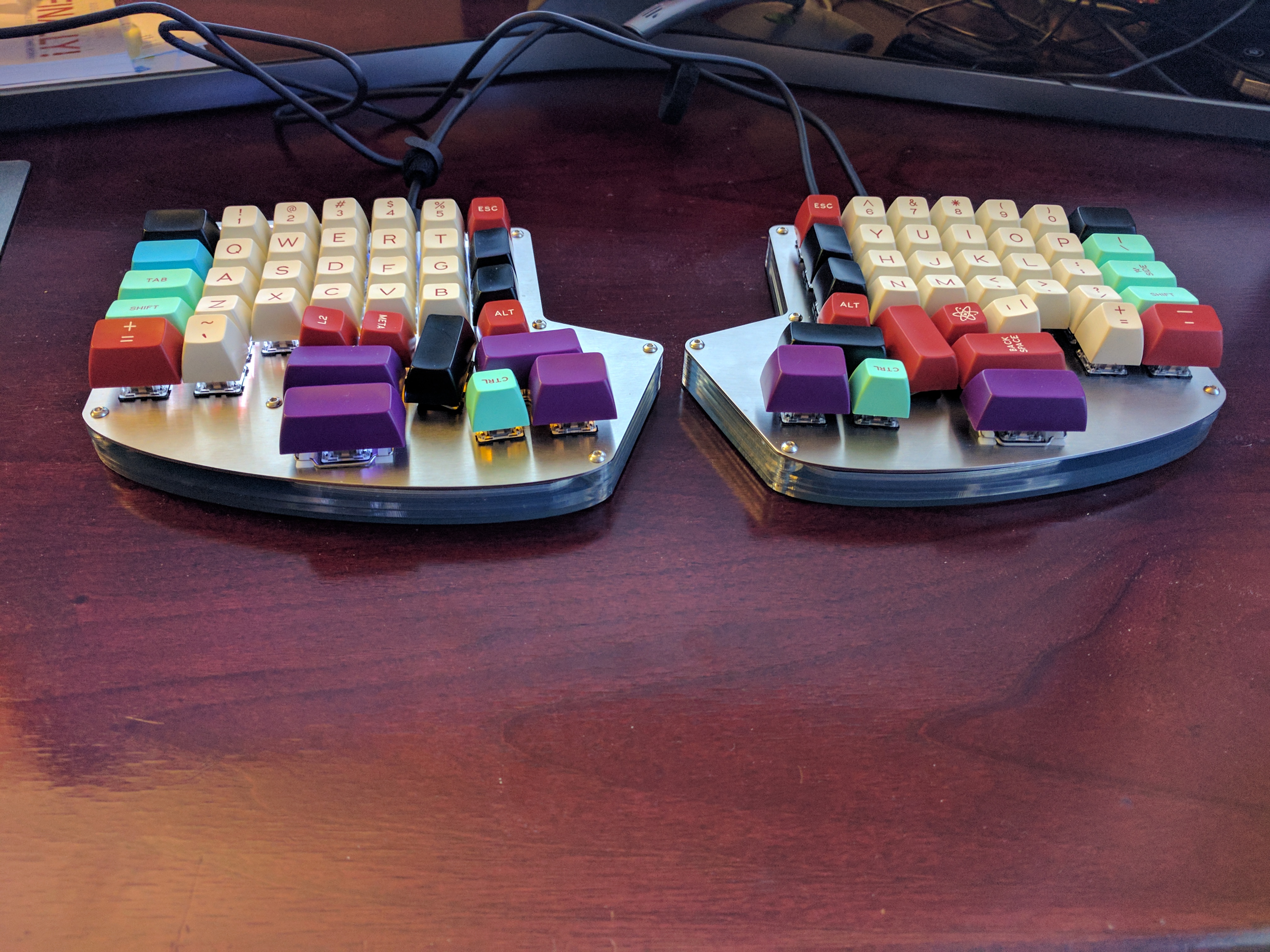

24 Jan 2017, 01:25
Top View
Top View
Landscape View
Landscape View
See ThumbHack 3.1 for background keyboards-f2/thumb-hacks-t14933.html.

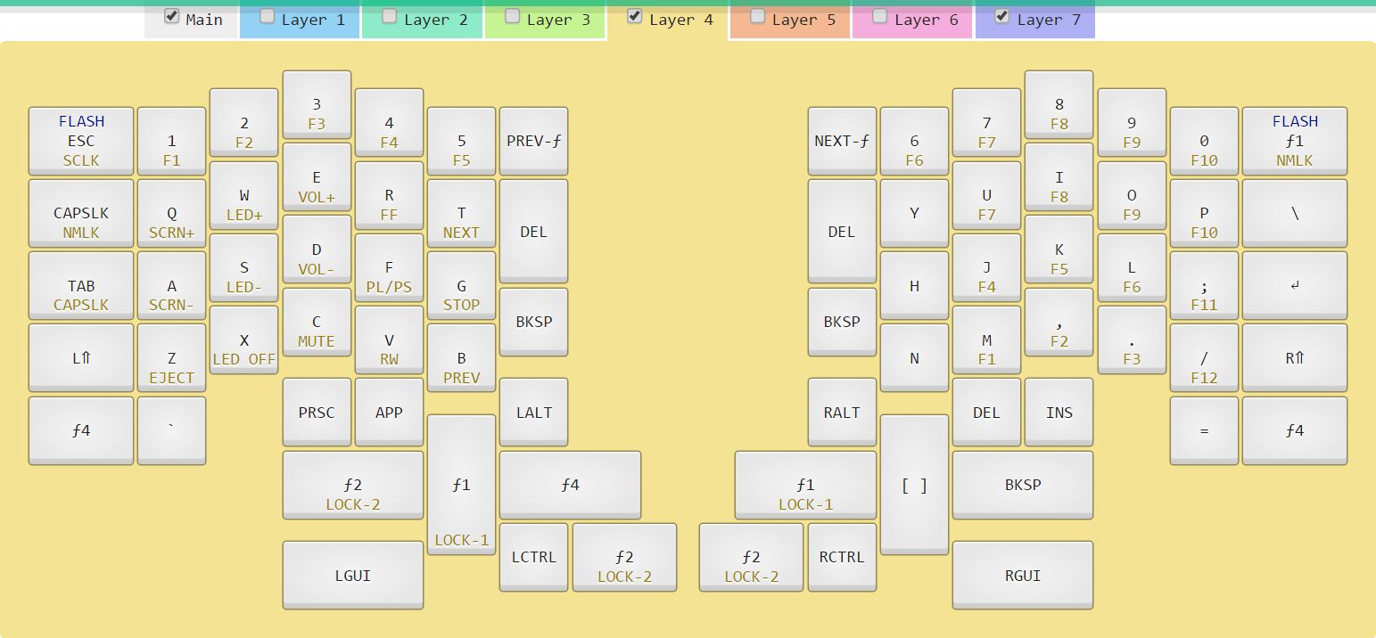

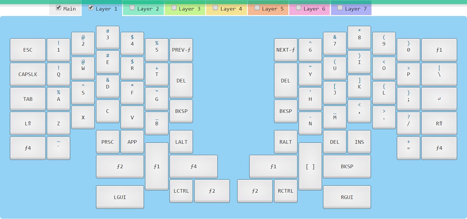

Before I post a video, first let me show you my keymappings. This should help you better understand how I am using certain keys.
Layers 0 & 1
Layers 0 & 1
Layers 0 & 2
Layers 0 & 2
Layer 0, 4, & 7
Layer 0, 4, & 7
Here is the JSON file that bootstraps the layout and configuration using the web based https://input.club/configurator-ergodox/tool.
