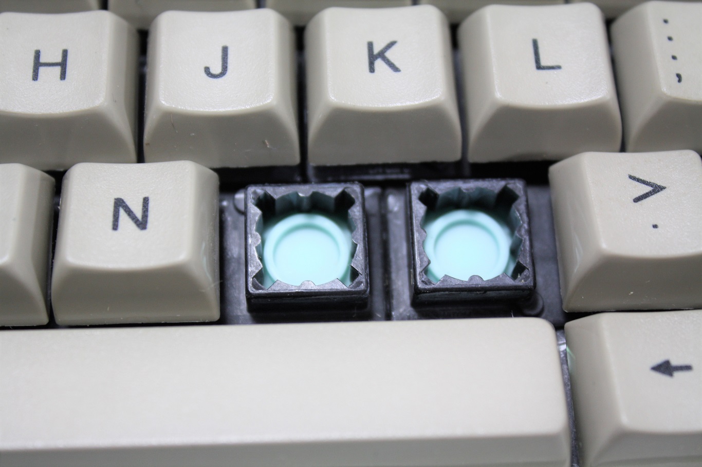

These switches are pretty early and they are quite tactile which is odd. Here's the switches in my Xerox Sunrise. The keyboard is from Max-switch and is from 1983/84. More pics to come...
Xerox Sunrise - Maxi-switch discreet rubber dome
Xerox Sunrise - Maxi-switch discreet rubber dome.JPG (247.57 KiB) Viewed 7803 times
