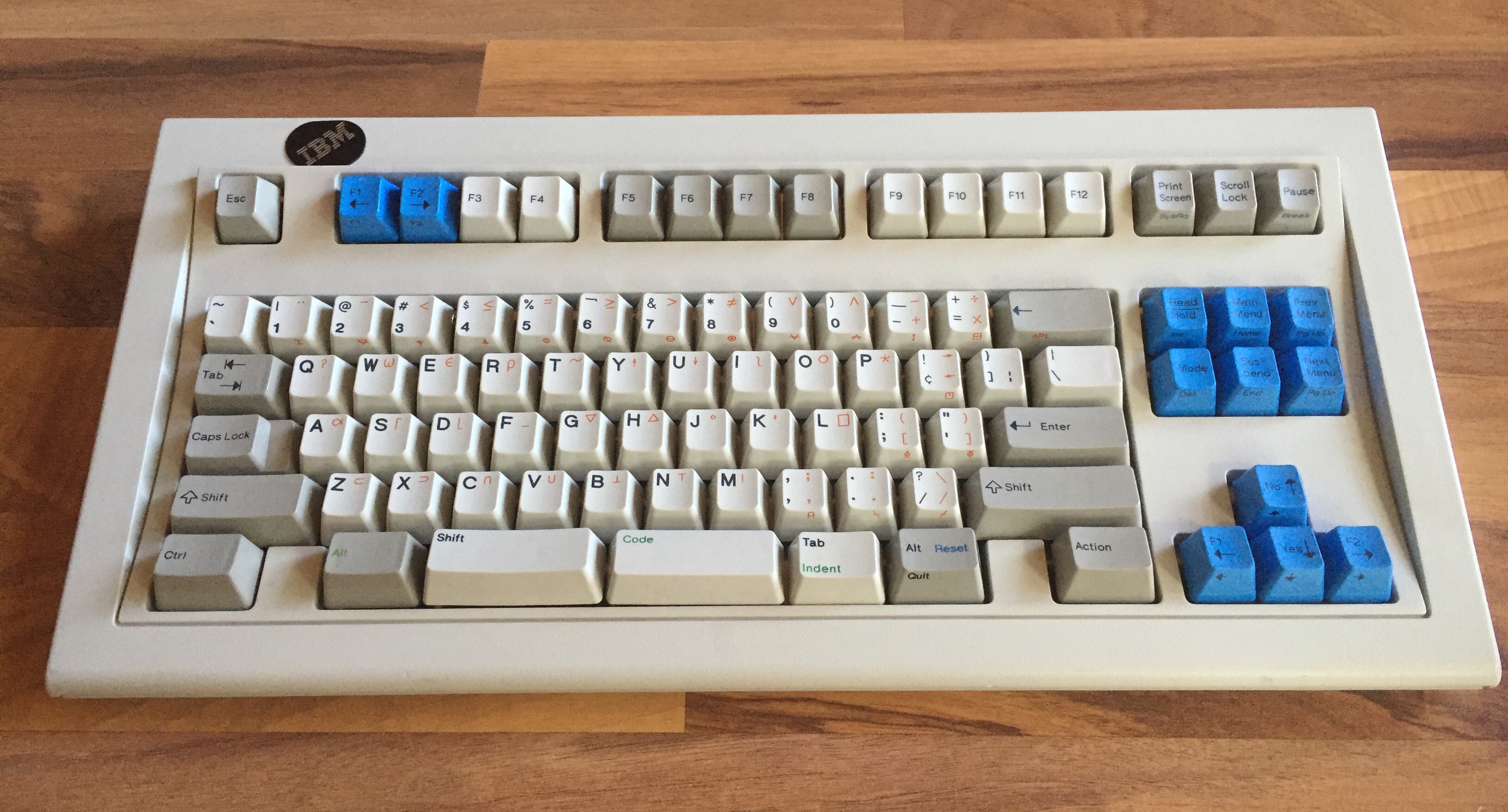

What about the Japan varients?
05 Feb 2017, 21:01
Phenix wrote: What about the Japan varients?
Are any of them buckling springs?

Phenix wrote: Image
That japanese Model M is really cool - I wouldn't need to mod the spacebar row as it has pretty much everything I'd need - any clue where I could get one? Do they cost a lot?
Great tip, thanks
Phenix
-p
06 Feb 2017, 01:10
looks like its rare, so in case you find one for sale it should cost a bit..
If you are also into Model Fs i would recommend try to get an MF-SSK or MF-M once they are shipped out.
in the GB thread for the MF theres an picture regarding the split spacebar.
You need an Code keycap, which is designed different to an Rshift to make split spacebars work on the MF

That Japanese layout would drive me crazy. I use my right thumb and it hits the space bar almost directly below the N. On that keyboard, it would be right between the space bar and the key to its right.

The keys do not look the same to me, shift is rounded and code is flat, and the small tab key looks different height to the alt key next to it - but i guess code and tab are not from the same line of keyboards.
cheater
06 Feb 2017, 14:10
Ok, so apparently I am looking for a 4u key as the space bar, or I could get the japanese version and that would just work for me. If there is no 4u key easily available, that could be a viable option.

The Code key is indeed convex upward, unlike the rest of them.
Finding a key that you like is irrelevant unless the configuration of the base plate and PCB support it. I have never had a Japanese IBM, but it appears that they are in the "M2" style which is different and every row actually does have a different profile, like most other plastic keyboards.
