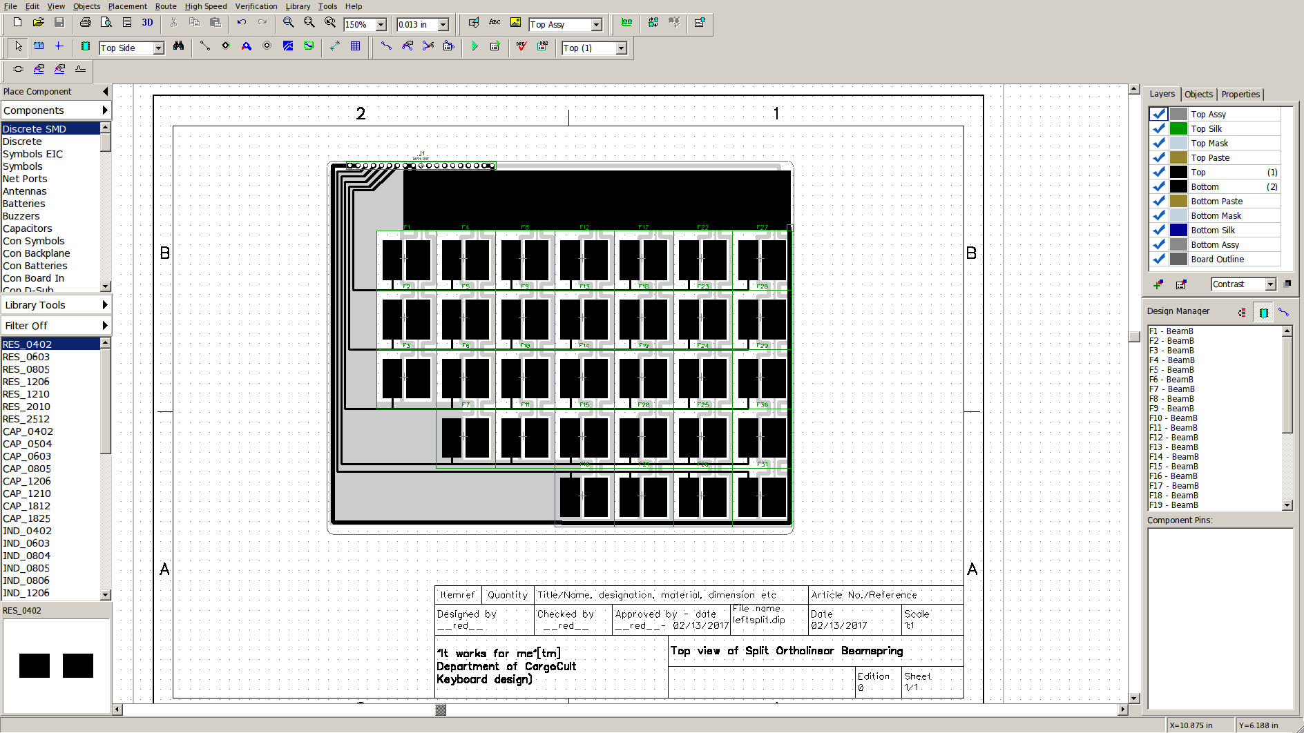

__red__
14 Feb 2017, 03:32
So, this just happened...

I'll likely laser the top and bottom plate from Acrylic and cover with grounded copper-foil. Quick and easy (and in theory I have all of those parts already in my shop here).

The pcb looks a lot like a Model F one.. would it be possible to make a custom plate and just put beamspring switches in a model f with some other modding? :S

Ir0n wrote: The pcb looks a lot like a Model F one.. would it be possible to make a custom plate and just put beamspring switches in a model f with some other modding? :S
There's a good reason for that.
... and yes it is (but you'd have to change the controller)
However, the distance between switches on an F and a beamspring is slightly different so you would have some gaps.

Have you designed capsense PCBs before?
It looks promising but I remember talking to i$ at the German meetup and he showed me his work on capsense PCB and explained that the biggest challenge is to make sure every row and column cross paths exactly ONCE.
If you are getting issues with the rightmost column of your PCB design, this might be due to the fact it is not crossing traces with any of the rows.

Wodan wrote: Have you designed capsense PCBs before?
Nope
Wodan wrote: It looks promising but I remember talking to i$ at the German meetup and he showed me his work on capsense PCB and explained that the biggest challenge is to make sure every row and column cross paths exactly ONCE.
I will confess, I'm cheating. I'm working with DMA so the controller will have the ability to be more granular on each and every key.
