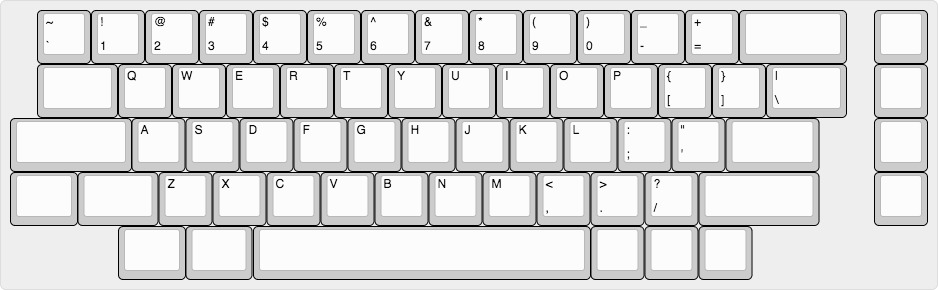

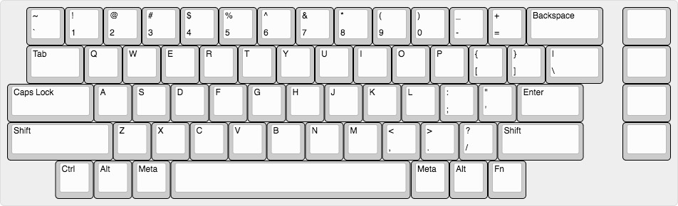

andrea-i
22 Feb 2017, 12:32
Hi Sigmoid, I was very tempted to go for the layout with some custom keycaps, this is what it could look like:
But I already have a massdrop keyset on the way, and I wouldn't have the custom key sizes for capslock and enter, and for the vertical column it's easier to put some 1unit keys than finding four custom sized keycaps I guess.
I know 60% keyboards and I find the HH2 very charming, in fact I started off my layout from a standard 60% and worked from there.
I guess with that layout and a programmable chip, anyone could put whatever they like for the four buttons in the right column. I'll try to go for arrows initially, as my original intent was to solve the arrow keys issue of a 60% without going for the leopold layout.
We'll see : )

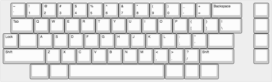

Hey :D Here's my 15 minute take on the topic, 16u wide. The c64 was definitely a pretty interesting keyboard.
Orpheo
22 Feb 2017, 17:36
I prefer your original design. And for the arrow keys that is essential in your need, I would sacrifice the left three 1u mods on the right, move all the space bar row to the right to form a traditional inverted arrow cluster, and use a short ISO shift instead. Anyway you have a splendid design to begin with already, good luck and keep faith!

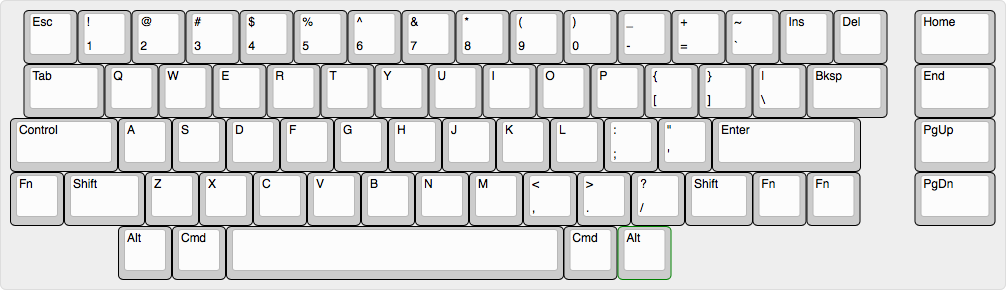

andrea-i
23 Feb 2017, 11:16

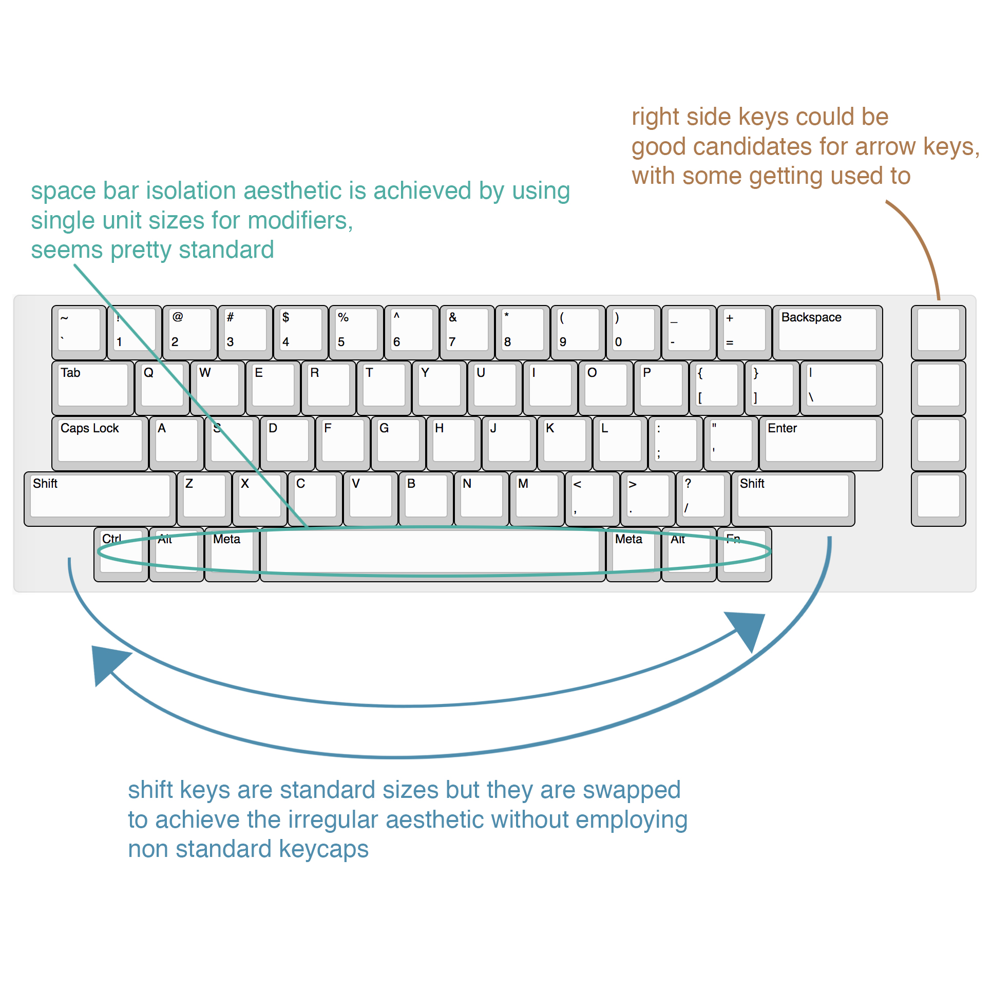

I think I'll make one more try reshuffling an an ansi 104 keys, it'll have to be blank modifiers or the labels will be all badly scattered around.
Keypoints:
- keeping two rows out-shifted to really resamble a c64.
- managing with one standard 104 ansi keyset (I still think it's important, to not make this just sci-fi)
- keeping the lower-right modifier cluster open to the option of becoming arrow keys (I really like this idea).
keyboard-layout (1).jpg (58.04 KiB) Viewed 10088 times
I think I'm not there yet with the second row from the bottom, too there's one or two extra non standard keys there.

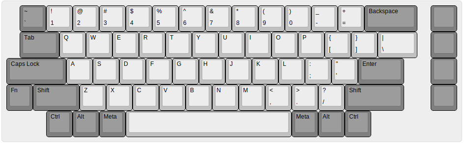

andrea-i
24 Feb 2017, 13:36
Ok, this was harder then I thought!
I made a photoshop file with all the keycaps from the drop I'm waiting for: https://www.massdrop.com/buy/massdrop-x ... keycap-set
And I managed to come up with this layout, which, if I don't go insane, should be my final:
I think it's pretty standard too, especially if one buys keycaps with symbols for the modifiers, or blanks.
Next thing, designing the case.
I think I'll try and make a layered case for the core and then design a cover that sits on top. All cnc machined out of acrylic.

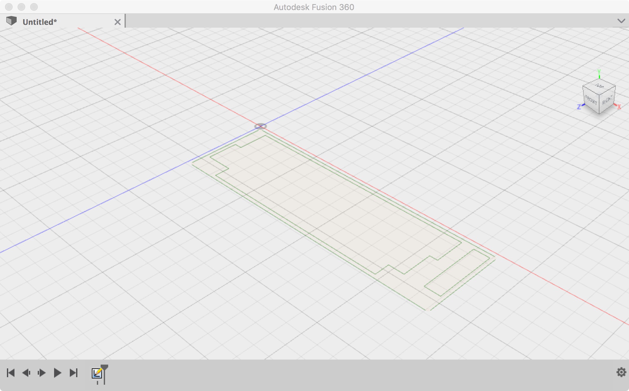

Meanwhile I'm getting into Autodesk Fusion 360 for the case, I'm designing it starting from the handy svg files coming from builder.swillkb.com .

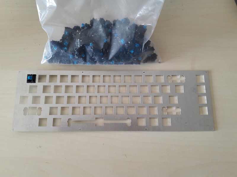

andrea-i
22 Mar 2017, 12:36
Slowly making progress!
The plate is awesome, bought from lasermaster.co.uk, switches fit perfectly, hopefully I didn't f*up the screw holes, but I should manage fine anyways.
Now that I have the plate I can get the exact measures to design the case, which I foresee is gonna be the most difficult part.
Especially finding the right material to cnc might prove challenging (I fear I might not find thick enough acrylic for the top cover).
To celebrate I've done a new render with an industrial flavoured case : )
The nerdy adventure begins!

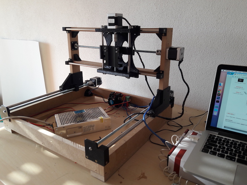

andrea-i
19 Apr 2017, 10:00
So after a quick round of quotes and with more ideas for keyboard cases coming to my mind, I went ahead and bought this:
Can't say I'm not loving where this little project is taking me :D
If anyone is looking for a cheap entry point into cncs, that thing comes from spain and is called maduixa cnc by boloberry, it's one of the largest machines I've found for reasonable pricing.
Once I'll manage to get something decent out of it I will post results...it's too bad I will be out for work for one month, I am so looking forward to get into cam machining!!
Ps. forgot to add that the keyboard wiring is all done, thanks to the wonderful tutorials from Matt3o and many other members of this community who went through all the details and made this process super smooth, thanks!
