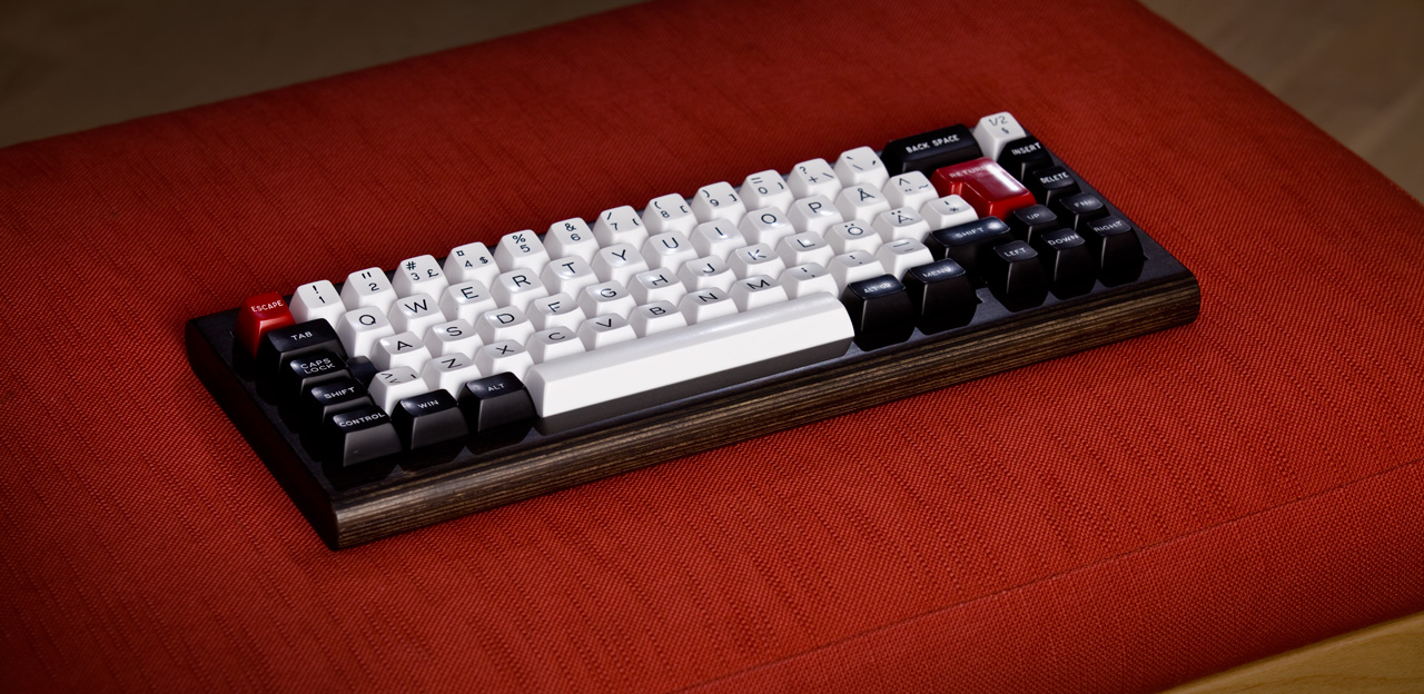

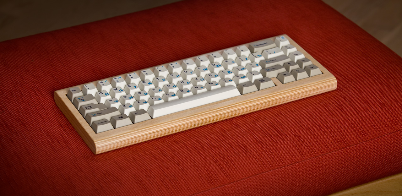

Production prototype:
Production design bottom:

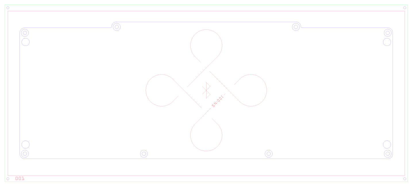

Material: Grade 'A' 2-3 ply/mm Finnish birch plywood.
Finish: Osmo color TopOil
(add 20 EUR for a colored under coat)
Made to order plates
-no universal plates
-no switch-top removal
-no spare plates or PCBs (monoblock design)
-costar stabs
PCB supports the following layouts:
the 5% portion of the 65% PCB can be removed for a 60% layout.

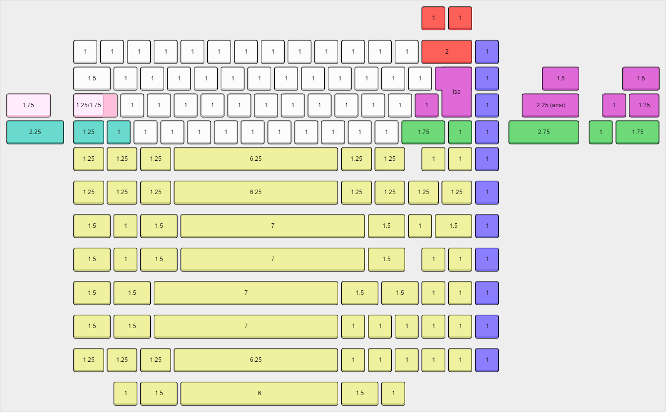

4. Select the layout by loading the KLE link and coloring the positions you want with 0x00FF00 (see example for 1st position)
5. Select the surface treatment you wish to have (clear/colored(color code from http://www.osmocolor.com/puuvaha.html)/untreated)
6. send the KLE link and the surface treatment option of your choice to me via email. I will update it to the OP under your position
- if you are unsure about the surface treatment or KLE layout, please have explicit questions as part of the email, so I can answer those easily
- it's possible that the KLE link I have does not fully cover all possibilities there is with the PCB. If you have some specific bottom row layout in mind I can check whether it might work.
