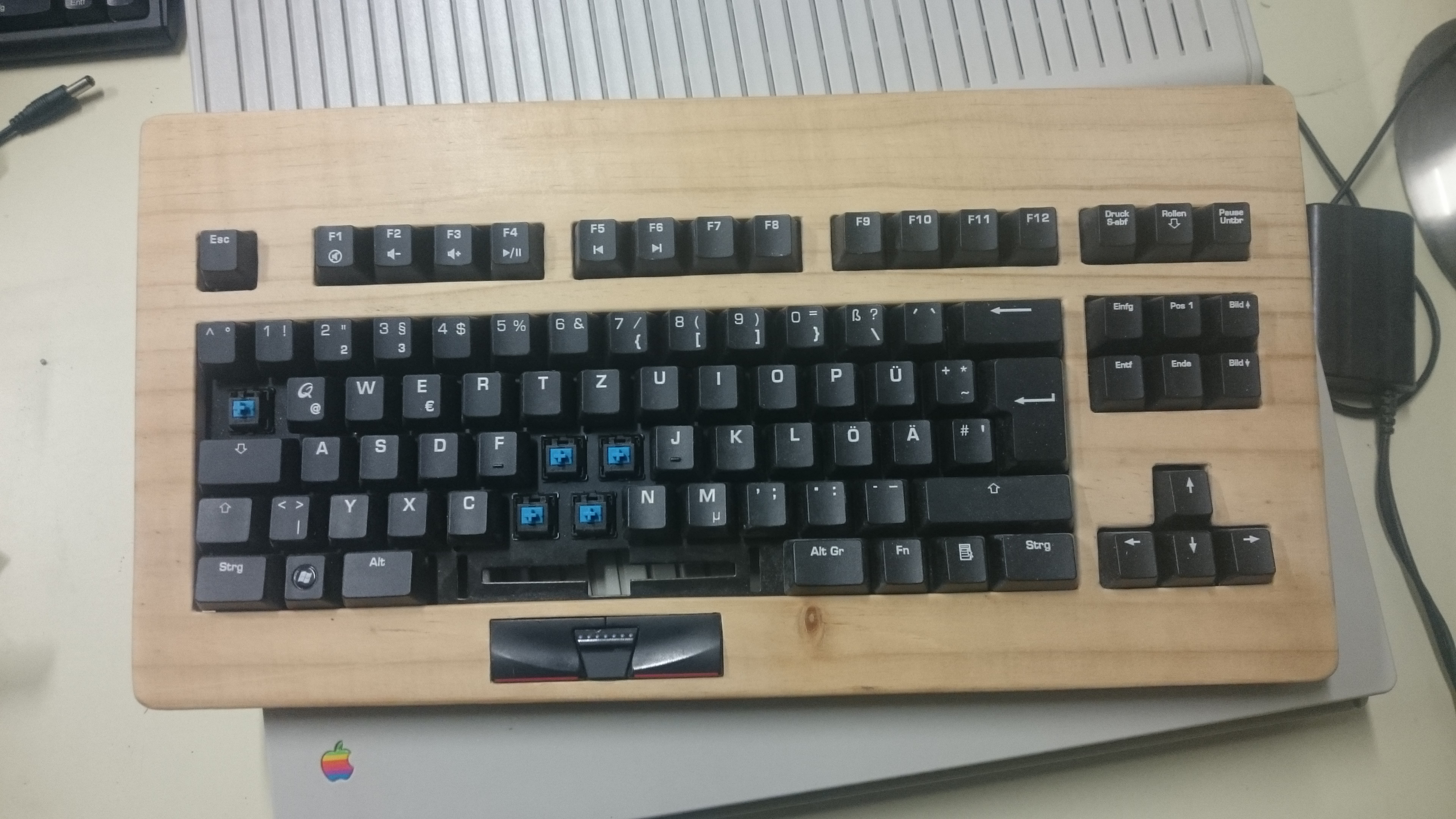

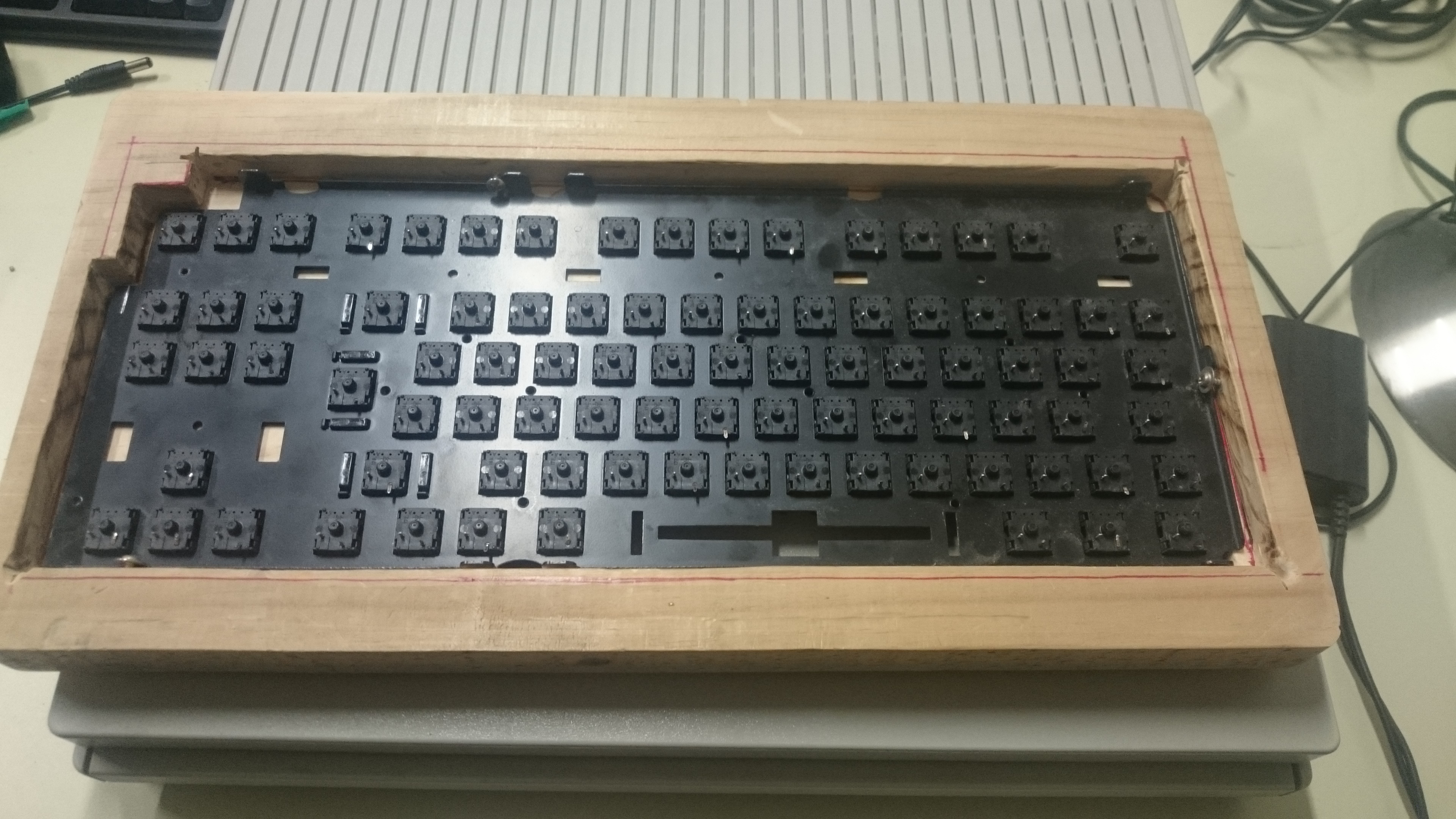

20 Apr 2017, 02:13
I think I'll give it a try, my friend made up a little case for it, now I need some spare time to get it done, but looks as if it's a good starting point. He made it all with a dreml by hand, and the wood is hard! Would love to know what kind of wood it is, btw...
Front view
Front view
Back
Back
