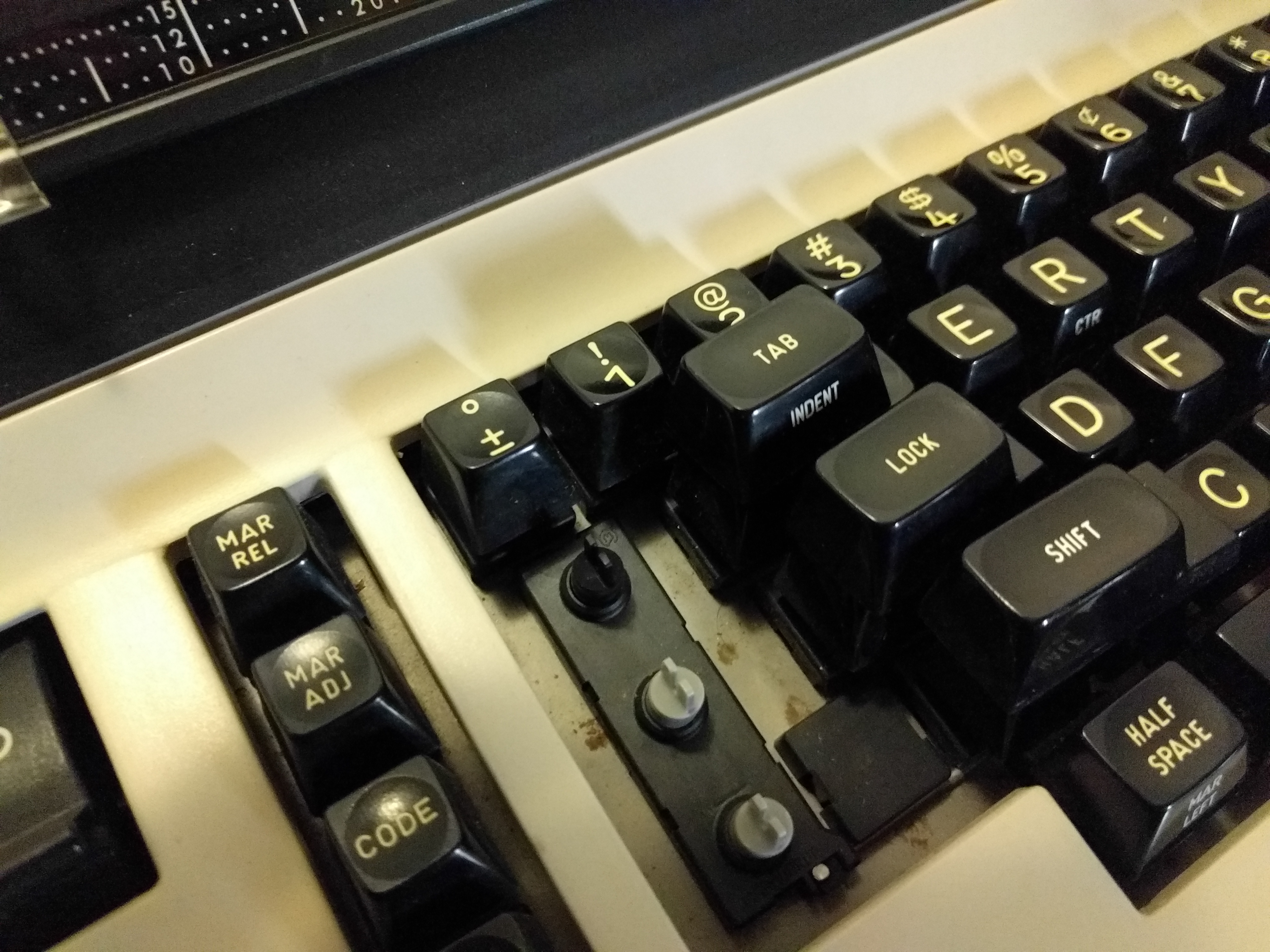

Someone enlighten me as I think my eyes are playing tricks on me - are those three switches in one block? That's pretty neat looking.
- seebart
- Offtopicthority Instigator
- Main keyboard: Rotation
- DT Pro Member: 0061

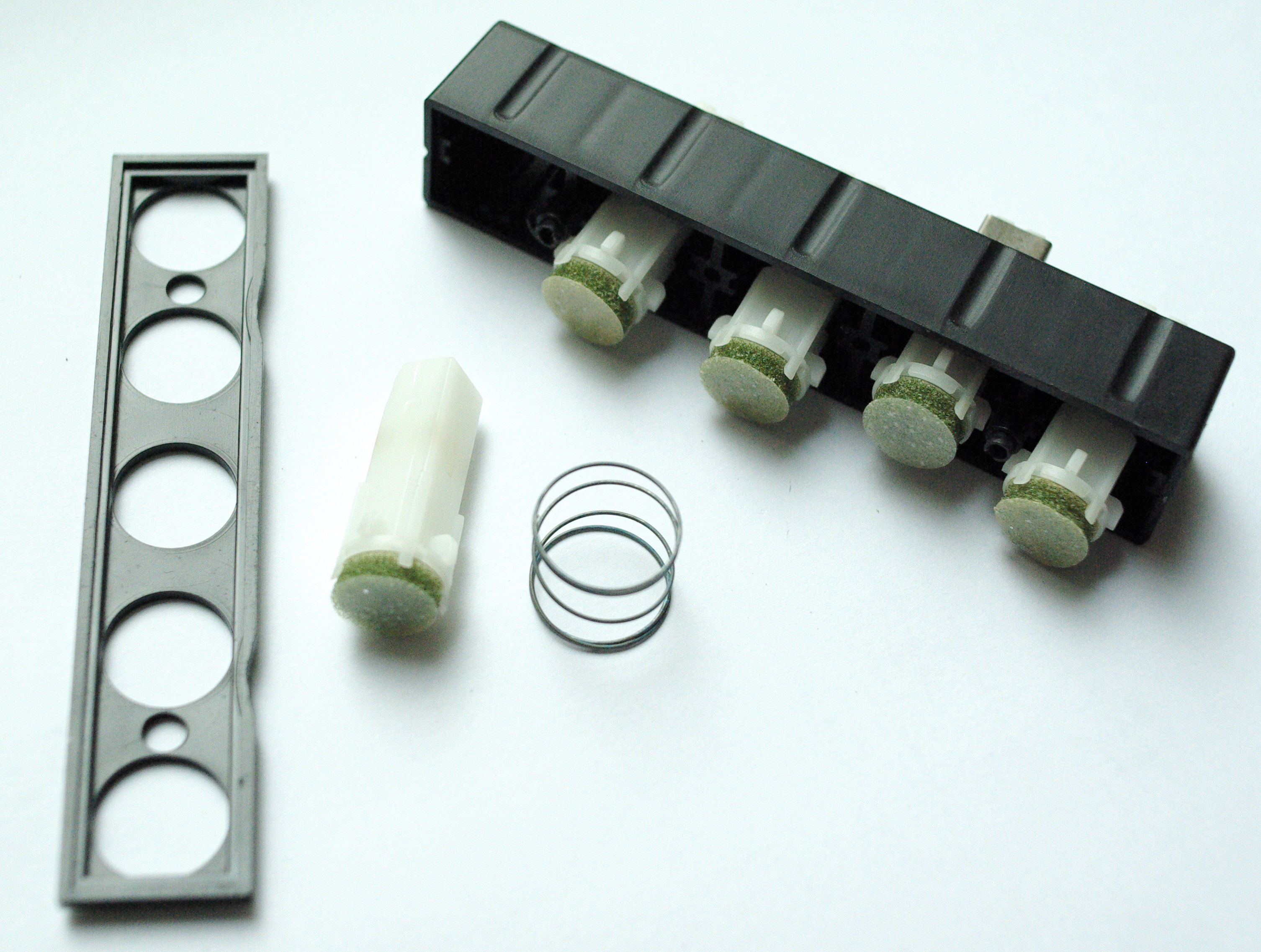

Yes, here is another example of switch rows in my old Key Tronic FF:

Marquardt Butterfly is only known from typewriters, hence all the adaptations for typewriter use. This includes double action (the white switch; standard behaviour on electric typewriters) and mechanical shift lock (the grey switch), where pressing either shift key releases shift lock. The single key grey module has a ram that drives a release rod that connects each shift key to shift lock. Shift lock itself is inside that special three-key module — there are no sufficiently clear photos to see what's inside it, but it should have a latching mechanism as well as an releaser fed from the shift keys.
It's nothing to do with seebart's module different — for some reason, some companies found it easier to manufacturer keys in blocks, including Maxi Switch and Key Tronic. It was also used by Hi-Tek and Stackpole for peripheral keys on keyboards that used switch grids, but both companies did make single-key modules too.
Mechanical shift lock itself was also made by Cherry and others, and double action is confirmed from Cherry (M9), Alps (plate spring?), Mitsumi (Type 1 standard) and likely others.

So are these switches intended to be used as a combination shift/caps lock key? If so that would be an interesting proposition on a compact keyboard.
- Daniel Beardsmore
- Main mouse: MS IMO 1.1
Shift Lock and Shift are separate. Pressing Shift will release Shift Lock mechanically (using rods/levers). There is no Caps Lock: that was a later invention just on electronic systems.

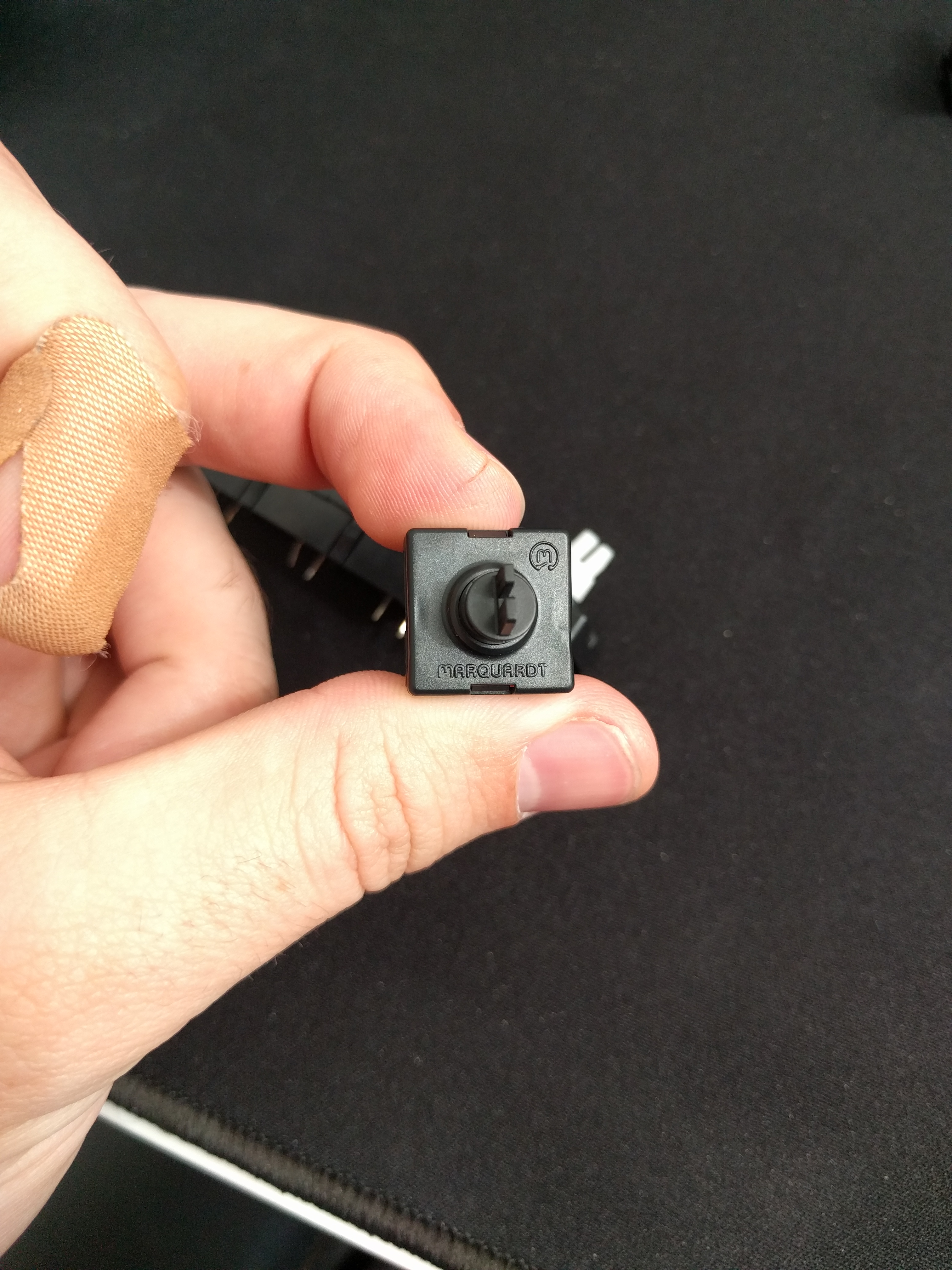

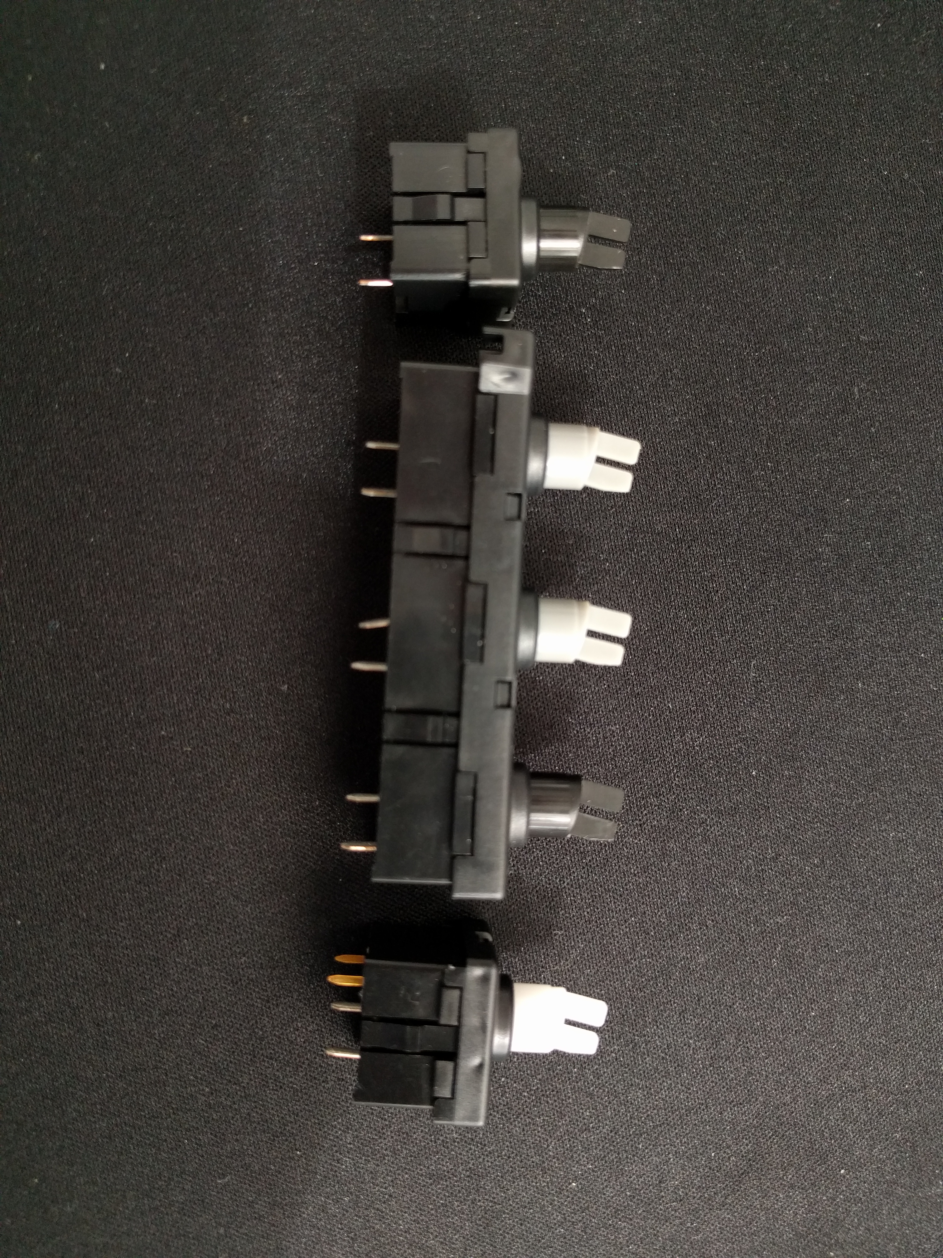

Ok I took some quick and dirty pictures now because I am a bit busy but want to get the information out now.
Grey single pole, is lock/unlock switch
Grey multi pole, is lock and unlock pair
White single pole, is double action
Black on multi pole, is single action
Black single pole, is single action

I am curious to know what the mechanism is like to have a 3 way latch switch. That is some engineering effort there.
Also is your Olympia working? Mine seems to not be able to move the daisy wheel head. I think it may be a broken gear or belt.

Didn't even try to power on the first one. It was in bad shape anyway so just salvaged the keyboard.
This one from the photo arrived today and it seems to be working fine.
- purdobol
- Location: Poland
- Main keyboard: Custom
- Main mouse: MS WMO 1.1A
- Favorite switch: Marquardt Butterfly
Turns out it's quite simple. There's plastic plate on the right side with little spring and cut out notches. Sliders have little bumps that fit those notches. When button is pressed this plastic part slides down releasing previously latched button and comes back up grabbing the one being pressed, and holds it. Third button from the top (default) has no contact plate or the metal "butterfly" plate spring. Just the central terminal and spring.
Shift lock module probably works the same way. Plastic plate connected to metal rod, slides down (releasing lock key).
