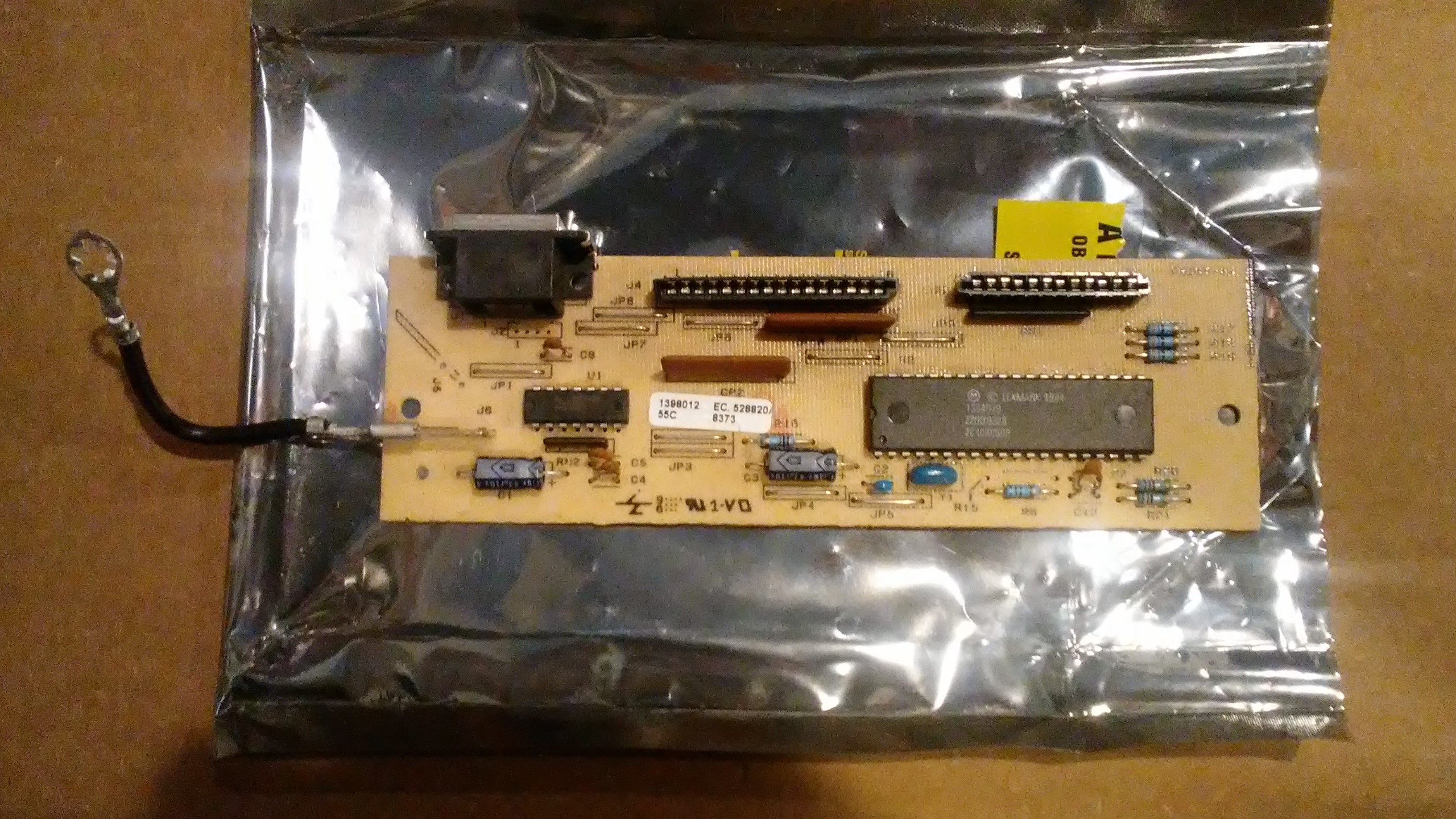

I have an IBM model M 1394950 keyboard with a bad 1398012 controller board. Lock lights may blink once when keyboard plugged in but then nothing - no response at all from key presses. I swapped out the controller for a different one with the same membrane connectors (16 + 12 pin) and the board works fine.
The problem is the 1398012 has an SDL plug with a nice detachable cable while the replacement controller has an attached cable - not as nice! I can try replacing the electrolytic capacitors if the symptoms sound typical for bad caps, but otherwise, any ideas where I could find a replacement 1398012 controller or what IBM keyboard years/models use the 1398012 so I could keep an eye out for a donor keyboard? I'd really like to have my SDL cable back!

Quick update - I went ahead and replaced the two 47µF 10V electrolytic caps on the non-functioning controller and now it's working fine. I guess not too surprising on one of these old boards.
