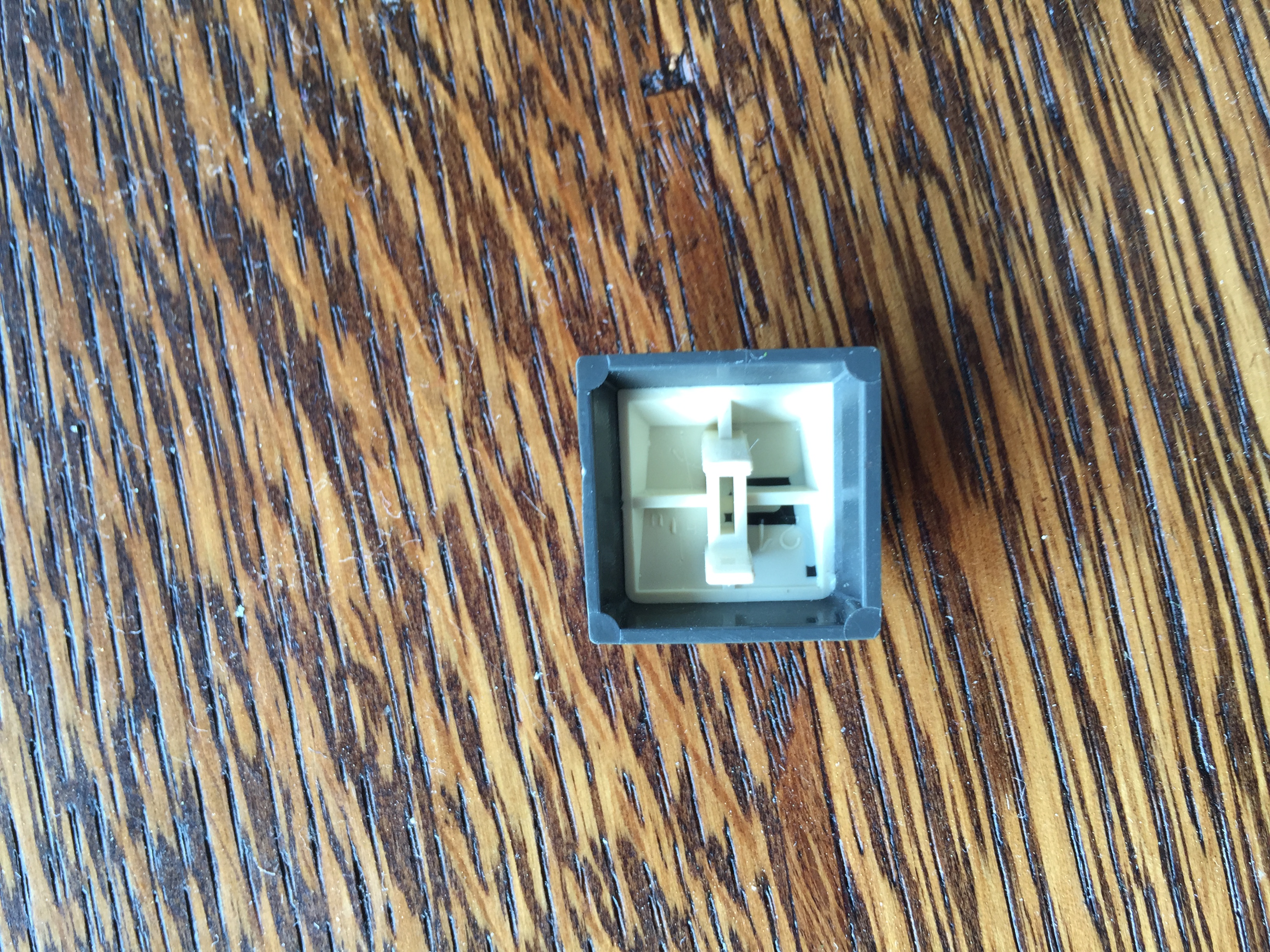

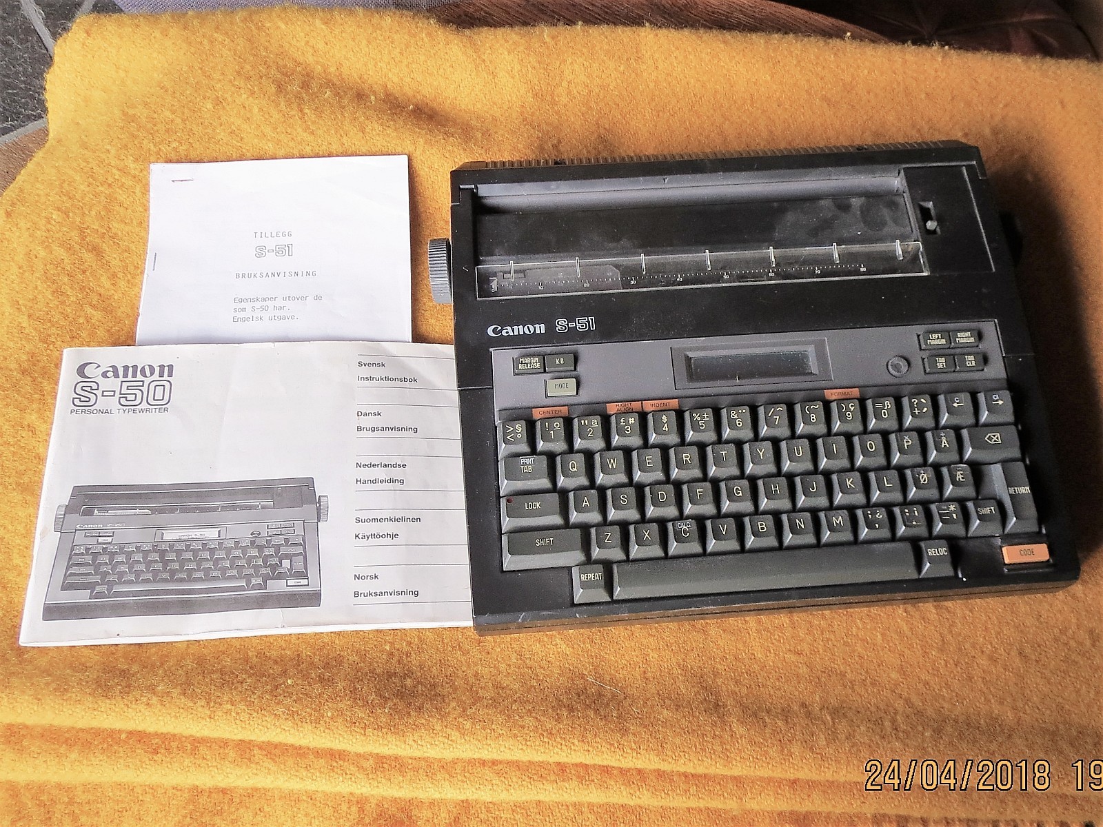

snufflecat
28 May 2018, 12:34
So what about unearthing this thread again? :)
What are your guesses? Could this thing be compatible with any modern switches at all?
28 May 2018, 13:17
snufflecat wrote: What are your guesses?
I am guessing that it is Stackpole switch grid.
I once passed on buying a typewriter with switch grid that looked much like that one, and I of course regretted it afterwards.
snufflecat
29 May 2018, 13:02
That's what I hate about buying things online, really, but part of the fun too I guess.. :p
snufflecat
29 May 2018, 16:58
Update: Got the seller to send me pics of the switch and caps, doesn't look promising:
