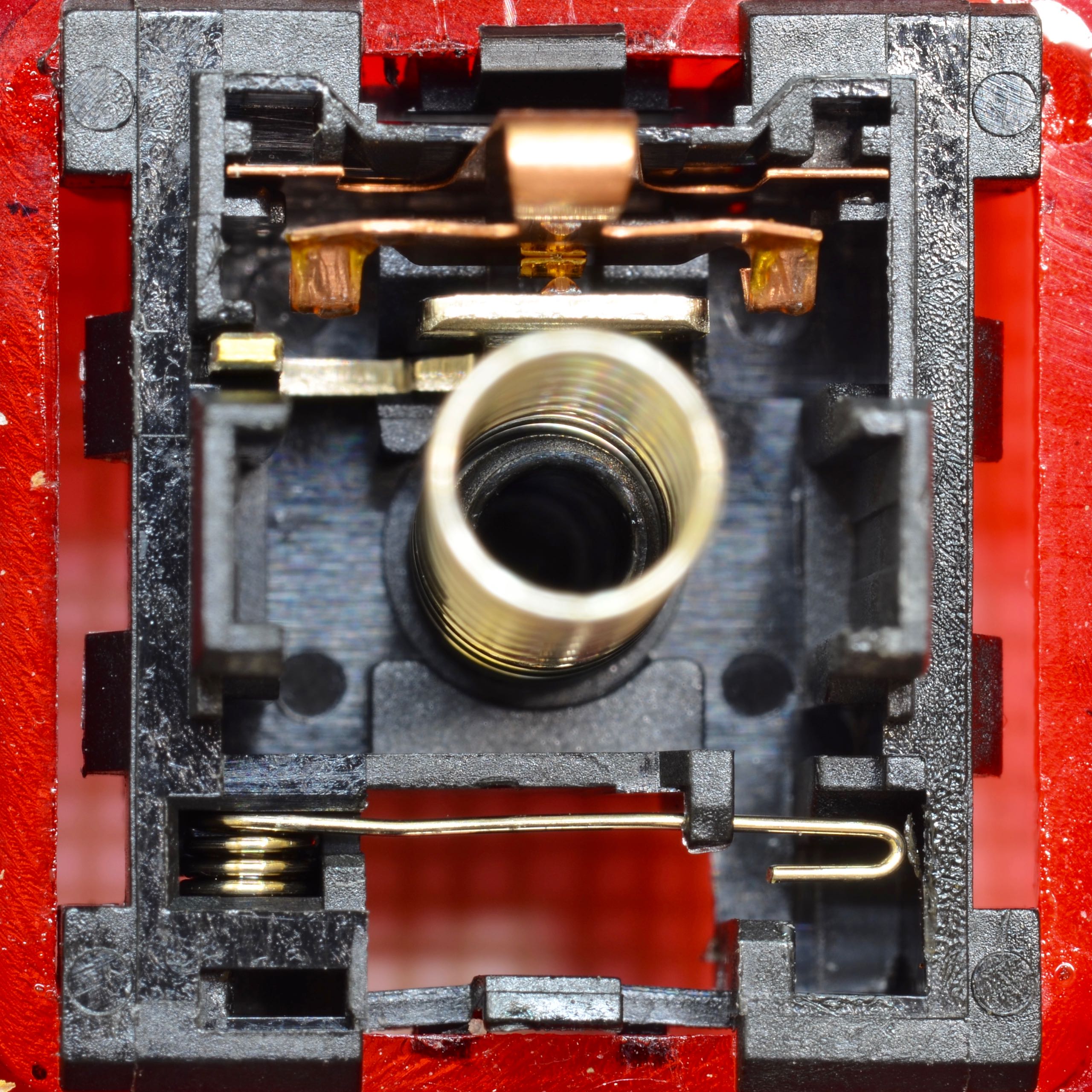

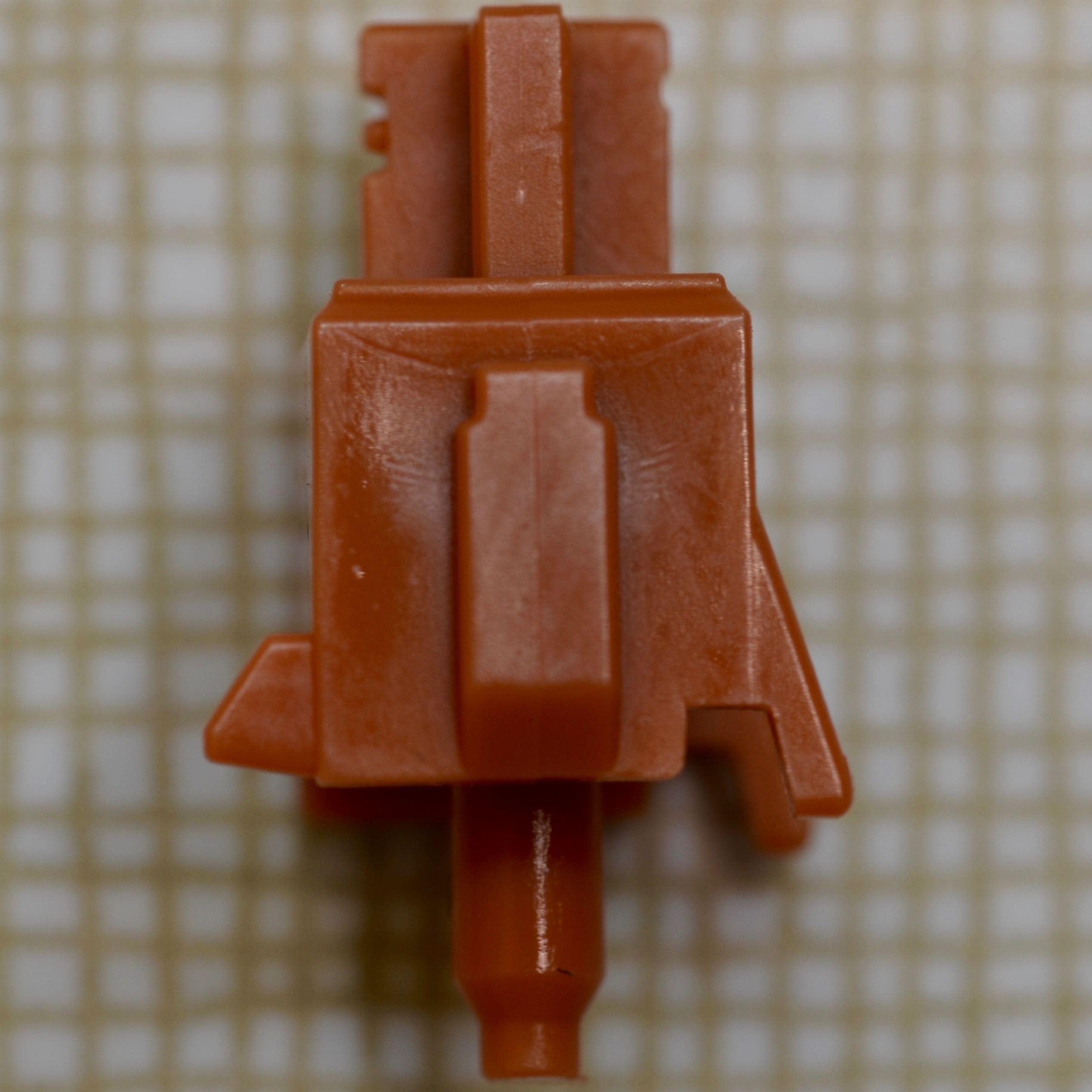

I received a sample of a new switch "coming soon" from Kailh. I took some high quality photos and videos and wanted to share them here with you! Thoughts and suggestions welcome!
Kailh click - switch slider. Note click arm on left side.
Kailh click - switch internals. Click bar clearly visible.

Ah, so this basically uses the clicker from their new low-profile switches. Very interesting, I really liked those switches. How did you acquire this?

Thanks for taking the time to video and photograph it, I agree that you got some really good shots!
So how does the click spring change the feel of the switch?

How curious. So we know that the upstroke and downstroke feel different, yet this guarantees an upstroke click, something few switches offer so precisely.

Stabilized wrote: So how does the click spring change the feel of the switch?
It adds a nice snap. It adds force before the click, and decreases force a little just after. The switch is otherwise linear.
This is a really clever mechanism for adding a click and tactile feedback to a linear switch.

I really like this mechanism, I find it much more satisfying to use than a click jacket.
I was a little disappointed by how little we've seen of the ML switches they put out, but I'd love to review a fullsize of these :D .

The only thing that's really changed is the click mechanism and some minor changes on the stem, so I doubt that these switches will have the characteristic Alps "thunk." There's still a lot of a difference between them. The click does sound a lot better than the typical mechanism though.
Also, I'm assuming that this mechanism still allows usage of LEDs thanks to how slim the torsion spring is.

E3E wrote: Also, I'm assuming that this mechanism still allows usage of LEDs thanks to how slim the torsion spring is.
It IS conductive though :p .

I was thinking that, but given enough separation, it wouldn't interfere. The little spring doesn't move very far. The LED might be fine.
Now that I check again, yeah. The top has an LED cut out, so it's probably designed with that in mind, as I had thought. I missed that part when I originally watched this.
Heh, short circuits... It'd be its own backlight mode without any programming needed!
15 Apr 2017, 13:05
If the spring touched the LED legs it would short the current and stop the LED lighting up.

This design works best with surface mount LEDs.

I'm not sure I trust SMD LEDs … they're a long way down. The Matias approach just ends up with the light coming out from underneath the keycap: you just see a glowing switch. At least with Kailh the LED would be above the PCB.

The top of the switch appears to be designed for LEDs. The spring wouldn't be touching it at rest either, so if it did cause a short, it'd be a momentary short and cause flicker when the spring is pushed forward, which is what I was joking about regarding LED modes without programming.
If this version reflects the production model, then it was obviously designed with in-switch LEDs in mind.

Ah, I see from the video that the spring stays out of the way. I was arranging to order some Kailh speed switches, and I've just realised that it's these, so I'll have some to play with in a month or so.

Cherry's click system is plastic on plastic, while Alps is metal on plastic, so this click spring design is closer to Alps. It's an interesting idea, that should have less if any of the MX rattle.
I'm curious to hear the pitch compared with blue and/or white Alps side by side in the same environment.
