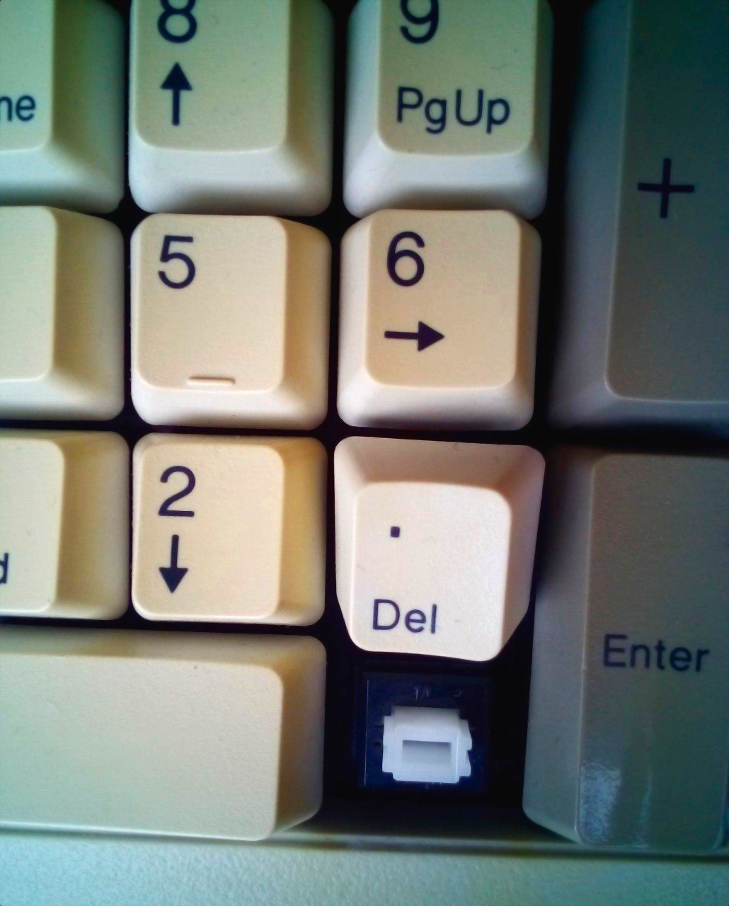

Restoring this old thread 3 years later, just bought this one in decent condition. All switches are working except for one that i broke when cleaning. I got lucky enough and got an alps on enter key. but other keys are still atw alps clones.
Strangely theres no at/xt switch, just solder on the points where that switch supposed to be. Its working good despite that i almost killed it after resoldering.

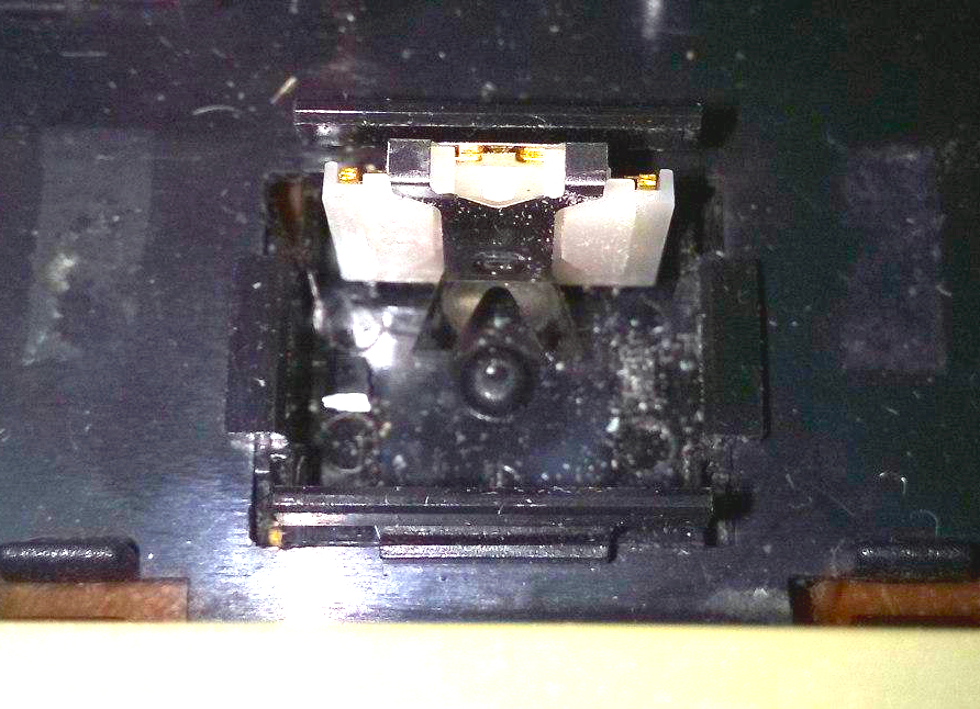

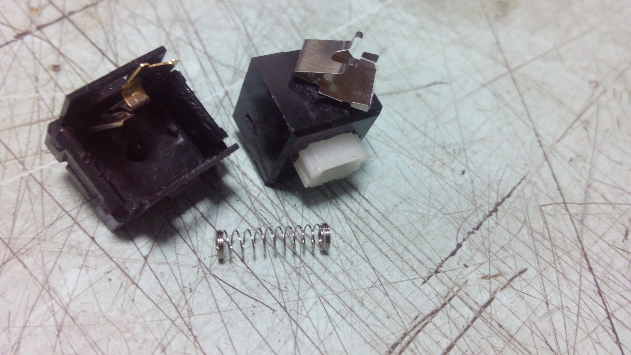

The alps switch
Alps Switch on enter key
It has a little different stem than other switches
Alps switch that i found in enter key
