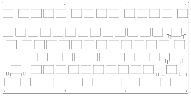

Zombimuncha
24 Jun 2017, 22:30
OK, here's my plate:
SVG: The stabilizer arrangement is based on this concept - credit to Edgar Matias.
The idea is that it will let me use normal Alps caps, or those made by Signature Plastics, which have MX-style stabilizer mounts, but without ever needing to bend any stabilizer wires to fit the SP caps.
The upper pair of stab holes in each group are for Costar stabilizer wires, so they need to all be a consistent distance apart, due to the consistent spacing of the cruciform stab mounts in the SP keycaps, even on that big 2.75 rShift.
The lower pair are for Alps wires. In most cases there's not enough room on the outside of the costar holes, so they've been placed on the inside, closer to the switch. On the right shift there is enough space so in that case they're in their normal positions.
Please critique! Any obvious fails in here?
Wingklip
26 Jun 2017, 06:34
To be quite honest I would go ahead and put the windows key to somewhere you use the least, possibly to the right hand side cluster (it screws you over if you ever play games and gets really annoying if you accidentally tap it anyways).
Want to use any macro keys? They're quite useful if you ever want to put your signature everywhere or if you want to execute easy combos in games, or to type a really long line of identical text in a millisecond.
Zombimuncha
26 Jun 2017, 08:21
zool wrote: If you really want bluetooth/ble it would add quite a bit of time to your keyboard build if someone has not done the work for for the micro you use. using a well developed firmware and going straight usb would be the quickest road to success and support when things don't make sense.
However if you are keen good news though most of the hard work has been done for a lot micros, and by hard work I mean the underlying usb stack(I eventually gave up implementing my own version) Low power modes and power management for good wireless system are still quite a bit of work to get right. But if you wanna get into the hardware and software under the hood, its loads of fun.
A shortcut to ble bliss could be to use a sx1509b, spark fun have a breakout for it https://www.sparkfun.com/products/13601. it has a 8x8 matrix scanner built in or you can just use it as a normal i2c 16 bit port expander, and or a led driver, and sparkfun have even written a driver for arduino so if you did use the adafruit ble board it could be all arduino, which is not a bad way to go if your starting out.
This is all good stuff for v1.1, but I've decided to go with plain vanilla USB for v1, and have ordered a Teensy2.0.
Thanks for the suggestions - it's helped me to figure out what I want to do.
Wingklip wrote: To be quite honest I would go ahead and put the windows key to somewhere you use the least, possibly to the right hand side cluster (it screws you over if you ever play games and gets really annoying if you accidentally tap it anyways).
I was actually hoping for some feedback regarding the plate design in terms of will I run into any problems in getting it made or assembled.
I've thought long and hard about the layout. I value keycap compatibility (yeah, that delete key is a problem but not unsolveable! I have a couple of TaiHao sets with standard 1.25 layout, and have Granite on the way) I like the windows key in its standard location and use it fairly frequently. I dislike macro keys - I have CTRL-C and CTRL-V for that, and they would take up extra horizontal space.
Thanks for keeping me honest!
Some specific questions:
  • The screw mounting holes - are they all sensible in size, location, and number?
  • Could I get away with less padding abve and below?
  • Should I bother with adding Alps stab holes for the spacebar? Are there any 6.25 spacebars with Alps stab-mounts in existance?
  • Did I pick the right kind of stab mount holes for hand-wiring (no pcb)?
  • Am I crazy for trying such a novel concept with the stabs? Did anybody actually build one of these before?

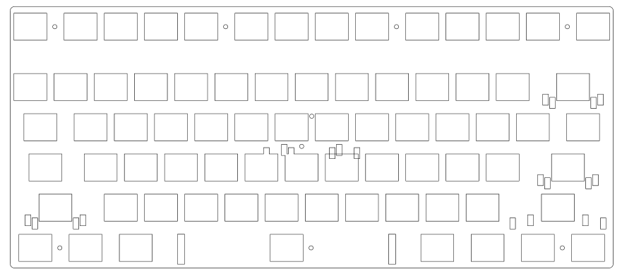

Zombimuncha
03 Jul 2017, 23:26
How about something like this?
Please disregard the extra stabilizer holes, and one extra screw mount hole in the middle of the plate - there's a bug with the custom polygons feature of the builder, I can clean it up later.
So does this kind of setup have any advantages or disadvantages over the earlier larger plate? More or less stable? Easier or harder to work with?
