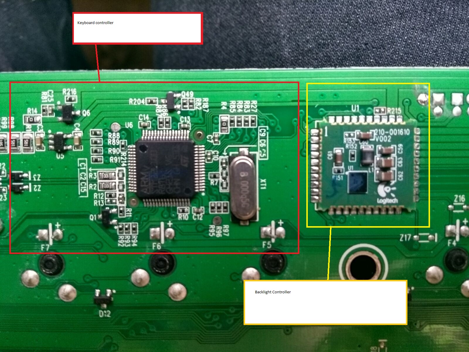

Hi y'all , I was wondering how hard it could be to replace / reprogram the Controller in my Logitech G610, it is a soldered Arm chip, Im not afraid of cutting traces, but I dont Know how to determite if a Tensy would Work, also i dond need "per key backlight" so the controller could go , a simple led driver chip vould be enought, I am also wondering if just buyng a new PCB and desoldering all my MX browns would be more economic ( Im in germany so shipping from the US would kill my budget)

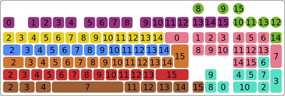

Hi NaTaKa! Though you didn't receive any feedback, were you successful with your project? I received a bricked G610 and also want to replace the controller with a Teensy. So far I determined how the matrix is organized (see attached image - hope I got everything right). Now I need to decide whether it's better to desolder the chip (and possibly the LED controller) or to cut traces.
I'm also not sure yet how to connect the rows to the teensy. The columns are simpler because they don't involve diodes and I can simply solder to a switch pin. I fear that for the columns, soldering a wire to the tiny connectors of the chip will be too delicate for my miserable soldering skills. But I also fear that soldering a wire to one SMD diode in each row might displace the diode and I might not be able to properly put it back again.

Did you possibly solder to one of the diode legs instead of a switch pin? Unlike you, we don't have diodes integrated in the switches that have nice big easy solder joints exposed. We have those flimsy SMD diodes like the one labeled "D12" in the image NaTaKa posted:
NaTaKa wrote: Image
I think I'll do the following:
  • Practice soldering to SMD components in the controller area that I won't need anymore.
  • Replace one SMD diode per row with regular diodes if I mess them up.

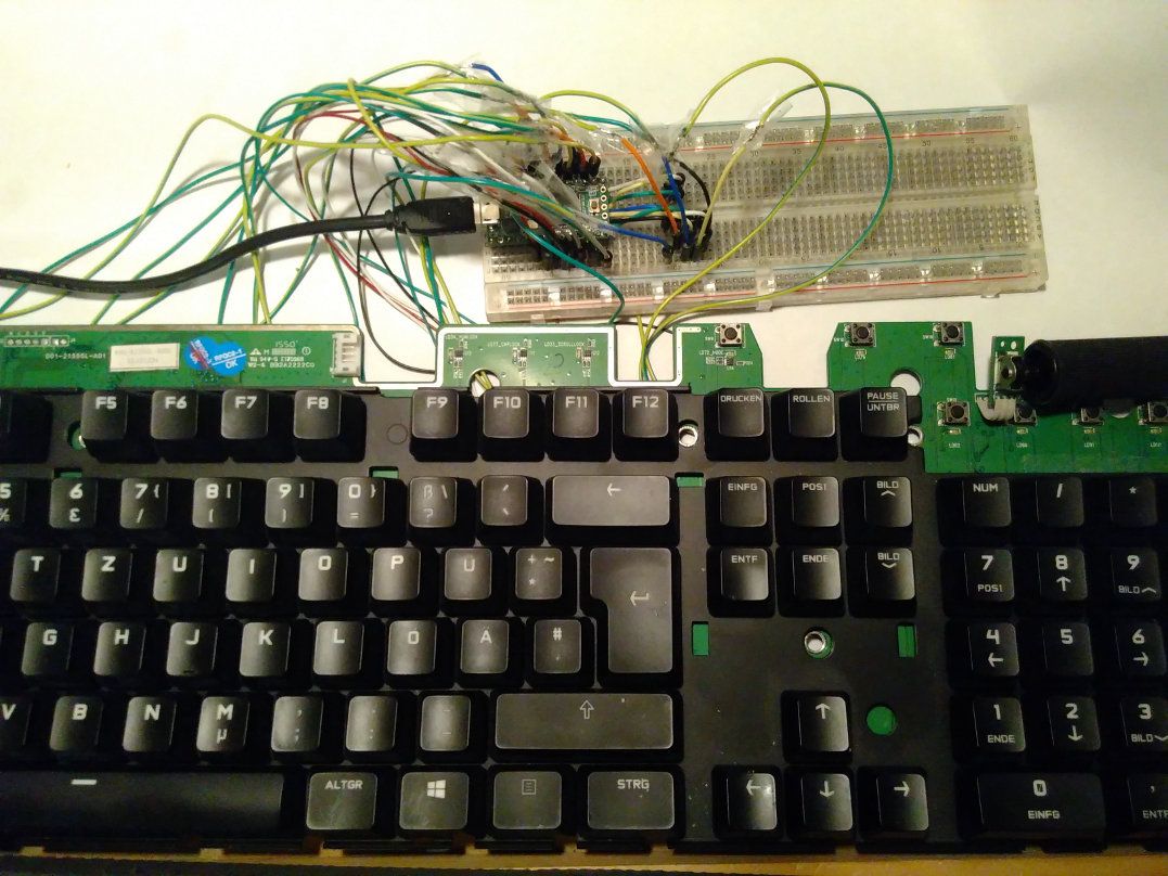

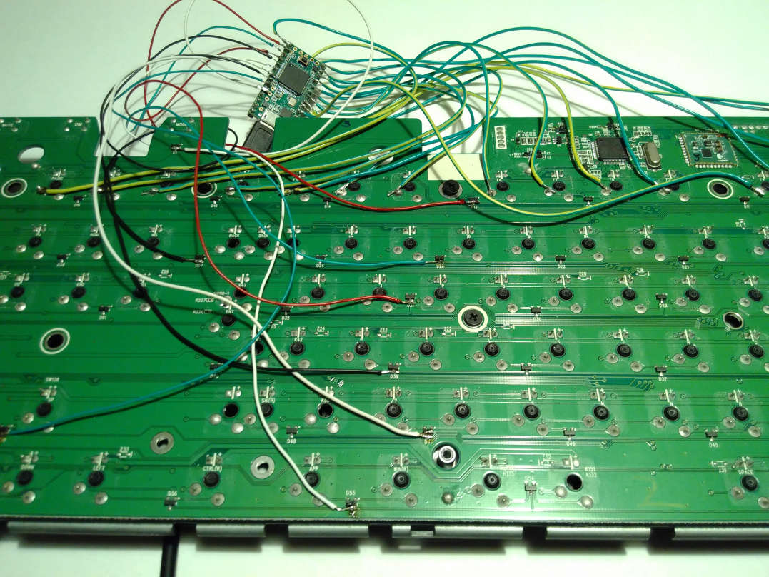

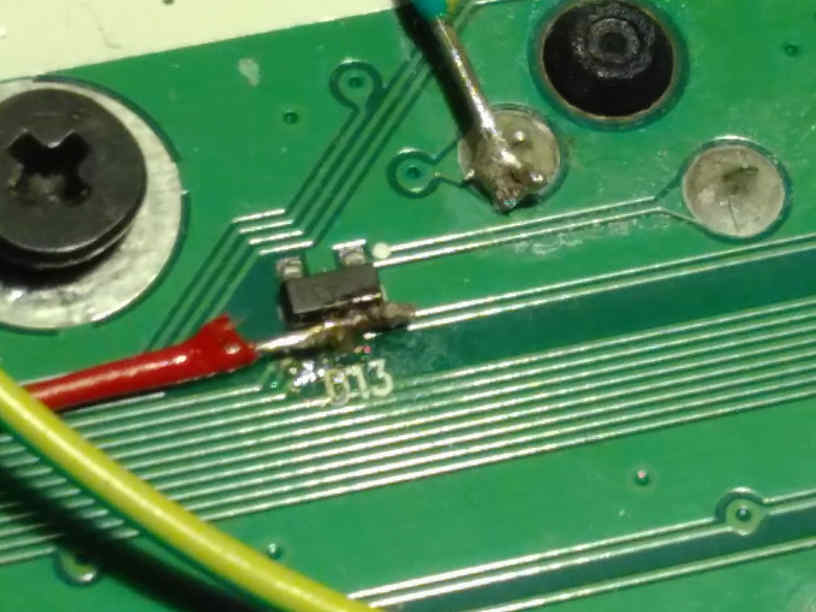

I now soldered cables to the keyboard.
The row cables need to be soldered to the bottom leg of the SMD diodes. The column cables need to be soldered to the left connector of the switches. (Pick one of the diodes in each row and one of the switches in each column.)
It was easier than expected. I feared I might accidentally desolder the flimsy SMD diodes, but they actually felt quite solid.
We tried to configure the matrix with QMK, but when flashed with the software, it did nothing. Not sure what the problem is. We then tested a little teensy program that can read if a key is pressed. We might now just write our own keyboard controller, just as a learning experience.
We did not remove any controllers or cut any traces. We'll find out if that will cause any problems.
Dilettant
02 Nov 2019, 11:24
I've now used the keyboard for several weeks successfully with a very simple firmware I wrote from scratch. Typing works flawlessly so far. No need to cut or desolder anything. Everything is still connected to a breadboard – the challenge is now to put back everything into the case.
