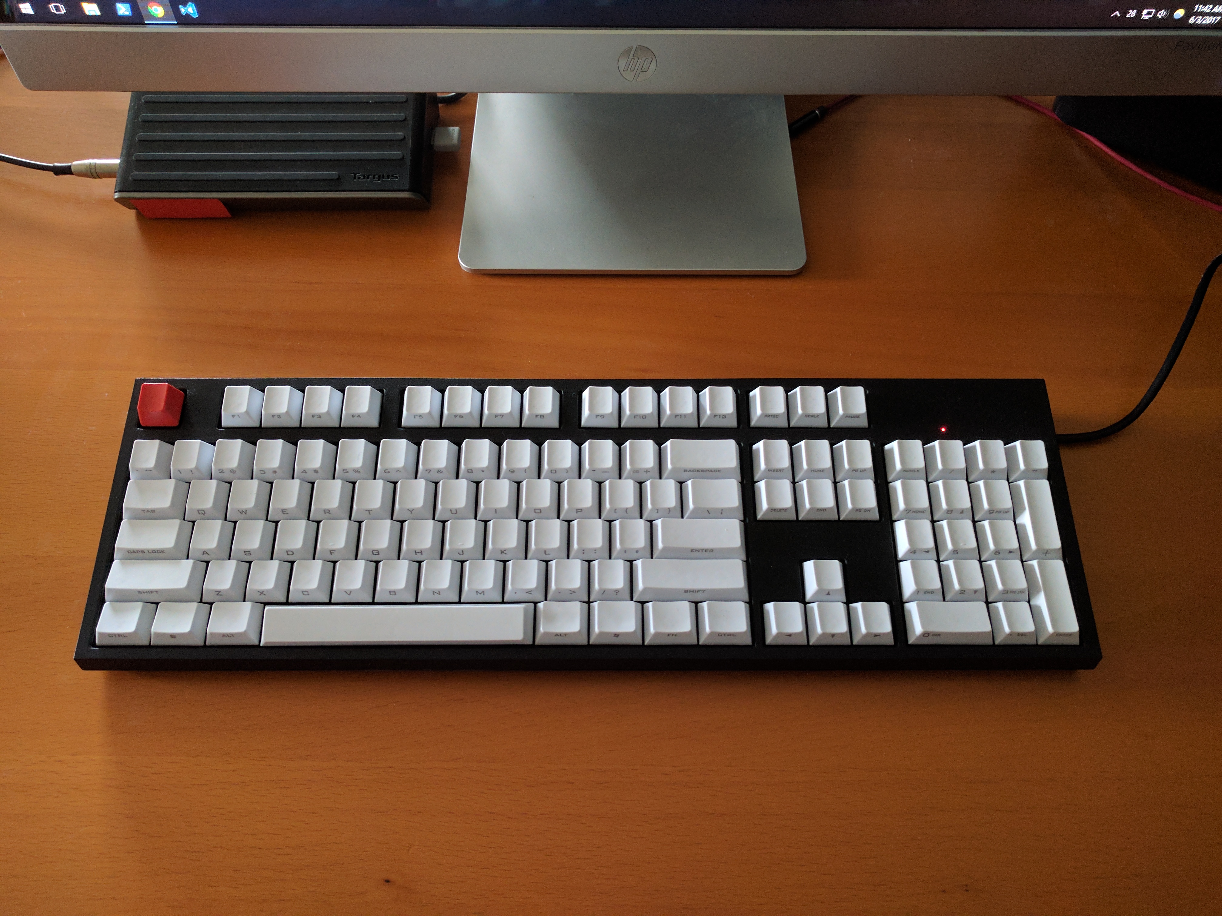

This is my first keyboard review, and it's been a long time coming. I originally won this keyboard from participating in the Deskthority Awards 2016. I received the board in early December 2016, and have nothing but nice things to say about ohaimark and WASD support, who threw in a bonus red ABS esc key for free.
I wanted to use my keyboard heavily before writing up the review, and it's been my primary board for the past 5 or 6 months. I'll start with Pros and Cons, and give my summary at the end.

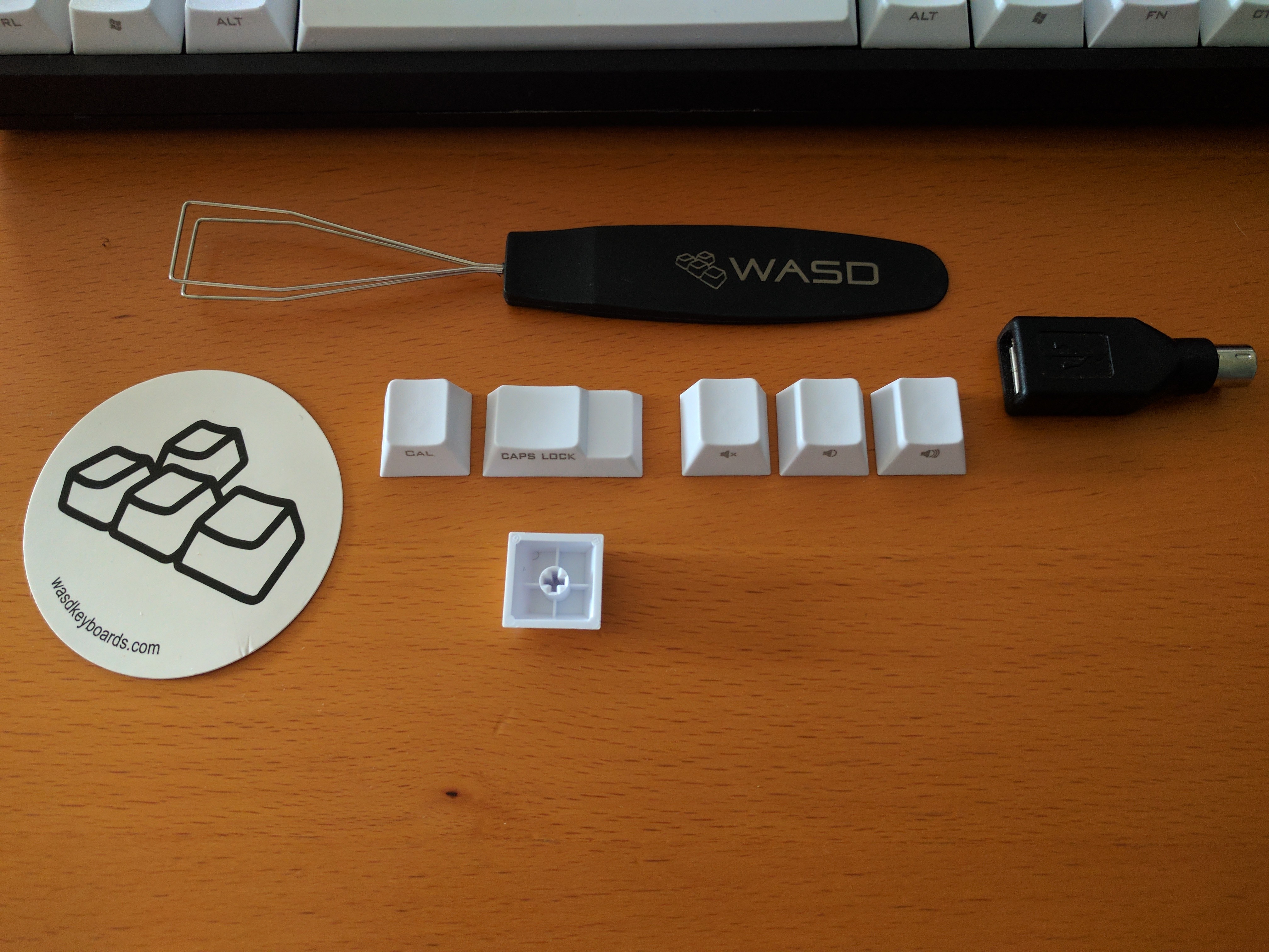

- Bonuses: A sticker, cap puller, PS/2 to USB adapter, and a few bonus caps.

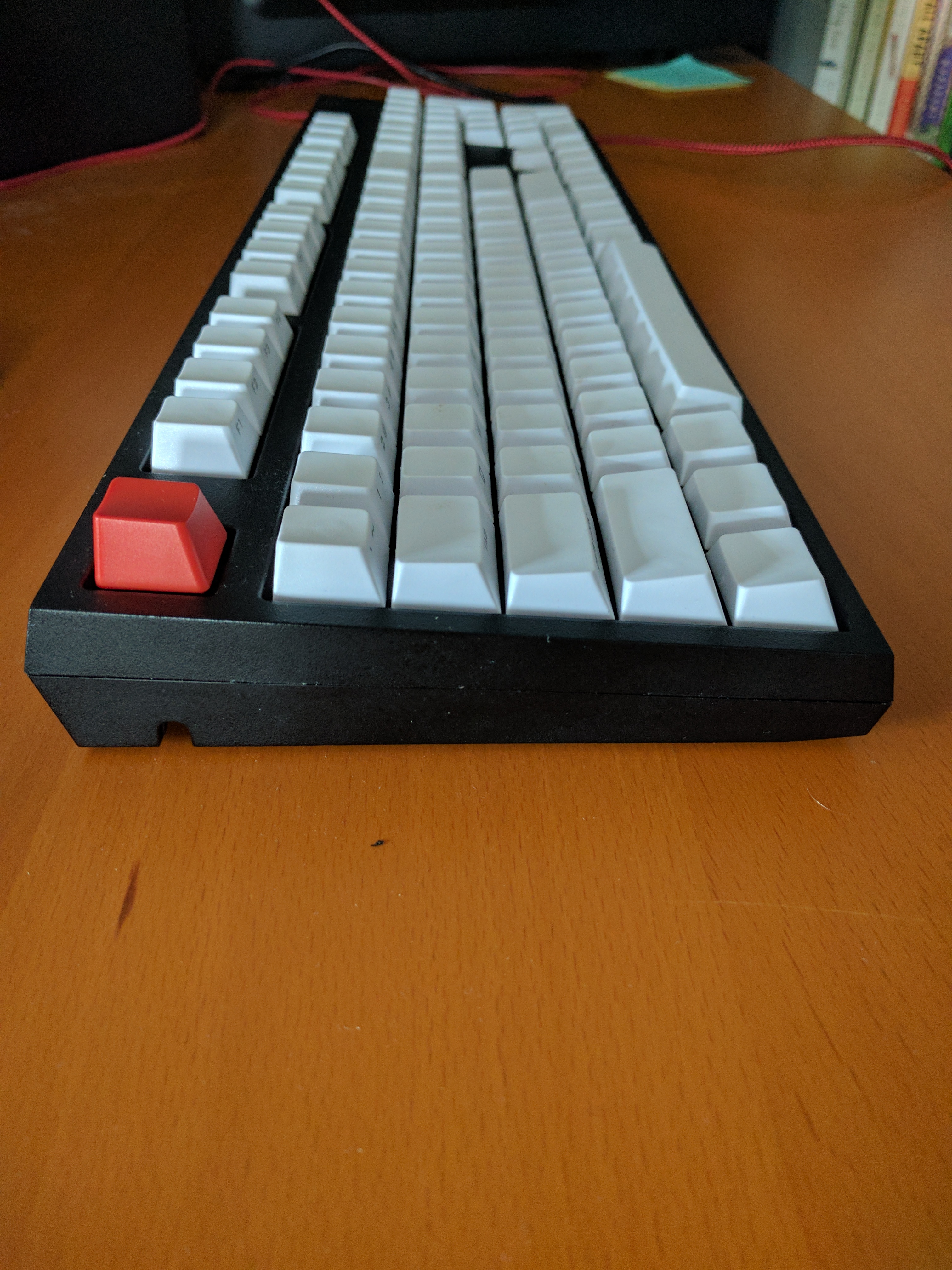

- The Case: The black plastic has a nice texture, which doesn't shine or show too much dust. But the way the housing is finished and put together leaves something to be desired. My $70 CM Storm has less flex in the case, with smaller gaps. The biggest issue is the case right in front of the spacebar, where I rest my thumb a lot when working. Pressing on it causes an audible creak, and it moves horizontally and vertically a few millimeters. I bottom out on a lot of my key presses, and I'm pretty certain that it would be quieter and echo less if the case were more solid.

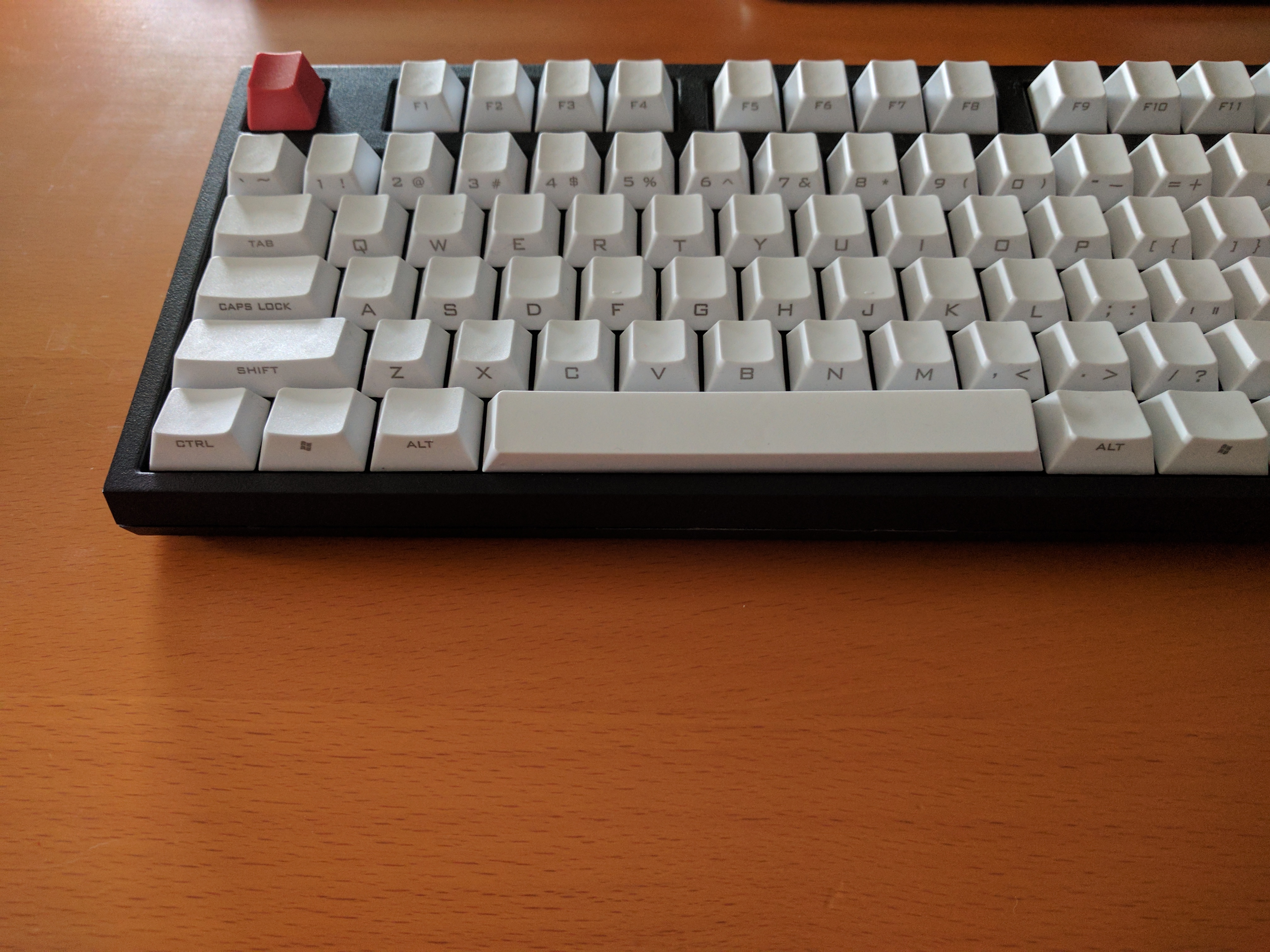

- Key stabilizers: This keyboard uses Cherry stabilizers, which work fine unless you hit the edge of a key. Particularly on the right Shift, hitting the key on the extreme edges causes the key to become lopsided, and you have to depress the opposite side to balance it out. I haven't had a key become stuck this way, but it can be annoying.
- Keycap profile: largely subjective, but the OEM profile isn't nearly as nice as Cherry profile. WASD does a great job offering custom caps, but there's a large amount of interest in custom keycaps and different profiles, and it would be great to offer additional profiles.

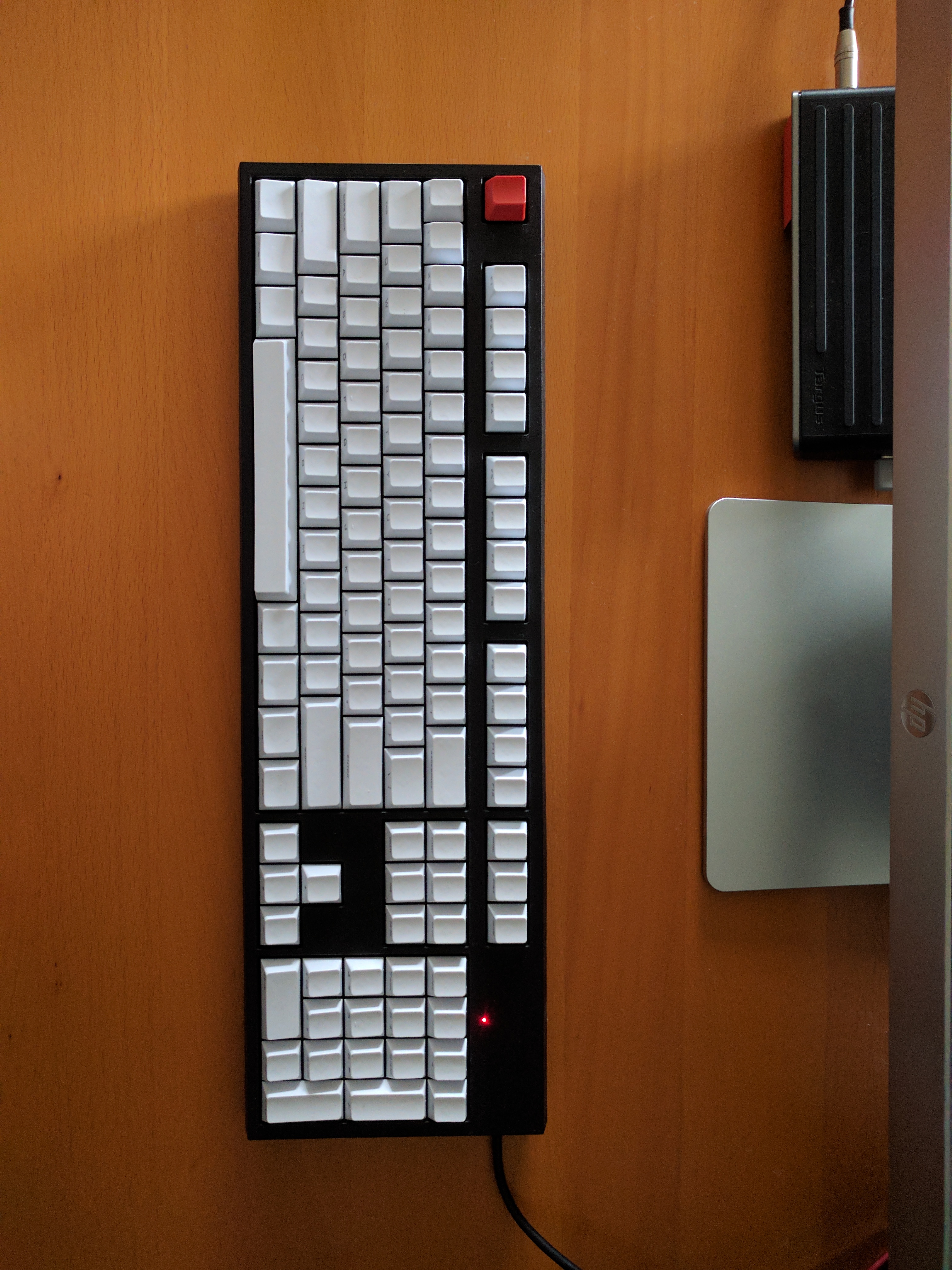

What's wrong with the space bar? It looks like it's about to fall off!
0100010
04 Sep 2017, 17:34
Spacebar has been flipped.
