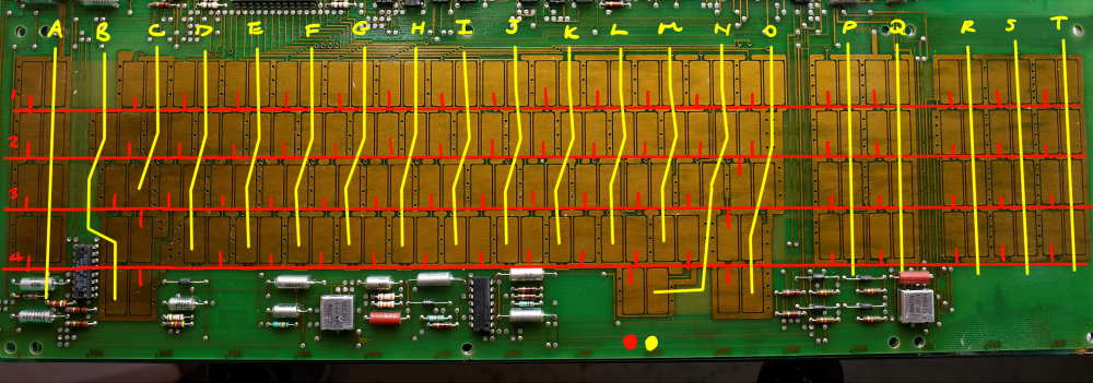

The proposed matrix:

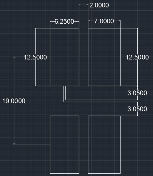

The row and column arrangement of early beam spring keyboards are a little obtuse so this redesign will incorporate a layout similar to that of late beam springs and capacitive buckling spring keyboards.
Row and column pad measurements:

- 6/26/17: Initial drawing of top pads completed, updated row pad measurements: workshop-f7/xwhatsit-cs-compatible-ibm- ... ml#p377420
- 6/26/17: Added matrix spreadsheet screenshot.

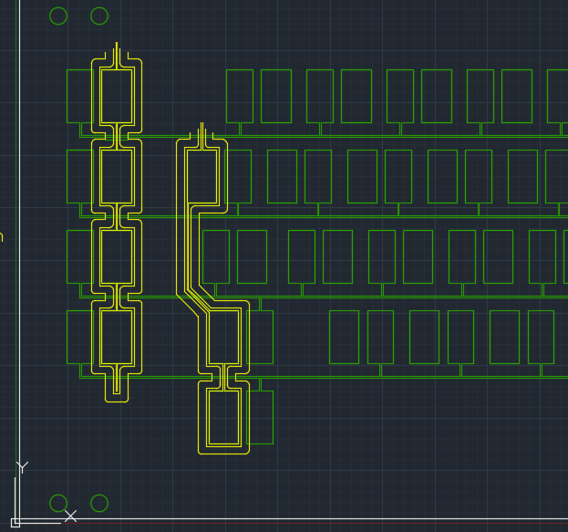

- 7/2/17: Initial drawing of bottom pads completed: workshop-f7/xwhatsit-cs-compatible-ibm- ... ml#p378039
- 7/4/17: Updated key spacing measurements, again. Initial drawing of 30-pin edge connector completed: workshop-f7/xwhatsit-cs-compatible-ibm- ... ml#p378307
- 7/6/17: Initial trace routing completed: workshop-f7/xwhatsit-cs-compatible-ibm- ... ml#p378590

I measured the pads on my 3277 using a cheap chinese caliper and they're ~ 7.5mm wide x 16.5mm tall. Has anyone else measured their pcb?

I sent Wcass 5251 beamspring guts including the capsense PCB for measurements and my thought is the best way to convert would be to take out all of the switches of the 3277 and use a flatbed scanner to scan the barrel plate face down and send the scan to Wcass. He should be able to use those measurements plus the capsense PCB info from my beamspring guts to put capsense pads below each barrel hole and make the pinout be that of a beamspring controller and be good to go. Would also do a scan of the underside of the barrel plates which would be useful for placement of the bolt holes that would need to go in the PCB as well.
The issue is finding enough people that have the larger 3277's for production though. There were recently about 10 mini data entry 3277's found by scottex recently here and I believe they are all spoken for, but that's enough right there to go with a group buy.
I was thinking that I could do the actual group buy and take the risk if things don't work. I think I can probably get the cost of the PCB's down to like $40 shipped to the USA at least for the mini ones to the USA and could package beamspring controllers with them as well. If the mini ones work, then would proceed to ordering full size ones as well.

Wcass gave me the measurements of your 5251 beam spring and I used some of those measurements for my CAD drawing.
There are enough owners of 78-key 3277s that I can run a GB for at least 5 PCBs through PCBWay or EasyEDA so finding people is not an issue. I was planning to take the risk of the PCBs not working myself; I would be happy to do things the other way around and produce the 78-key version first.

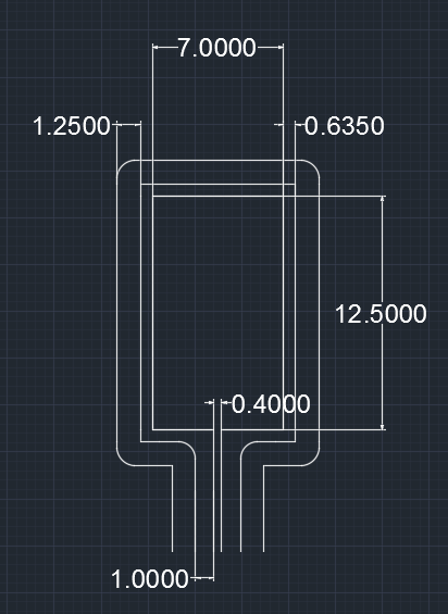

I have completed an initial drawing for the top row pads as well as the bolt holes and attached a full-sized SVG and PDF. If anyone with a 3277 would like to print out and test the drawing, I would appreciate the extra feedback.
I also updated the row/column key spacing, using a 19.125mm spacing now. This should be pretty close or it, but a more accurate measurement would be great.

This is remarkable. I printed the pdf and the holes and pads line perfectly with my pcb. Great work! 8-)

Thanks, the extra measurements would be great! I measured the thickness of my 3277's PCB and got ~1.2mm.

That's swell, I also printed out the PDF to check and everything to seems line up pretty well. I noticed that the two center bolt holes were off and corrected them.
I'll work on the column pads next.

Small update: I don't think the column "shield" should be overlapping the row pads, at least from what I can tell from other beam spring and capacitive buckling spring keyboards... Might lead to unwanted capacitive coupling or something (not an EE, clearly)? May have to take another look at the column pad measurements.
EDIT: Ah, I think I see now that the purpose of the shield/guard is to prevent that. I'll probably change the width of the ground trace to be safe.

The PDF also includes a drawing for the 30-pin edge connector that is just floating above the pads. That is not the final placement, of course, just had it in there to compare to the edge connector on my Model F PCB. It looks fine, but feel free to check that too.
If anyone is curious about how I'm testing these drawings - I print them on vellum paper and overlay them on the switch mounting plate as well as the PCB.
EDIT: @ipreferpie, thanks for the photos. I may just make your PCB a separate design. I'm hoping that the other mini 3277s share the same pad placement. Since I don't think the full-sized PCB will be going to anyone with that particular layout, this iteration of the PCB will probably be the final design for the full-sized 3277.
