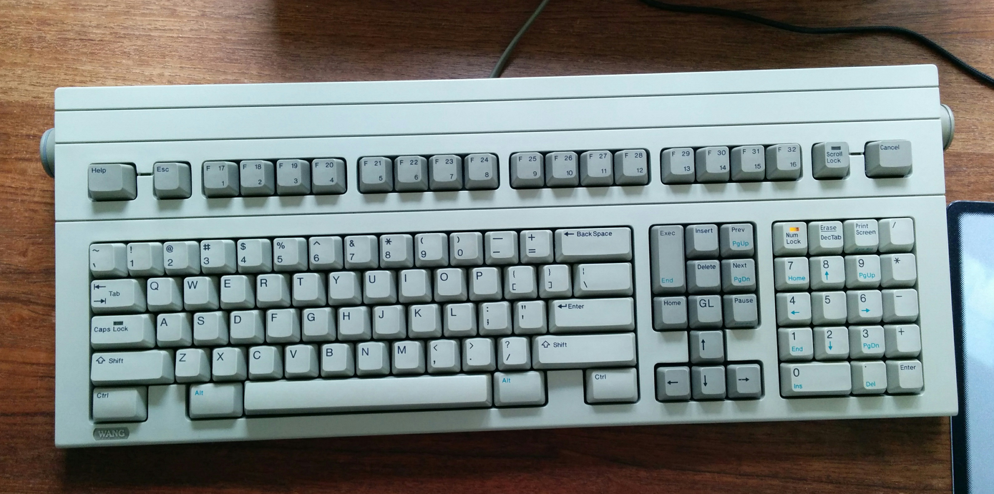

I recently got a Salmon Alps-powered Wang 725 (thanks //gainsborough for the trade), which I enjoyed quite a bit. I wanted to start using it at work, but that would mean I would have to kill off the built-in speaker.
Instead, I decided to replace one of the switches (which wasn't working as its solder pads were busted) with an SKCL Lock switch from an AEK and wire the speaker to it instead.
(potato camera warning)
Just in case, I used some electrical tape to separate the SKCL Lock switch contacts from the PCB:
I sliced up one of the speaker's original cables, but on reflection, I should have just desoldered it from the speaker and use it for one of the switch contacts:
Here's how it turned out:
Overall, I love this board. The soundtrack, keyfeel and orange LEDs are fabulous, and now I have a way to use it at work for longer than it would take my co-workers to organize a lynch mob :)

Interesting, is the speaker not adjustable on your Wang 725 then or did you just want to do this anyway?
macboarder
14 Jul 2017, 17:27
It has the volume control working fine, but even on the lowest setting it still makes a noise (granted, drowned out by the switches themselves, but still). I wanted to add a way to turn the speaker off without making it permanent nonetheless.
