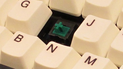

Switches. Apart from the programmability in the Type R, which is excellent, or the RGB LEDs in the Polestar variant, the Type R is still a V60. Thus far, the switch options of the Type R only include Cherry mx (Red or Grey Linear, Blue or Green Clicky, Clear or Grey Tactile). As yet, the Type R is not available with Gateron or Matias switches. I hope that KBP will add Gateron and Matias options to their Type R lineup.
Stabilizers. Like the standard V60 with Cherry or Gateron switches, the Type R has Cherry stabilizers, which to me feel mushy. I much prefer the wire Costar-type stabilizers, like those that KBP uses in their Matias-switch V60 models. Vortex has modified the Cherry-type stabilizers in the Pok3r, and they feel less mushy than the standard Cherry stabilizers in the V60 and V60 Type R. The stabilizers in my keyboard were also a bit rattily, but this was satisfactorily addressed by lubricating them with some Superlube 21010 synthetic grease.

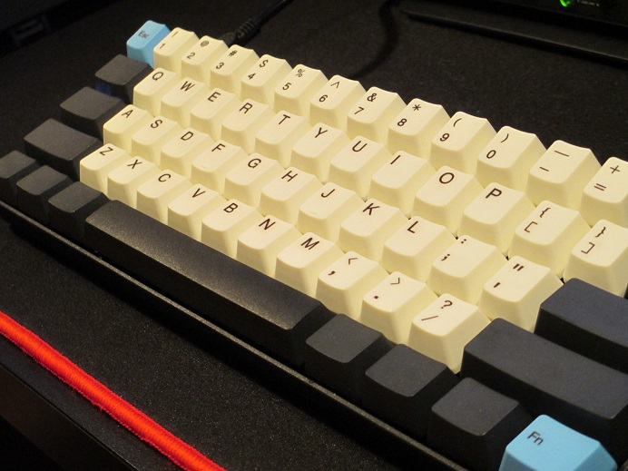

I changed the keycaps, using a mix from sets of OEM profile thick dye-sublimated PBT caps from Ducky. The alphas are black on cream, most of the mods are dark gray, and the two accent keys (Esc and Fn) are black on blue. I also silenced the spacebar somewhat by placing a red 40A-L 0.2 mm O-ring on the center stem. To my eye and fingers, the new caps look and feel much better than the stock caps, but I think the keys sounded better with the thin ABS caps -- thick PBT is sometimes overrated in this respect.
