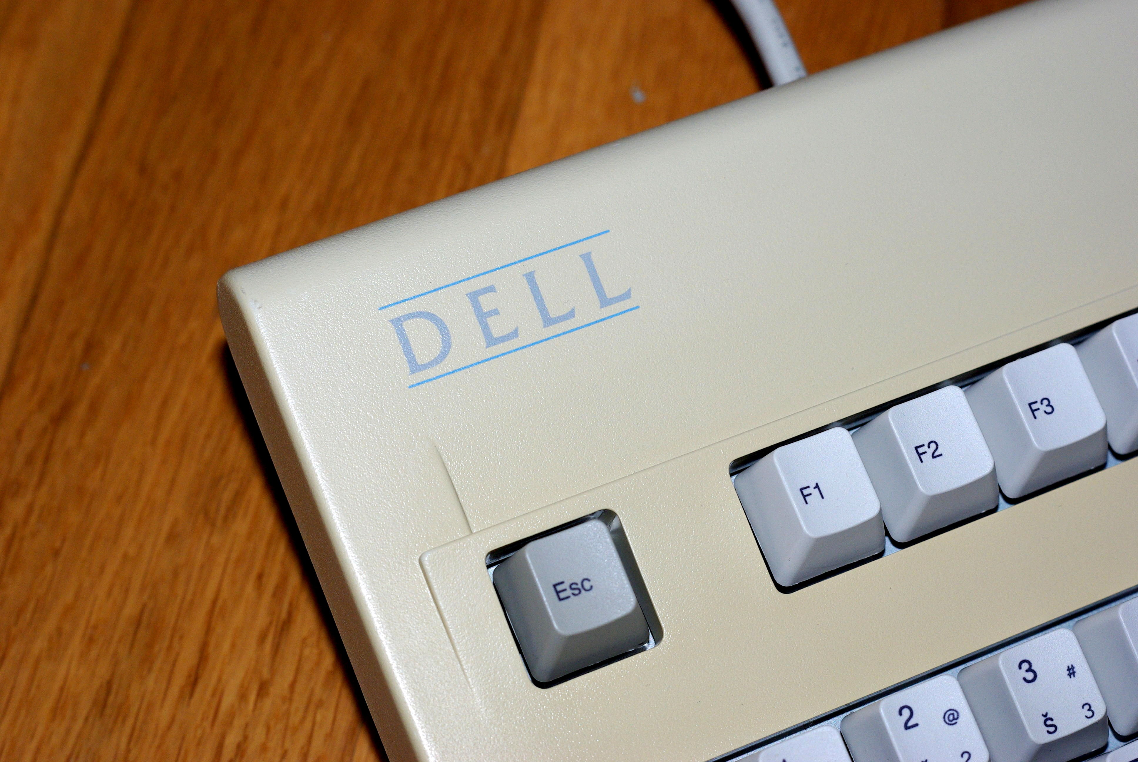

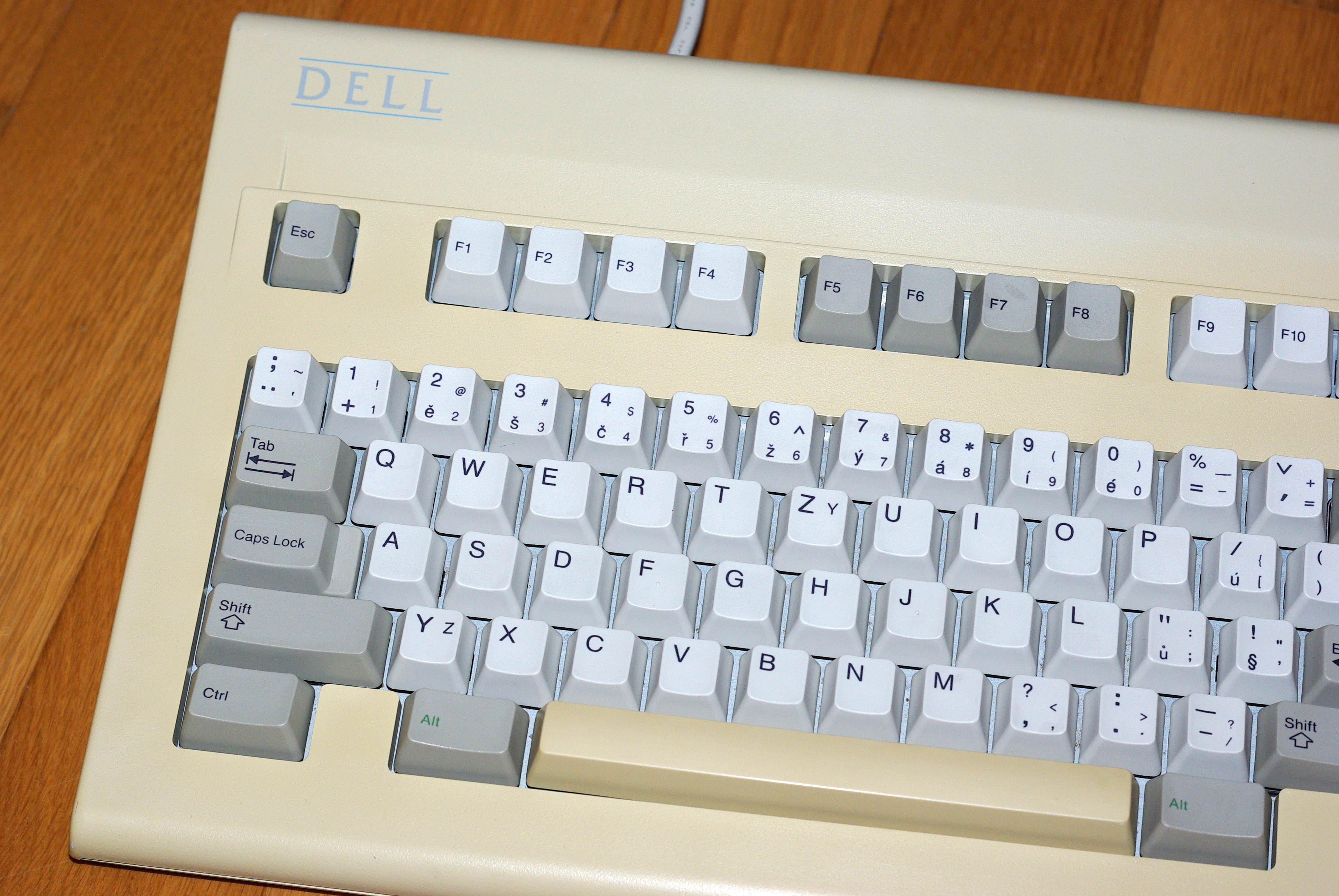

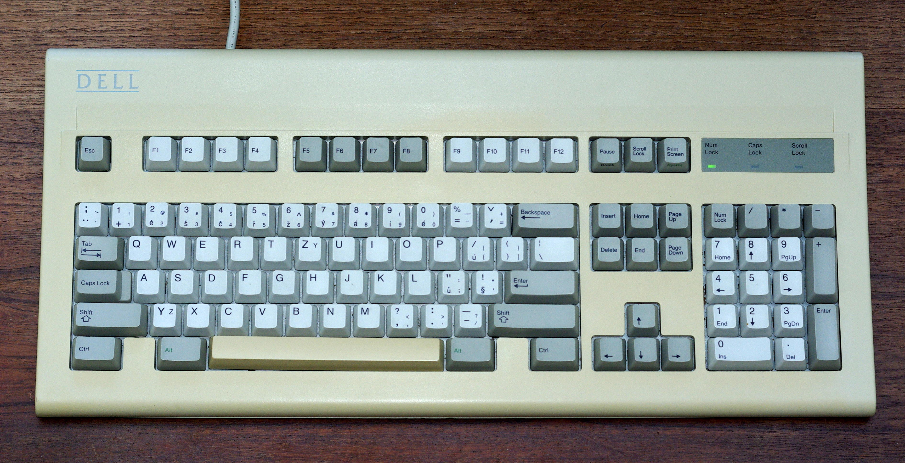

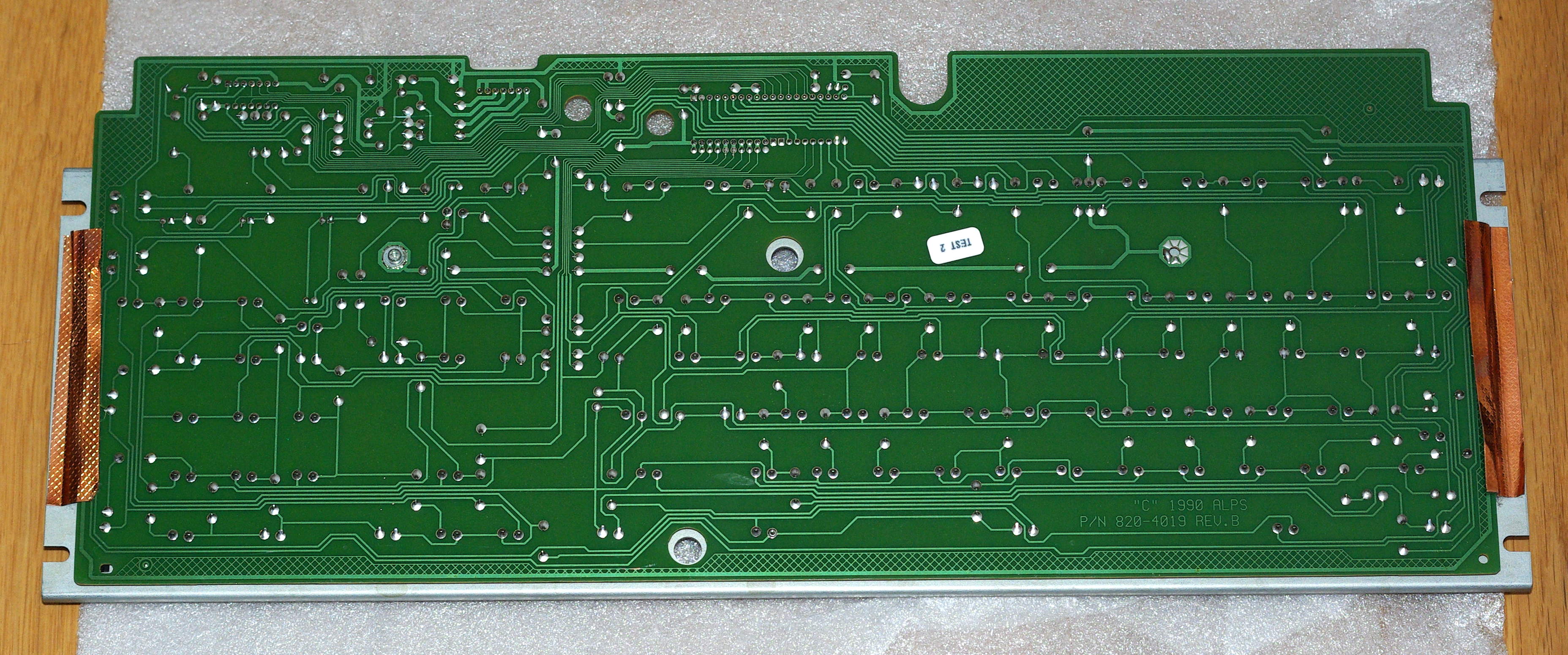

This is the very common Dell AT 101 in a not so common varaint; case & spacebar are still yellowed but that's fixable. These old Dells are quite uncommon in the EU, this particular one being manufactured in the USA.

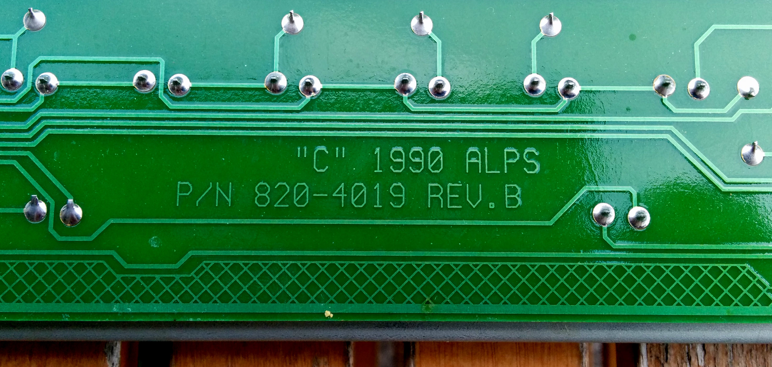

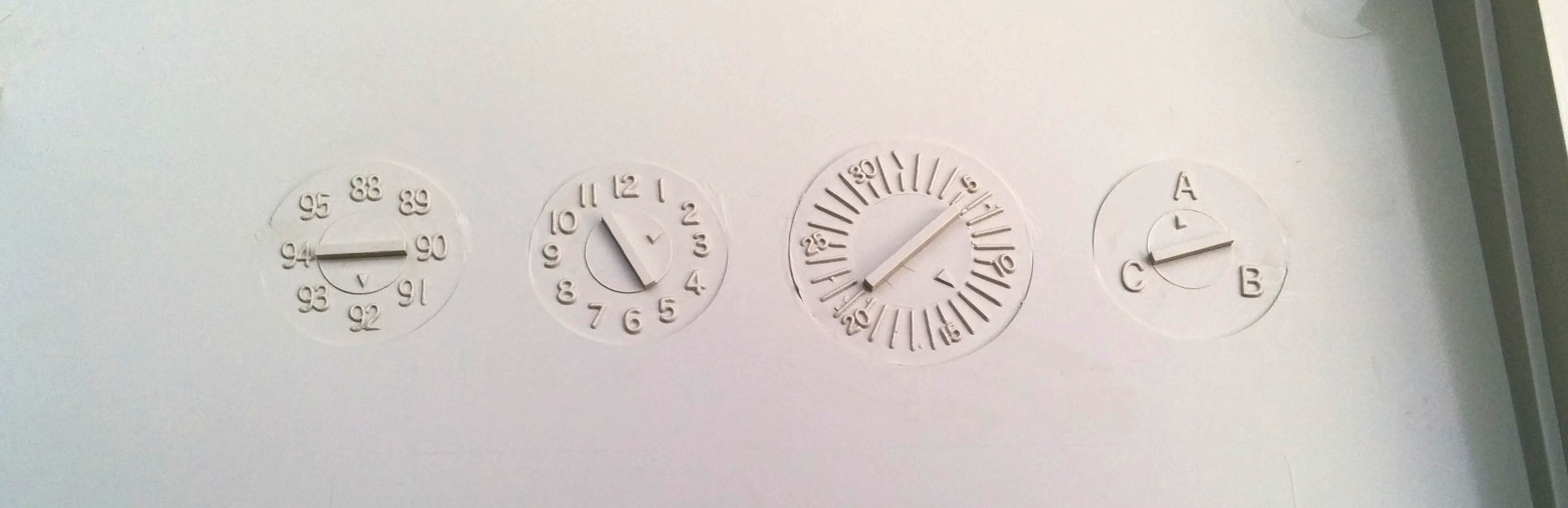

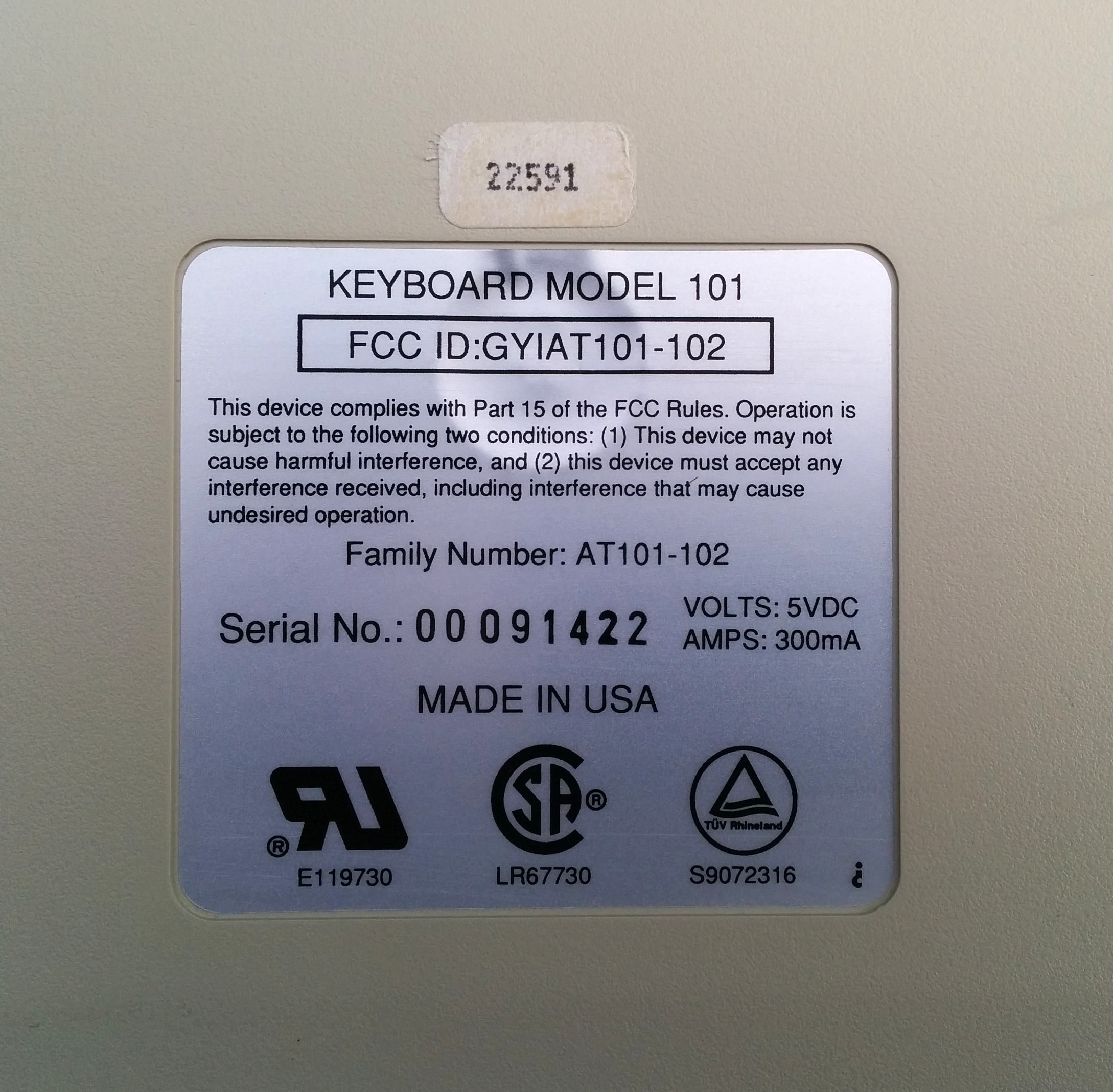

While the PCB reads "1990 ALPS" the case reads "2/92" which is around the time production transferred to Silitek. This is interesting because we've had some "unusual" discoveries regarding keycap printing on Dell AT's. You tell me what these keycaps are...

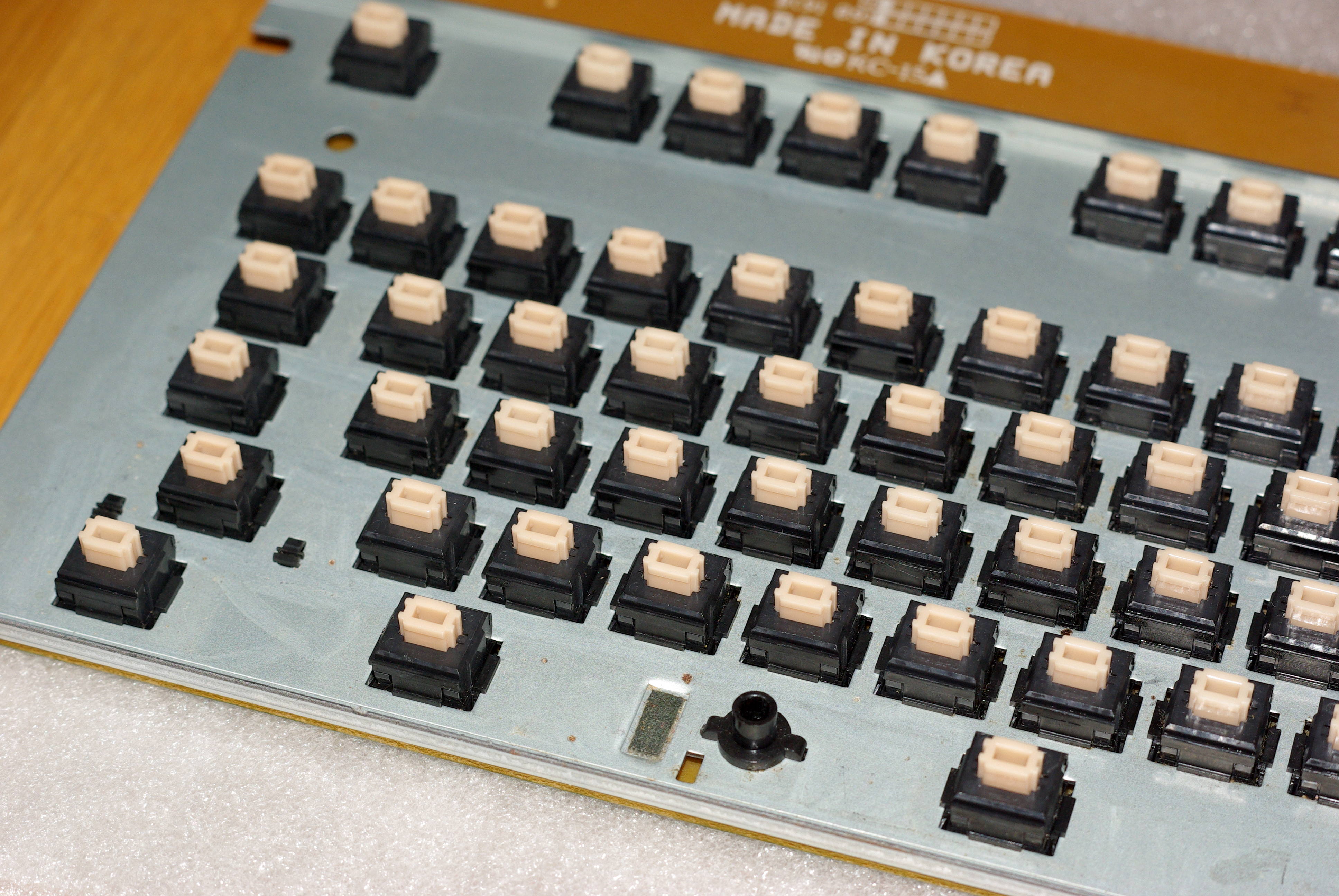

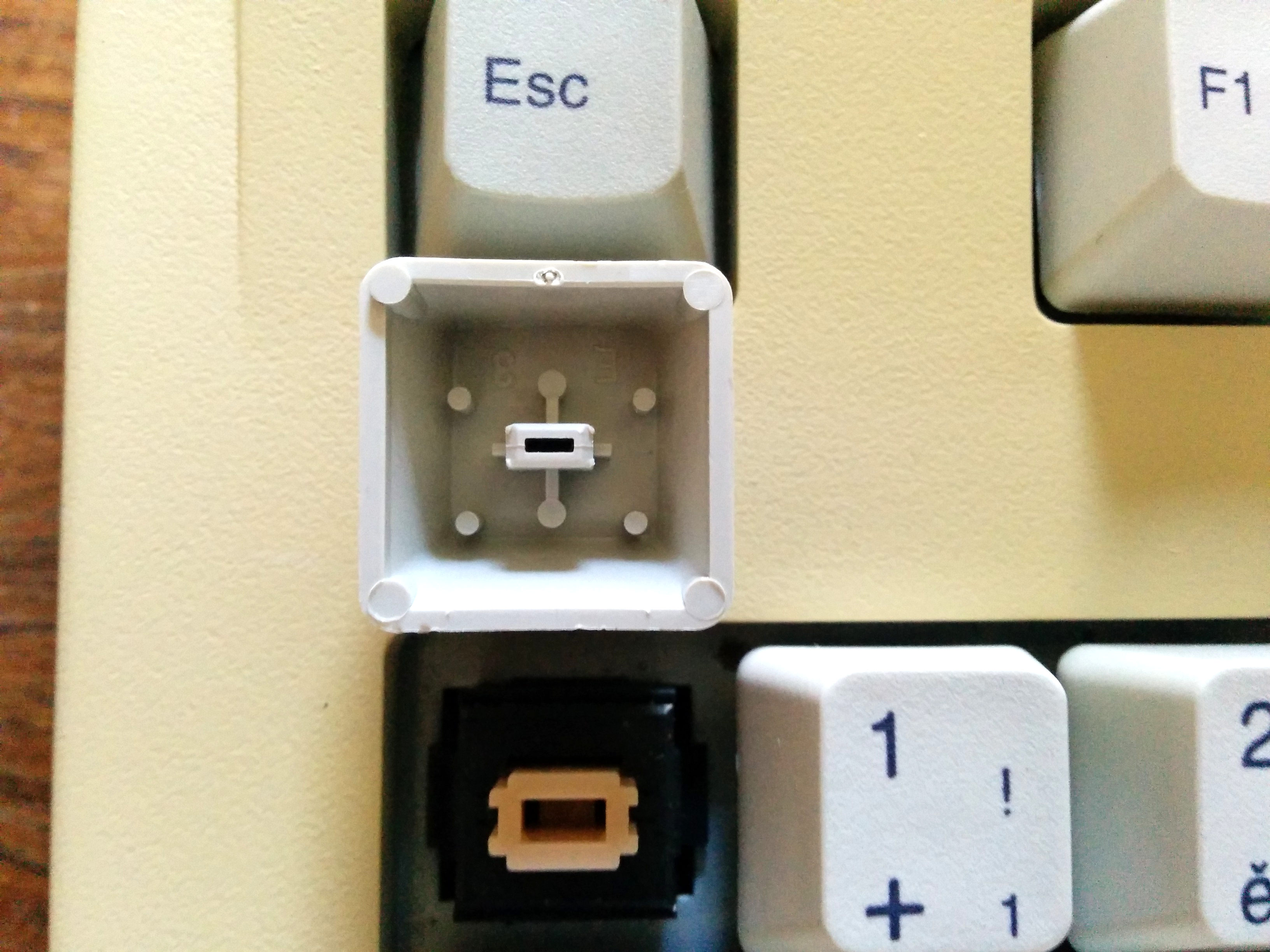

These salmon Alps SKCM are in a good shape for their age, the tactility & smoothness is still fine. The salmons are quieter than the orange Alps yet still provide tactile feedback.

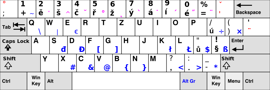

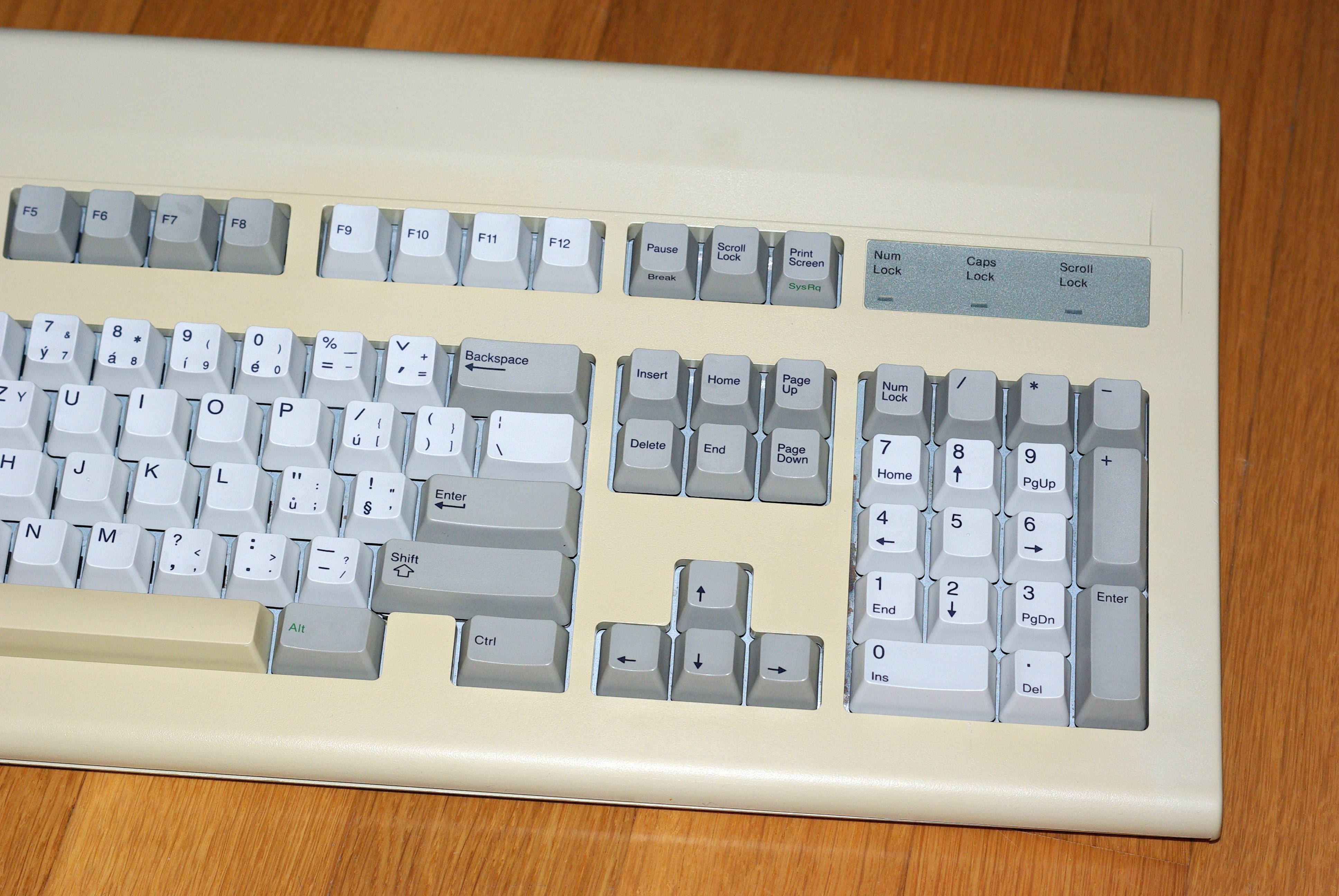

I like this layout with the dual "Z" and "Y" and secondary symbols on the top row. Also ANSI enter and large left shift, this is what ISO should always look like. A bit like on my symbols only M0115 layout.
In terms of overall quality this is very silimair to the SGI granite series, this is the Dell AT 101 to own really. It's generally a gamble with these old Alps SKCM keyboards in terms of what you get and what's fixable and what that is worth to you.

Oh, beautiful! I've never seen an AT101 with sub legends before. I'm really liking this one. It's interesting that it has an ANSI configuration but suited for typing in Derman. ANSI DE? That's pretty awesome.
Both that and the fact it's made in the USA as opposed to their facility in Ireland (it'd be closer at least), is quirky.
Very cool! Do you know of any other AT101s documented with sublegends, seebart?
21 Jul 2017, 14:52
E3E wrote: Oh, beautiful! I've never seen an AT101 with sub legends before. I'm really liking this one. It's interesting that it has an ANSI configuration but suited for typing in Derman. ANSI DE? That's pretty awesome.
Thanks, it's not a German layout that's for sure. I think it's some varaint of Czech QWERTZ:
https://en.wikipedia.org/wiki/QWERTZ
E3E wrote: Both that and the fact it's made in the USA as opposed to their facility in Ireland (it'd be closer at least), is quirky.
Right, definitely for export but I'm not sure if all AT101's for the European market were manufactured in Ireland.
E3E wrote: Very cool! Do you know of any other AT101s documented with sublegends, seebart?
No I have not seen other Dells with this layout but they must exist in smaller numbers.
E3E
21 Jul 2017, 15:03
Oooh. Haha, I saw QWERTZ and I immediately thought DE. I forgot that Czech also has that. I have a little Sharp PA-1000 that was in Czech layout. Oops, no, it was Slovakian. :O
Yeah, true. Not all of them would, though I believe most of the ISO ones I've seen were from Ireland. The very early AT101s were made in Japan. They lacked any serial numbers and had SKCM Black (pine).
Interesting stuff, and thanks for the clarification!

The caps are dyesub PBT. It's an Alps bigfoot made in their USA plant. Alps usually made European models in their Ireland plant, but apparently they did some EU ones in the USA as well.
Silitek used a different process for printing the logo on the case, by the way. Even the old-logo ones look very different between the Alps version and the Silitek one. Silitek also never used PBT caps or salmon Alps as far as I know - they appear to have had a completely different manufacturing process set up just for the production of this keyboard. I'm pretty sure that Alps only supplied the switches, or maybe not even that, and that Silitek manufactured them in-house. Silitek Alps keyboards are so far outside of the Alps timeline that it's quite clearly a different production branch.
Thanks for the infos. My question is if I retrobright the case will the logo take damage? The layout is definitly some sort of Czech QWERTZ variation.

You should have no damage if you Retrobright the case, Seebart. :) I did so with my first Dell AT101, and the logo was just fine. It's a pretty hardy printing method that they use.

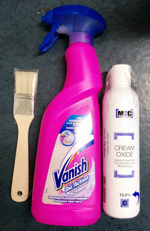

Be careful never to let the creme dry if you use it. In my experience, any time it has dried, it will leave bleaching under the film. I like using a thinned out cream for any tricky areas, like vertical surfaces, and the liquid H2O2 mix for everything else. :)
Good luck!
Now that I think back, I actually used creme on the AT101 when I did it. It was one of my first indoor Retrobrights. I ended up with a little bleaching on the case. The creme is pretty awful if you don't thin it out a bit. After it is thinned, it doesn't have the tendency to bleach nearly as much.
I've used liquid H2O2 + Distilled Water + Liquid Oxygen bleach to thin out the creme.

From some posts that I read, one actually doesn't need any UV light to bleach ABS with Retr0Bright and with these.
I've had good experiences with this cream but I never tried the powder sofar:

I'll also have to fix up the switches. They were the dirtiest Alps I had ever come across and sonicating them did no good. They'll need housing swaps. :?
