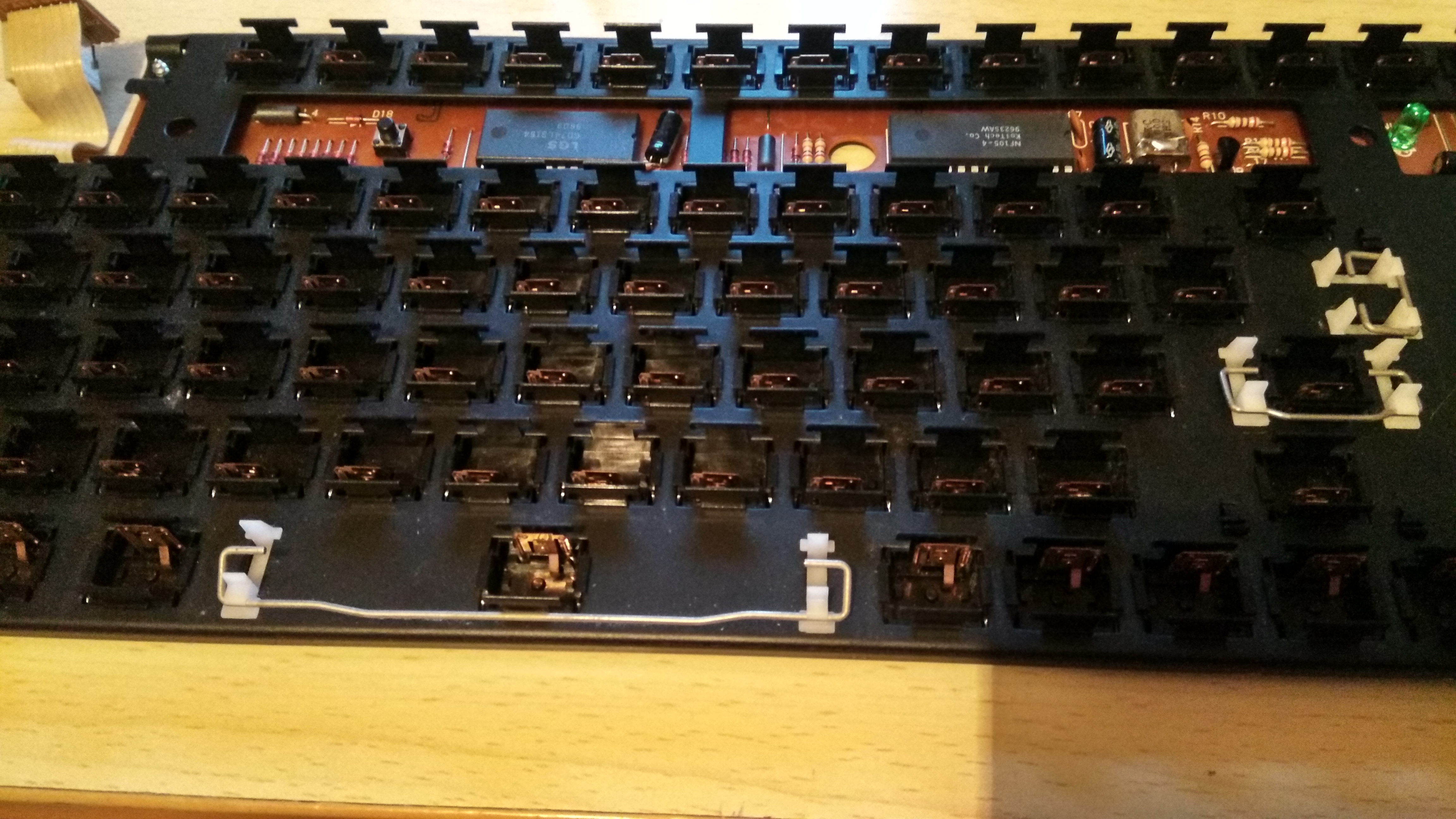

Welcome to my little sekrit dokumantation of my alps modding field trial.

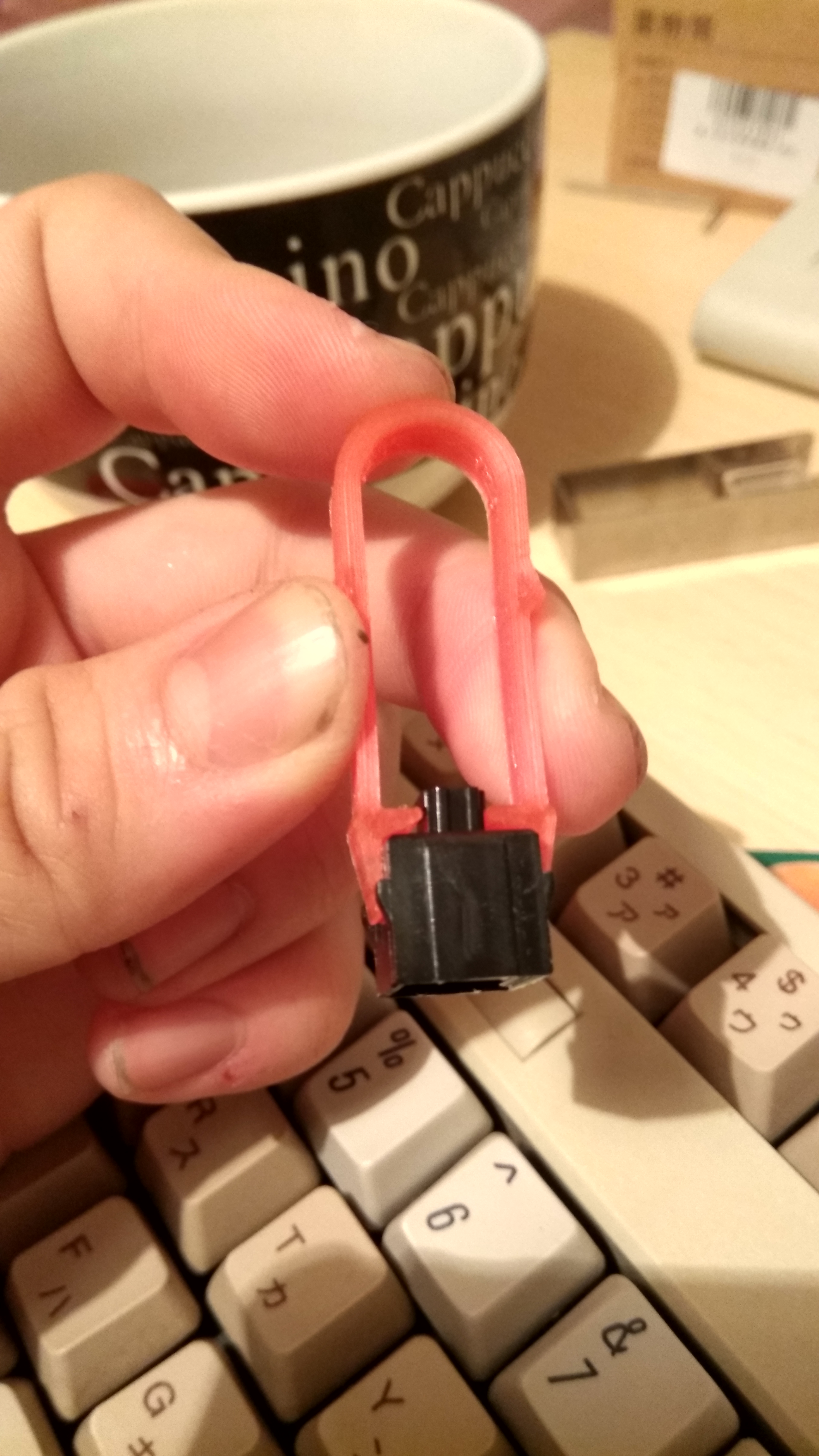

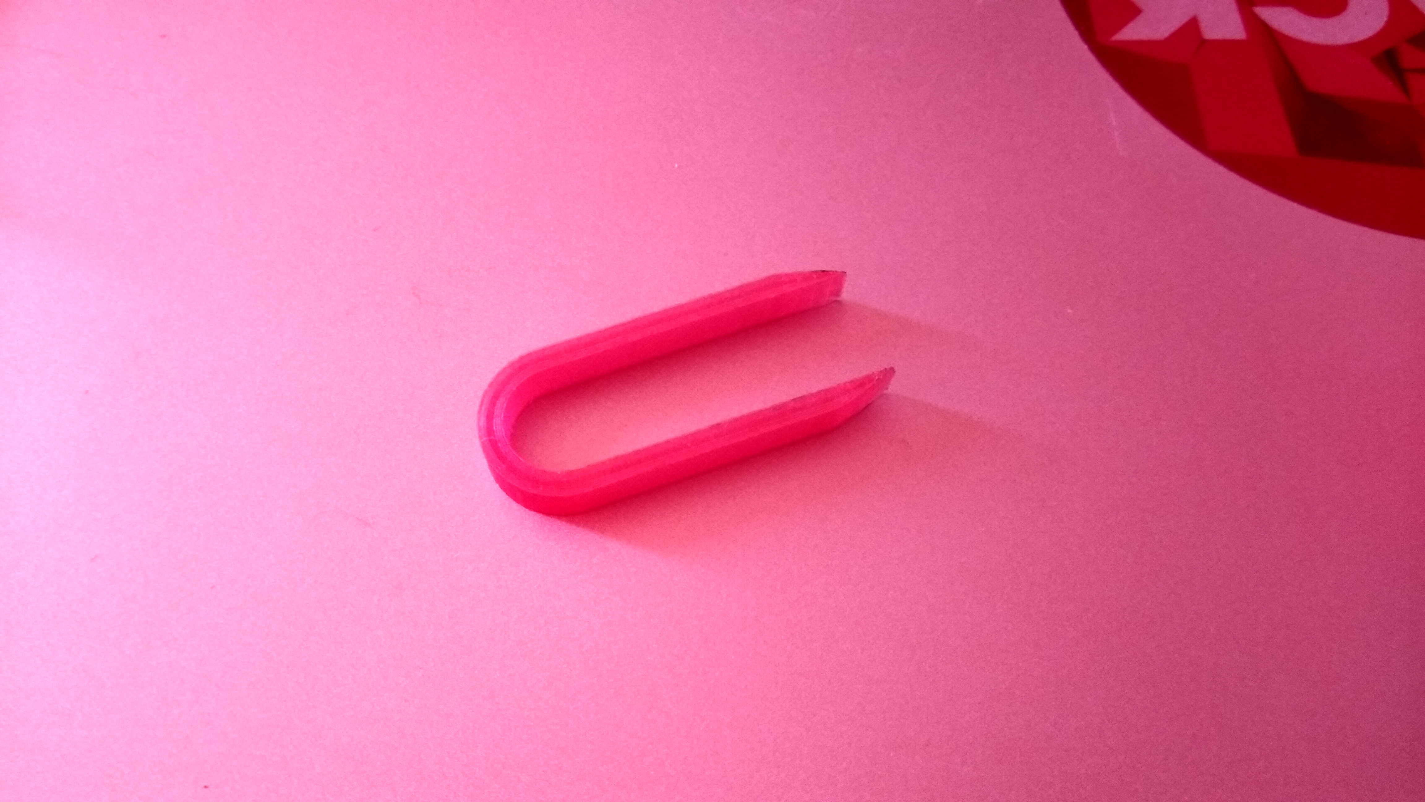

I have printed a special tool designed by yours truly, wingklip gaming, and succeeded in removing all of the switch housings in a little less than ten minutes.
Below I will post some photos and stuff when I get home, but here is some experience I would like to share:

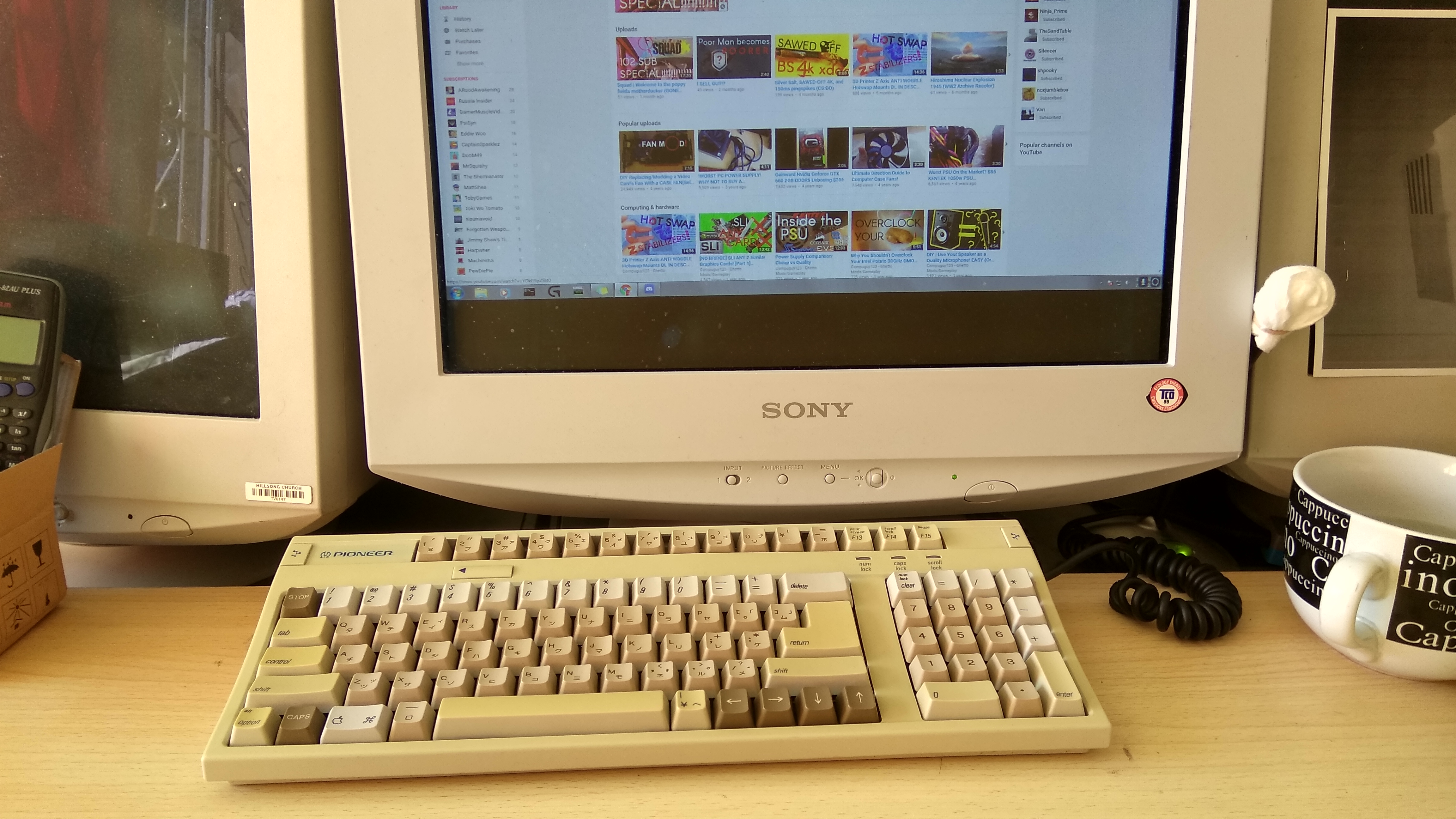

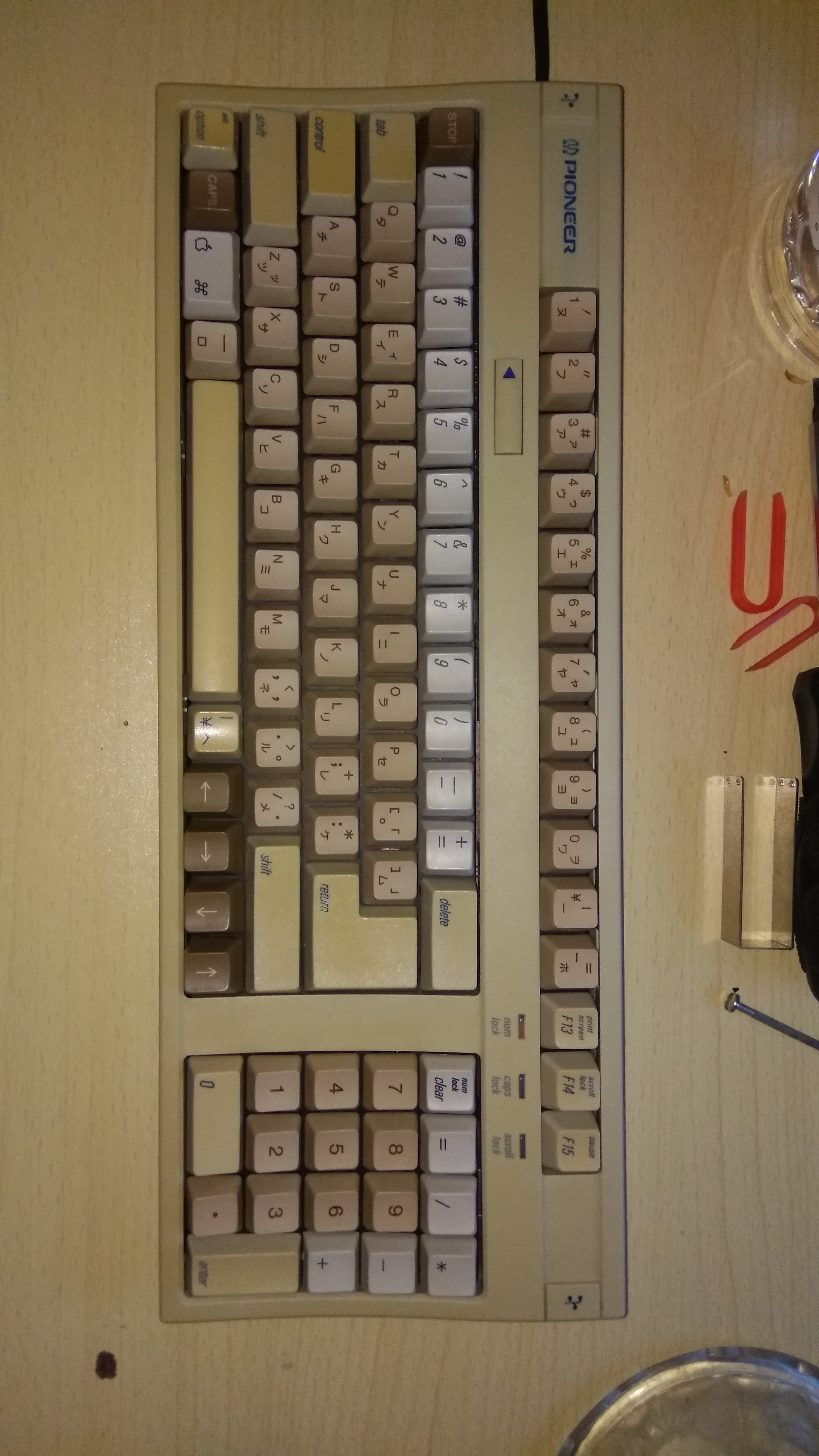

- Remove keycaps with IBM metal cap puller (bent piece of metal with stamped protrusions either side, comes free with the 6113442 keyboard)

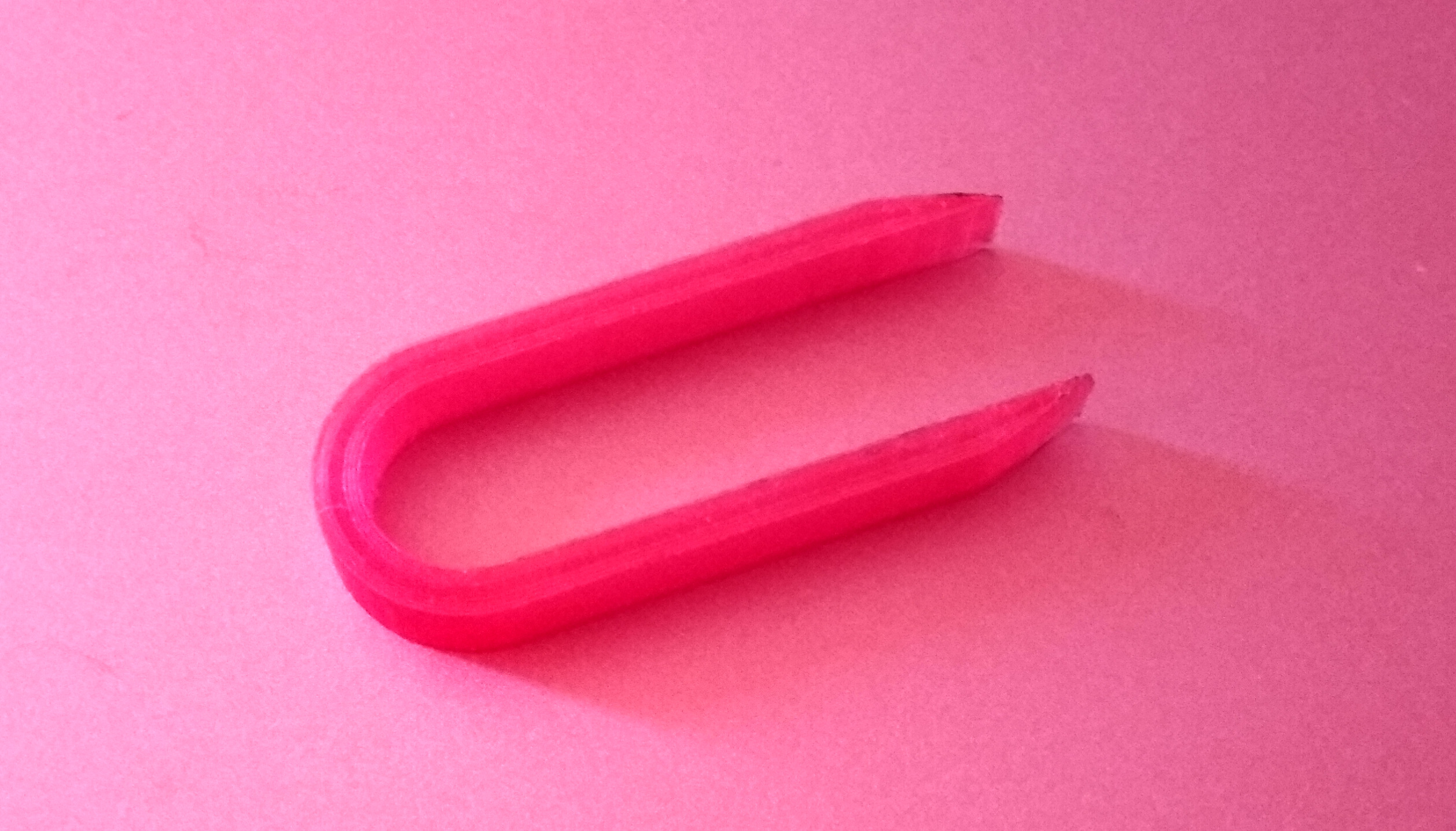

- Remove the switch housings by hand with the aid of a pryer I printed and designed (patent pending????///???))
- Snap off the 4 tabs of the switch tactile leaf by bending it parallel to the plate and then back again a few times using small pliers. PSA: Hold it VERY gently on the flat part, do not pinch together the bent part
(BE VERY CAREFUL, OR YOU WILL BEND A SIGNIFICANT PORTION OF THE CLICK LEAF)

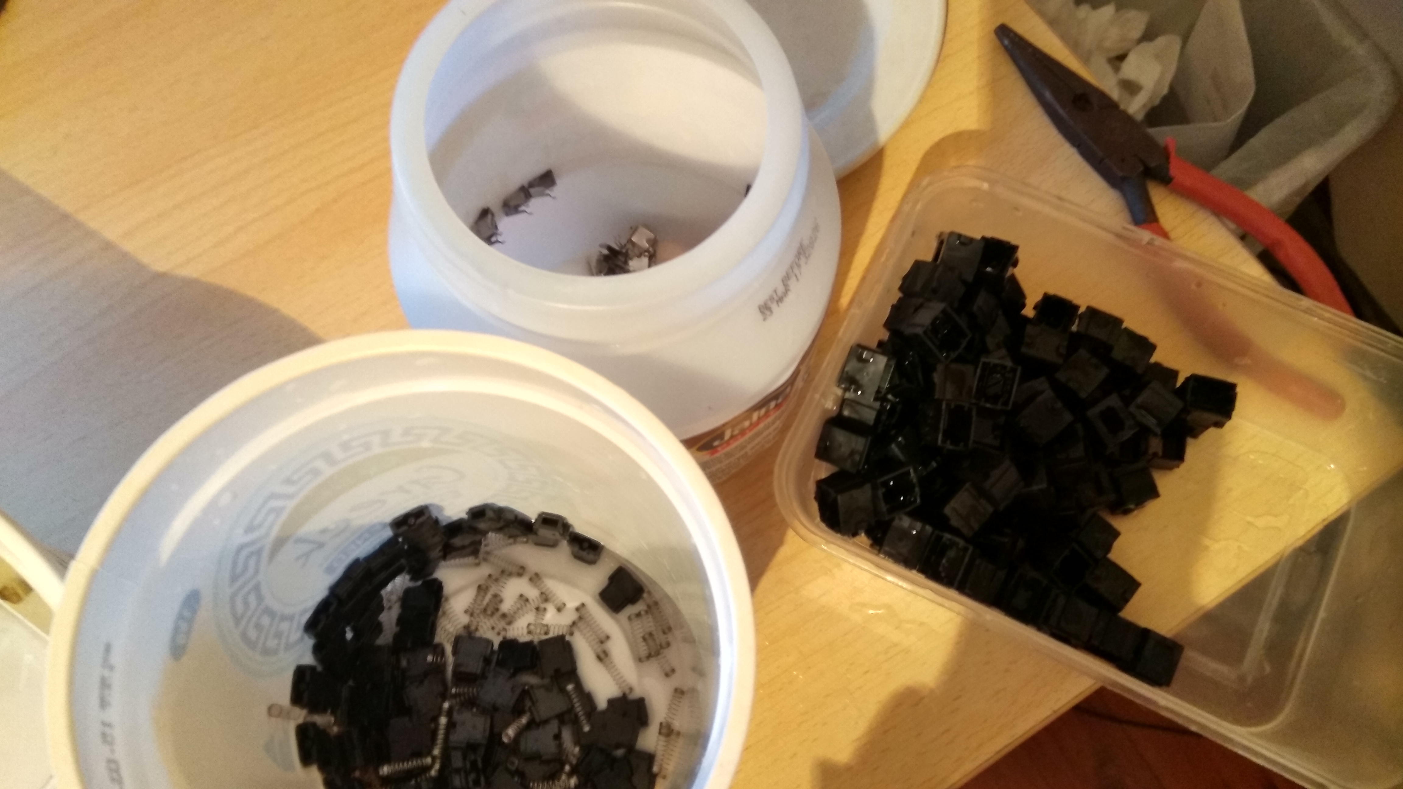

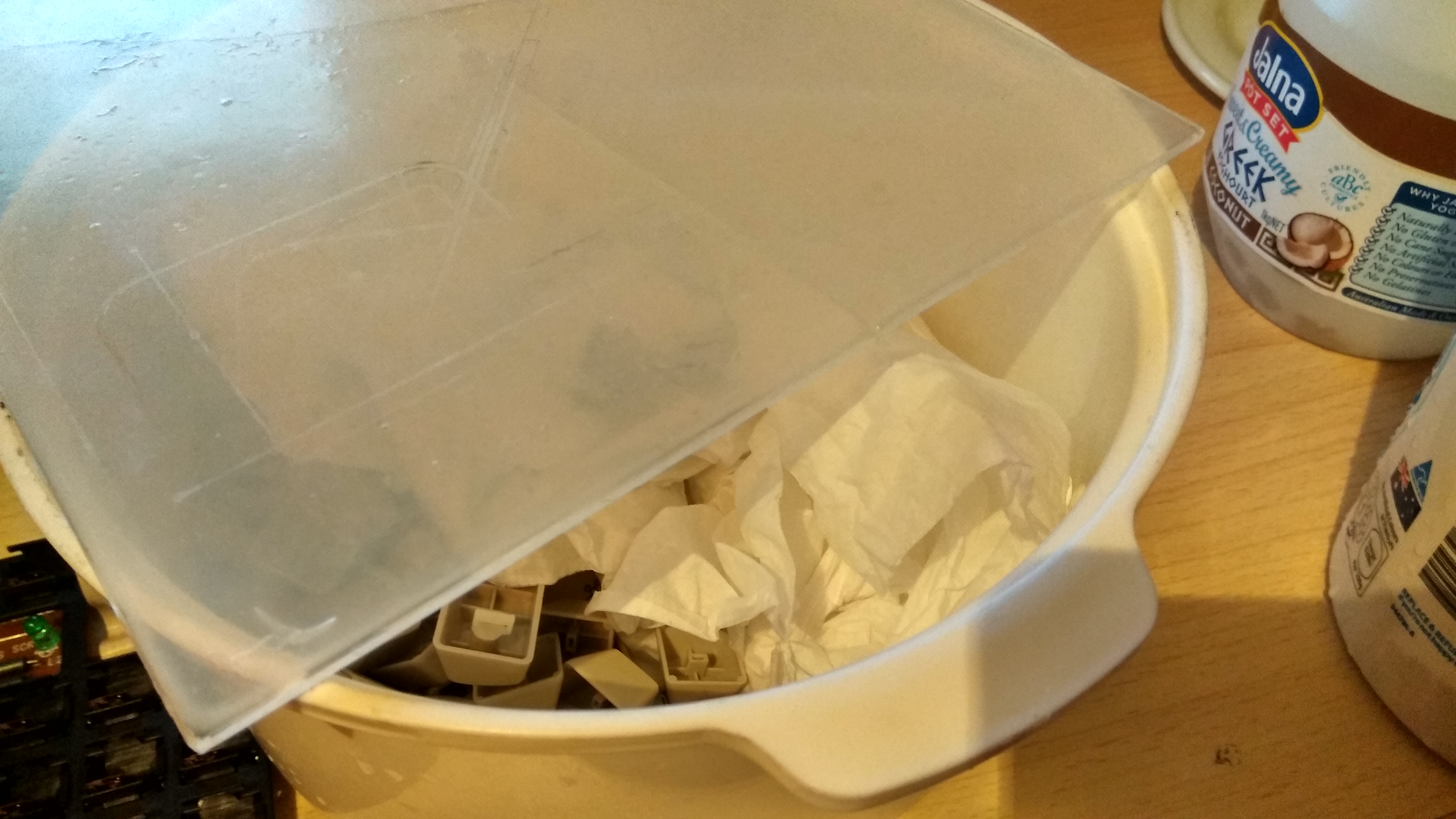

- Separate all parts and douse in water and Vanish napisan oxyaction
- Leave for 24 hours; for the keycaps, I left them on the balcony under the sun to properly bleach for a week instead in that napisan stuff
- Wash and rinse everything off
- Place all the grouped parts in a plastic bowl or whatever with balls of tissue, lid it, and ensuring there is plenty of free space, shake hard for 1 minute and most things should come dry. Shake the leaves lightly to prevent them from bending under force. Try not to lose anything in the tissues. (cellulose sponge will be better though but who has money for that?)
- Put sliders in a container and spray the crap out of it with teflon spray or WD 40
- Reassemble.
- Profit1?1?1?1??1?111??????!!!!

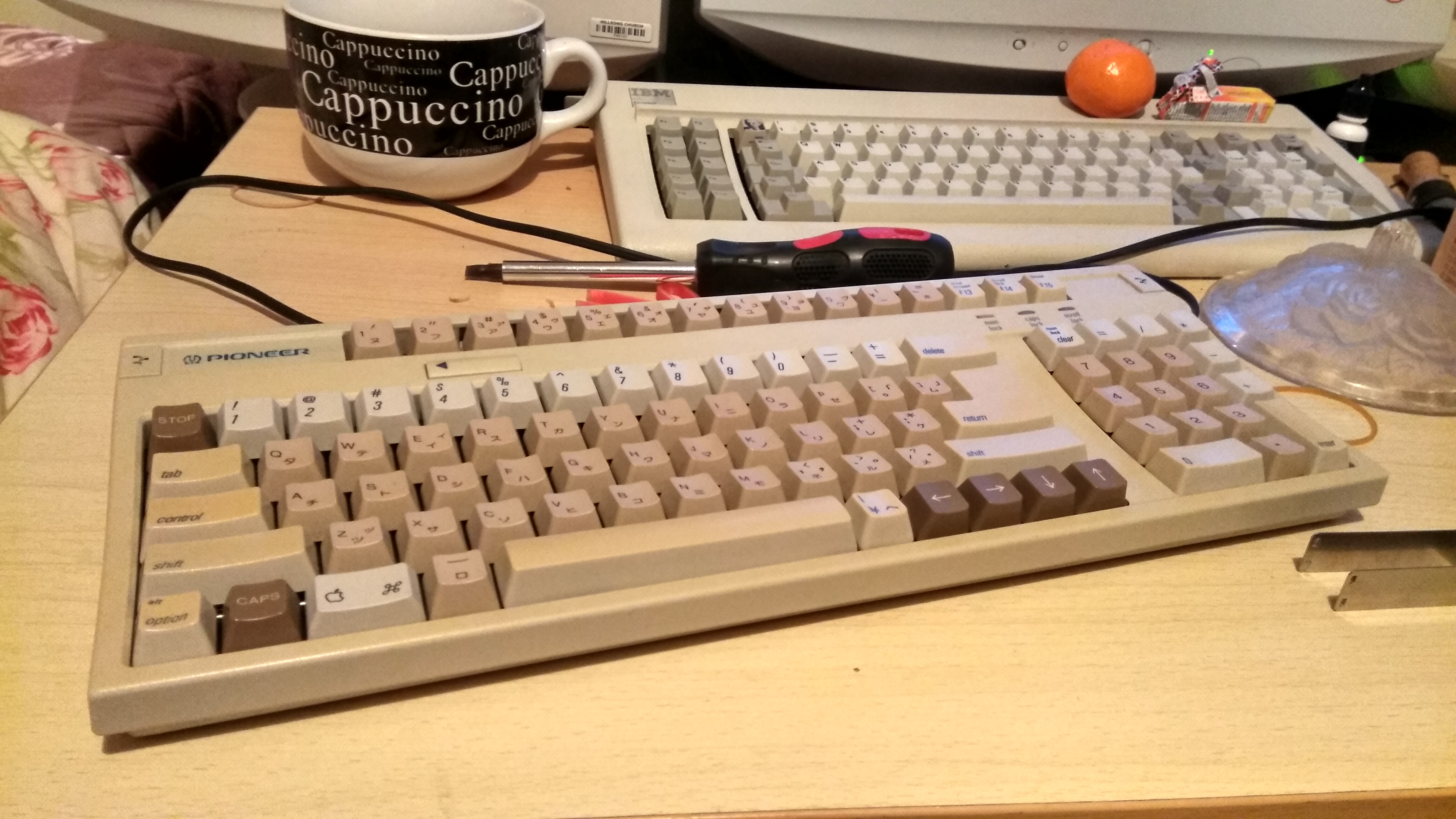

No. But you know I'm still interested in your little Alps tool that almost looks just like a harmless Topre keypuller?!? Anyway good work sofar. Love that Pioneer board of yours.

I have an idea for the keypuller so that it's slightly larger than the switch housing in spacing, then having 2 grabbers to grab that lip on the slider I noticed. That should allow the housing to come off easily if I get the tolerances right.
patent pending xddddddd

Made this thing in sketch, It's got some grips and the ability to latch onto the small protrusions on the cap either side.
