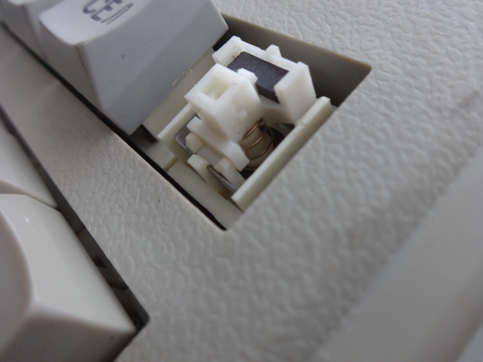

Does anybody recognise these keyswitches? I've found them in use on various different computers from the USSR, and it'd be nice to know if they were ever used on Western keyboards, or if they're purely a Soviet design.

That black bar looks like a magnet, so I would assume Magnetic Reed or Hall Effect. I just scanned through the wiki but could not find a matching entry either.

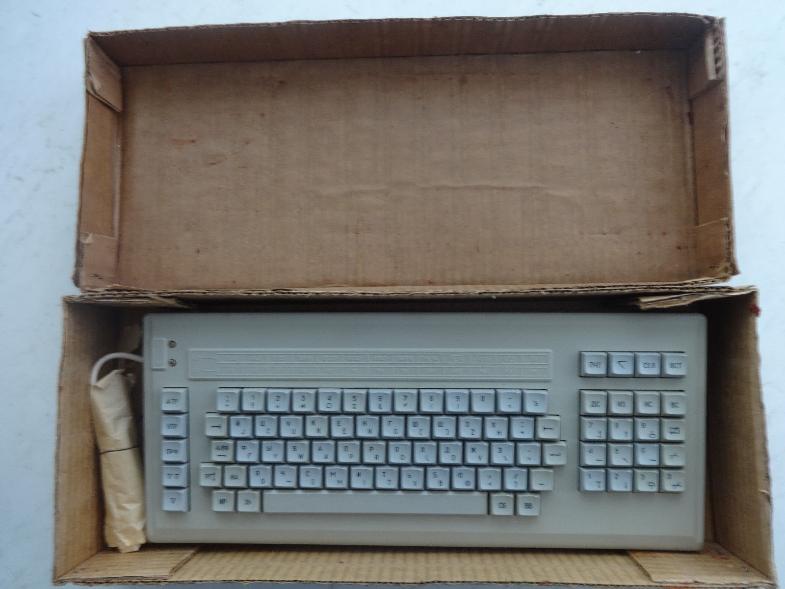

It's a keyboard from a smart terminal "ТС-7063" in Russian, or "TS-7063" in English. The full name of the keyboard in Russian is "ТС-7063.02.А003.01" or "TS-7063.02.A003.01" in English. It feels like a very nice linear switch (although personally I prefer clicky keyboards).
Even information in Russian seems to be scarce, the most I can gather is that these keyboards connected to a smart terminal, which in turn connected to one of the ЕС (YE-S) series of mainframes.
I'm hesitant to pull them apart to see if it's a slider over membrane or dome, or a board mounted slider, as the factory seals are still in place.
Here's a picture of one of the NOS keyboards. :)

those look a bit like RAFI's Hall Effect switches
[wiki]File:RAFI-RS76C-assembled.jpg[/wiki]
except the slider is wider at the end of it

Yeah those do look a bit like RAFI but that's something else. Where are our experts for Soviet stuff...do we even have experts for that? :o :oops:

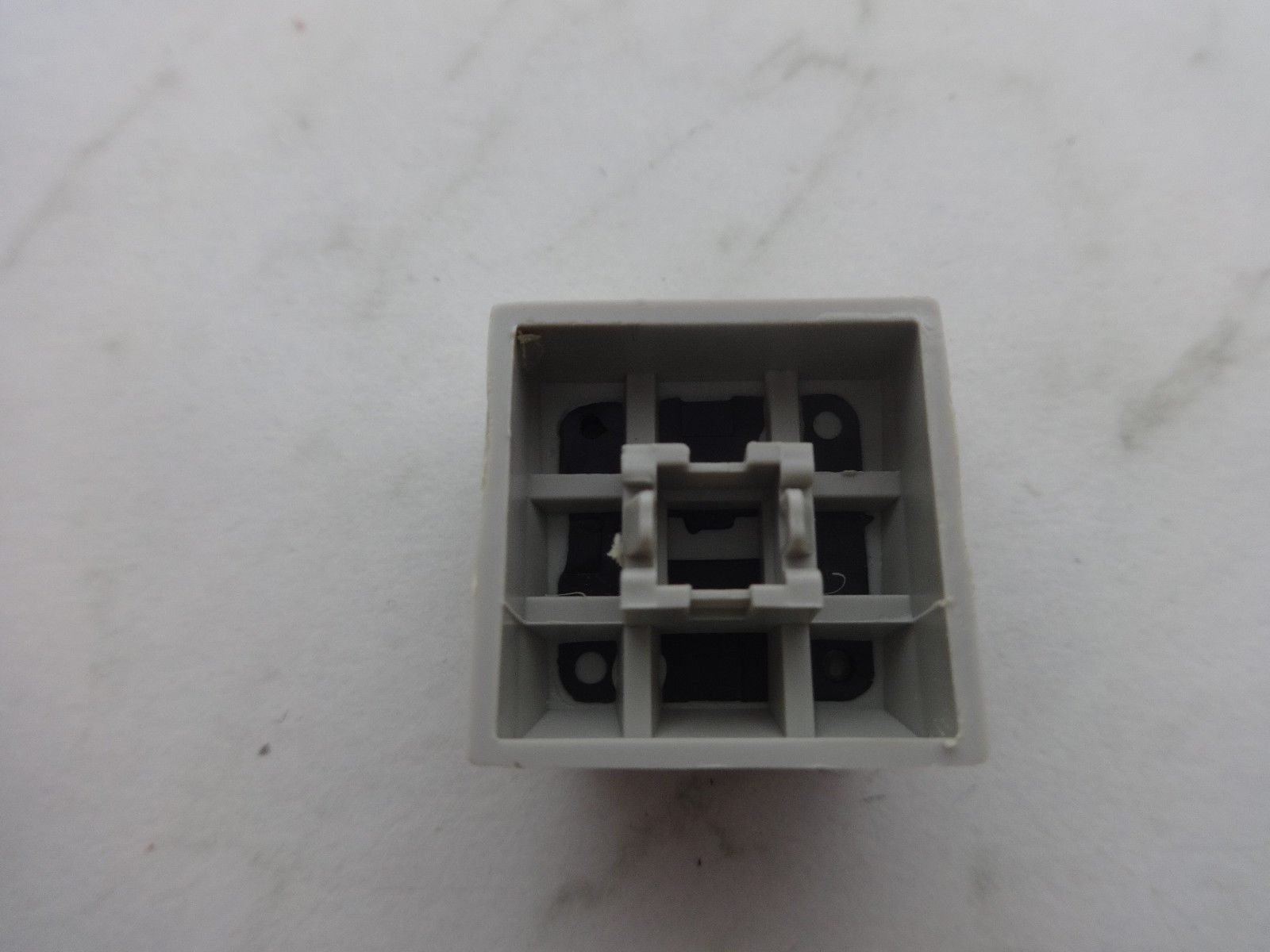

The mounts look almost the same, but I'd need dimensions to check if the keycaps would be compatible.

Generally, keyboards in the Eastern Bloc used switches specific to that region. IZOT made clones of Cherry M8 and M9, but for the most part the switches were Bloc-specific, such as IZOT reed and Tesla Hall effect. These look like something RAFI-inspired. You may find something interesting written on the bottom of the switch if you de-solder one.

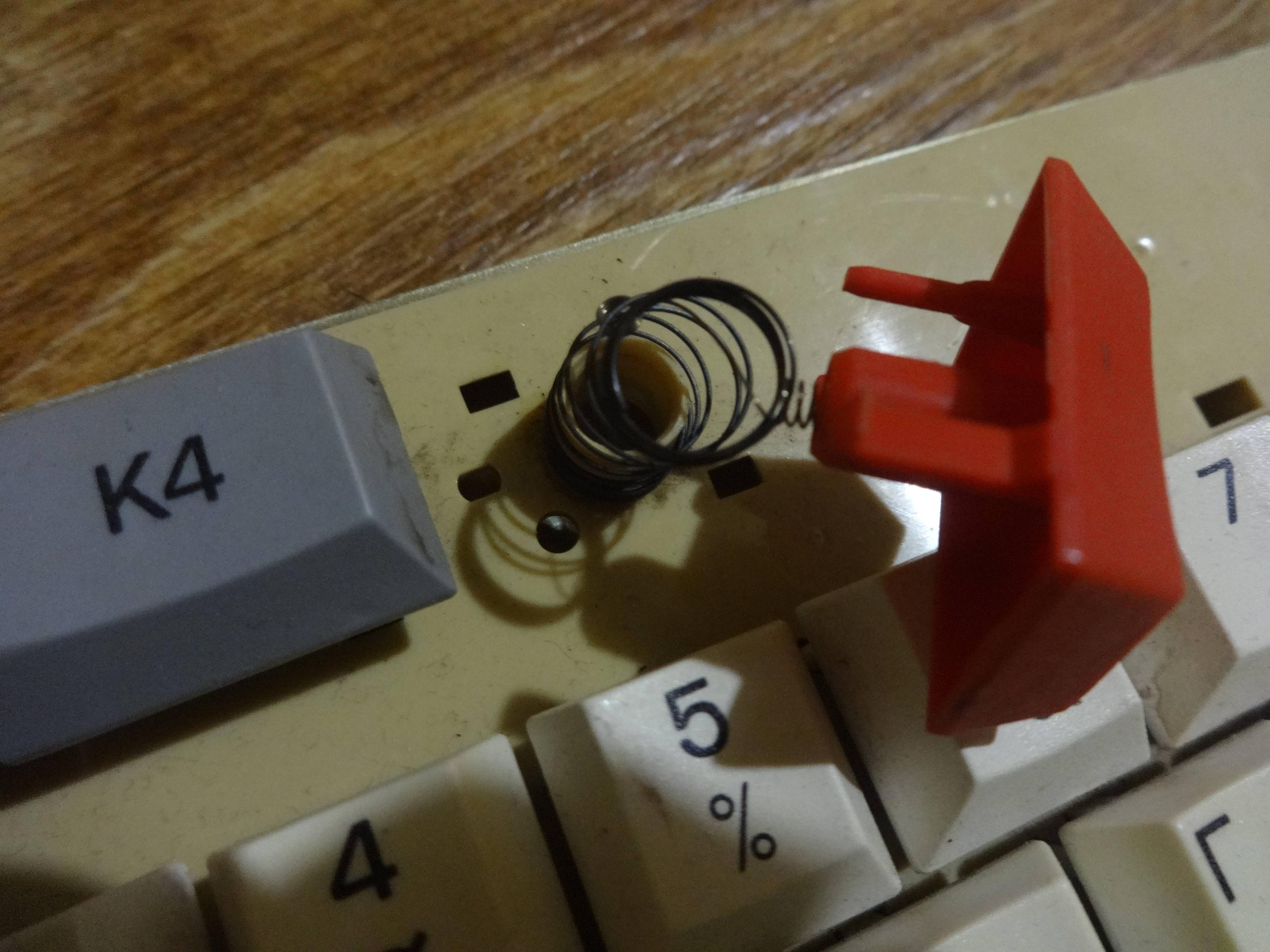

Identifying Soviet ZX-Spectrum clones' keyswitches can be a nightmare. The hall effect and magnetic reed seem to be most commonly used, but almost always of differing designs and incompatible.
More "serious" computers tended to have more interesting switches (PDP-11 micros, IBM clones, etc), although you still find the oddball "switch" like this. (The keyboard pictured below is horrible to use by the way, although you could probably guess that from the picture alone). :D
