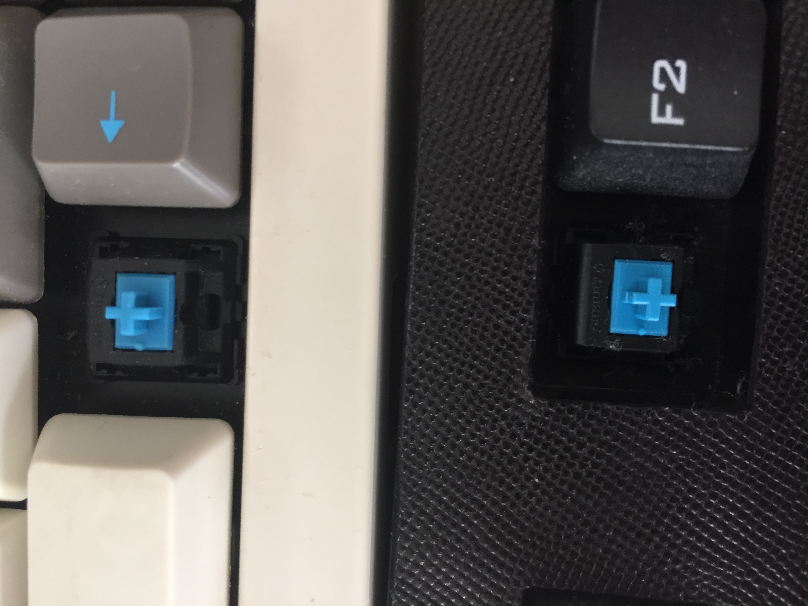

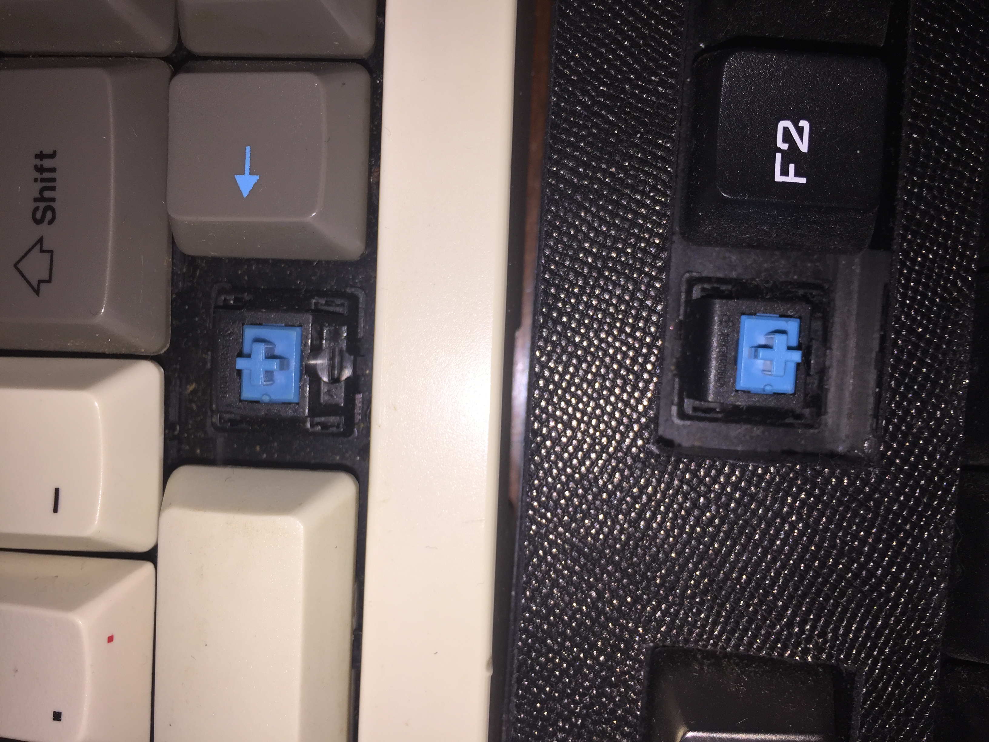

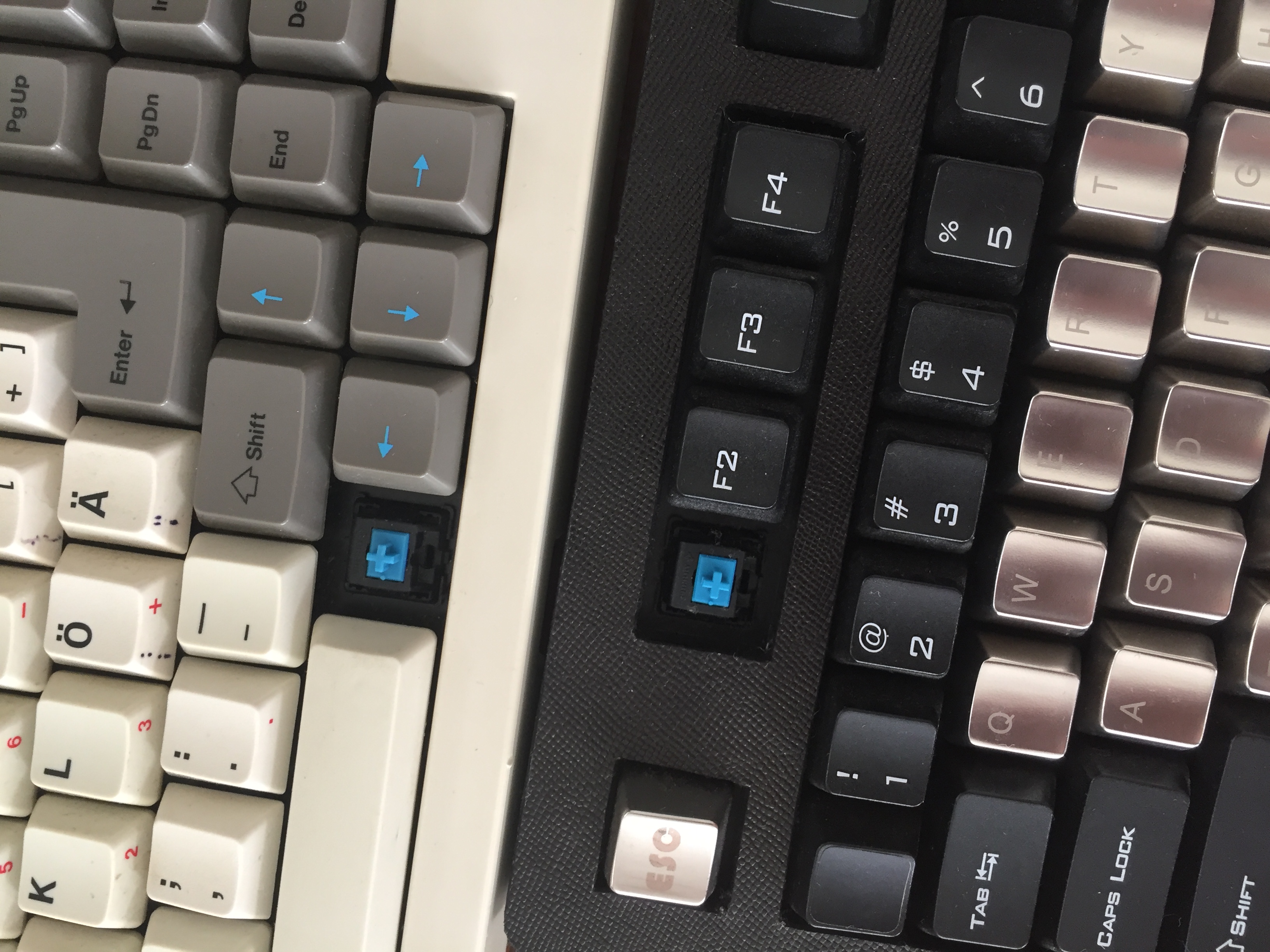

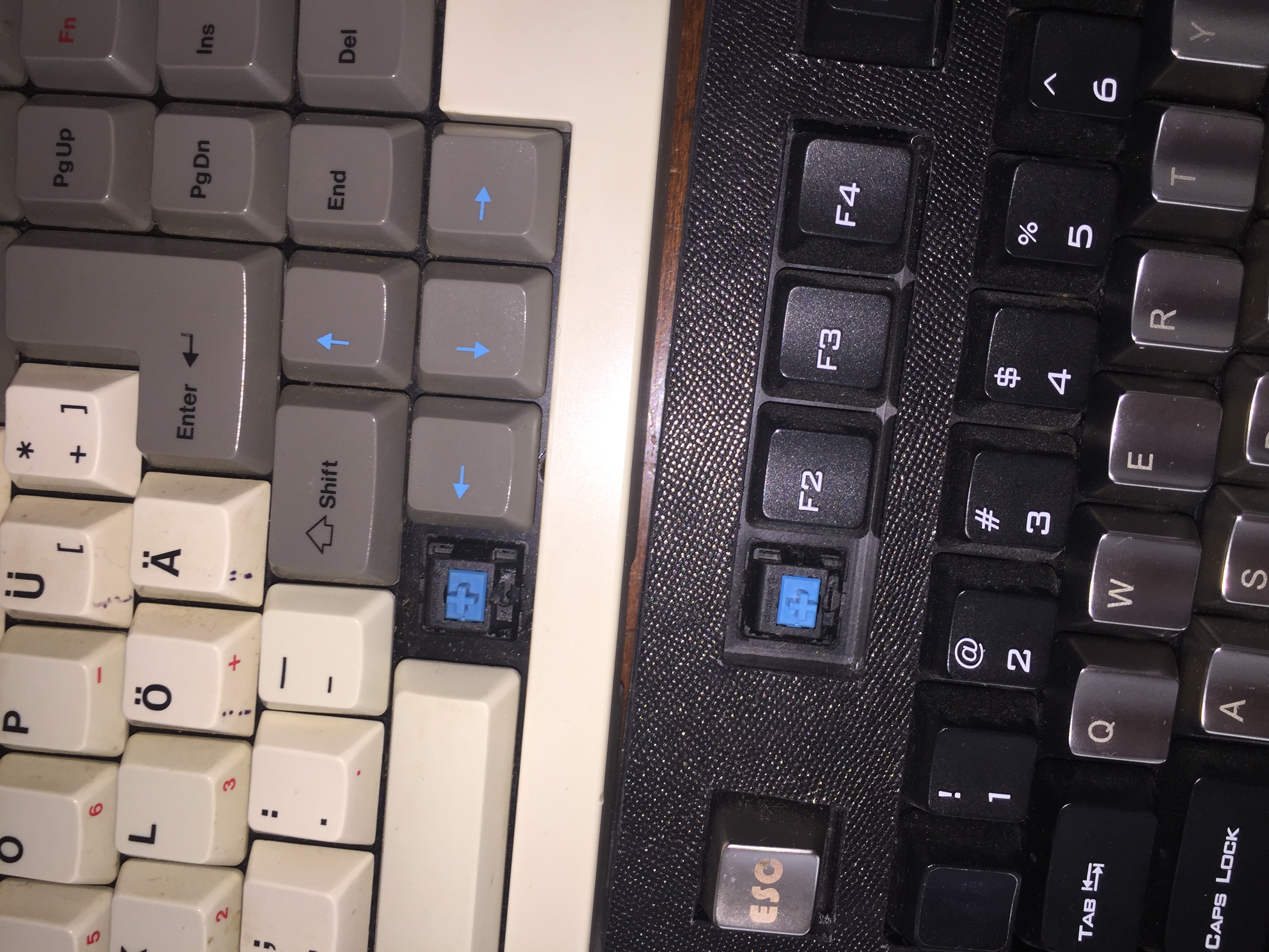

Hi folks.
After hastingly editing the Deskthority wiki entry for 'Cherry MX dark blue', a member of another forum brought to my attention that the switches I found under the keycaps of my ancient 8088 laptop might also be 'Cherry MX pale blues'.
It never occured to me they could be anything other than dark blues. In fact, I just heard the first time about the pale blue variant.
Here are some pics in comparsion to the current MX blues in a modified DAS:
Closeup w/o flash
Closeup w/o flash
Closeup w/ flash
Closeup w/ flash
With a little distance and flash
With a little distance and w/o flash
It's puzzling, I've never seen different switches so similar in color, although they are obviously not the same. I can't tell if the laptop switches are darker, paler or even brighter than the new MX blues; maybe this is a job for a spectrometer. It had to come to this.
Any ideas?
01 Aug 2017, 13:32
They look basically identical to me. I have both the Navy and Sky versions but neither look like normal blues at all.

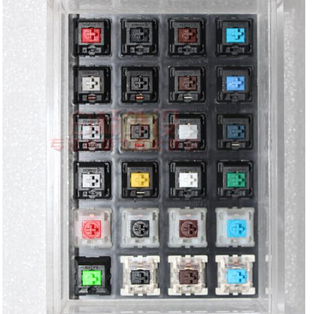

01 Aug 2017, 13:42
There are plenty of Cherry MX clones out there also.

02 Aug 2017, 15:15
JohnZD wrote: Now someone just listed a Bondwell B310 (of which all known devices sport indeed dark blue Cherry MX switches) on EBay, including a reference to the 'dark blue' switches, although the auction pictures are showing a switch which is very similar in color to the obscure Cherrys in my Bondwell B200: http://www.ebay.co.uk/itm/Bondwell-B310 ... SwBt5ZJ5V2
Those are Normal Cherry MX Blue, lokk at how dark they should be if they were Dark Blue :
This is not the best quality picture but you can still manage to see clearly the difference.
