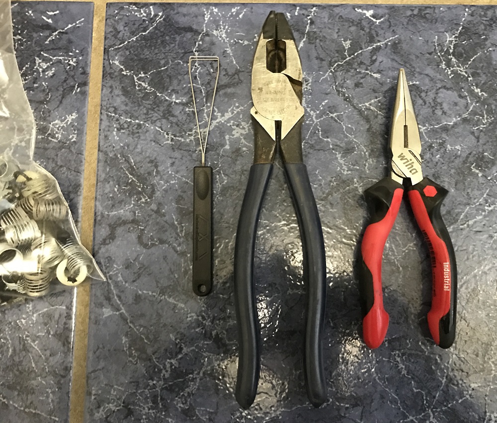

I was able to pull a couple out with my needle nose pliers but just barely. My large linesman pliers pulled them out easily.
