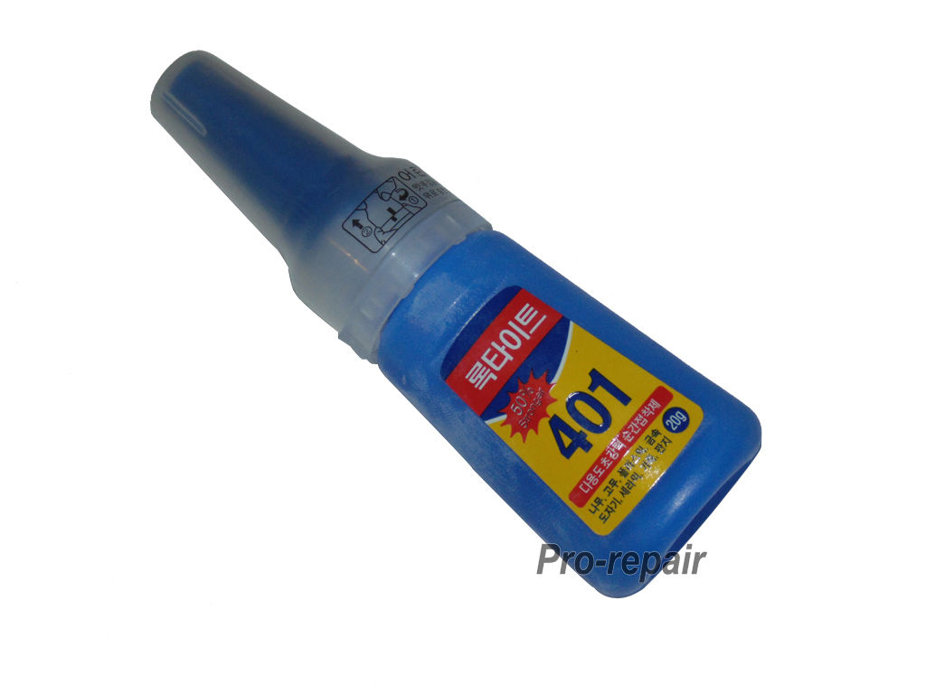

I went to page 39 to consult the bonding strengths for all the different options. I guessed that I was using an unfilled resin (as opposed to glass fiber filled or whatever) and Loctite 401 with prep was the clear winner! I guessed, too, that a swab with acetone would be about as good as using Loctite 770 primer.
Loctite 401 is really expensive ... unless you import it from Korea! :D
http://www.ebay.com/itm/321862849979
Loctite 401, Korean version, stock image.
Now, be warned: this stuff is basically Krazy Glue on steroids. Use nitrile gloves and eye protection when dealing with it. Better safe than sorry! Use a tiny dab, and hold the parts together for 60 seconds.
It worked great! The key cap is saved, and I've learned some things along the way. PBT can be glued ... and, be careful when stacking keyboards. :cry:

Yeah, I've read about this actually, though I was more interested in Loctite 454, which is the gel version of 401, since I'm not a fan of the thin runny instant bond stuff versus the more workable gel. There's some on eBay for a decent price of $10.

I also ordered some 401 to compare it with the 454 too. :D

FWIW, the Loctite 401 is holding the key stem on just fine. I made sure to lubricate it before re-inserting to make the cap easier to get out int he future.
