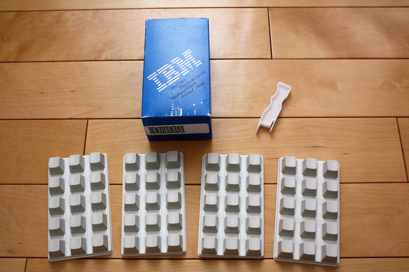

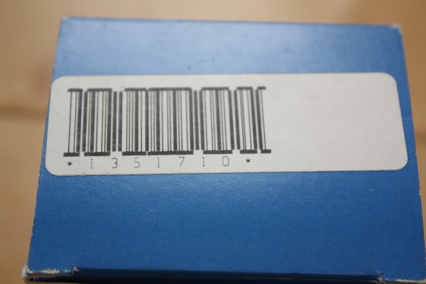

Technically, there could be an official IBM blank keycap set for SSK (it could work for both SSK and M). I got this some time ago.
IBM 1351710 -Blank keycap set.JPG (371.75 KiB) Viewed 6712 times
IBM 1351710 -Blank keycap set label.JPG (272.69 KiB) Viewed 6712 times

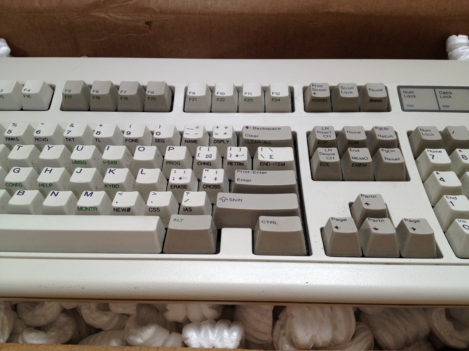

I received the Sabre SSK new in box and will have to take some pictures and post here. The seal was broken, but appears unused. It did indeed have a part number of 1393691 and the part number on the box also matches this, so it appears to be legit. If you google that part number, there seems to maybe have been 2 for sale over the past 6 years or so, but no pictures remain of them as ebay only keeps those around for a few months to a year maybe. One guy put in the description that it has "rare green stenciling" - http://www.ebay.com/itm/301413209083
