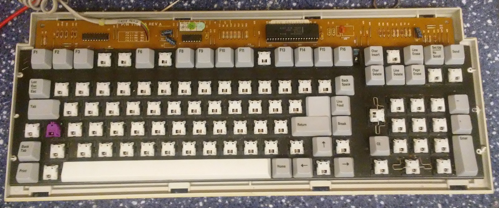

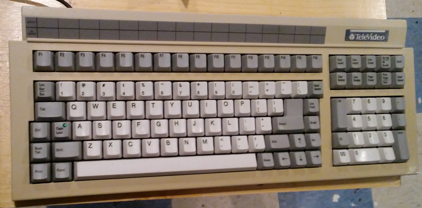

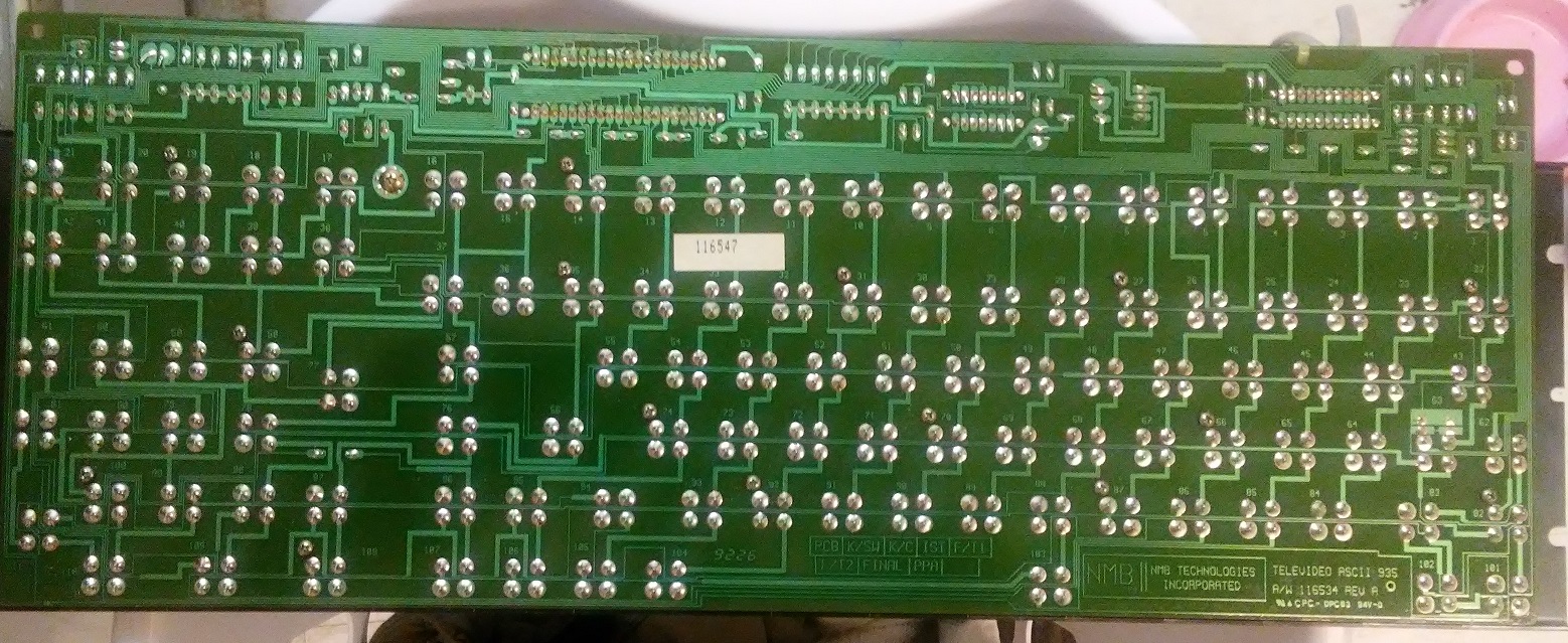

I've finished up with the last of the five terminal keyboards I've somewhat randomly accumulated in recent months. This one is a Televideo 935 terminal board (at least that's what it says on the PCB). It has white linear Hi-Tek 725 Space Invader switches that are kind of cool I think.
It's nice to be able to use these boards on my Windoze machine - I guess I'll just rotate though them for a while. I think the really fun part, however, was just the process of working on them!

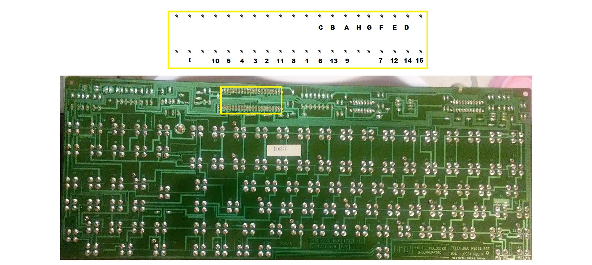

Wow. Those rows and columns look very easy to trace. I wish every keyboard had a PCB layout like that.
OldIsNew
19 Aug 2017, 06:08
ohaimark wrote: Wow. Those rows and columns look very easy to trace. I wish every keyboard had a PCB layout like that.
Yes, it's a nice matrix layout for a change! The Shift, Ctrl and Funct keys were a little oddly routed, but the Televideo folks seem to have made the effort to produce a pretty straight forward matrix which is definitely not the case for some other boards I've seen!

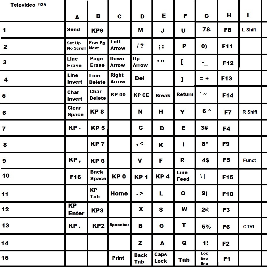

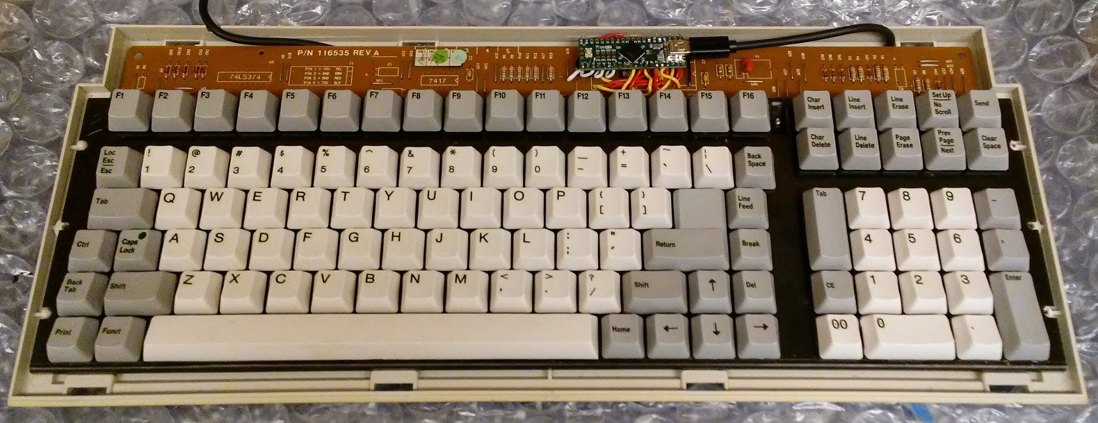

Do you have a closeup of how you did the teensy wiring? I could trace out myself, but this would save me a lot of work if I ever get around to restoring my TV935!
OldIsNew
19 Aug 2017, 21:18
orihalcon wrote: Do you have a closeup of how you did the teensy wiring?
Sure, happy to post. These are the matrix I traced out and then the corresponding pins on the main IC. I was too lazy to rearrange the matrix diagram so that the letters and numbers would line up in order on the IC pins.

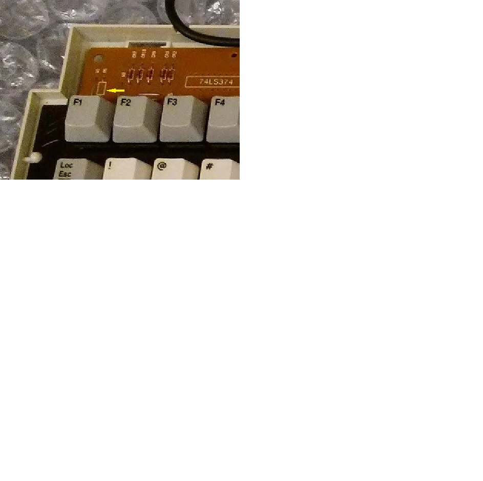

One minor note - when I wired the existing Caps Lock LED to the Teensy, I had to desolder a resistor to isolate the LED from the IC pads. Got lots of wonky key presses when I first hooked up the LED.

I was having a hard time tracing out the matrix myself. I soldered it up last night and this appears to be just what I needed!
Thanks so much for taking the time to post these details. This will be a huge help in converting the two Televideo boards I have 8-)
