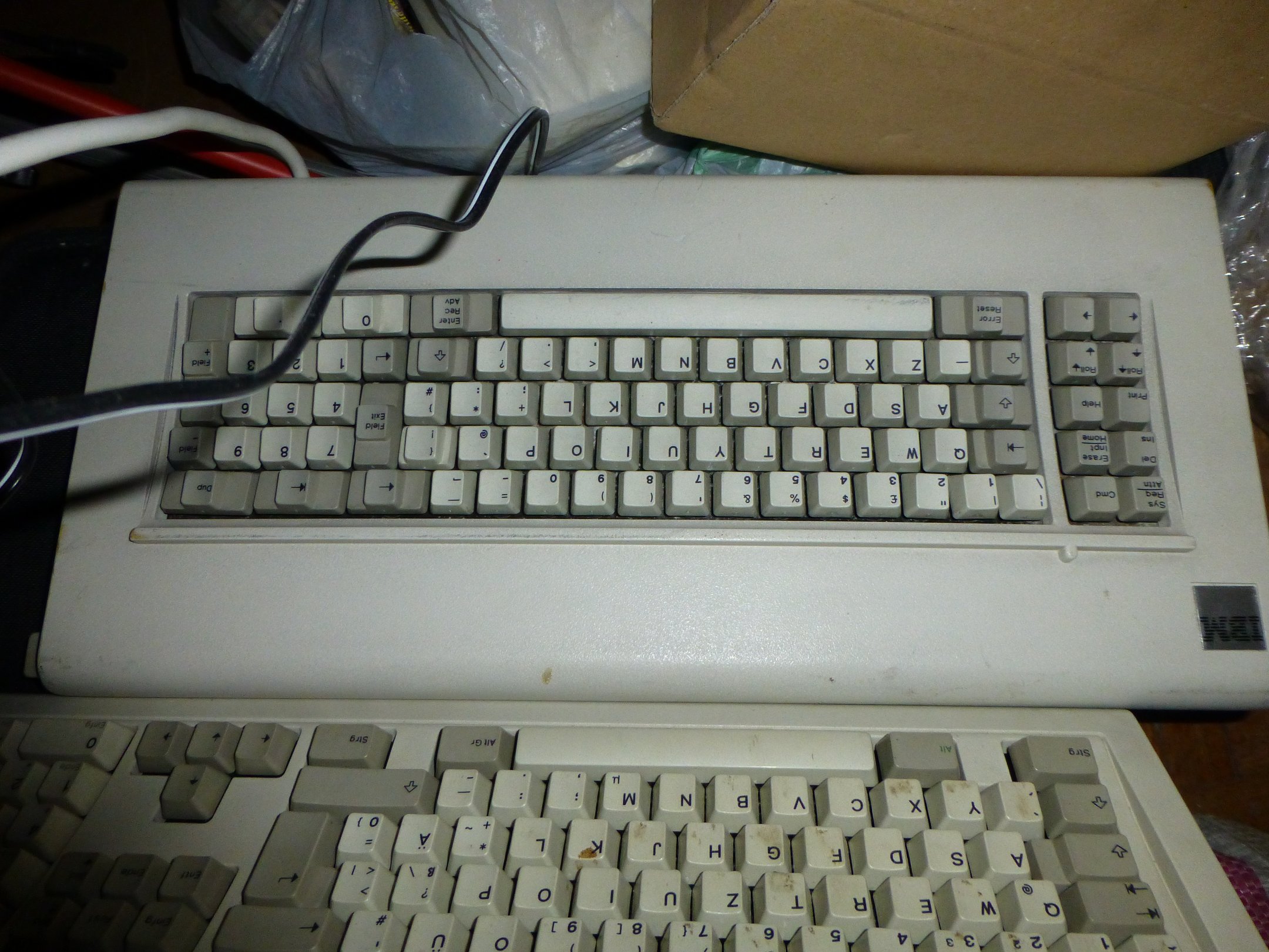

So, some days ago I purchased an IBM 5291 terminal, complete with the matching keyboard - a "Bigfoot" Model F. The description said that the keyboard was missing two keys.
I surely didn't expect this carnage:
As you can see, there is a ginormous crack that runs over almost the entire length of the Bigfoot's foot.
The description of the item did not mention that there was a fucking Grand Canyon on the case, and the picture was just at the right angle to make it very difficult to see - I don't know if on purpose or not. I'll ask at least a partial refund.

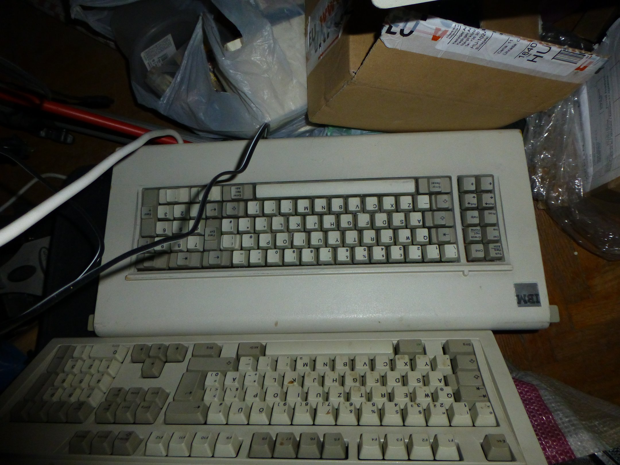

Closer shot:
As you can see better on this image, the two missing "keys" are actually missing barrel and spring. Moreover, at least two other keys are from a Model M, being that they are in two pieces.
Three other keys do not buckle properly - the spring is stuck against the barrel.
The situation becomes even more dire if we look at the top of the board:
It's clearly visible that the crack goes from horizontal to vertical and runs to the edge of the plastic front case. The metal back panel is bent. It is quite clear that the board have received a very strong blow on the top, almost certainly because of a fall from a respectable height. The backplate has probably took the biggest part of the impact, but nevertheless the brittle plastic of the case has taken the heavy damage you see here.
My question is: is this wounded giant fixable? How much of a pain in the ass would this restoration be?
And moreover, are the missing parts (barrels, springs, possibly keycaps) reasonably easy to find?
I tried capacitive buckling spring switches for the first time today, on this board, and I really love both the feeling and the sound. I really like this keyboard, but I need to know how hard and expensive this is going to be.
Thanks in advance, folks!

I would use this one as a parts donor and buy another one in shabby but unbroken condition.
You have some cool and unusual keys, but also some glaring inappropriate replacements.

Kind of depends if you are ok with how the case looks as that's not going to be easily fixed. Hammers/springs/barrels aren't too hard to come by, I'm betting you can find a fellow user in Italy that might have some. I sell them, but international shipping kind of kills it as it is a minimum of $13 USD to ship anything no matter how small these days if thicker than 1/4 inch.
Converting to USB is possible, but not sure if that is what you were looking to do or not. Wouldn't be a bad unit to practice the conversion on as you'd be less worried about possibly roasting something while you do it.

This hurts to watch (and it's a Spanish keeb, to boot!). I think fohat's right and it'll be off better as parts donor.
If nothing else, KEEP THOSE KEYCAPS!

I see... What saddens me it's the fact that Bigfoots are hellishly hard to get here in Europe, if I understood correctly. I'm new to vintage boards, so the "if only that dummy kept this rare piece intact" feeling really struck me.
orihalcon wrote: I sell them, but international shipping kind of kills it as it is a minimum of $13 USD to ship anything no matter how small these days if thicker than 1/4 inch.
Well, I already have to purchase an xwhatsit in the near future, so this wouldn't be too bad :roll:
Yes, the idea was to convert it to USB.

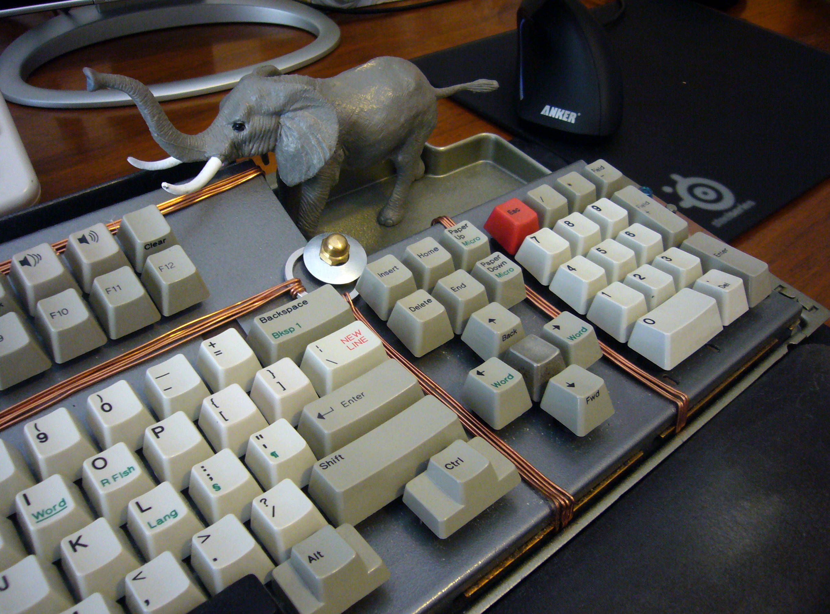

Or maybe keep it exposed, as in almost without a case? I did a search but I can't find that thread, 1-2 years ago, where somebody posted an IBM Model F that had its plate with keys stuck to some kind of transparent, bent, plastic support that was folded so that it was also at the right angle when placed on the table.
Also fohat seems to know something about using a F122 without a case :) https://geekhack.org/index.php?topic=53 ... msg1189702

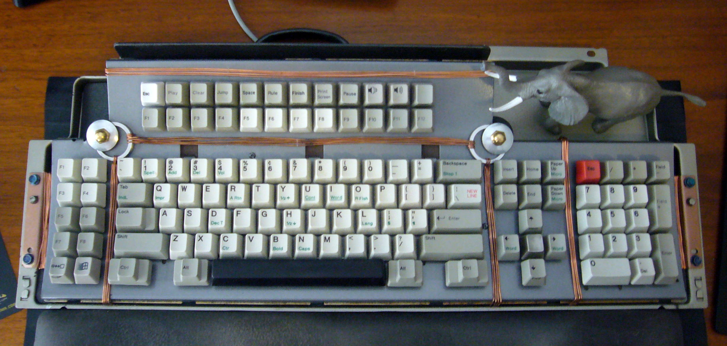

You reached far into the past for that photo. I put that one back into a case and sold it years ago.
These days I am using a "steampunk-lite" variation.

Well, here's your inspiration right there :)
