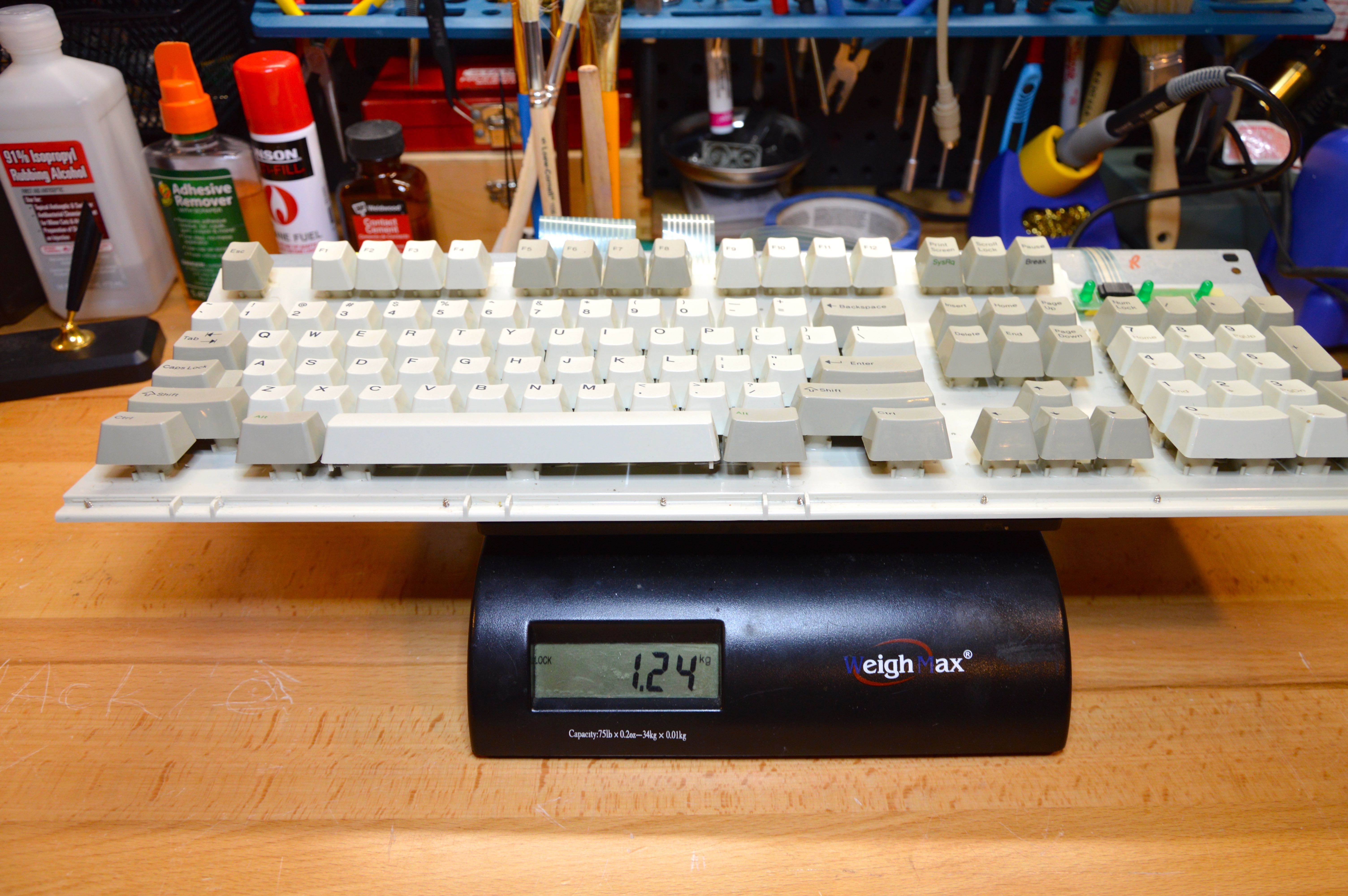

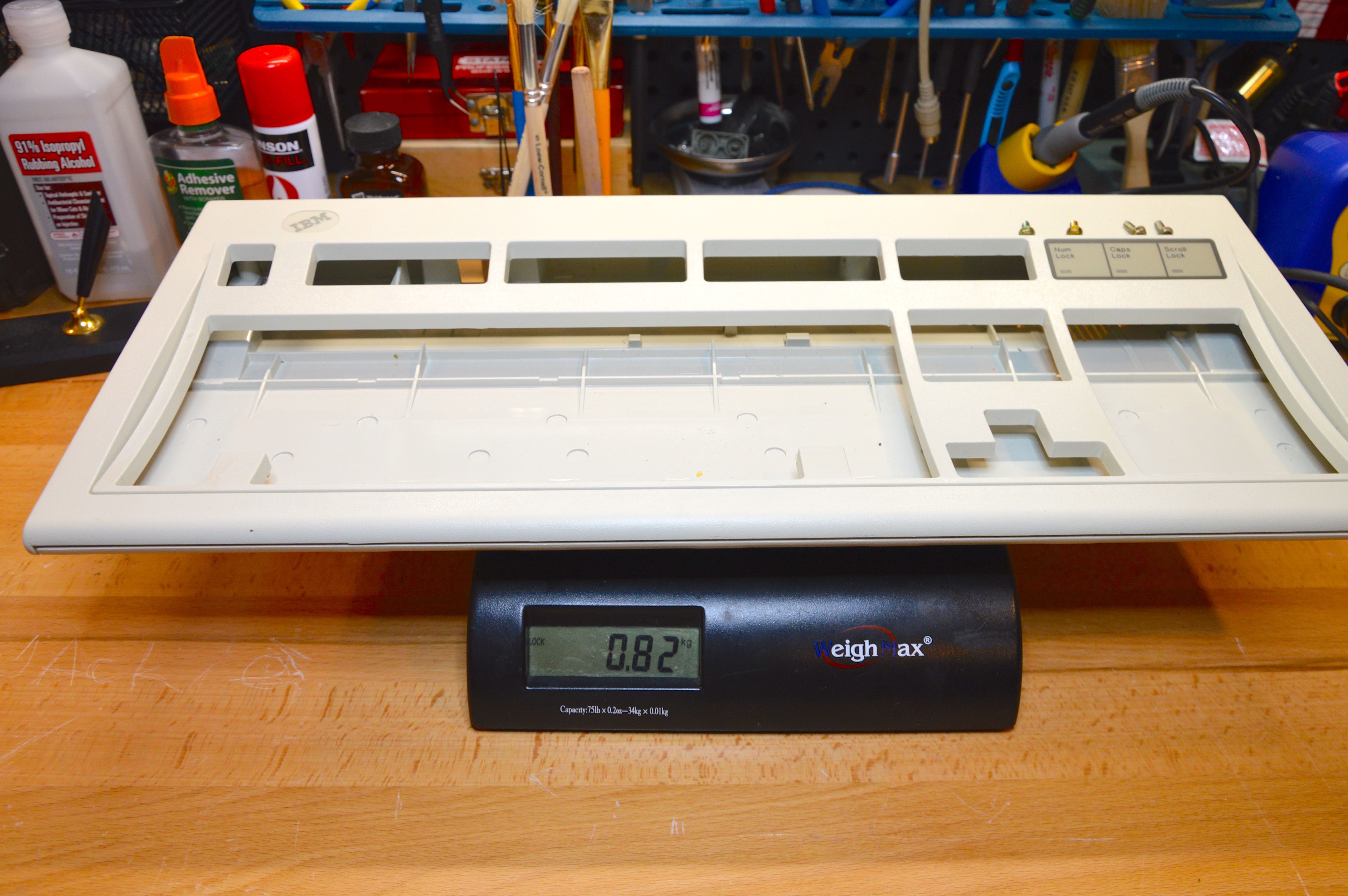

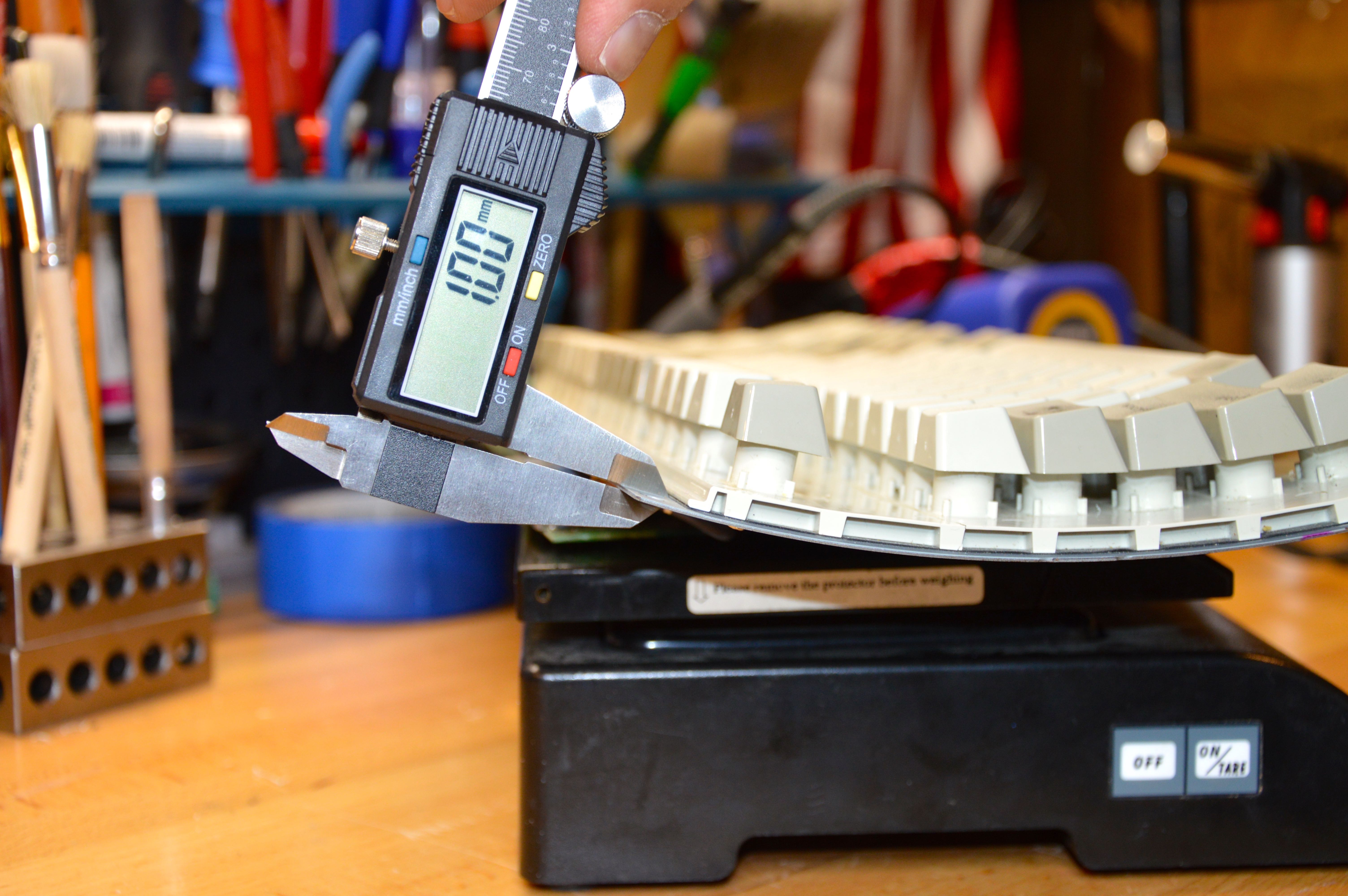

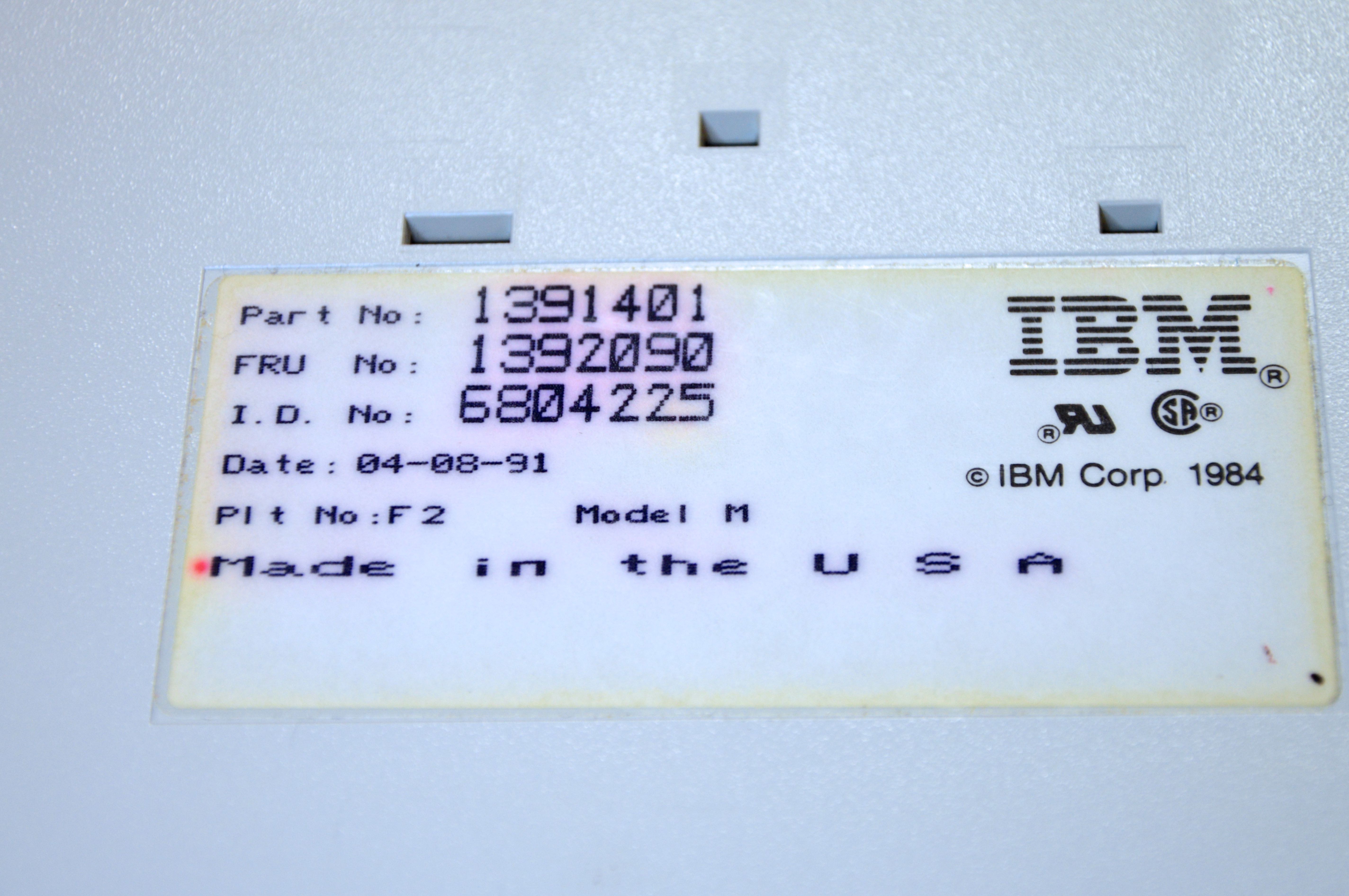

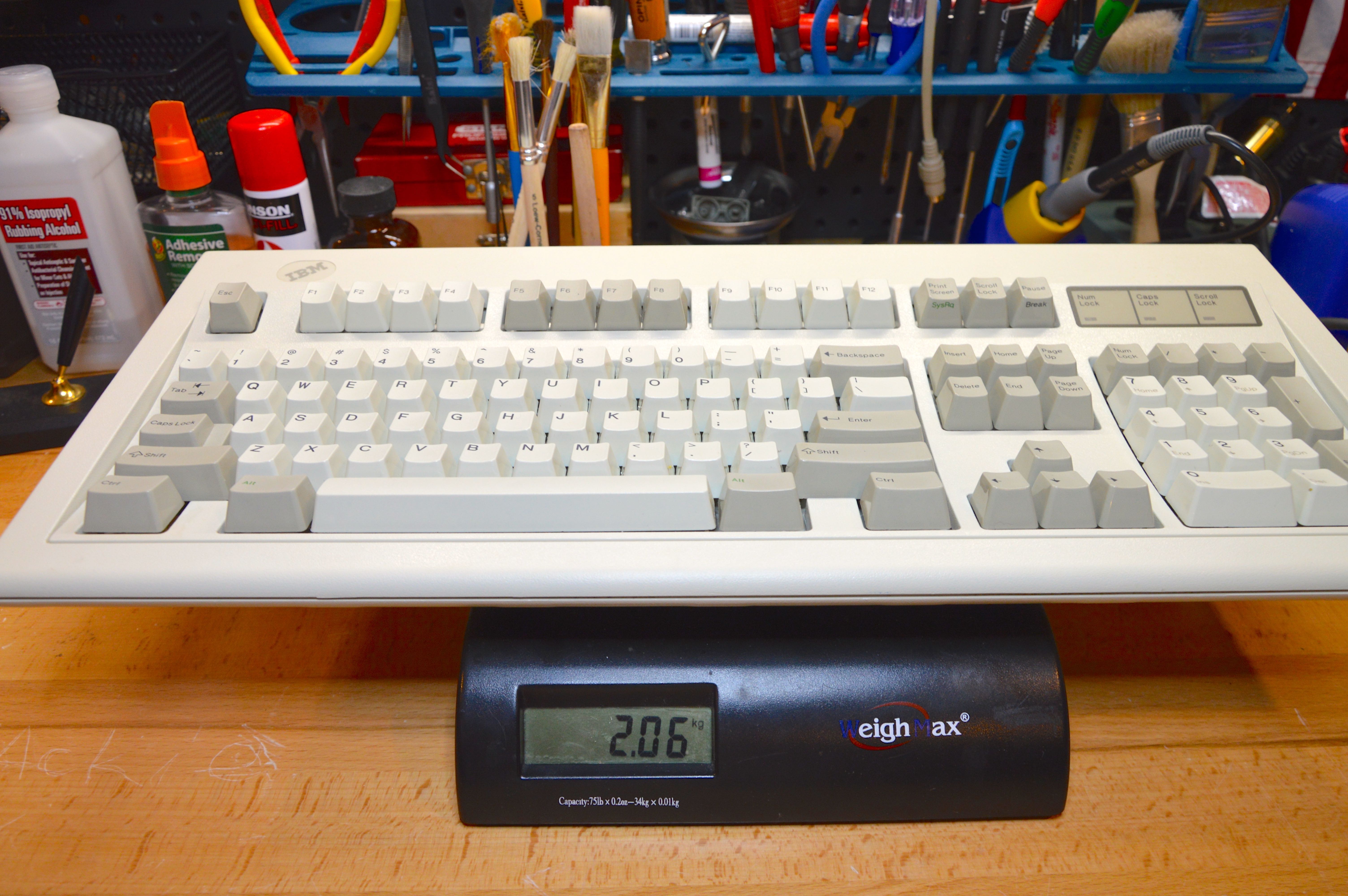

clickykeyboards
05 Sep 2017, 02:40
Data points from a (1991) 1391401 (04-08-91)
http://clickykeyboards.com/product/1991 ... -04-08-91/
-total keyboard weight (minus cable)
2.06kg
-case weight (top plus bottom, no controllers, just the two PVC shell parts plus badge)
0.82kg
model M internals with key caps, buckling springs, conductive layers, controller, metal plate
1.24kg
-plate thickness (should be between 1.0 and 1.2 mm)
1.0mm
