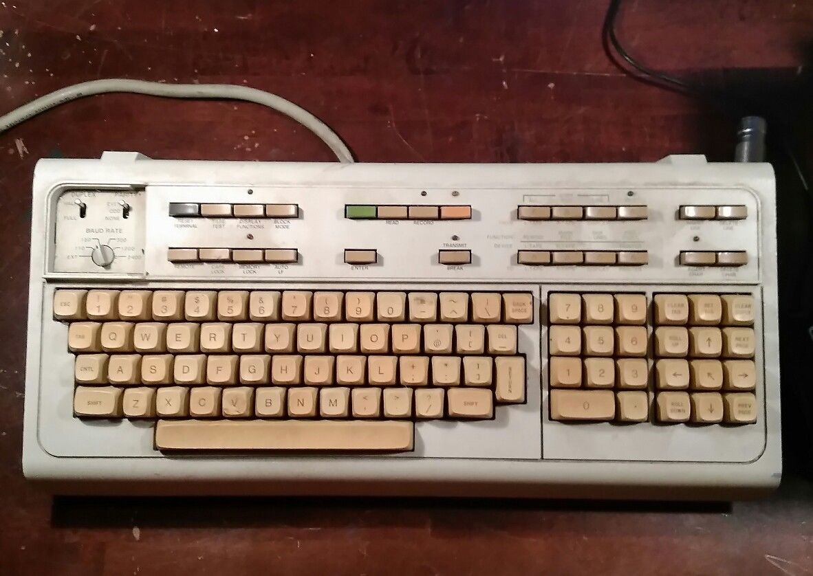

I just picked up this HP 2644A terminal keyboard because it looked neat. I believe it is from 1975 based on the date code and the timeline from the HP computer museum. Other than that I don't know anything about it. Maybe someone here has an idea what kind of switches it might have. I likely won't have it in my possession for about a week.

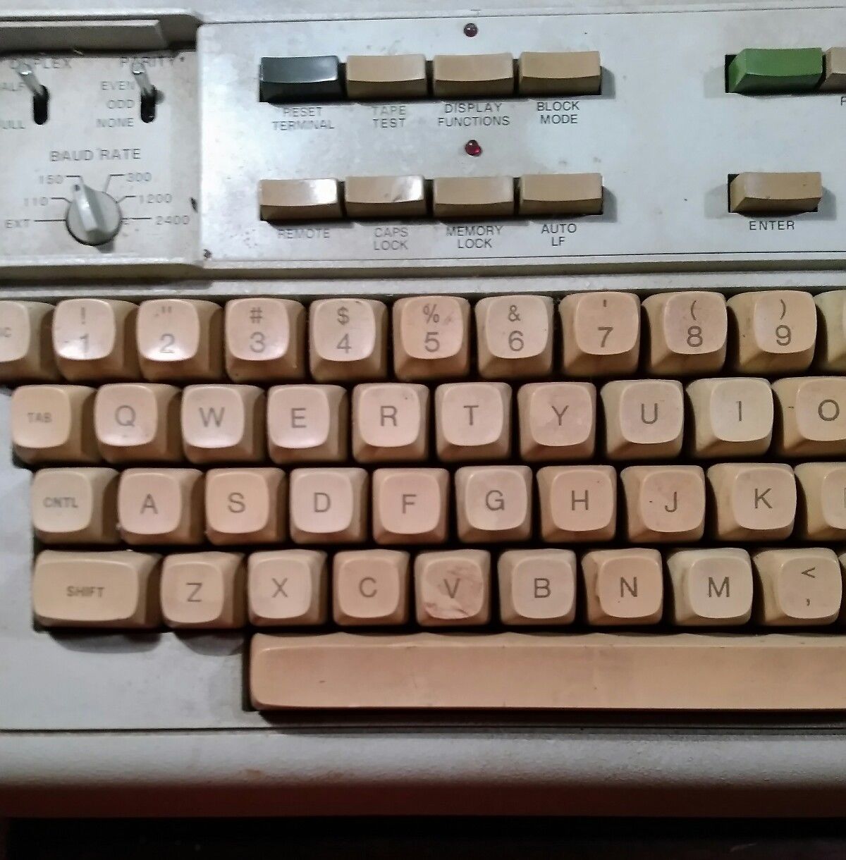

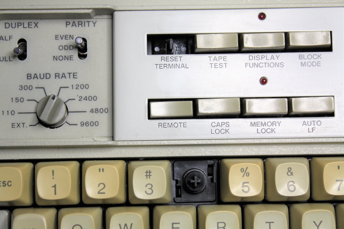

Technically, only one of us is wrong. If I recall, it has one lone Cherry switch and that was the one I remembered ;) Look at the "Reset Terminal" key. No idea why it is a Cherry switch. Maybe the gold cross point was quicker than the magnetic valve? That's pure speculation. We'll confirm when JP! get's hers. Nice terminal!
HP keyboard.JPG (386.72 KiB) Viewed 5193 times
19 Sep 2017, 00:48
Maybe reset terminal bypasses the keyboard logic circuitry, and consequently needs to be a simple pushbutton without any complex drive electronics requirements. Magnetic valve switches have to go through the controller to function.

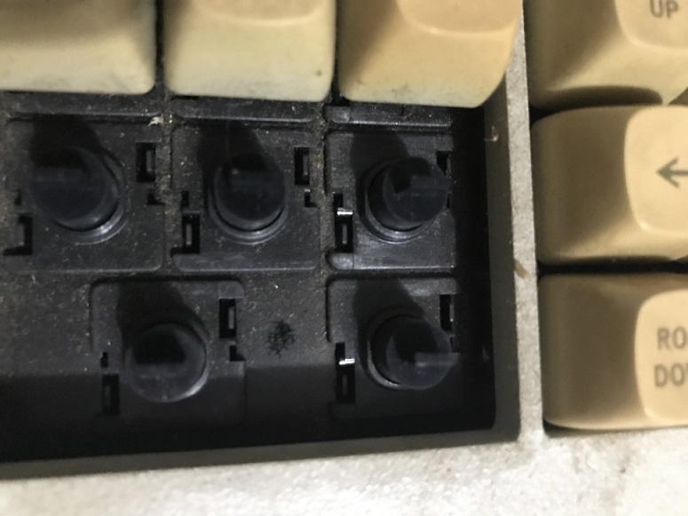

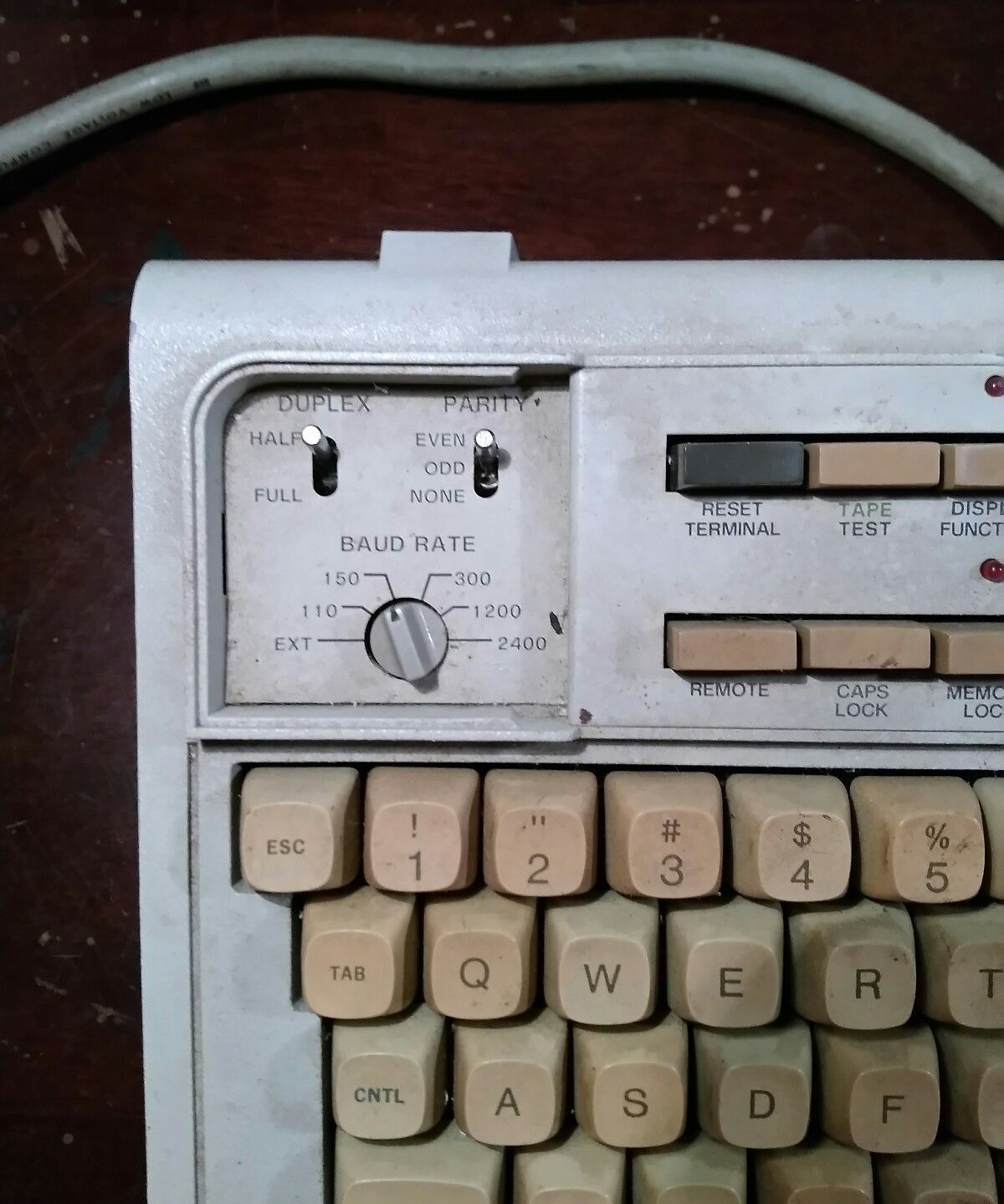

29 Sep 2017, 00:38
Just got this keyboard today. I was expecting a cross style key mount.
29 Sep 2017, 00:44
Don't think I've seen that mount on an ITW switch before — reminds me of the keystems in [wiki]Tokai MM9 series[/wiki].
29 Sep 2017, 10:37
JP! wrote: Just got this keyboard today. I was expecting a cross style key mount.

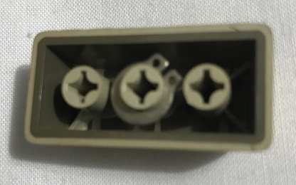

Haha nice another variation! HaaTa's has the cross style key mount. What is that metal bit in the center of that keycap? Come on let's see some more pics JP! :P
Nuum
29 Sep 2017, 11:02
This metal thing looks like a retaining ring, possibly to stabilize the mount and prevent it from splitting?
29 Sep 2017, 11:08
Nuum wrote: This metal thing looks like a retaining ring, possibly to stabilize the mount and prevent it from splitting?
Right. Pretty massive retaining ring. Of course this HP is a "massive" keyboard! :P
