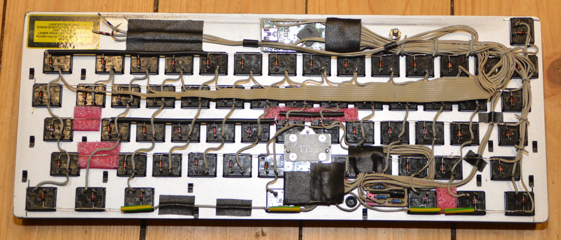

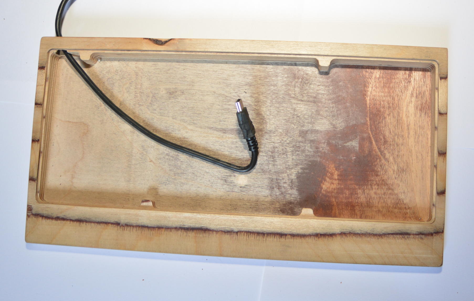

2 Month ago we talked about the idea and some coding collegues said they plan to build a custom board themselves. So we started to design a little case. One of us produced a prototype of the case in MDF. After some days of work on the plate we got it into the small case and where able to make it work. I am writing this on the first prototype. It yet doesn't have trackpoint buttons, but presstoselect works perfectly and the other buttons are integrated in the keymap for now. We will build a little module to integrate physical buttons soon. The final cases will be build from wood or aluminium. Every one of use wants it a little different, so we will make also a cherry plate, which matches the case. My boards layout is perfect for me, as a vi user I need the escape key and I miss function keys when I work on the mainframe, so I will add them too. I don't miss the cursor keys as I can use VI bindings now everywhere!;-)))

I will also build a cover for it. One Idea ist to build the body from aluminum and the covers from walnut wood. And a colorful vinyl version.

1) I use Space as FN key and it works great, but the time is to short. Sometimes it misses my Space press, because I pressed a little bit slower. Where can I adjust this timespan in TMK Firmware?
2) I have some very small TTC Switches(almost the same dimensions as Omron D2LS) from an old Razr Mouse. The only matching pieces I find are Omron D2LS, but they seem to have some special kind of snapin mount. I'd prefer PCB mountable ones, but can't find them anywhere, any tipps here?
3) can anybody help me getting started with pcb design? I wouldn't like to glue the switches and a pcb seems to be the only solution to allow my friends to build there own boards. Is it possible to create one PCB to rule them all(Cherry/Alps,ISO/ansi)?

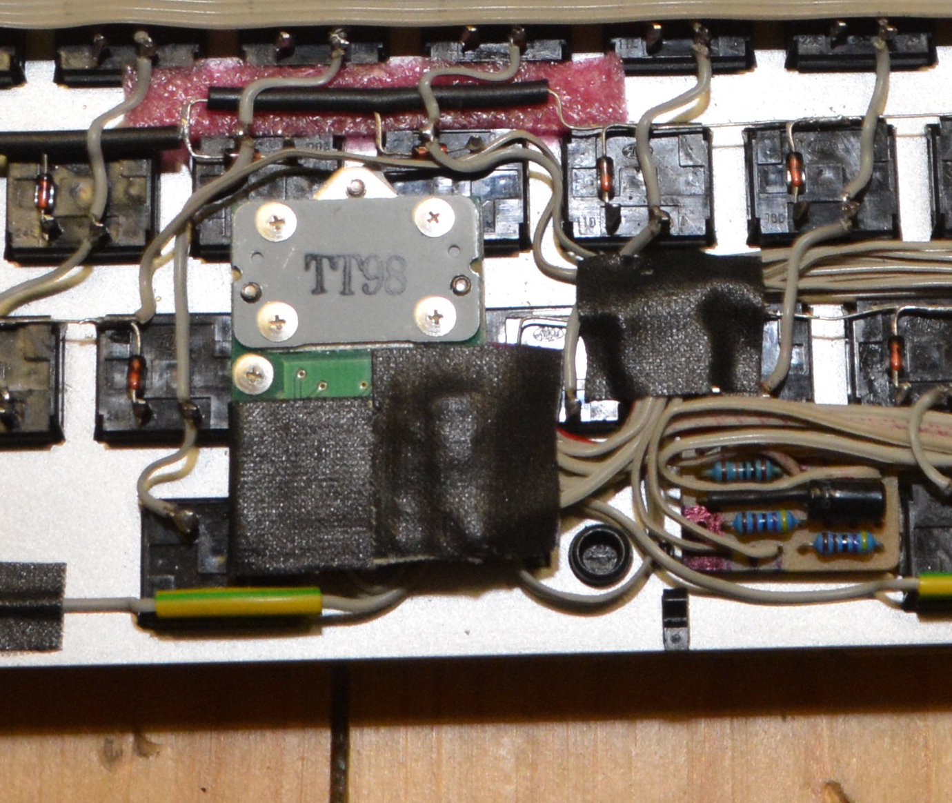

4) I think about using the trackpoint buttons from the matrix. But to make it really working I'd have to put the trackpoints button connectors to on. I should be able to connect them with a teensy output and put that one to high. Would that do the job? Otherwise selecting and middle button scroll don't work.
I currently test to clip the switches in, see the foto. It seems to work pretty well, but I am not sure, if it's worth the lot of work. But it doesn't hurt the switches!-)

Plate from the back
Plate from the back
Case
Case

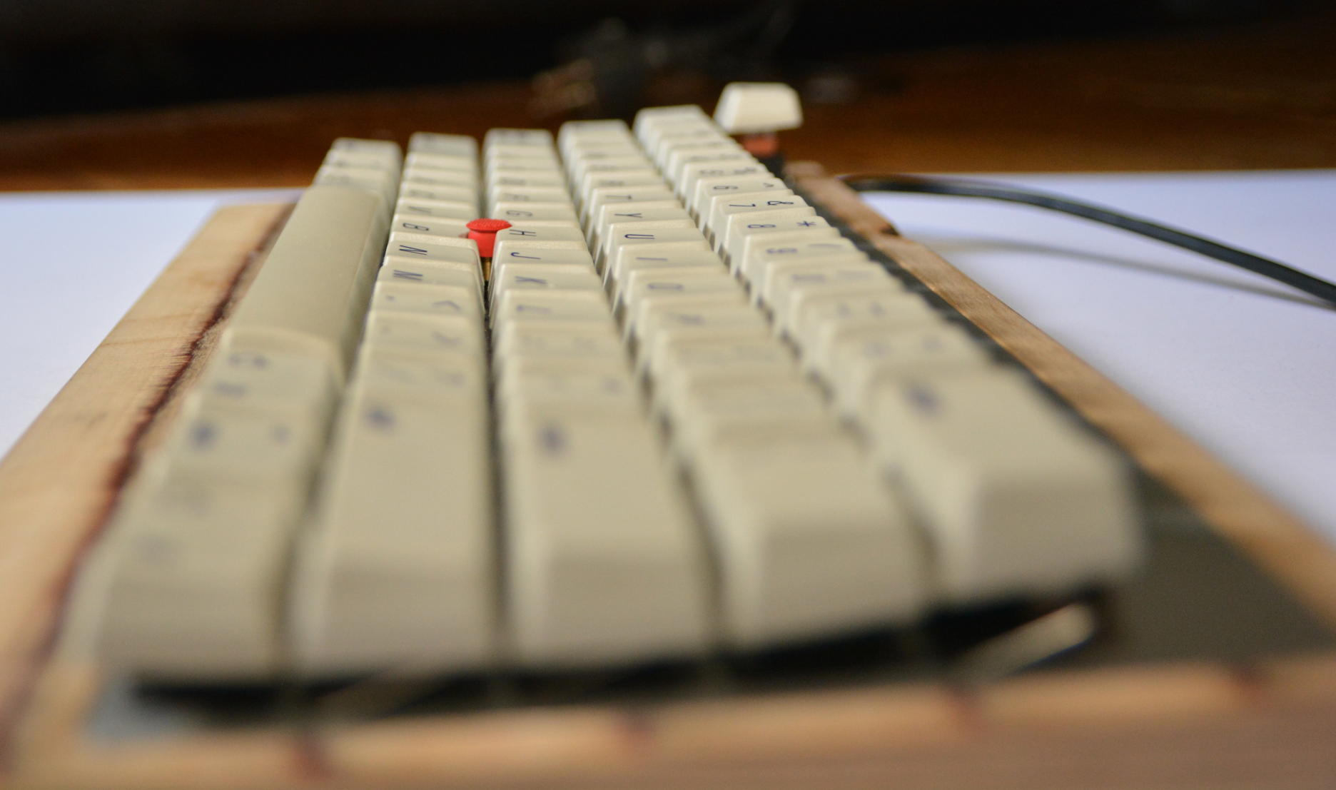

Sideview
Sideview

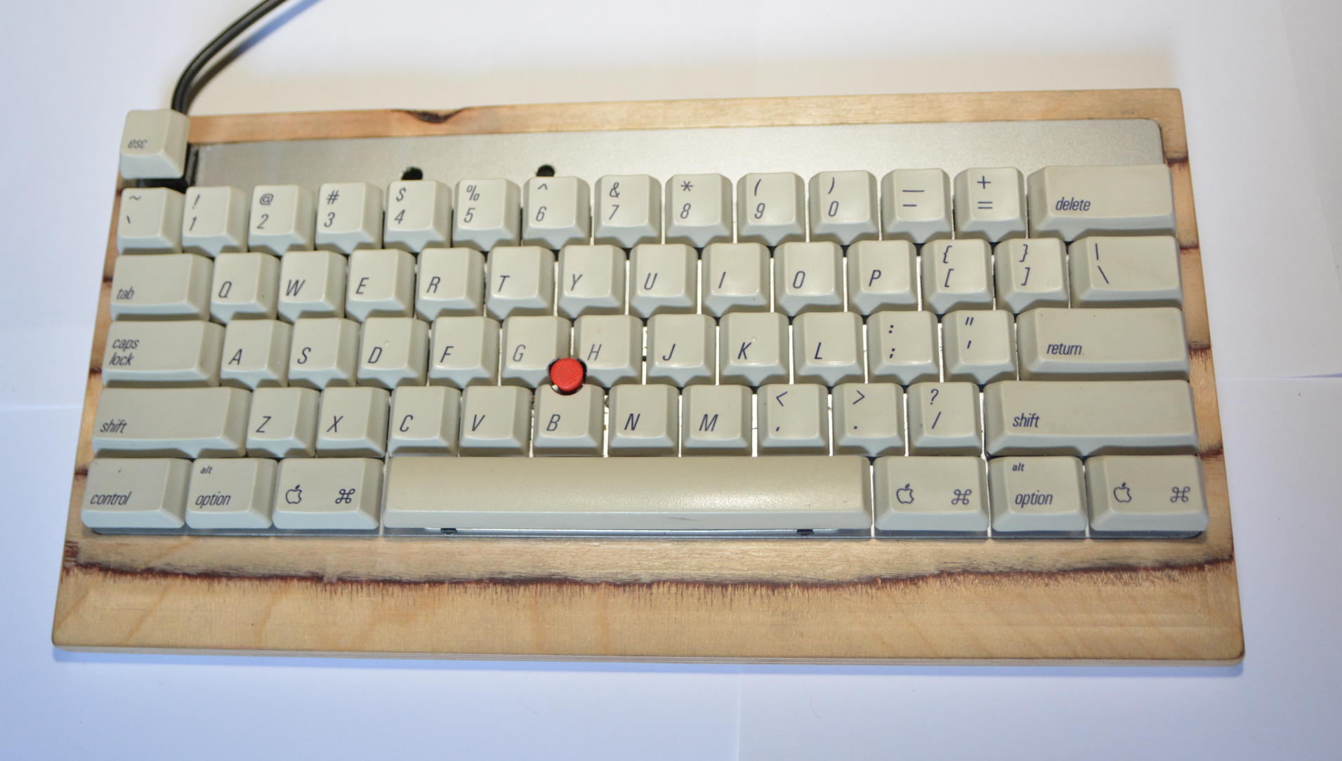

Overall view
Overall view

Here is a photo from the trackpoint in this board, as far as I know it came from a Thinkpad T42.
Trackpoint in Alps 5v61
